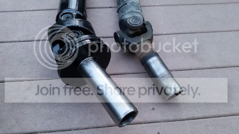

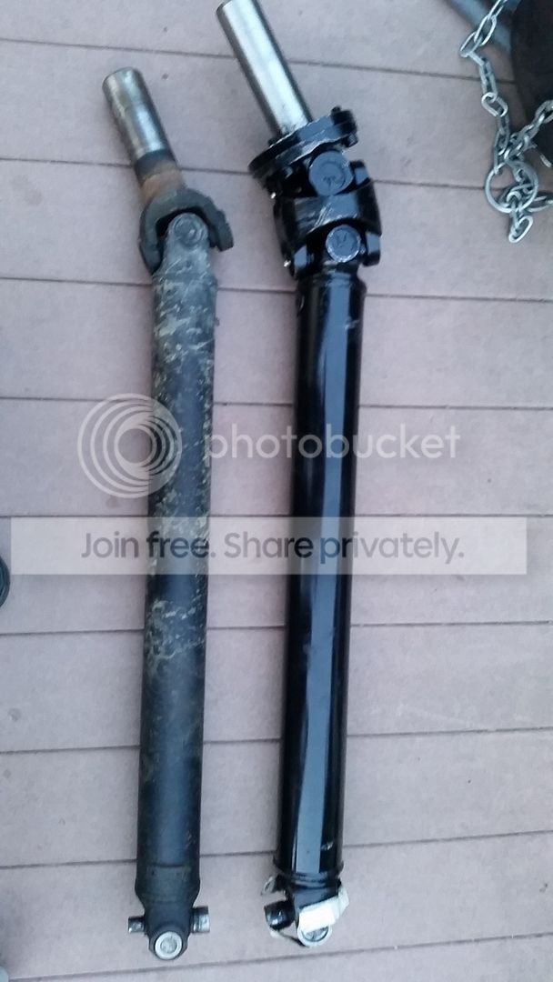

Here is @wetoolowdingbangow rear driveshaft built by Sacramento Driveline
^This...I was about to say the same thing. Don't have to go SYE to get CV shaft. Probably just getting a CV shaft even without shimming would go a long ways for you
