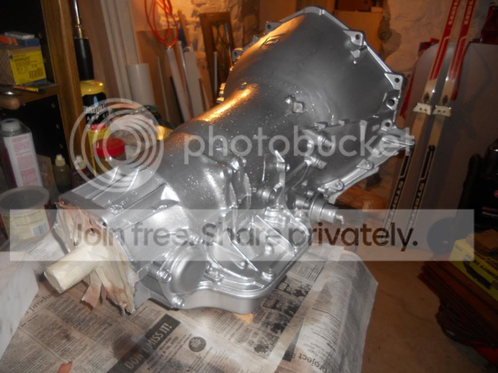

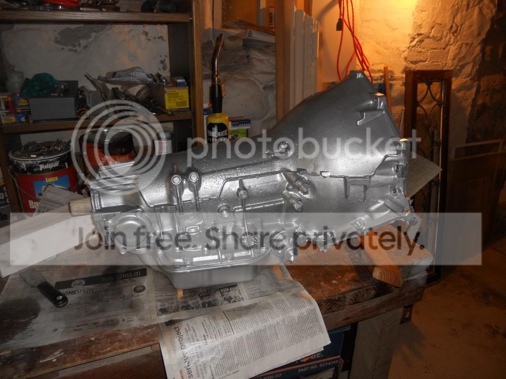

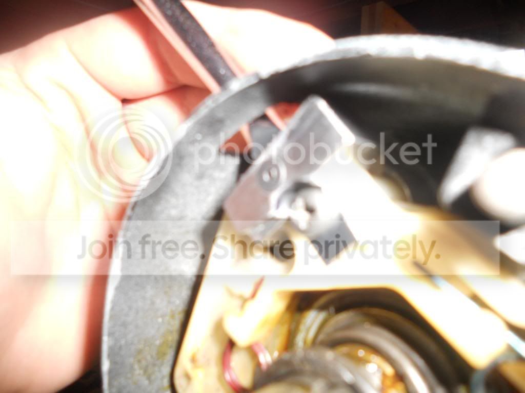

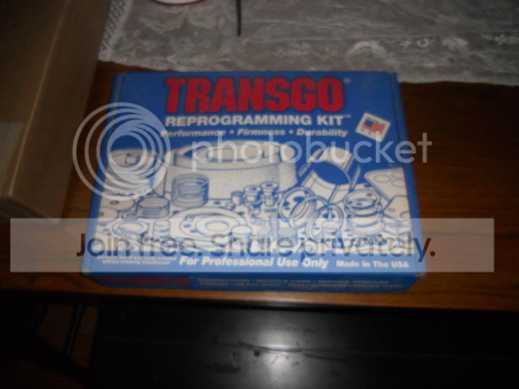

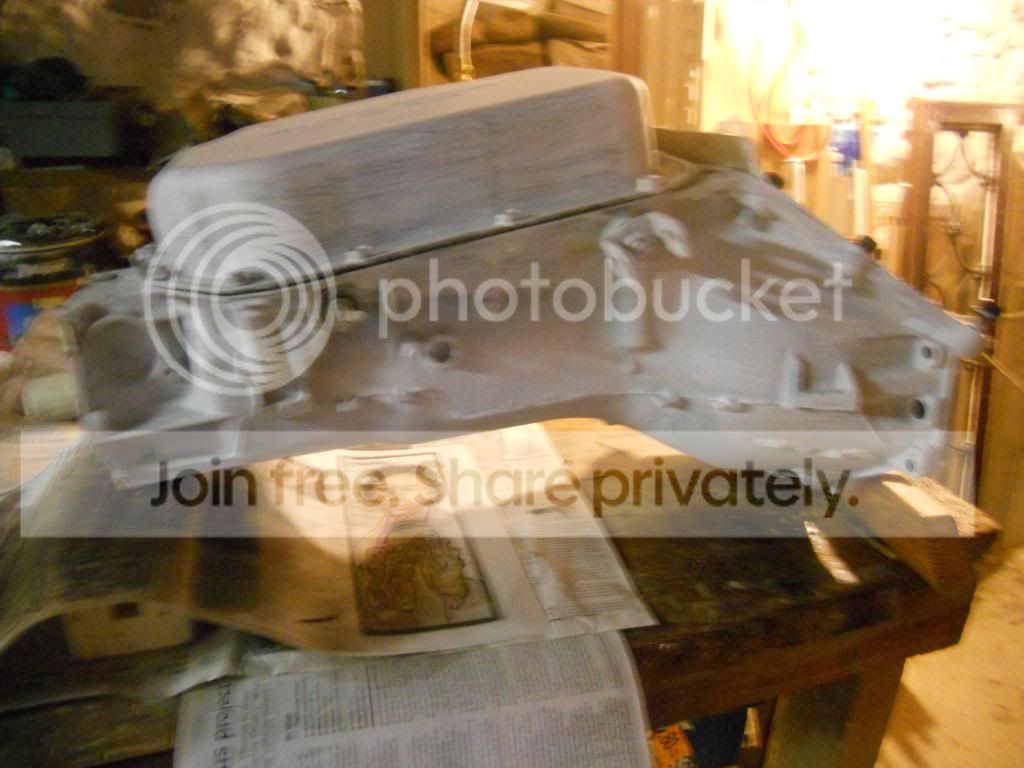

okay long needed update, got the shift kit installed in the th400 and actually dug into it pretty far, the kit came with a new HD snap ring to install in the case and also new springs to go inside the direct clutch. So i had that mostly apart and it looked good inside. Installed the new seperator plate and all that jazz with the check balls and a couple other various things. Went for the stage 2 which was not that much different that stage 1 (rv/towing) so i am not worried about it banging itself to pieces. After the reassembly i replaced the filter while i was in there and a new pan gasket, then i primed and painted the outside with aluminum colored paint, it looks like a new trans!

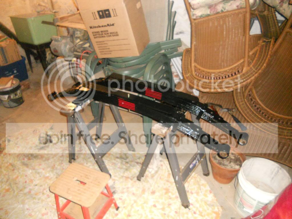

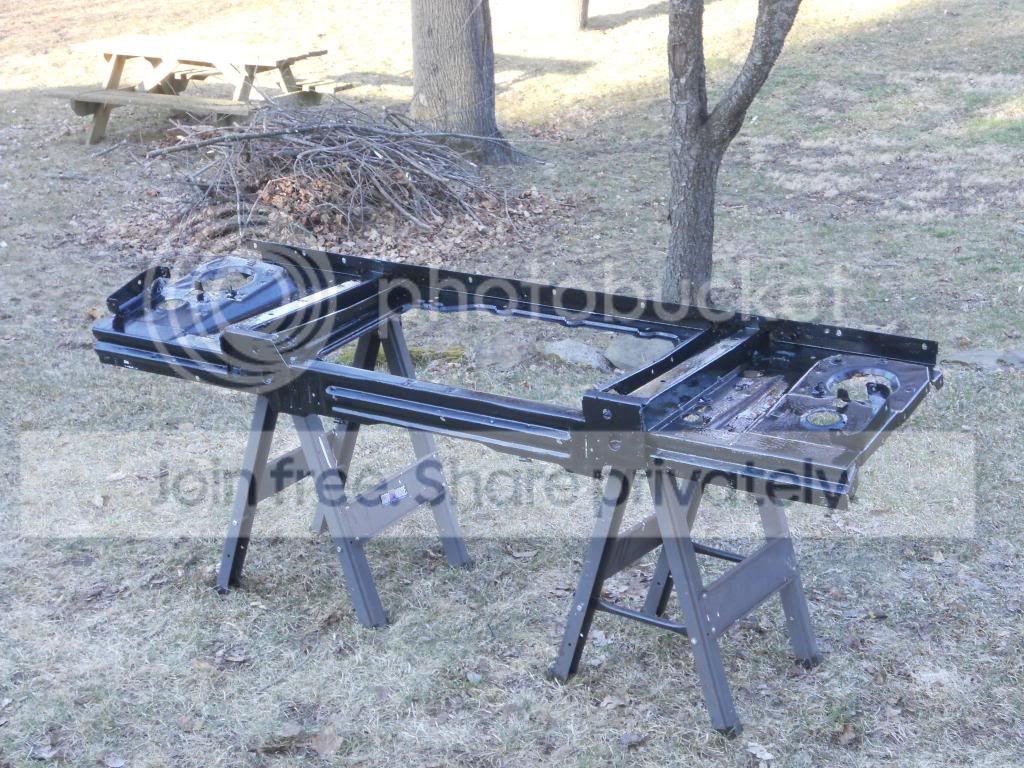

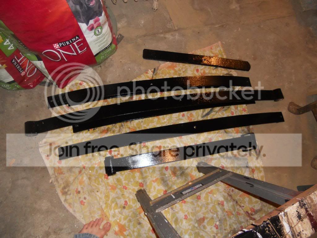

Also have grinded/primed/painted my 56" rear leaf springs, and they should be getting bolted back together in the next couple days.

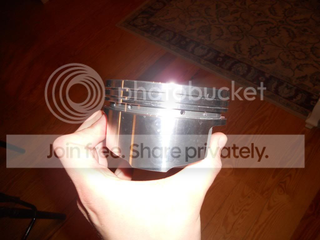

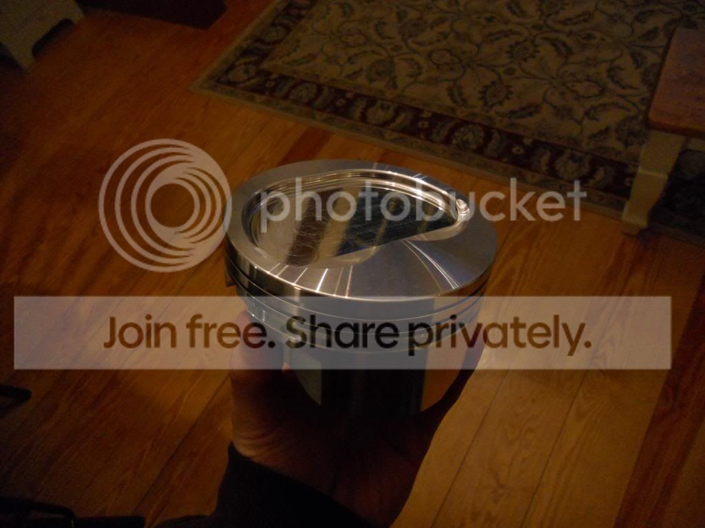

And finally, the engine build has begun. I will be boring out my 2 bolt 400 block to make it a 406, i have aluminum heads for it and a scat rotating assembly, forged rods and pistons, crank is cast, not going crazy on the cam but it will be around .480-.500" of lift, but geared for lower rpms obviously. Pistons are ordered and showed up the other day, talked to an engine shop and instead of buying a assembly with their pistons i got my own pistons but they are going to balanced the whole assembly as i have weighed the pistons, and that should be getting ordered this week. All the small stuff i already have, cam bearings, core plugs, pushrods, rockers, lifters etc. So all that is left is to finalize a cam and get that ordered.

Next up other than the engine, is bringing the transfer case inside to paint and get those springs back together and ready. Only a few more weeks and i should be able to be back outside working! My goal is to have it on the road at the end of may, have a little slack there obviously.
