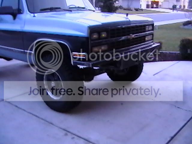

Here is an early shot of the bumper I built my brother for Christmas:xmas: Now it has a full on grill gaurd. He just got it powdercoated the other day, so look for a post this weekend with pictures of the finished product:cool1:
It tucks up nice and tight.
just a couple 3/8" and 1/4" brackets welded to a piece of 2x6x.188" tube, used some diamond plate :grin: to cover the brackets and eventually hide/protect some underside lights that will be mounted to the back of the bumper
front is similar
Front bumper, same 6x2x.188" tube and some 2x2x.188" tube, more brackets and some reinforcements, some fender trimming. I put them under the fender so it's not a anchor/hook if I'm backing up but yet if I come down on something it hopefully wont rip the fender off; hopefully left some room for body flex.
