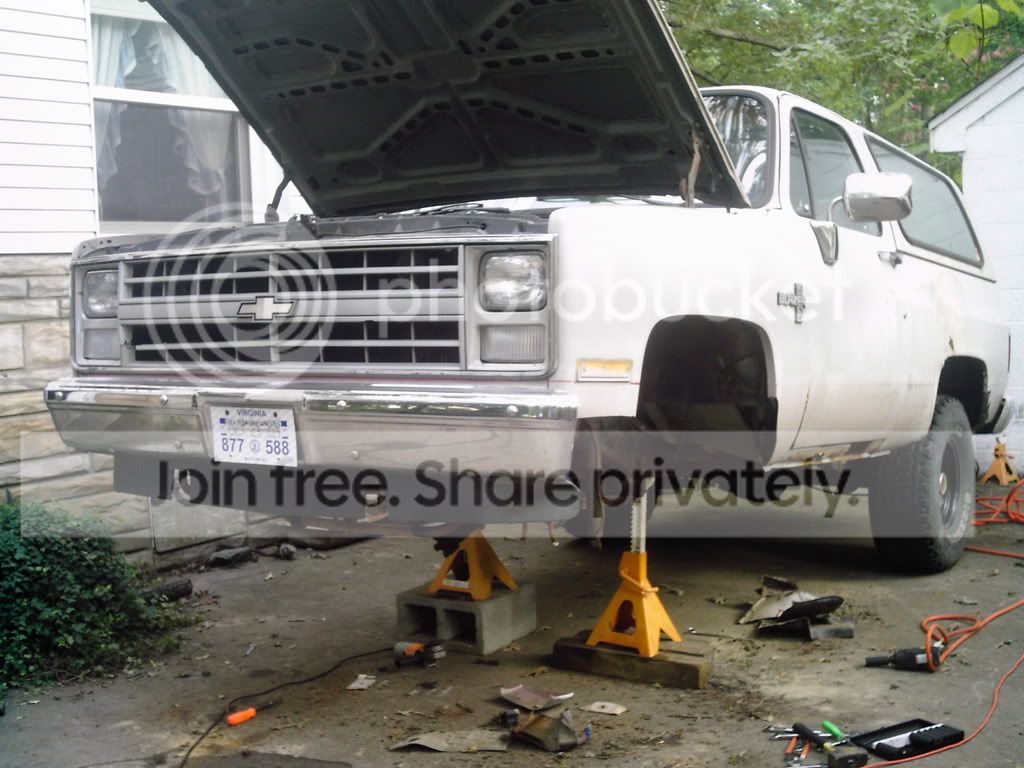

I would like to say something about the blocks. I agree you shouldnt use them BUT if you must use them stand them up so the holes are up and down with wood over the top. Cinder blocks are strong but the way you are useing them the weight is in the weakest part of the block. It dont take much to bust the side of the block but a hole lot to colapse the block the way it would be used in a wall.

good point taken never knew that man thanks..
not taken it as being dicks,some peole have there own way of doing things...i work with what i got and have been doing it along time thats all...
yea I feel ya on the i use what i got but if you do use concrete blocks definately flip them so the cells are opening up.I finally broke down and bought some huge jack stands at harbor freight that werent to bad but even with those I usually have to put some wood underneath them.I like the thread and the fact it is from another "youngster" like me...subscribed

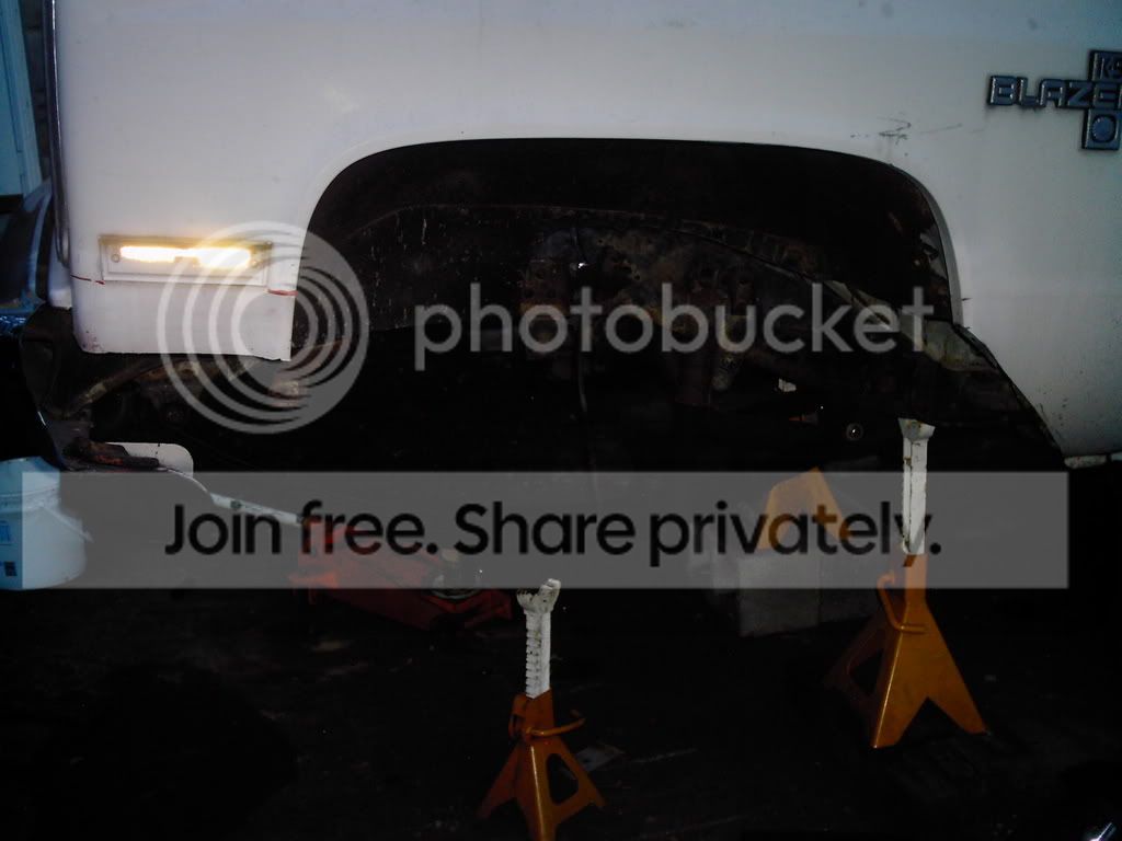

well more progress today but the word is SLOW...ive never had such a hard time getting a truck apart..this truck has some serious rust issues you can see the scale all over the ground...i have to go to the doc tomm about my back problems so we will see how much work he lets me do...anyway the front axle is out...

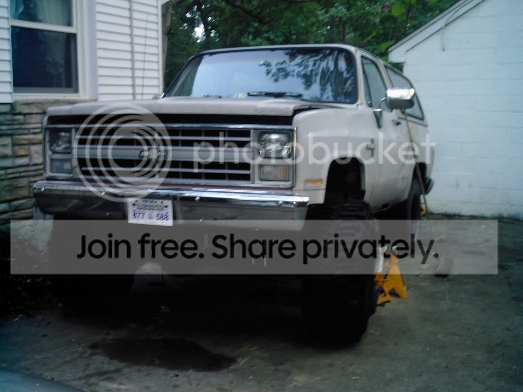

lots of progress today...its finnaly starting to look like it should...i got the axle in..the springs are in with a less desierable shackle angle...but remeber this is only phase one...im tired and dirty and ready to take a shower...i gotta work late tomm but after that im gonna try to wrench till the wee hours of the morning...anyway on to the pics...soory for the bad pic it was dark when i got done...

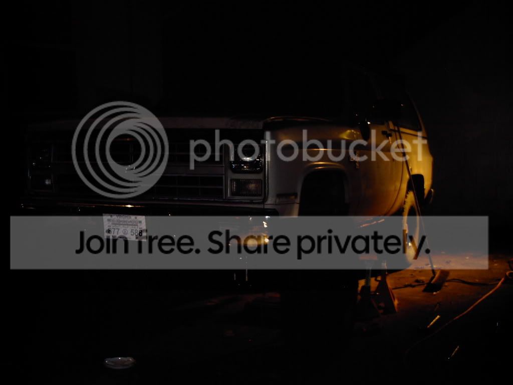

alright to dark tonight to get pic of the work done but LOTS OF PROGRESS TONIGHT!!i almost didnt want to stop cause everything was going right...i got the rear out of the white truck (someone is picking up tomm) and i got the rear out of the blazer (some one is picking the 10 bolt up tomm also)...it was a very good night....gonna have a lil get togher tomm with some of the carolinak5 member and get rid of some of this junk i got laying around...also hope to be wrenching for most of the day...got a daylight pic of the front done...

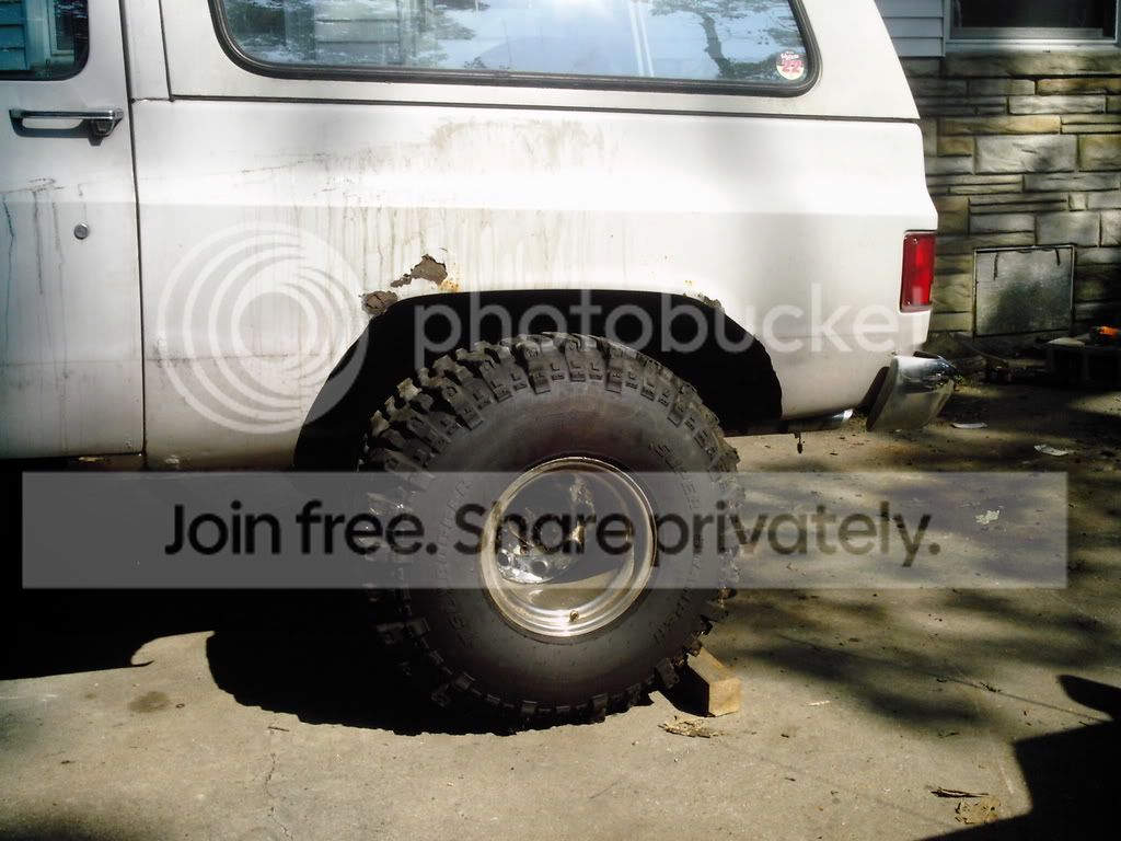

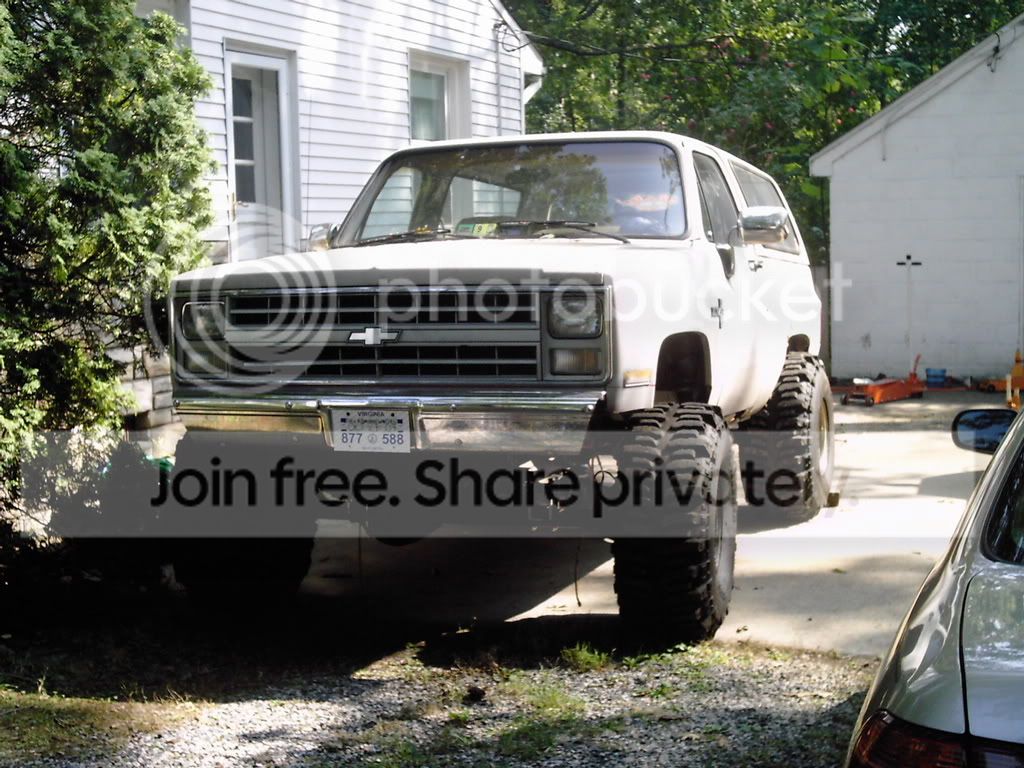

amazingly im clearing the 38.5s with just dut fenders in the rear...but in a week or two i will be putting my shackle flip on...onto the pics
horrible shackle angle but this is only phase in of my build :D
Looks good! Those 38.5 15 15s right? HOw much Bs are on those wheels? i love the stance it has.
