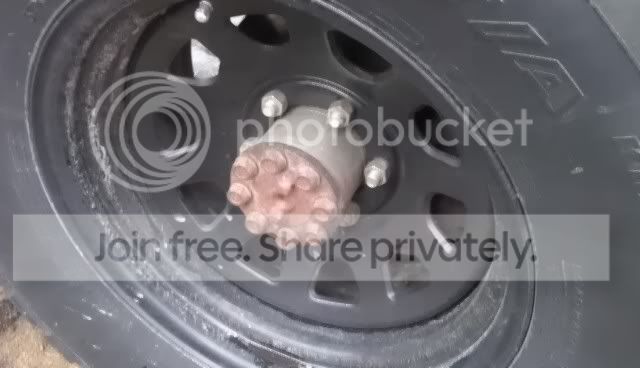

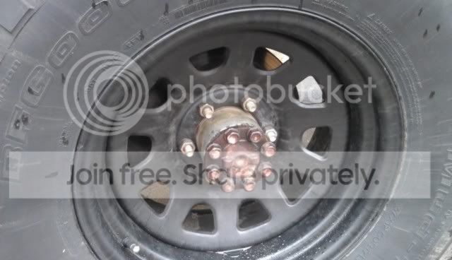

I got the hubs from extremeaxles.com. I took enough off the axle flanges just enought for my rims to slide off.....alot of test fitting...grinder to rim and back and forth several time....lol. I can get pics....
I went out and snapped a couple of pics.....
Before grinding......
After grinding.....
