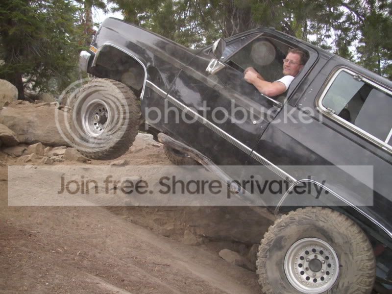

I can also attest to Chicken beating the crap outta his K5.
I've seen MrsChickenRammit beat the snot out of his 10 bolts, but not him. :popcorn:
