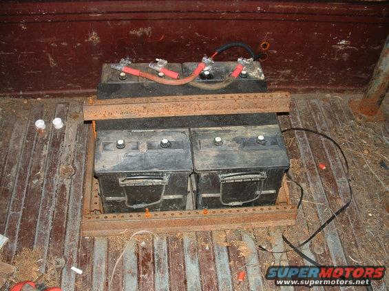

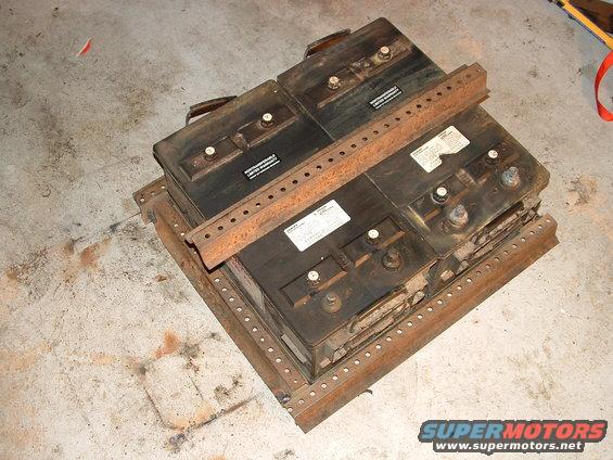

well if you looked at the link i had above.. it shows the wiring that WILL be done..
right now it is just the winch... 3/0 cable to batteries in parallel and a 10ag charge wire... all that is going to get redone...
but i used a stop sign post to make my mount...

Cool idea on the sign posts. Plenty beef along with the mounting holes. I have access to lots of those posts at work.
Looks like a lot of work, and a little overkill. But that can be a good thing, right?

im looking at it that way.. if im stuck... i want out...
I want to be a self recovery machine...
in addition i really most likely will not use the 200a relay... i want to as i can put a contura rocker switch in and jump the truck from either bank of batteries.... from within the cab...
however i can do the same with the manual switches but it is as it says.. manual....
