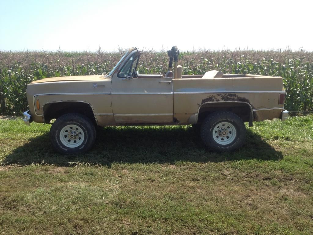

So here is the new ride height.
Oh, and I was really full of **** about not towing with this thing.
Martin
Looks good Martin! Does it ride better?
Corn look about like ours does.
