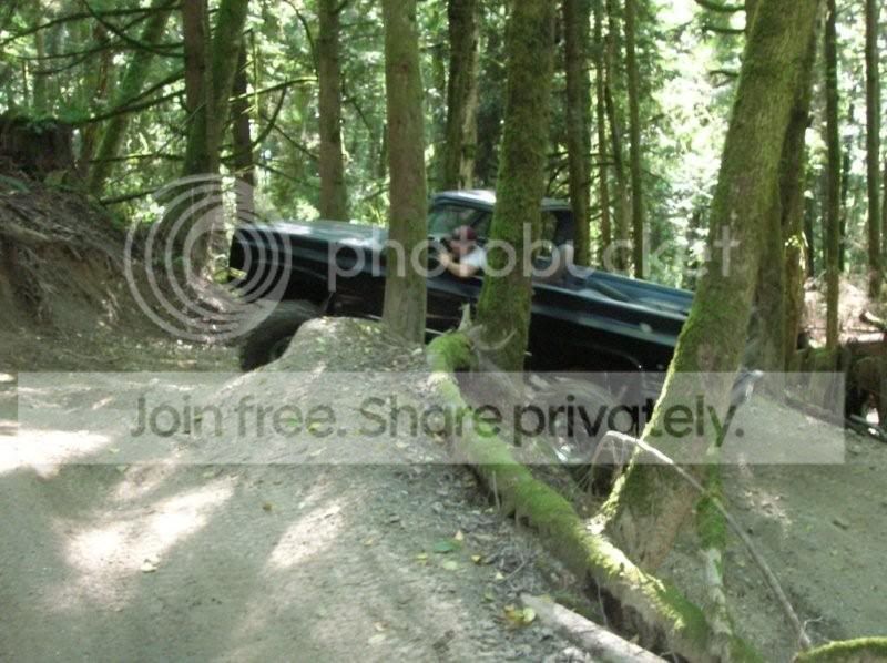

Oh yeah I know I have an 89 6 pack. It would be impossible to wheel a Crew LB on the trails up here. My K5 is huge by comparison to 95% of the rigs up here. Width is the main issue, but if I was much longer I couldn't run the trails at all.

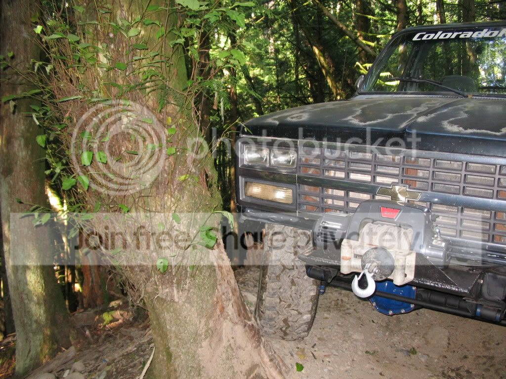

Here is one of the corners..I have to three point this turn, and there are lots that are tighter with trees :D Reason my doors look the way they do!
My bedside above my left rear tire is on a tree out of the frame in this pic. I'd love to see a longer fullsize and the carnage that would ensue on a couple of these trails :D

Hey Brian, is that Walker Valley???

Yeah they were both taken on the lower portion of Upper Mainline.

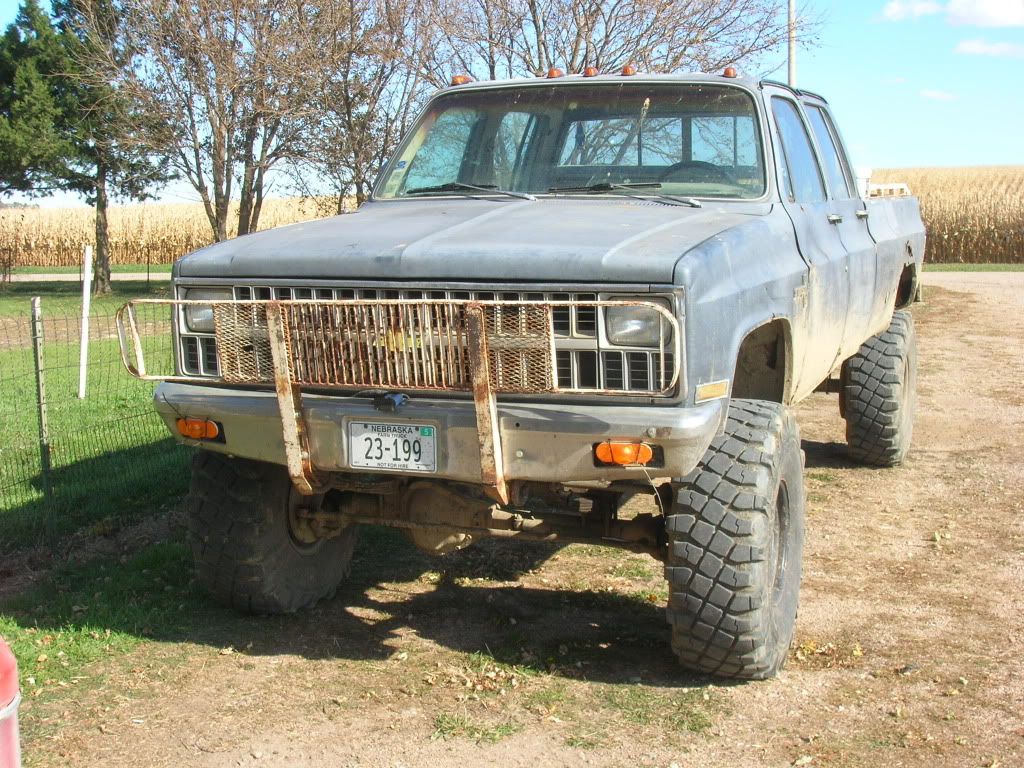

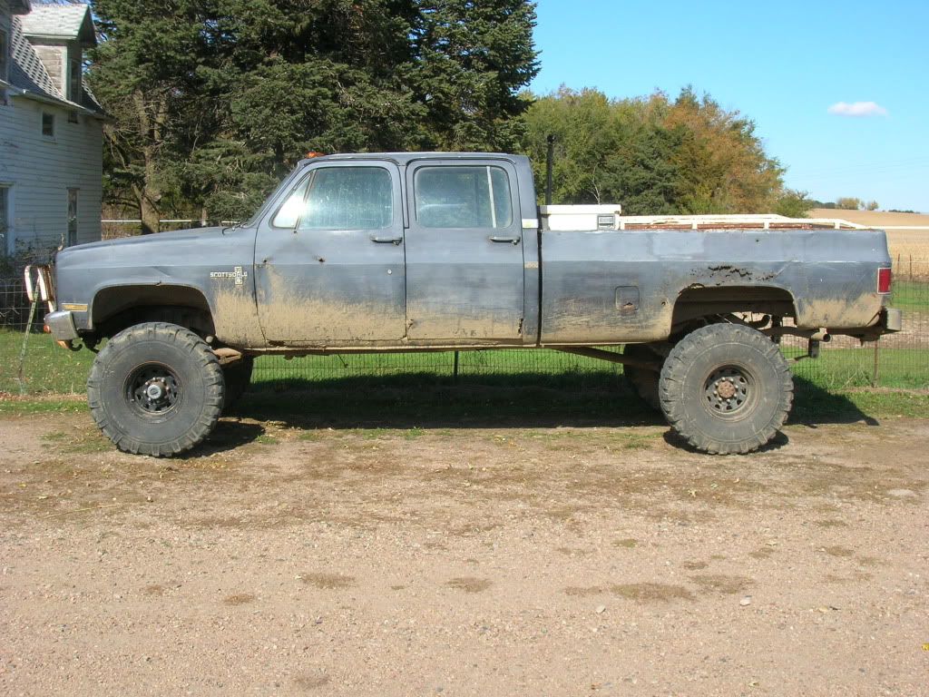

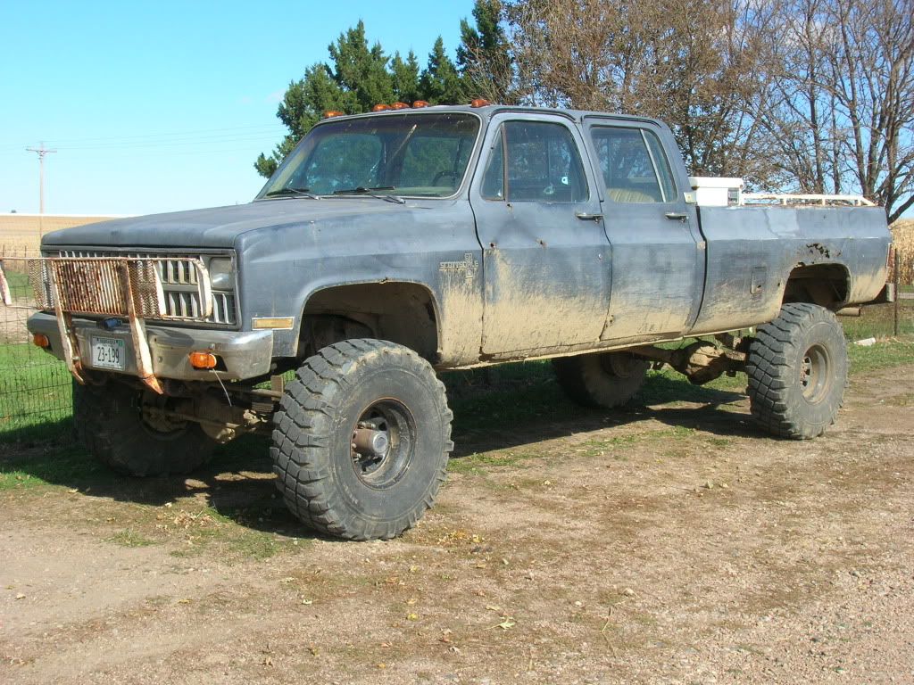

Here is how it looks on 38's (325/85R16 Michelin XML's).

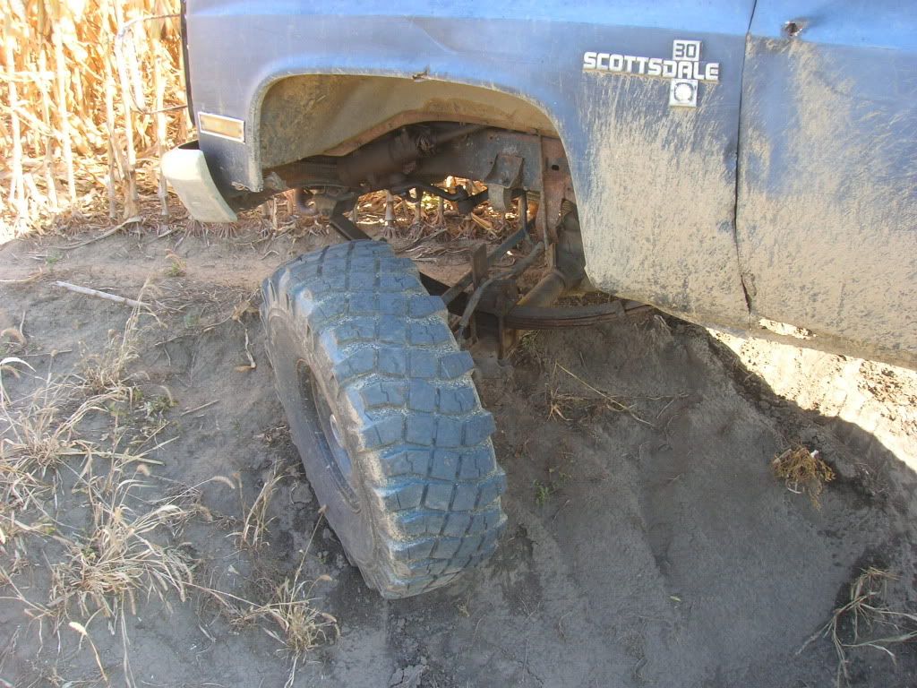

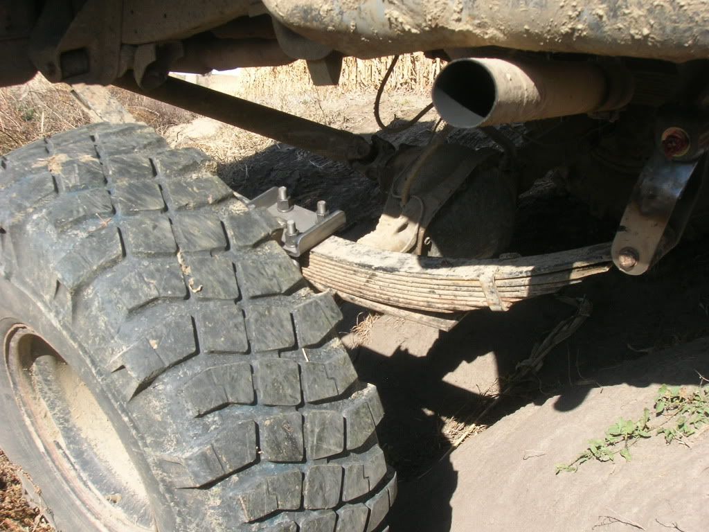

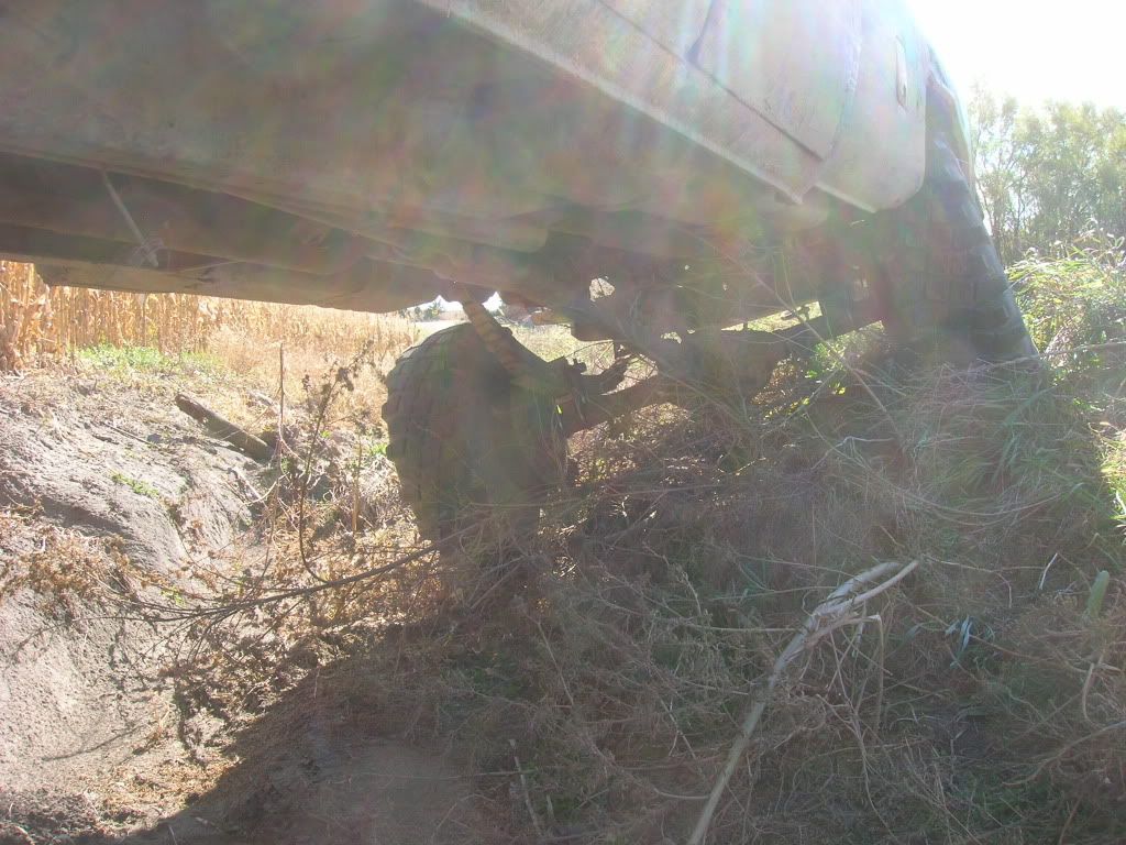

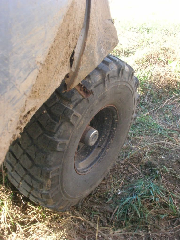

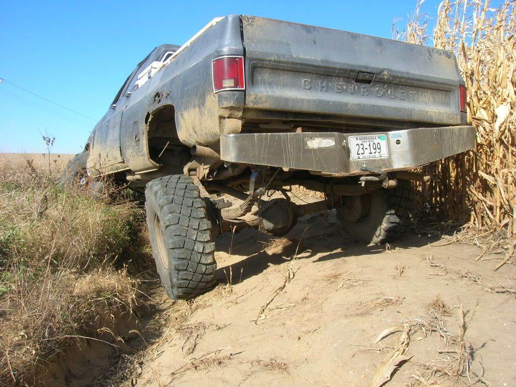

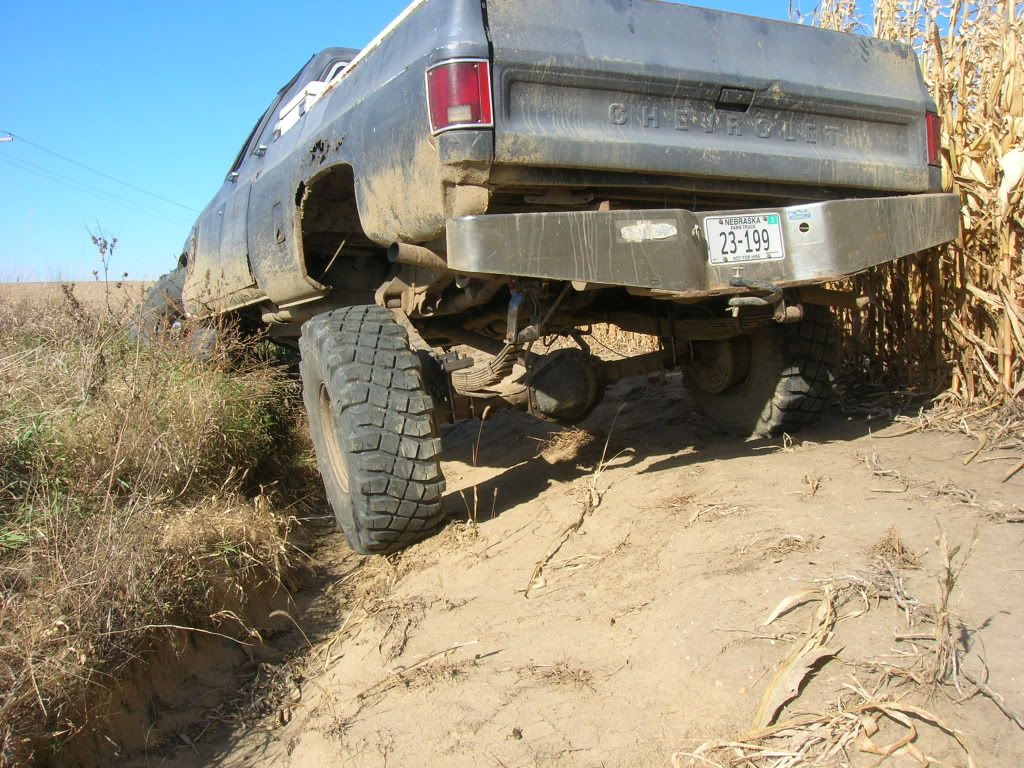

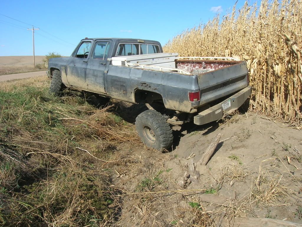

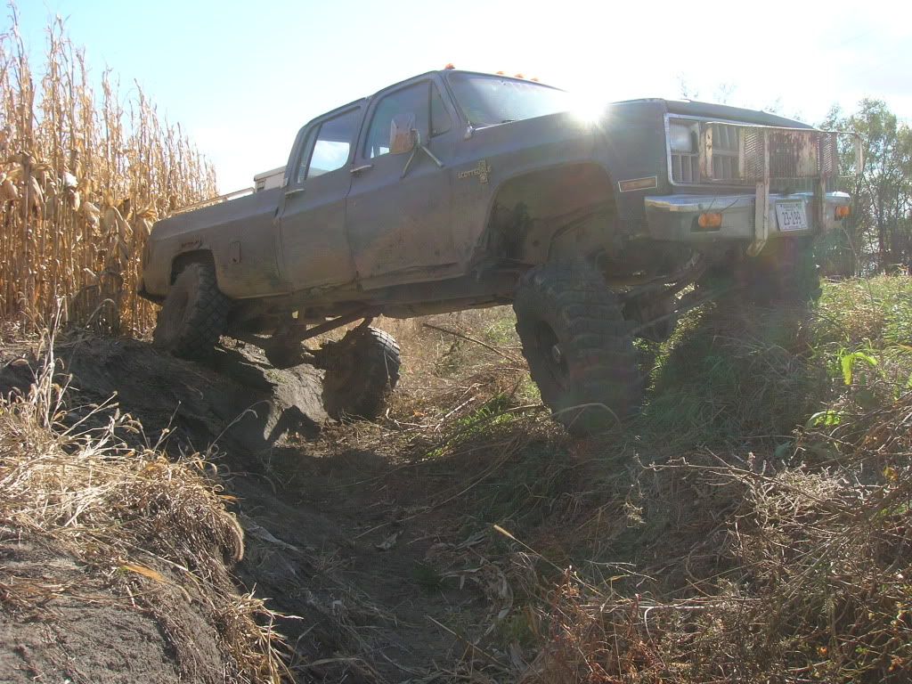

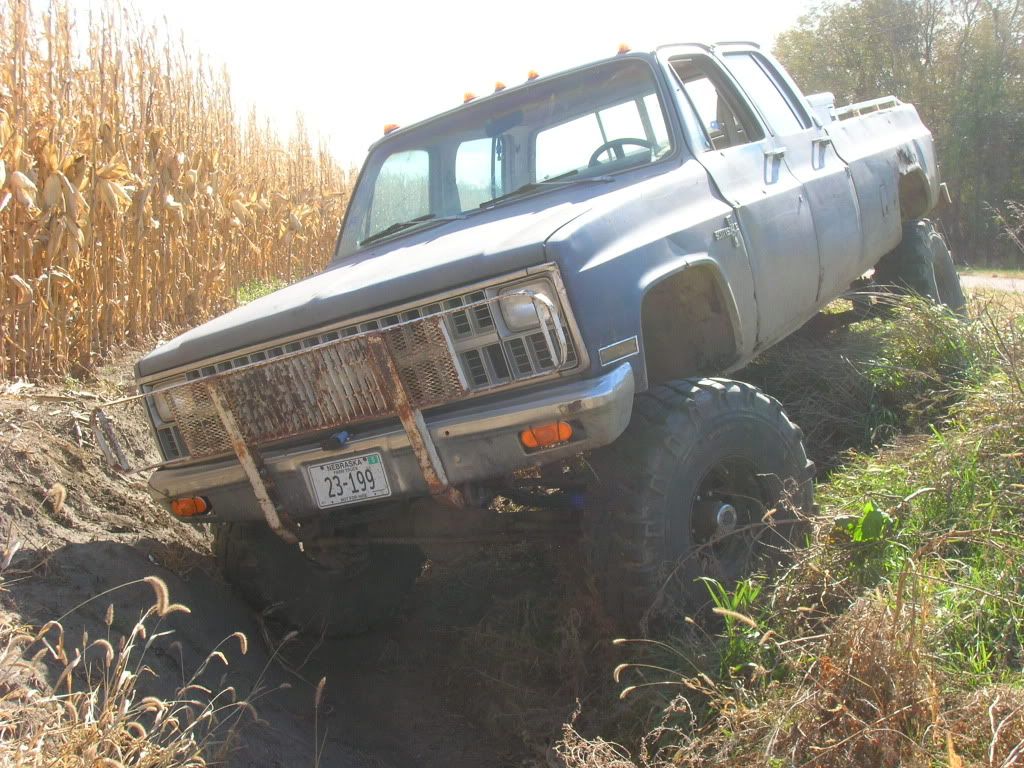

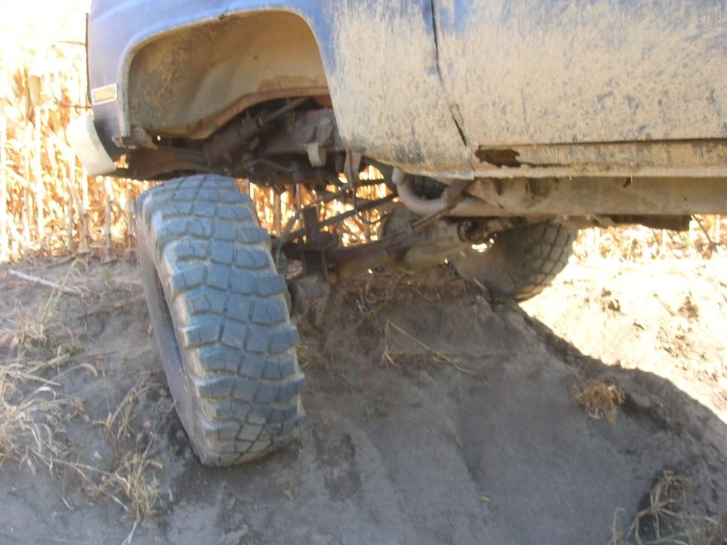

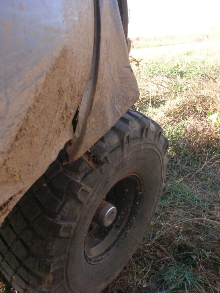

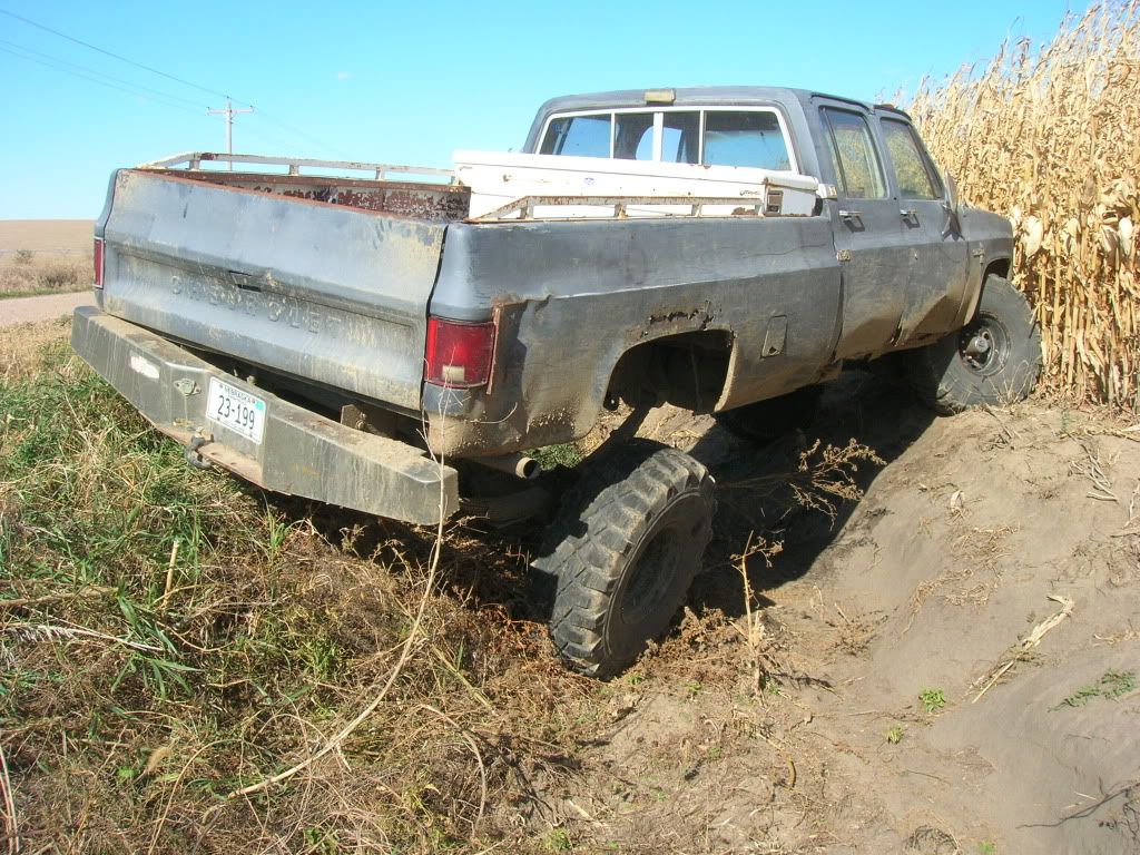

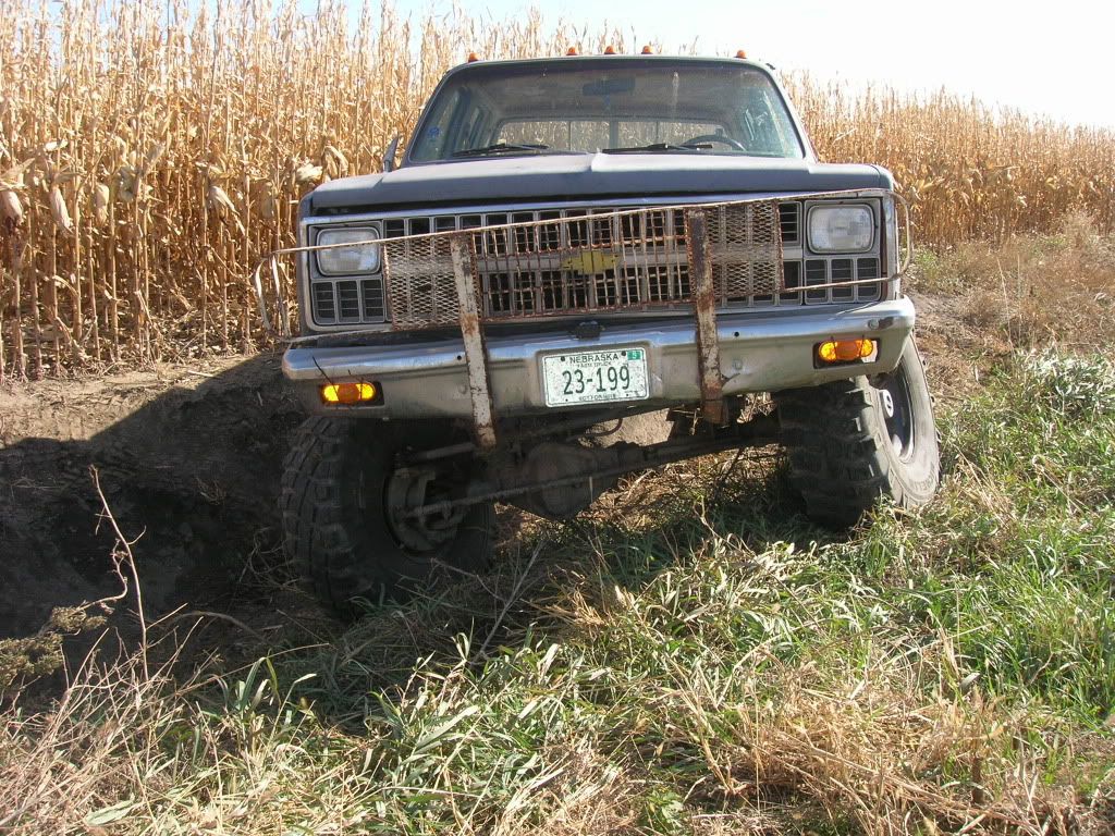

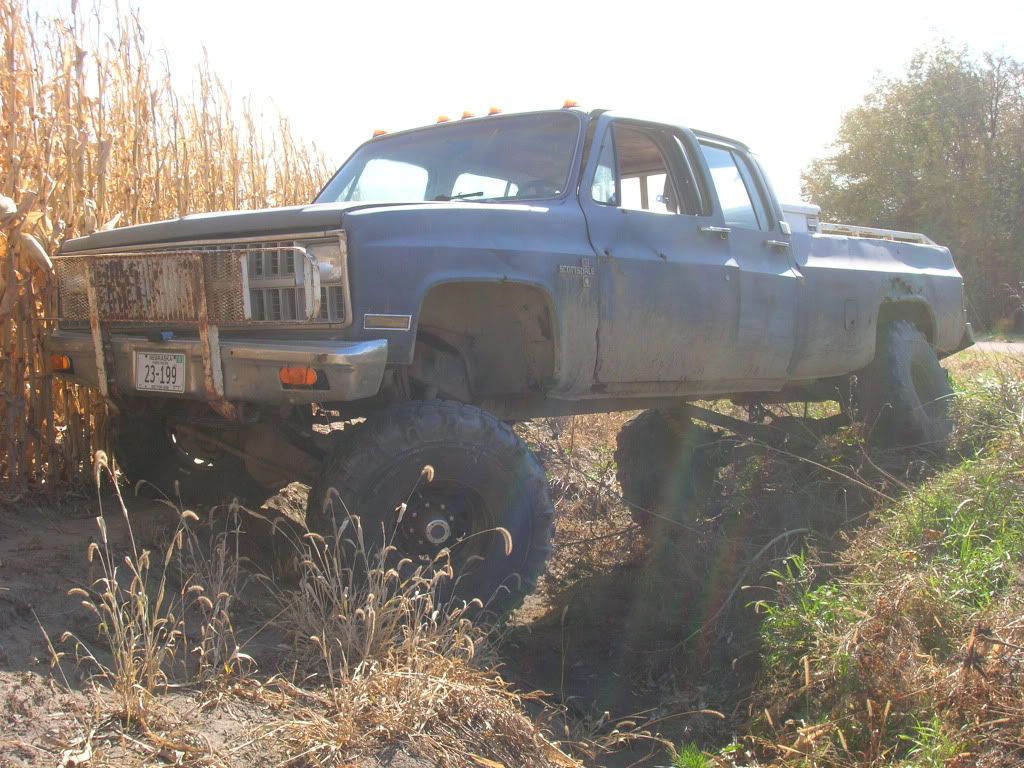

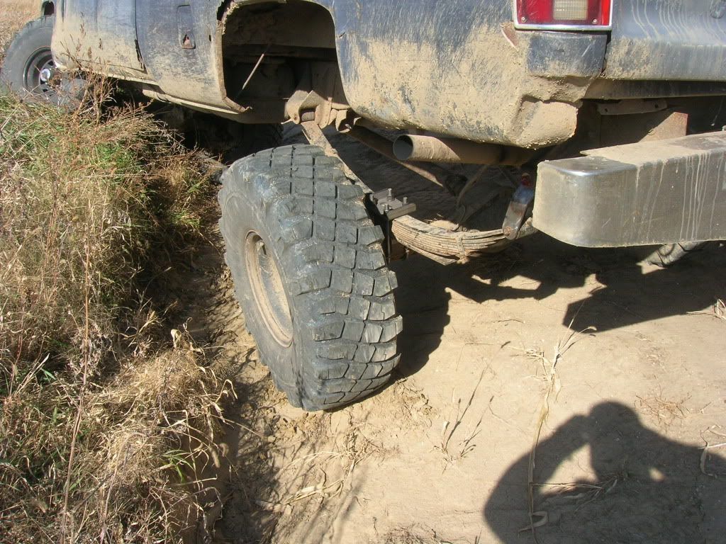

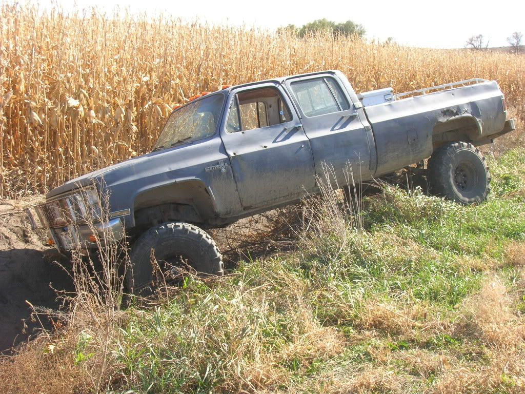

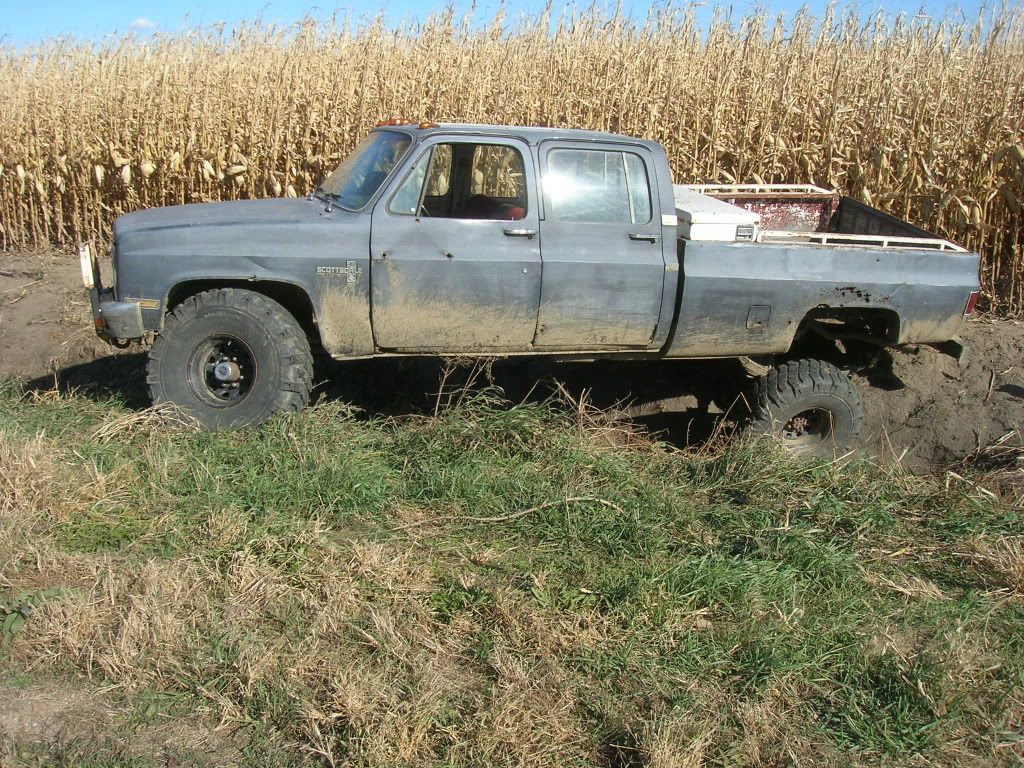

I am still running two tie rods. Need to break down and finish the hydro assist, but there are a lot of things I need to do (shocks?). I did however finally change the rear lift. I removed the 4" lift blocks that were originally on it, and replaced them with 1" zero rates. I also installed a u-bolt flip kit from ORD while I was doing the zero rate install. I installed the zero rates so they moved the axle back 1". I should have moved it back 1.5", but oh well. I also replaced the OEM rear shackles with 7" DIY4X shackles. My rear shackle angle is not good. They are pretty much straight up and down. I should move my shackle flips forward a little bit, but I am going to see how this works. After I got done, I took it out and beat on it a little bit. I am going to have to pick up some more sawzall blades, because I am in need of some serious fender trimming up front with the 38's. Here are some pictures from flexing it out in the ditch.
