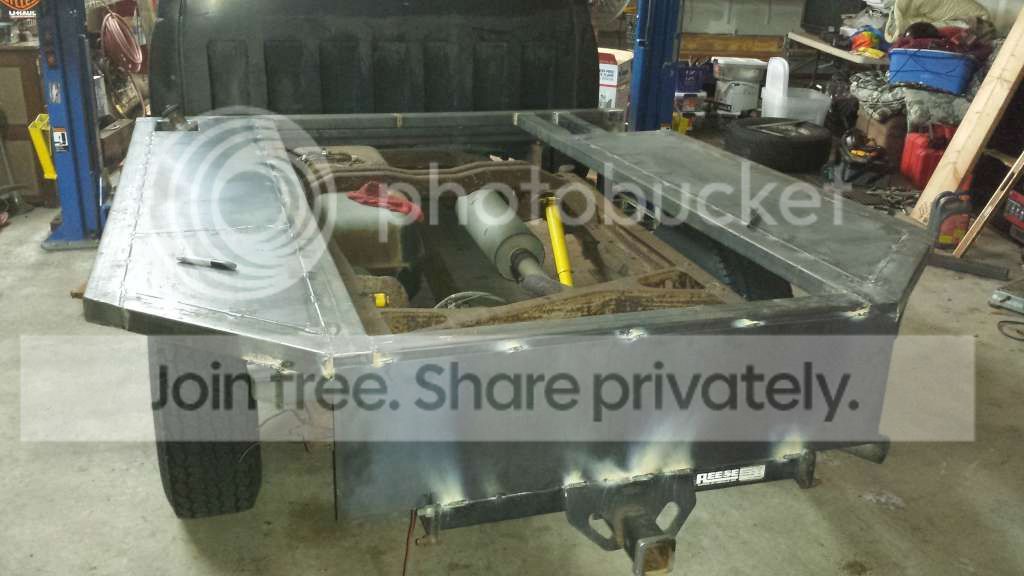

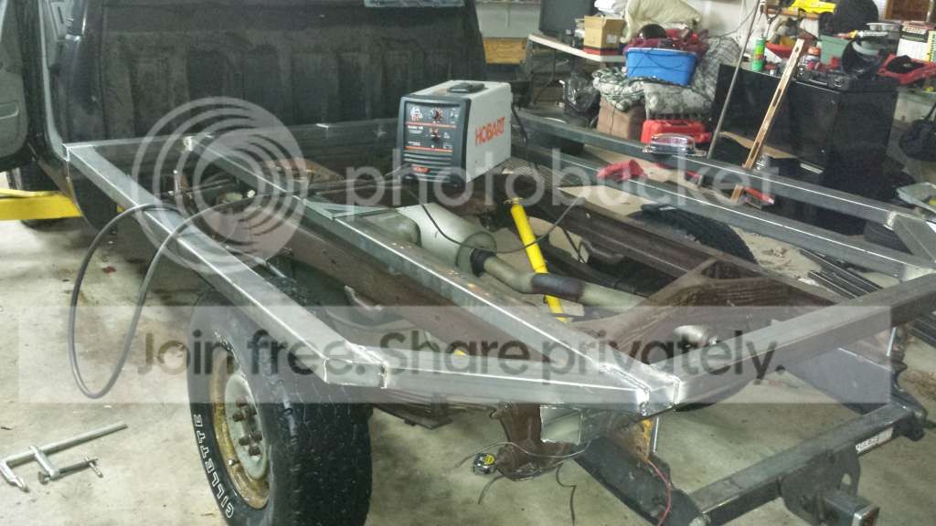

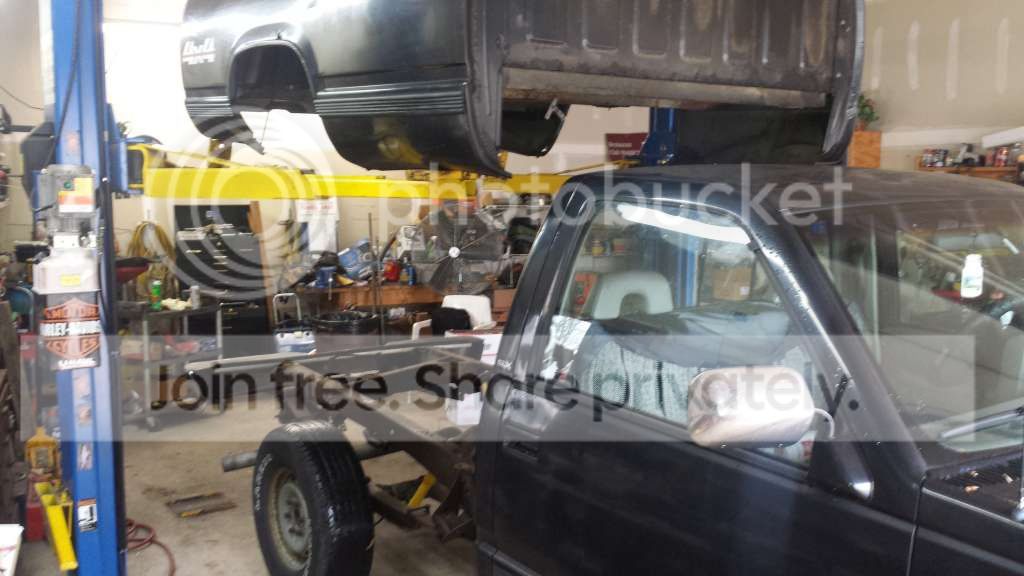

Yanked the bed and made a scrap run for a whopping $100 back into the budget. Its really easy to pull a bed off with a 2 post lift...

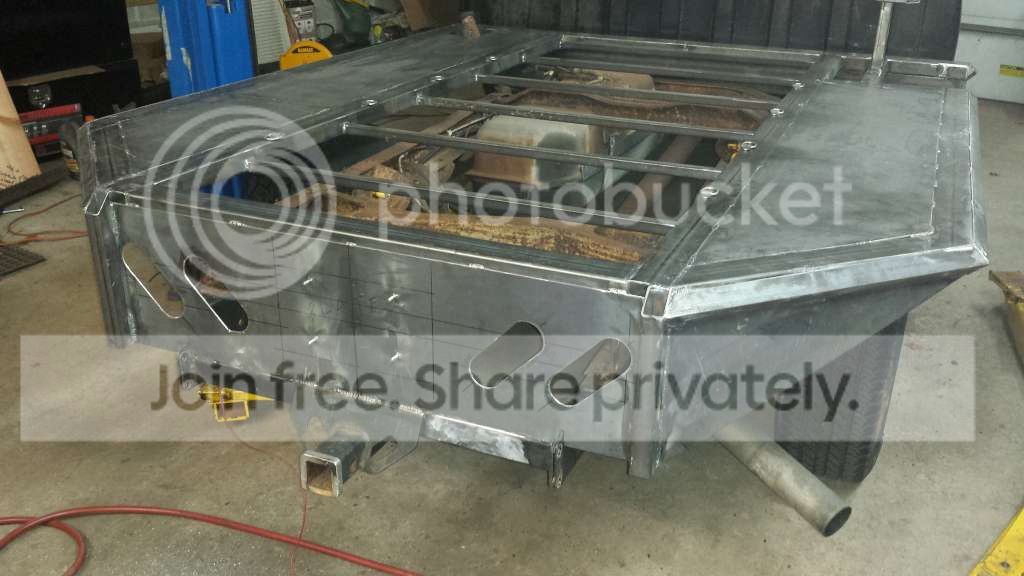

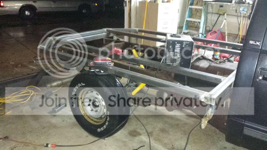

How its sitting after about 4 hours of actually building the bed.

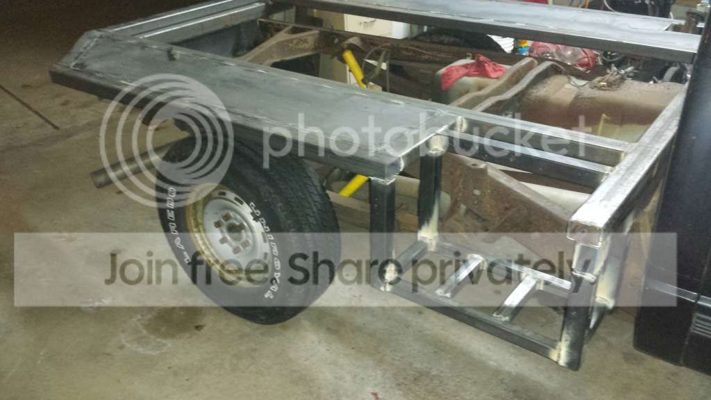

The back of the bed will have plate down flush to the receiver which will become part of the bed. Everything will still unbolt. The center section will be planked with composite decking like my old square body had and the outside sections will be 1/8 plate. Ive still got 9 ribs to put in, Oxy-Acetylene cut out, back rack, lights, and boxes. Ive been holding off on figuring my box location simply because I wanted to slam the box on the drivers side tight to the welder.

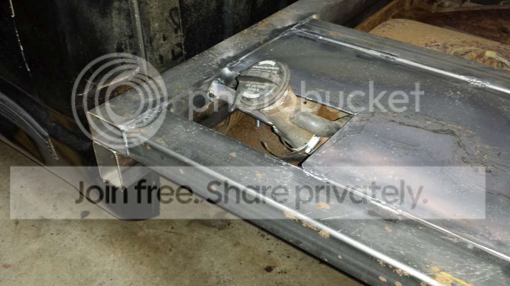

What it the drop down on the right side for? Torch cylinders?

On the plate they drops down to the hitch. Are you gonna leave it full like that or trim it at an angle to fit the width of the hitch? I'm assuming it was just an in progress pic but I ask anyway
That plate is staying full. Pictures to come to illustrate how it will come together today and not look funky.
Martin
Indeed

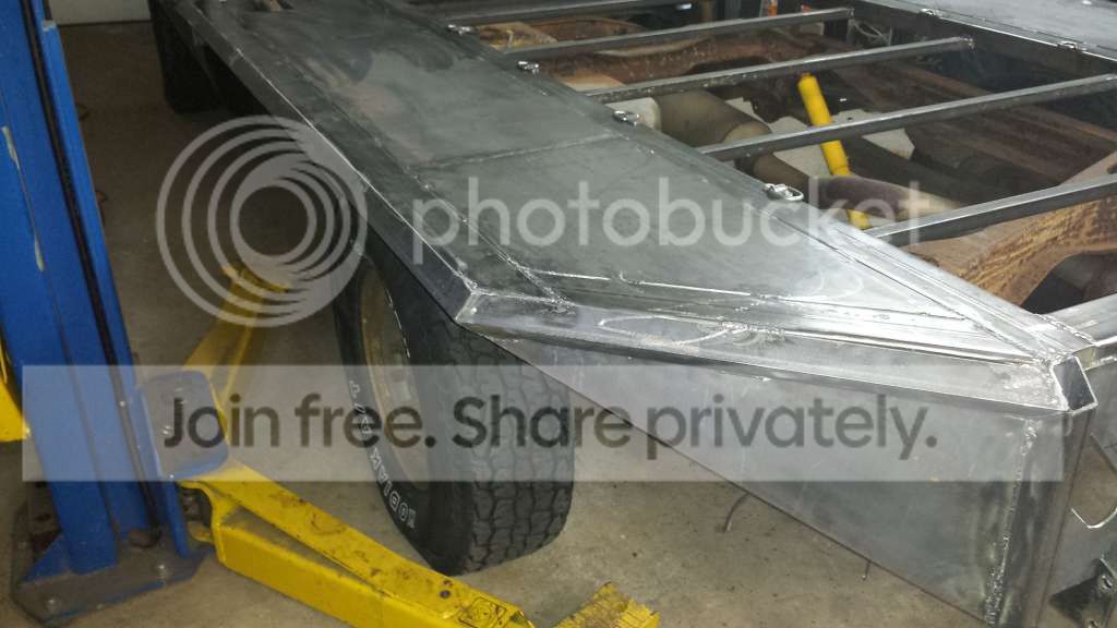

Like this.
Are you gonna plate in that gap as well?
That definitely helps.
Just for thought. About cutting the plate now on an angle and running the side tube all the way down to the hitch? Instead of making it a two step?
Just a thought. Keep up the work

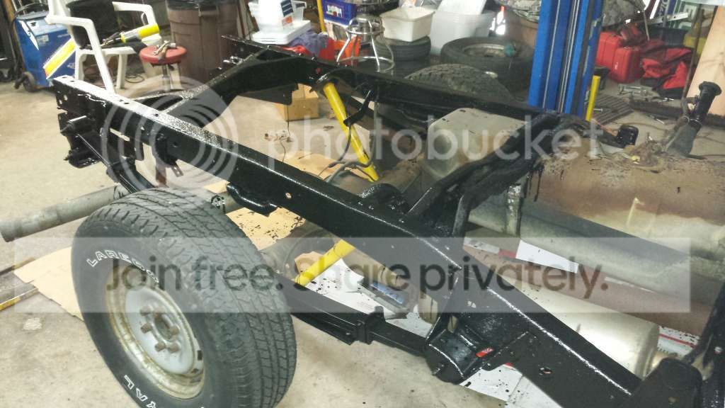

Holy long day. 6:30 until midnight. I really didnt want to have to grind paint off 10 times to finish everything just for the sake of getting it painted and out of my buds garage. I knew I would just make it if I pulled a late night.
First I douched the frame with rustoleum brush on enamel.
Which is flamable btw.

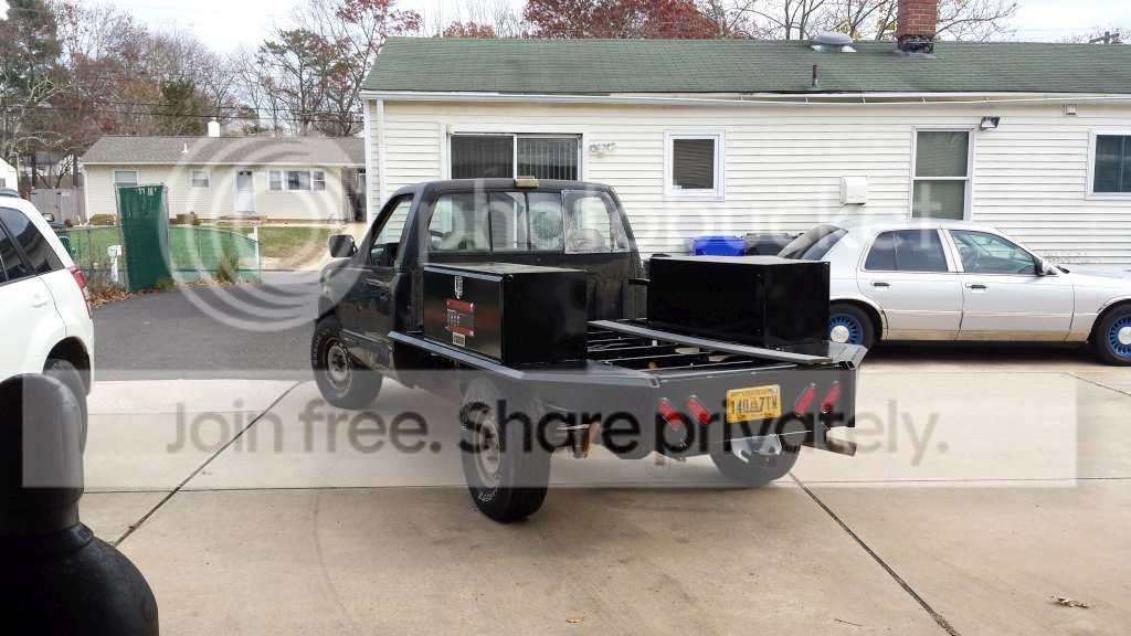

And I think it came together really nice with the angle irons capping it and the bumperettes in the back.

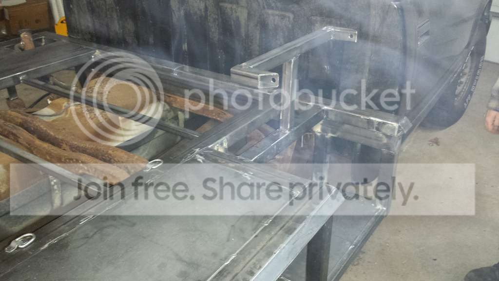

Tomorrow I'll wire lights, plank the center with the trex deck, mounts the boxes and be done. Only fab left to do is the racks. I figured it wasnt much of a big deal scrapping off a couple 3x3 sections.

I forgot already but do you have plans for air bags to handle the weight?
Not as of this moment. I'll probably put higher 3/4ton GVRW springs out back in the future but to be honest with you the bed isnt that crazy heavy. The stock bed is probably 200-300lbs and I would guess this is 650ish.
Lunch break. Need to wire trailer plug and set the decking. Backrack to come next week. Looks empty with no welder or tanks between the boxes and the cab lol.
