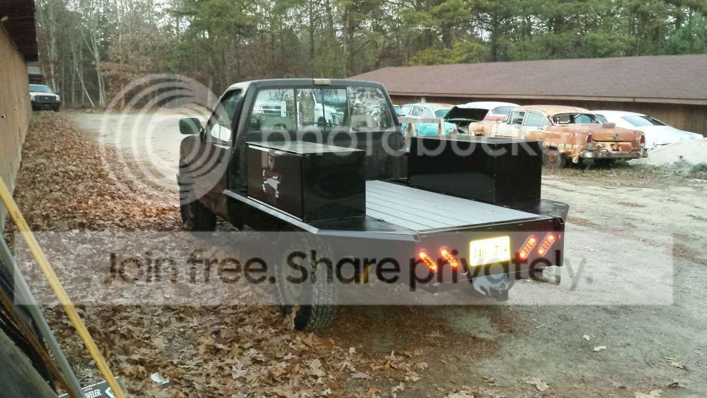

I'll check the law but I dont think there is anything illegal about it. I was thinking of adding a crash bar over them. Basically a really beefy piece of angle over the gap. Maybe I'll do it when I start the racks.
Threw the tanks on and went over to my shop and decked it. Still need to add back up lights on the wings, license plate light, trailer hookup. Gonna order some pucks to put a body lift on the cab so I can start on the racks next week.
Also need to figure out what Im going to do spring wise to handle the stuff like hippies said.
