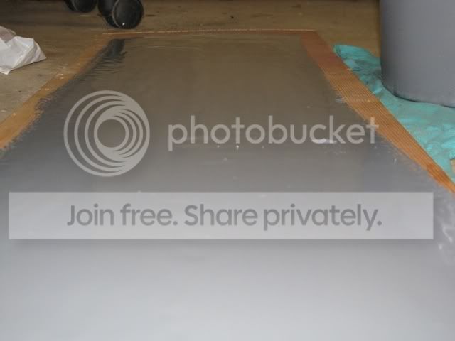

Initial results are positive! I used a stiff roller and poured the liner on and rolled it in and spread it out.
If you lay down a couple of coats it lays out really nice, two or three passes and it looks like a Herculiner would. If you lay it out thicker it smooths the surface out a lot to the point where it is lightly rippled. I think it may lay out flatter over night, I'll check it in the morning and see how far it went. I'm guessing it is probably about 3/32" or so thick, maybe 1/16" thick.

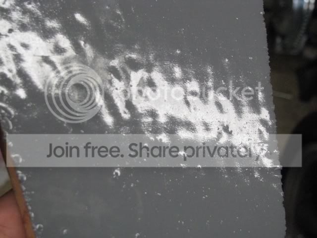

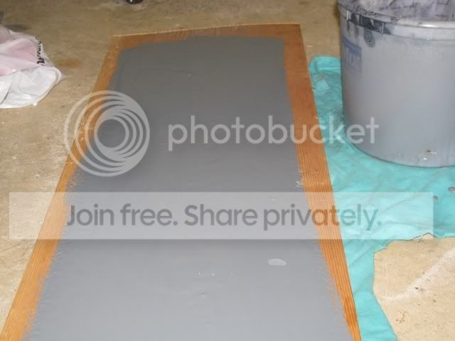

Here ya go! Don't mind the smudge on the big panel. I stuck my thumb in it before it was dry. :rolleyes:
It's tacked up and this is the way it will always look. I think the key is to lay either a thinner coat and wait for it to tack, then lay another thin coat, or just be happy with the roller texture.
It is a wrinkle finish, not rough at all. The texture is very similar to a rough plastic molded piece like rail caps or bumper steps. It is very grippy, though. I was amazed when I threw a 22lb box into the bed of the truck and it just stuck. :D
