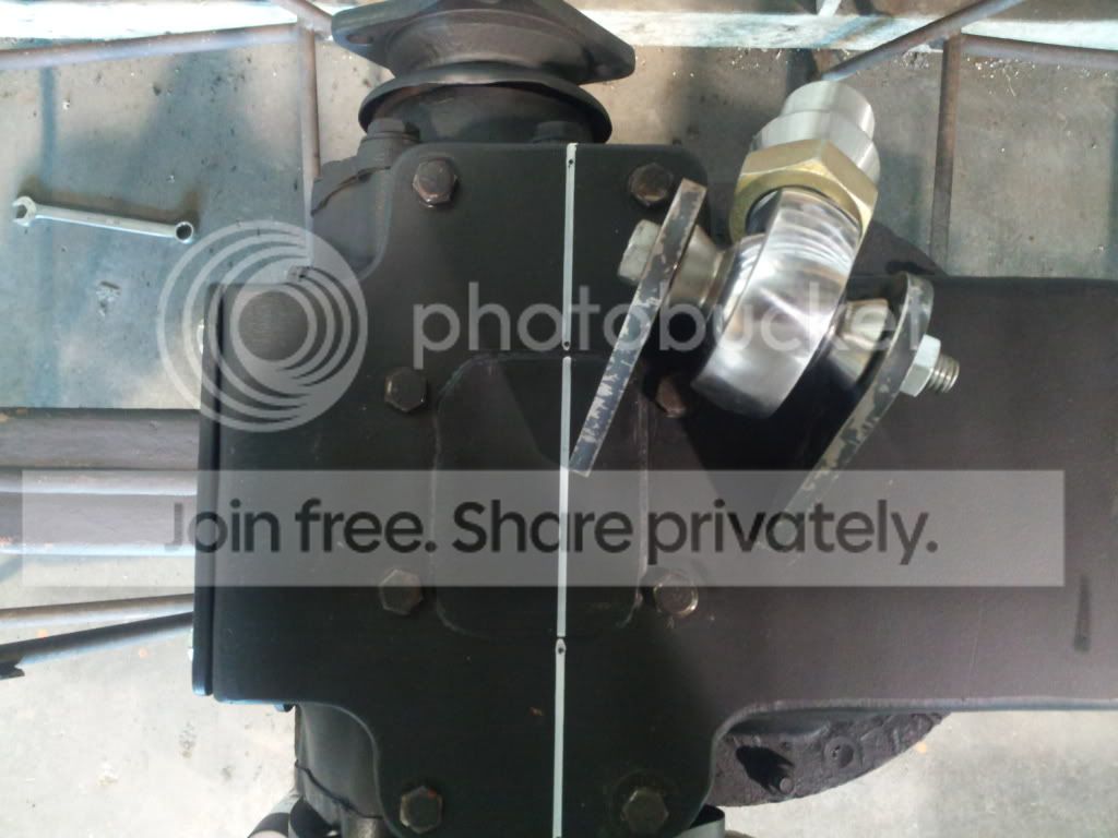

Been working at getting rockwells built still. Just finished the top hat for the rear triangulated uppers this morning.

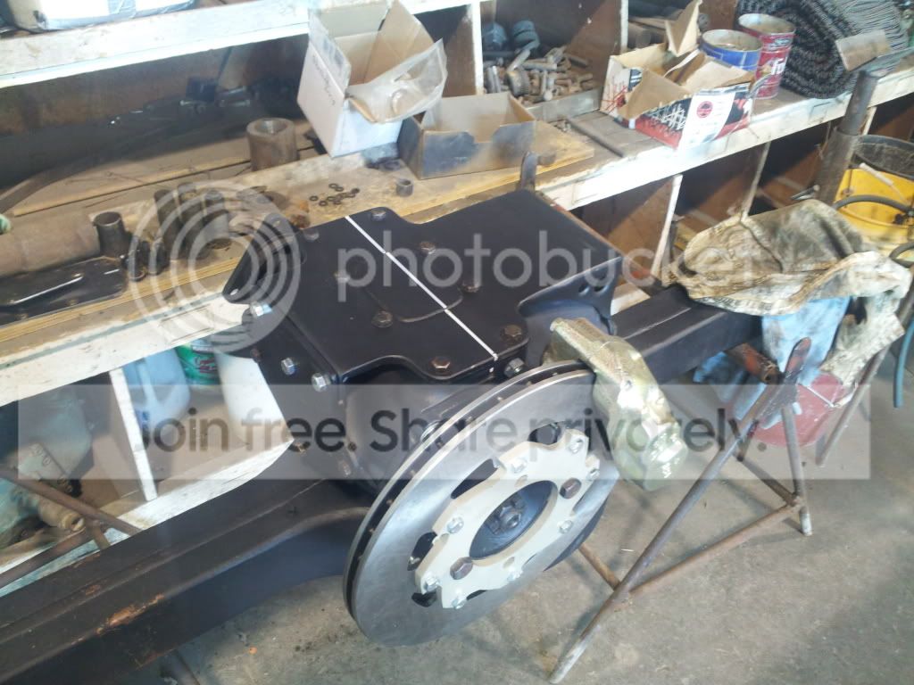

Here is the front axle all ready minus link brackets and bolting on brake components. I guess I never took a picture with the hubs on and new hardware.

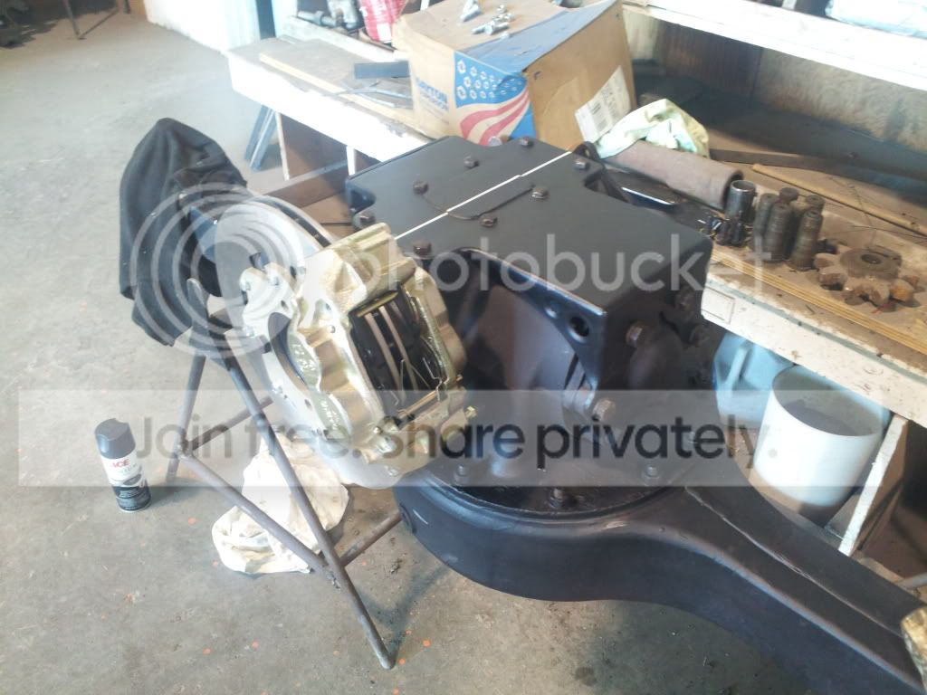

caliper wont blead air out on rockwell axle with bleader screw on bottom of caliper. :whistle:
Yeah I got that calaper cheap on eBay because I wasn't originally planning on rotating the 3rd but later on decided I was going to have to. I was still able to use that calaper to mock up and proper shim the bracket though. I ended up flipping the front bracket around so that calaper would work for the guy that bought those axles.
