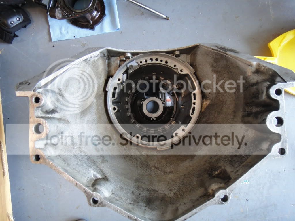

the governor assm looks different from the 1st vid to the second vid. the angle of the flyweights is different, and the gear itself looks a different size.
same or different?
Ok...damn you Scott-
One of these days I'm going to learn to trust the man when he tells me something is either wrong or right with my truck...He's been schooling my ass like this for years.

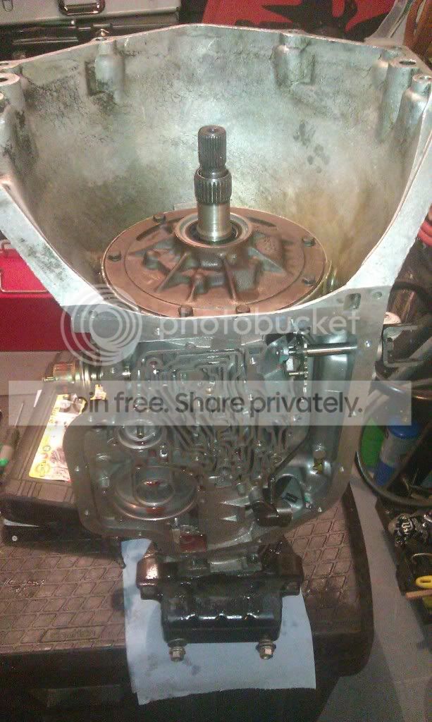

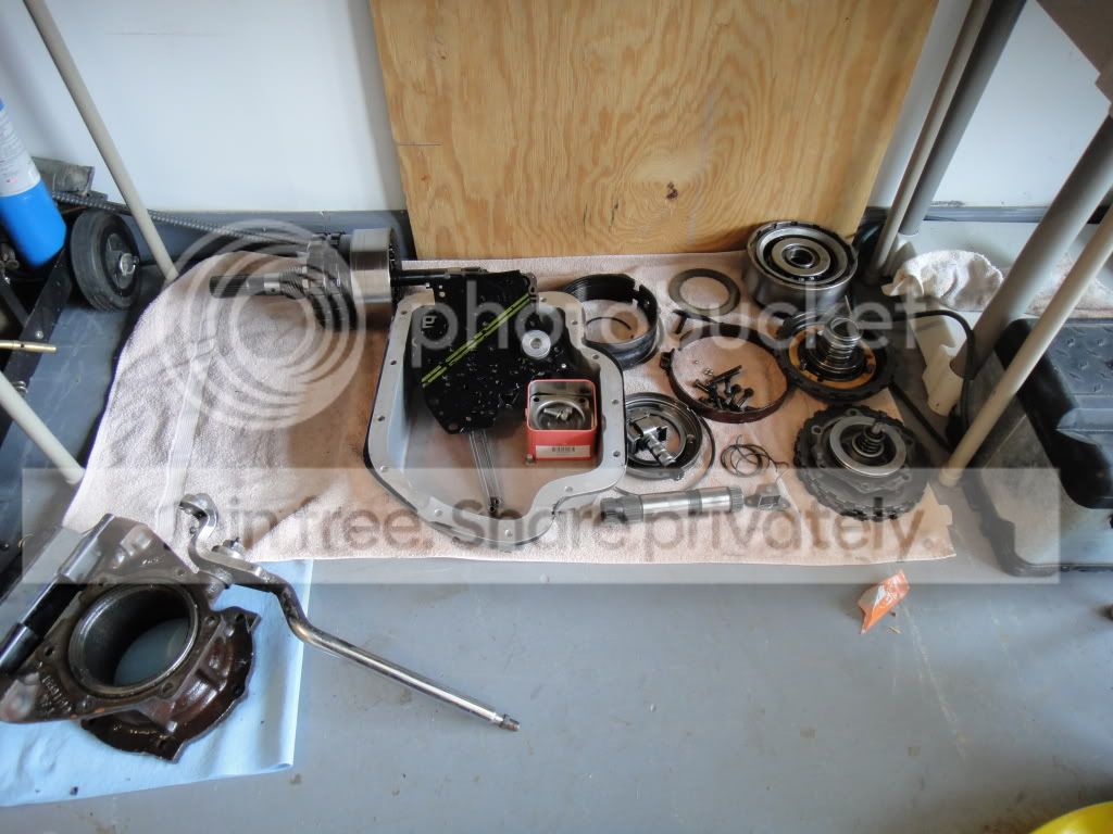

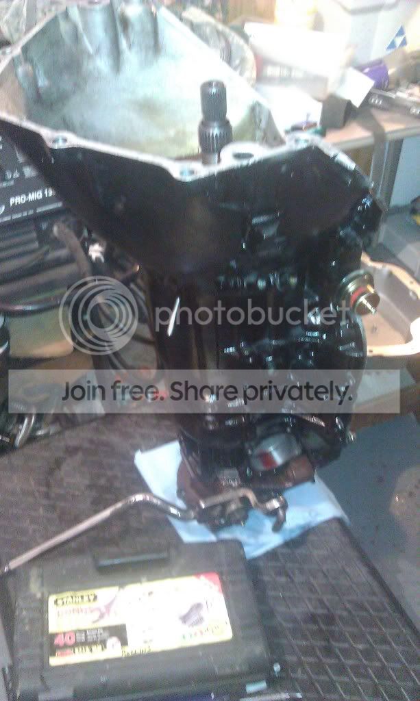

I'm not too worried about it...There's about 10 bazillion parts inside one of those things, but that ATSG manual breaks it down almost barney style. No problem.
What kinda goodies di'ja put in it?
As far as rebuilding the internals, everything stock. Clutchs, steels, sprag etc, all stock still. The valve body got a Trans-Go 1-2 reprogramming kit and bigger holes drilled in the separator plate. I have a TCI deep aluminum pan, installed an Autometer trans temp gauge and will have a Hurst V-matic shifter when it's finally complete.
