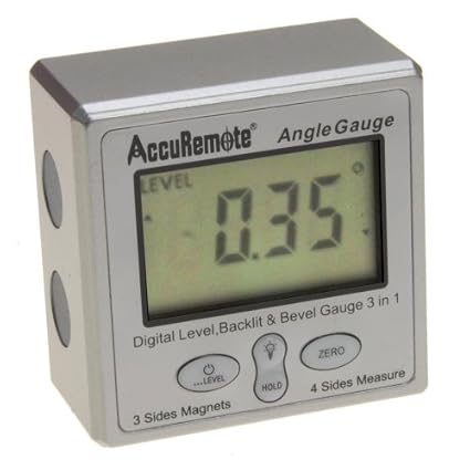

Get yourself one of these, I have found they are much more accurate than the little needles protractors and are still pretty cheap...
Angle Cube
I got one and love that little sucker .
can set your own zero point then use as regular .
so even if floor / work area is unlevel . zero it to that plane and use as normal .
Neat little tool for sure. Setting your own zero point is a cool feature. Craftsman has a few interesting digital levels/angel finders too. I used to have one that had a laser pointer in it too, that was pretty handy.
Although, I already have a normal dial/needle angle finder that works just fine...if you pull angles from the right places. :doah:
Angle Cube
