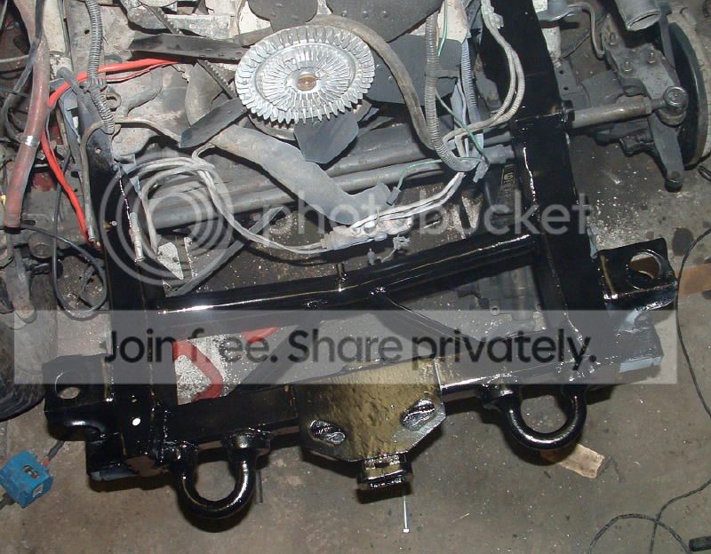

One thing I have become fond of doing is ditching that ugly huge crossmember that splits the steering box bolts I hate that thing. Pretty easy to make a clean crossmember up there.
The only reason I do it usually is to box that part of the frame in so steering box cracks are gone forever
My steering box is relocated about 4-5" down from the factory location, to bring the drag ling angle down to the best angle possible. (8" front springs make for a lot of work to make it comfortable to drive.) That fixed a bunch of things, bump steer for example. I am only re-using one of original holes on the frame, to locate the box in more or less the proper place. I had fabbed up a mount for it, hanging below the original, but I didn't do it right, which lead to more frame cracks and rushed fixes etc. So I want to fix it properly and permanently, like you mentioned. But I'm going to leave the big ugly one on there. If steering box was still in factory spot, I'd probably do what you said and/or somthing similar to those pictures. But, as it is now, it makes a handy spot for the brake valve, hard lines and a place to mount other little things.
