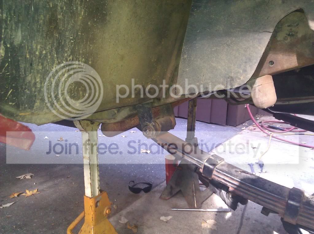

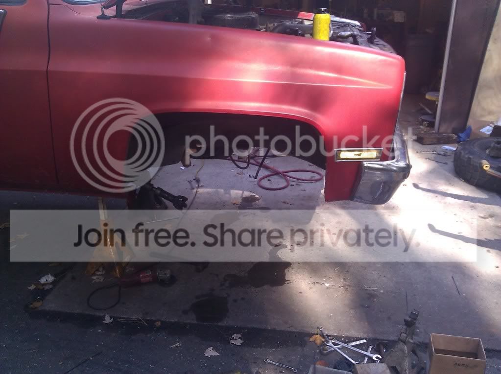

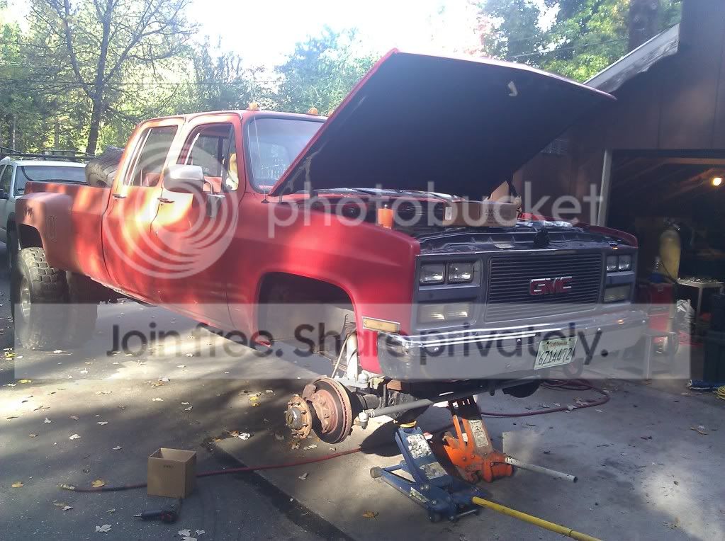

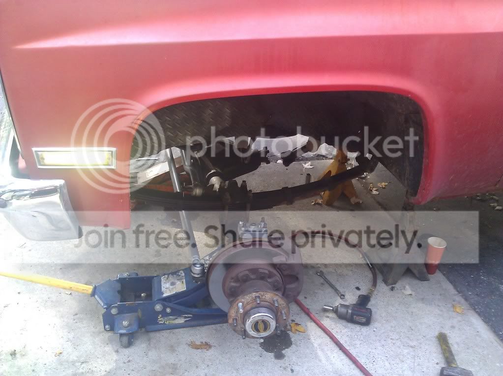

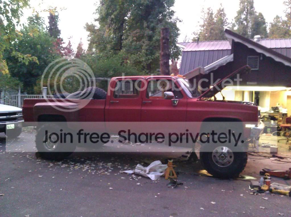

This is how it looked at about 0830 this morning-

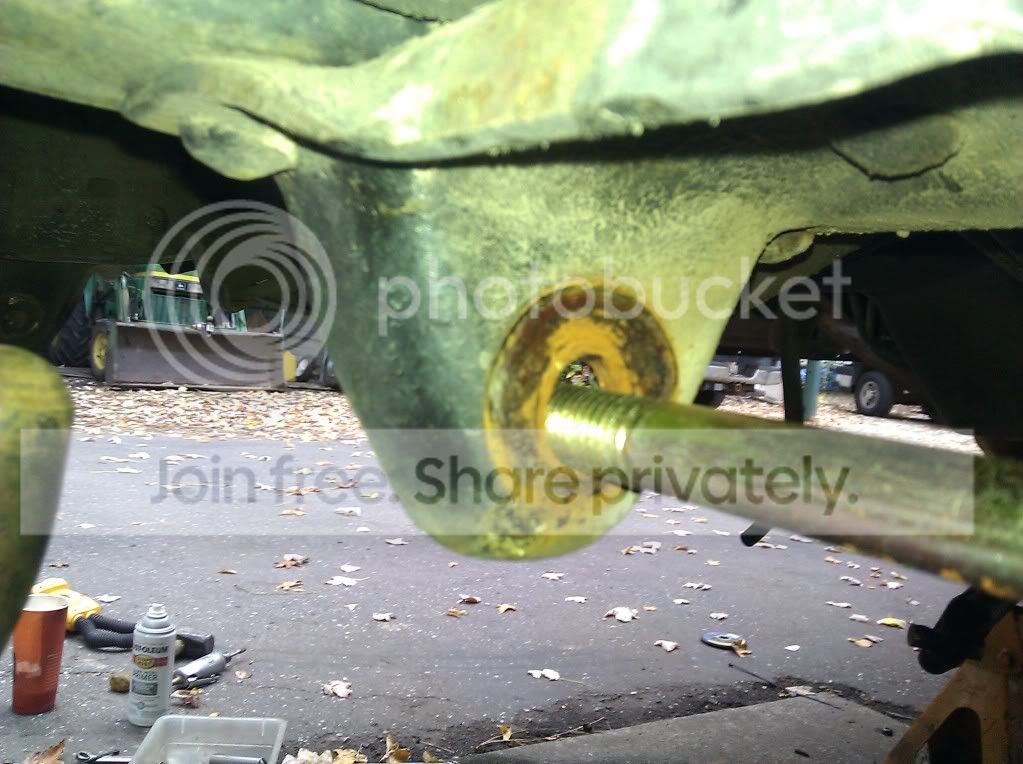

This shackle side and bolt wouldn't come loose from the sleeve, so I cut it off-

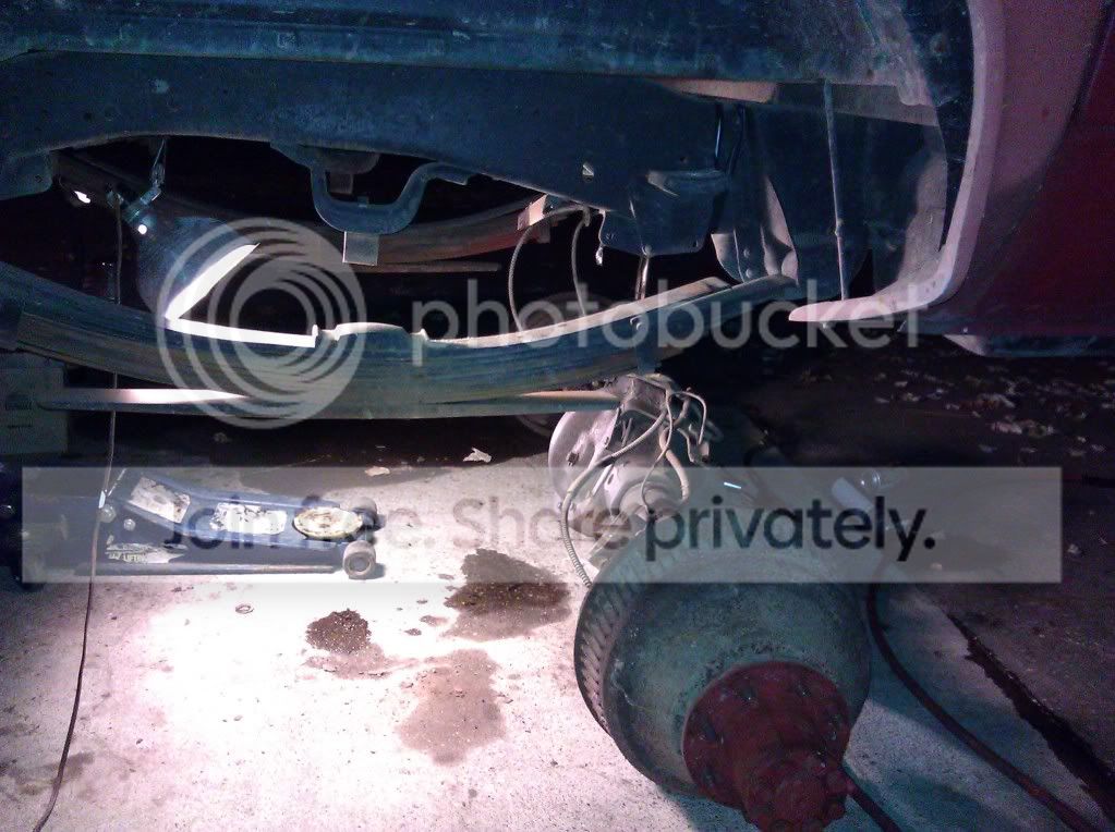

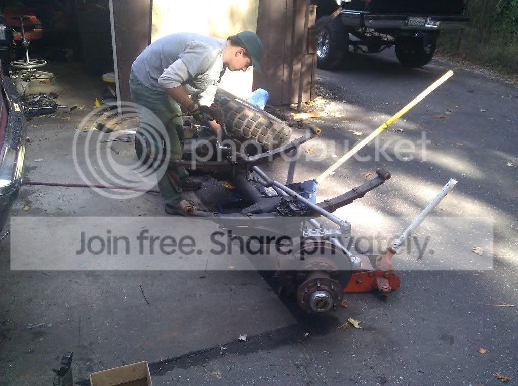

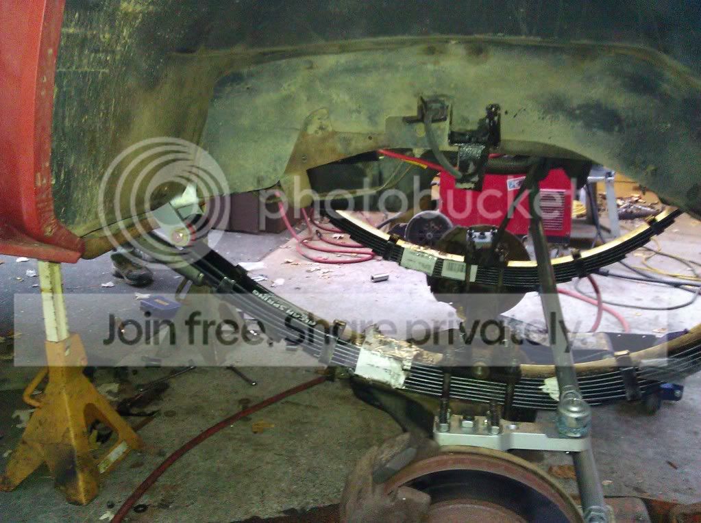

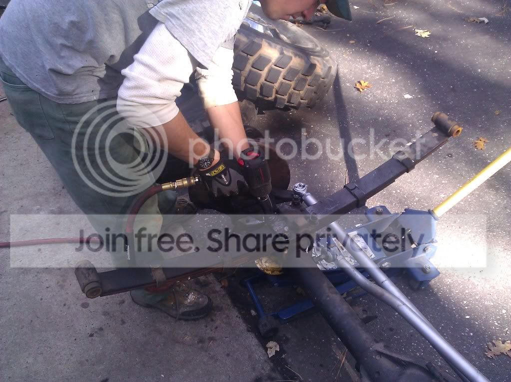

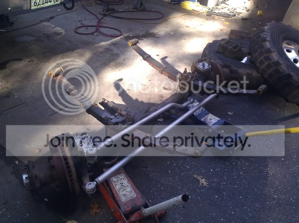

Axle/springs removed-
My buddy Joey removing the old springs-

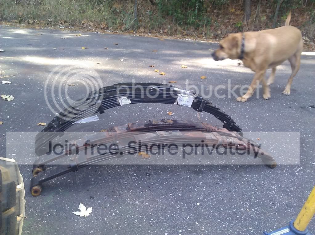

Old springs next to the Alcans-

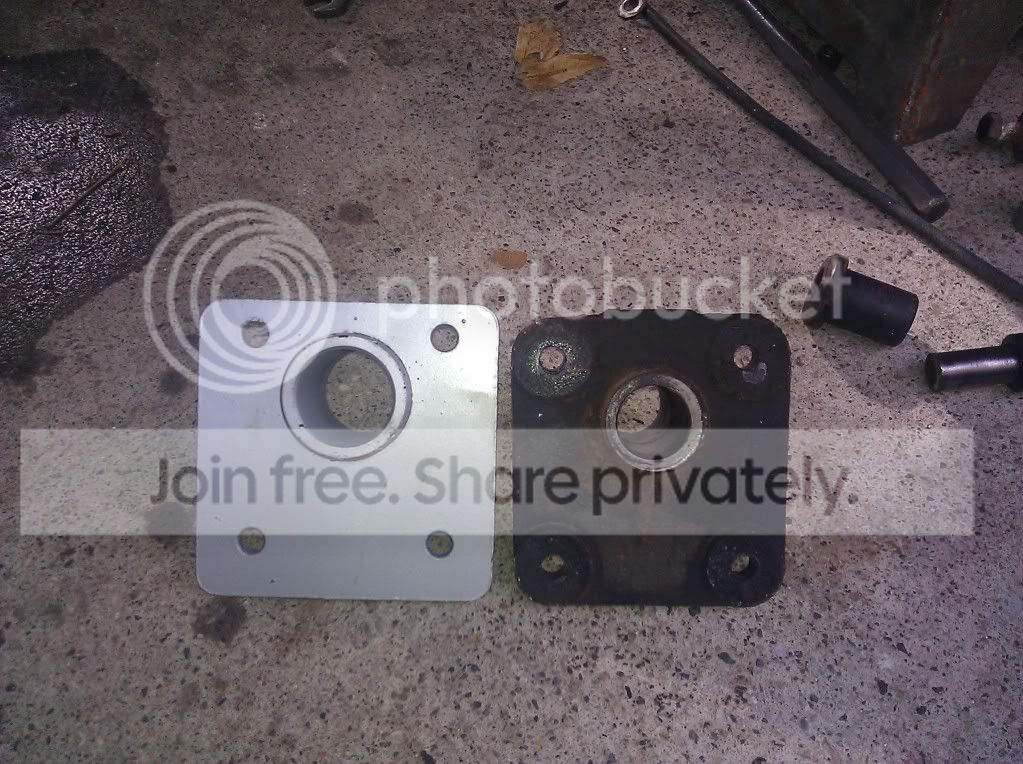

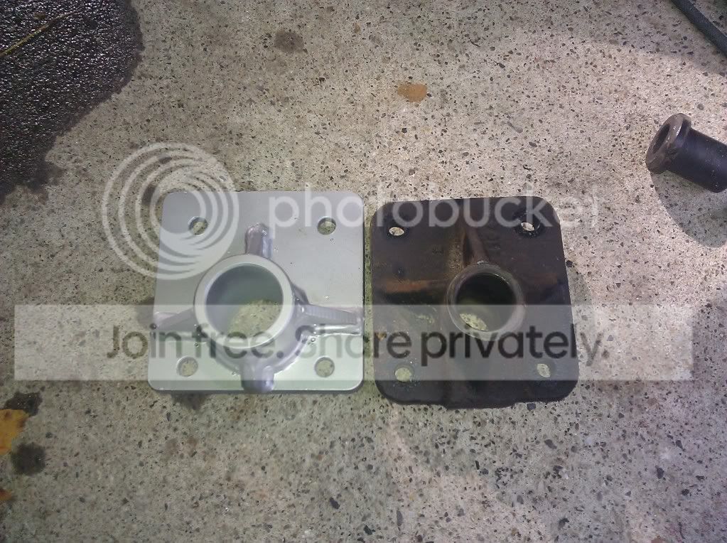

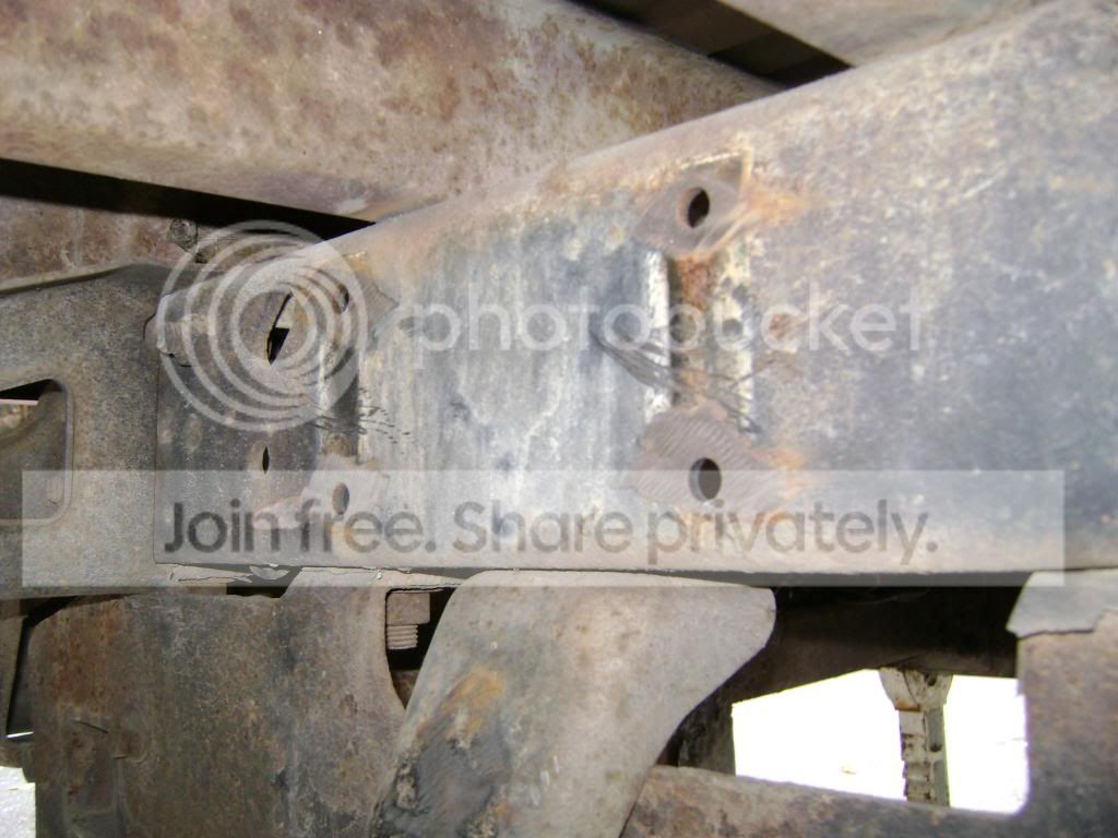

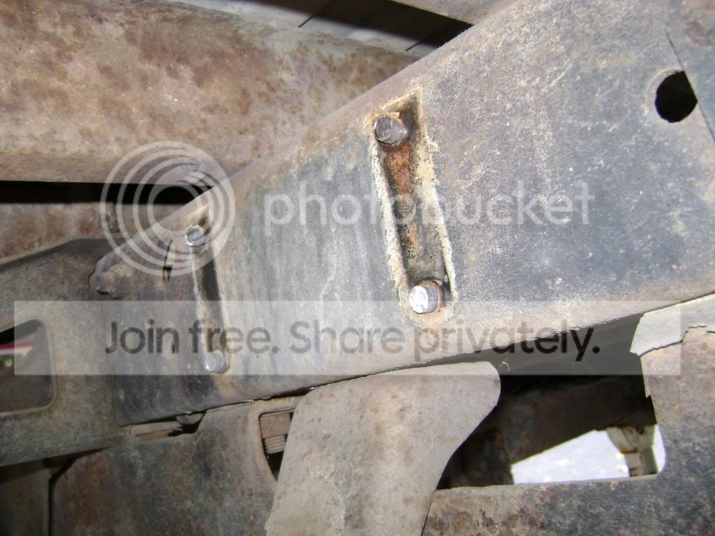

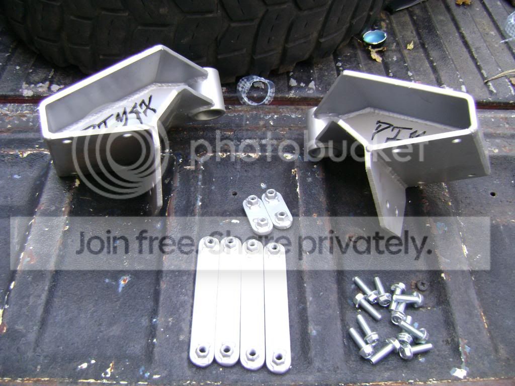

DIY4x front shackle frame eye hanger compared to the stocker-

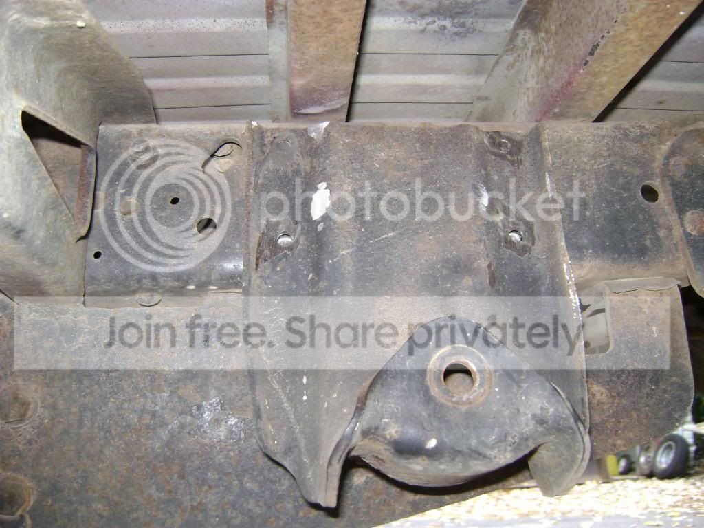

Where the stock frame eye hanger came from-

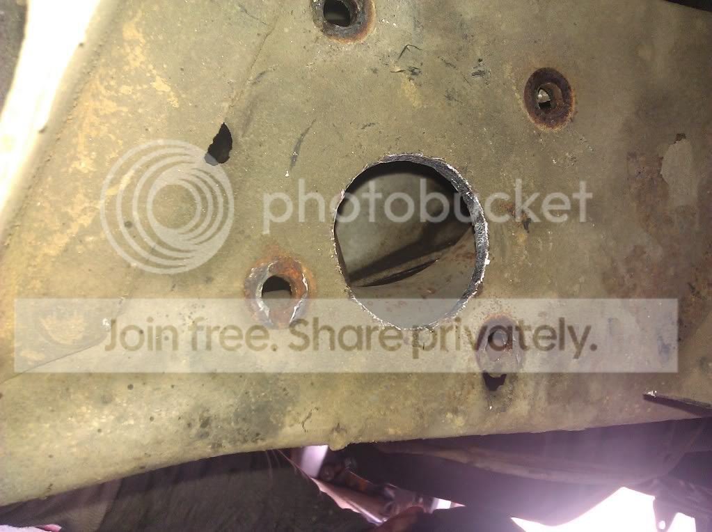

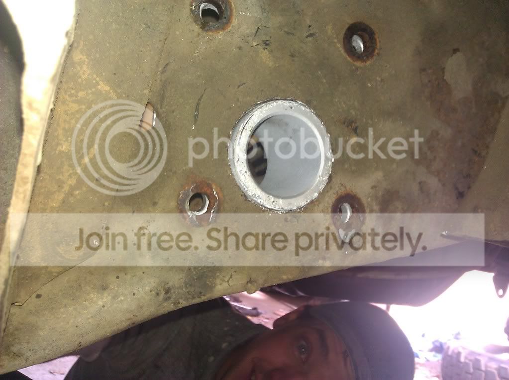

I used this to enlarge the hole for the DIY part-
Modified to fit-

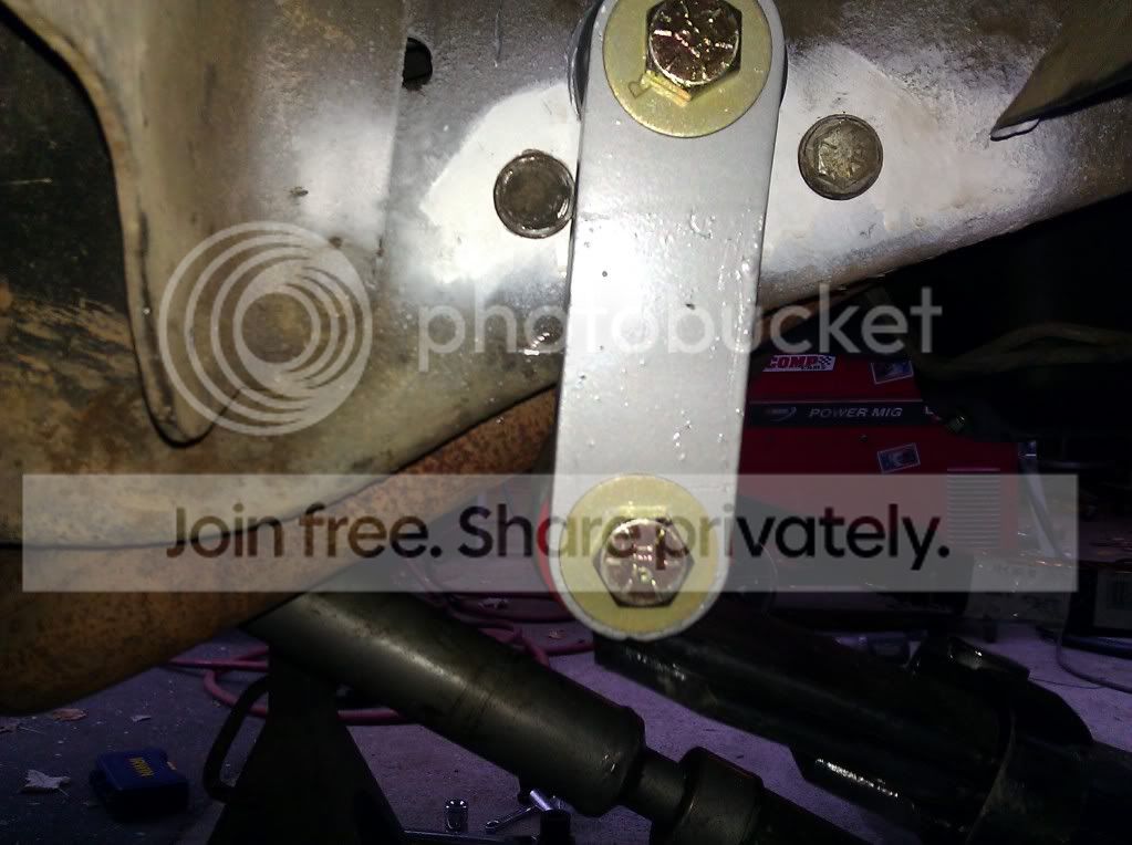

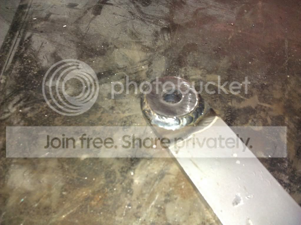

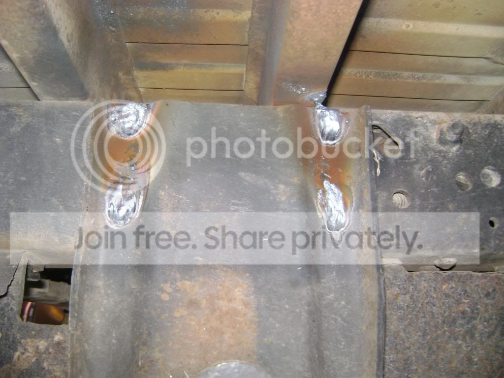

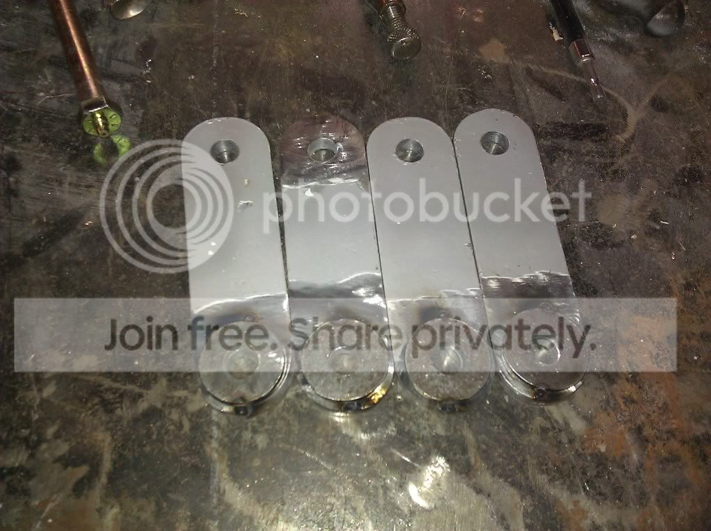

DIY shackles with DIY thick washers tacked on and welded-

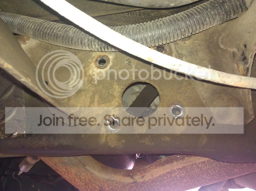

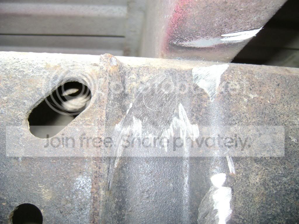

I discovered this when I pulled the springs from the front hangers. 5 mins with the welder and die grinder and that was fixed.

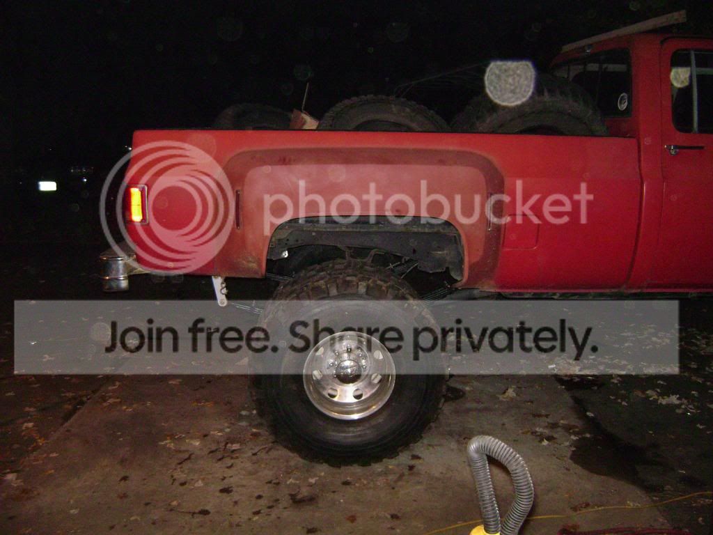

Schackle angle with full weight on the springs-

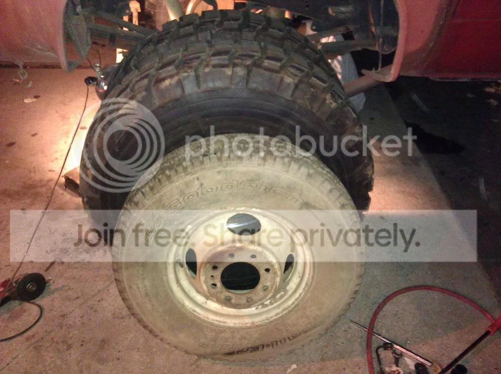

Tires mounted-

And this is how it sits as of 2130, minus the springs. I forgot to snap a picture after they came out.

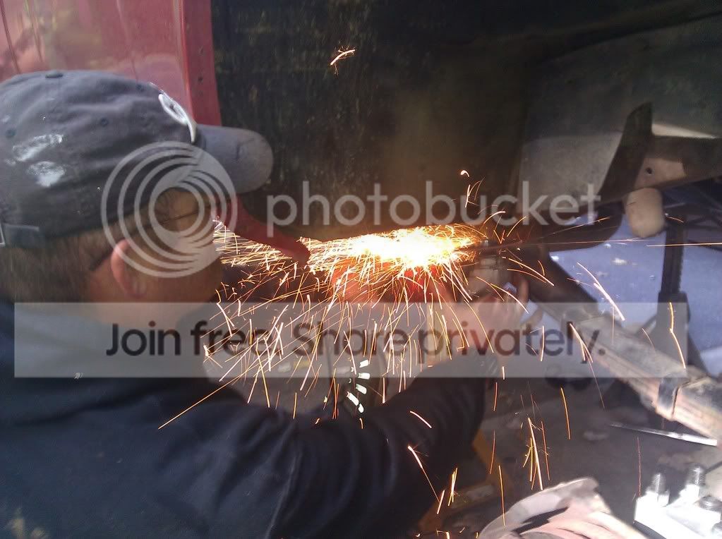

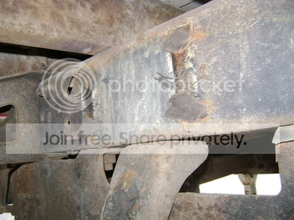

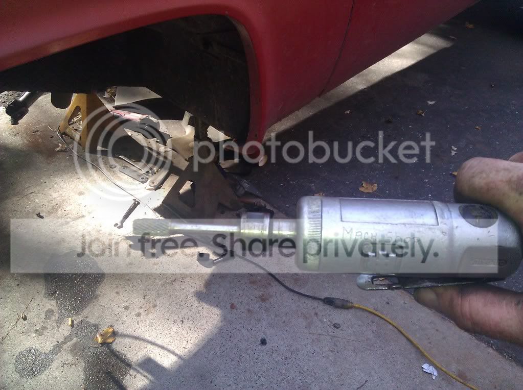

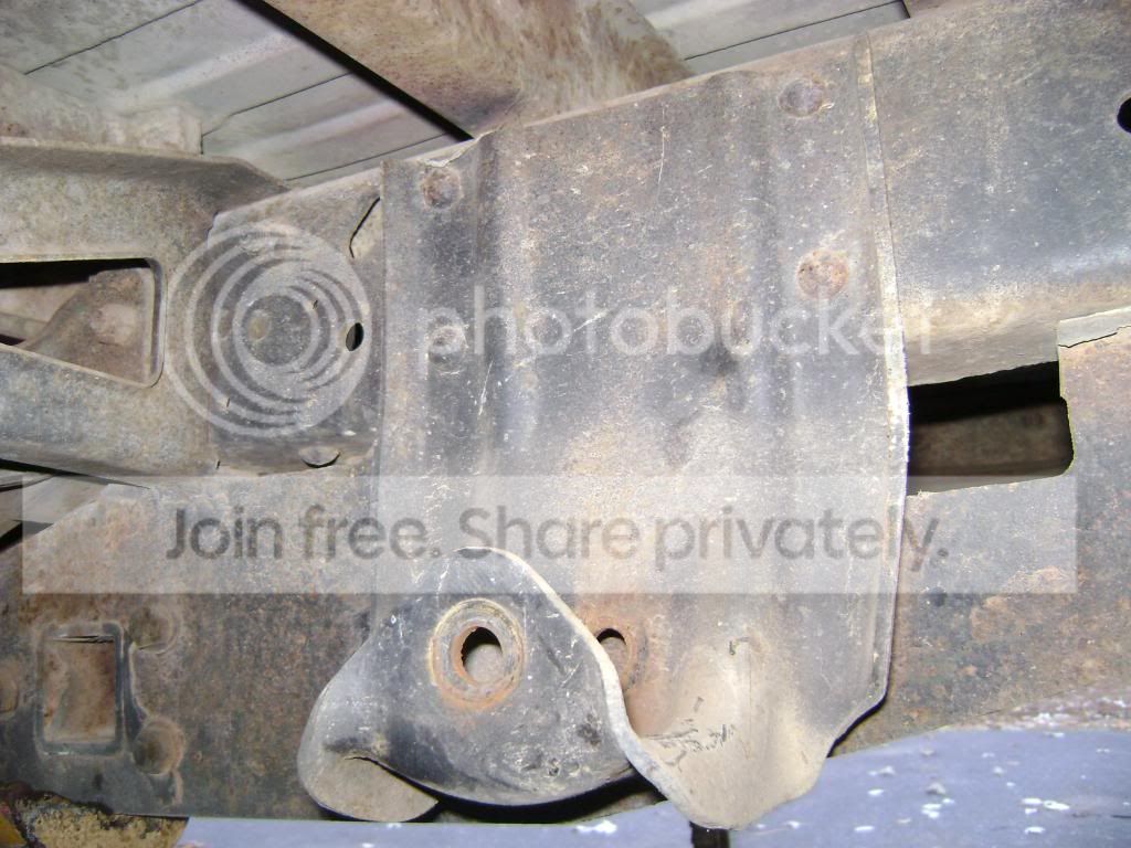

This is where I started. Rivet removal.
After about 15 mins with the grinder-
Exactly 6 whacks with the hammer-
Another few minutes with the grinder-

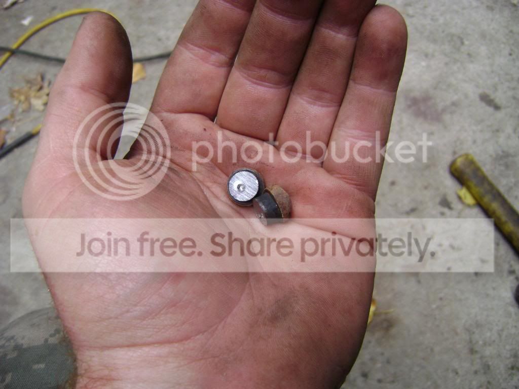

Knocked out what was left of the rivets with a hammer and center punch-
All in all, using the grinder method, it took about an hour to get the passenger side brackets removed from the frame. Not to mention laying in weird positions trying to get the right angle with the grinder to get at the rivet heads and the resulting sparks in my ears, nose, in my socks and a lot of bitching and cussing about it.

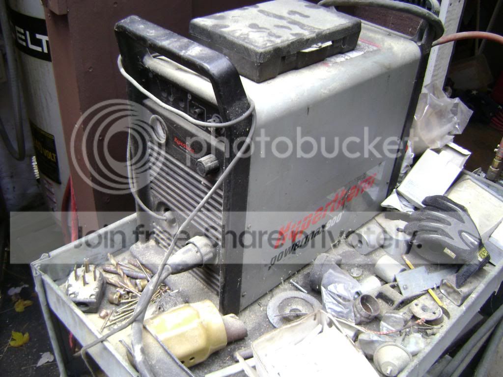

No way I was going through that again for the drivers side, so I cranked up the hypertherm-
I was completely done with the drivers side in less than 20 mins.

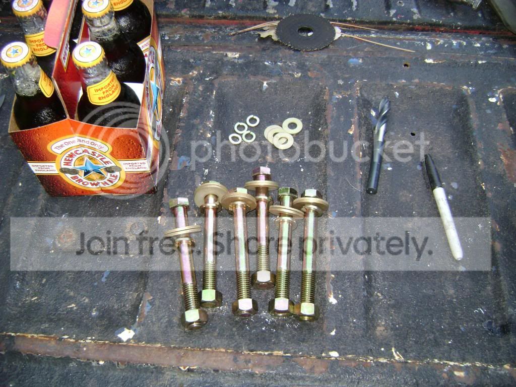

You're lookin at $48 worth of grade 8 hardware, and a $8 sixer of Newcastle-

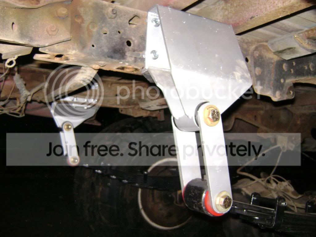

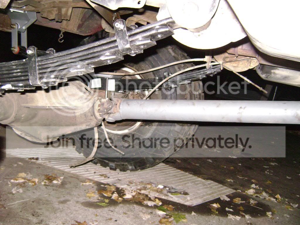

Everything installed. Not really sure how happy I am with the shackle angle. I'll have to drive it around a bit and see how it rides. If I have to, I'll relocate the DIY bracket forward a couple inches to adjust the angle a bit.

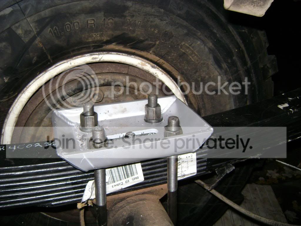

DIY spring plates-

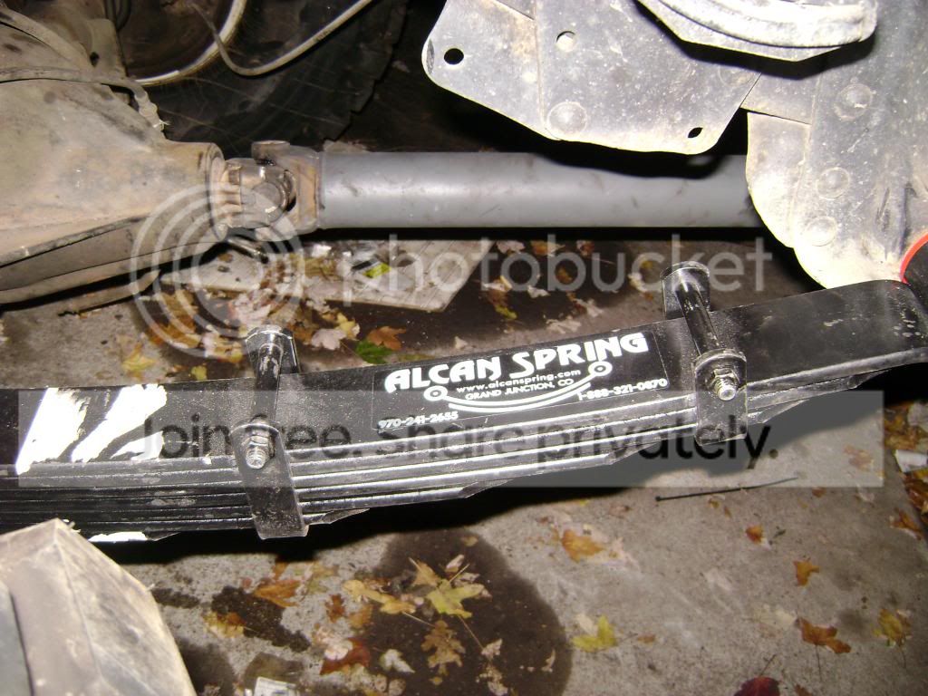

Alcans-
If anything, the pinion needs to come down-
I ended up mounting the Alcans opposite the way the stock springs were mounted. At first I mounted them with the short side forward. Got all the way done, put the tires back on, and cracked a beer to celebrate. Stood back to look and it just didnt look right. Tires where waaay to far forward in the wheel well. SHiiiiit. So I had to tear it all the way back apart and flip the springs around. I can't even tell you guys how bad it sucks doing that twice when you're working by yourself. I was pissssed. Had to take a walk, have a cigar and another beer. It worked out better I think. Axle located slightly rear of center, as you can see by the picture.

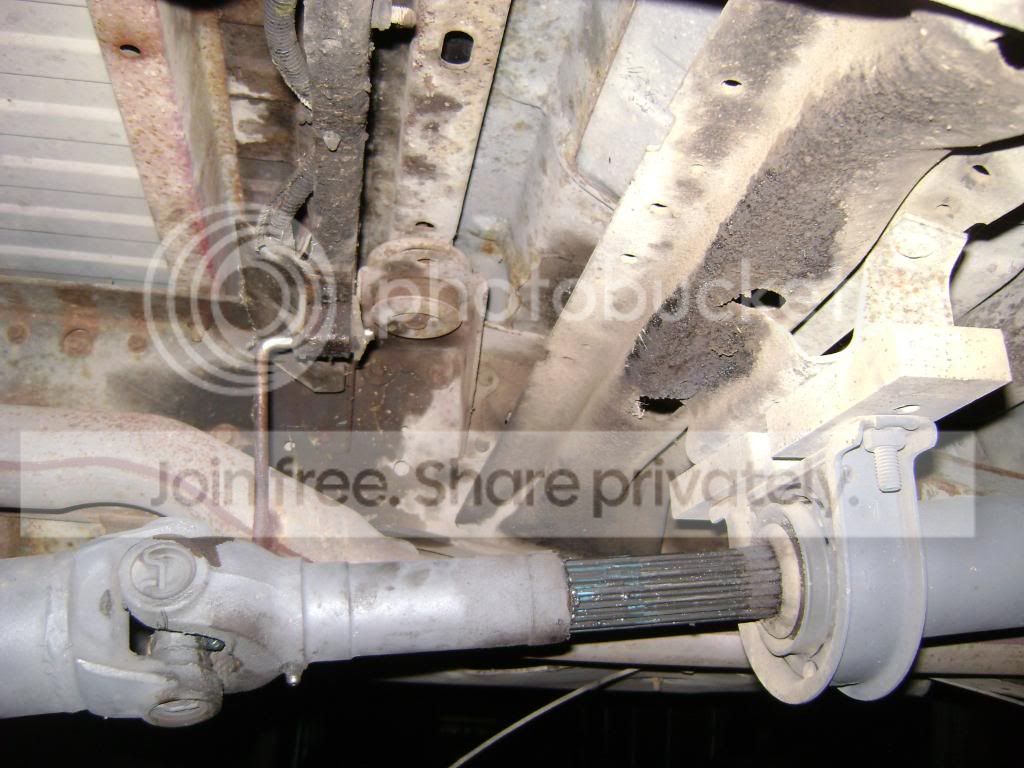

The down side to that. I''ll be taking a ride up to High Angle Driveline sometime this week to get the rear half of the drive-line lengthened. A little more than 1.5" of spline engagement-
The front shaft wasn't even close to usable. I could have extended it out enough to reach the yoke on the 60, but the angle was so severe, if I had engaged 4x4, the cv would have exploded almost instantly, even on flat ground.

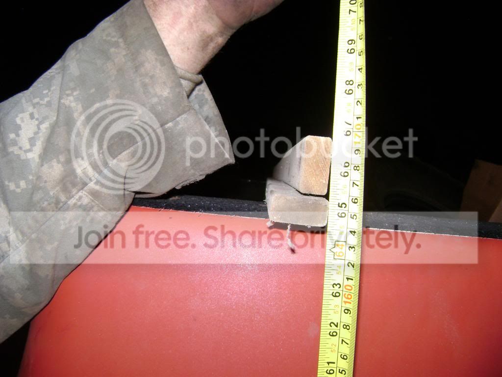

I'm 6'1"-
64.5" to the top of the bed rail-

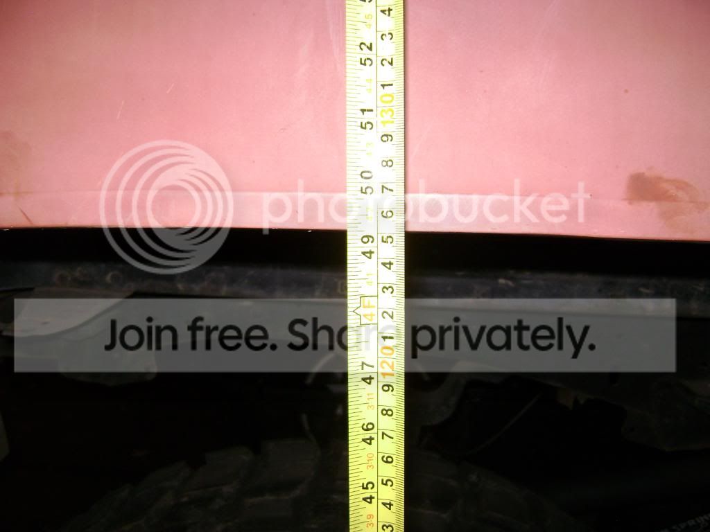

49" to the top of the rear fender opening-

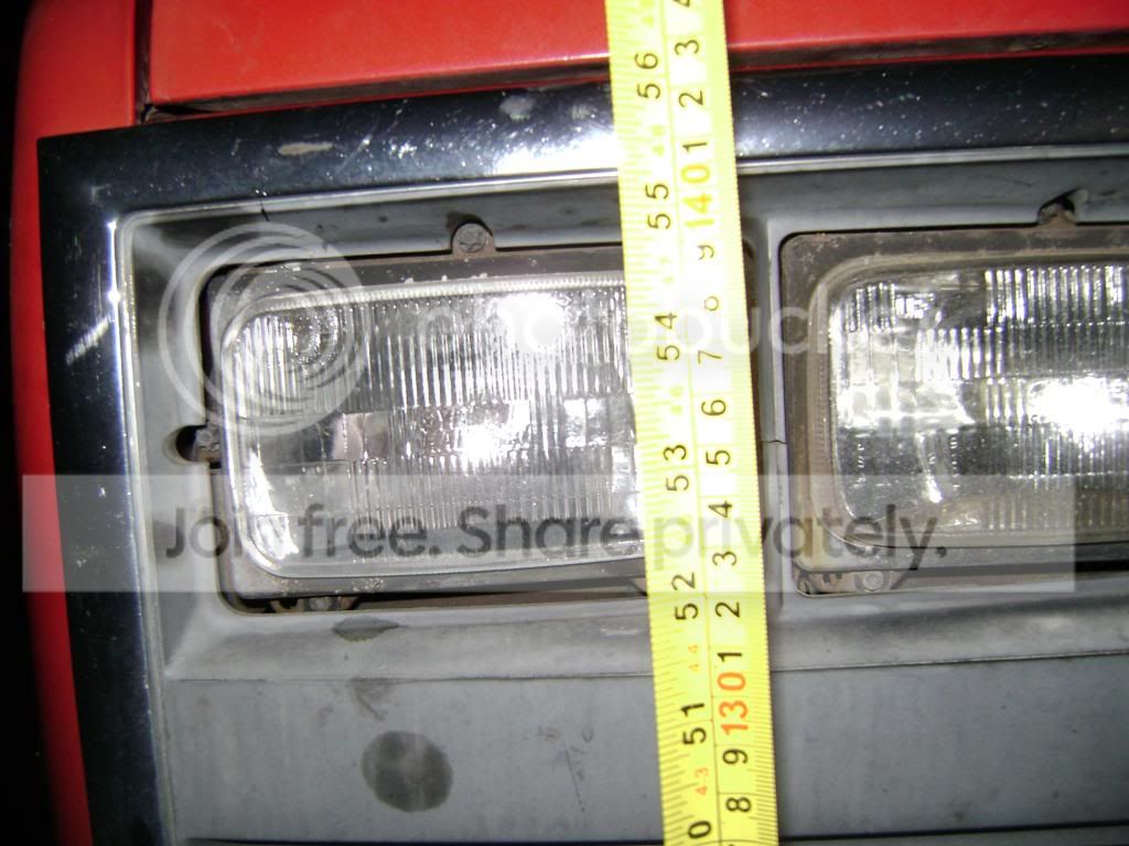

53.5" to the center of the headlight-

Looking at the flip brackets, it looks like they are on the wrong side. Is it just an optical illusion or could switching sides get you a better shackle angle?
The truck looks awesome:thumb:
Truck looks awesome!
Maybe I missed it, but how long the are Alcans? It looks like the shackle flip is mounted backwards, flipping sides should correct your shackle angle.
It looks the same to me as well. There's about 1" of offset built into the brackets from the looks of it, and it looks like swapping them around would move the upper shackle bolt a total of 2" forward.....just about perfect to fix that shackle angle.
:thinking:
I agree, if you switch sides on the flip it will improve you shackle angle but it will also move your tire back farther. I hate to be the one to say it but it looks to me that if you switch the springs back and switch sides on the flip your tire will be very close to the center of the wheel well. On the bright side it may keep you from having to get the rear drive line lengthened.
