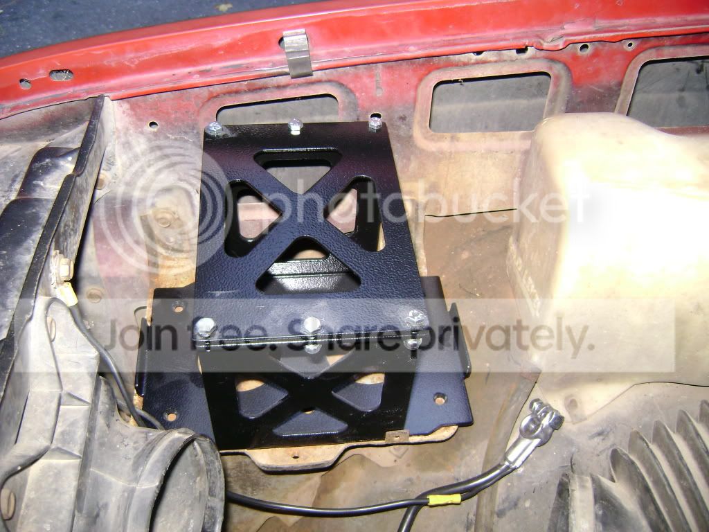

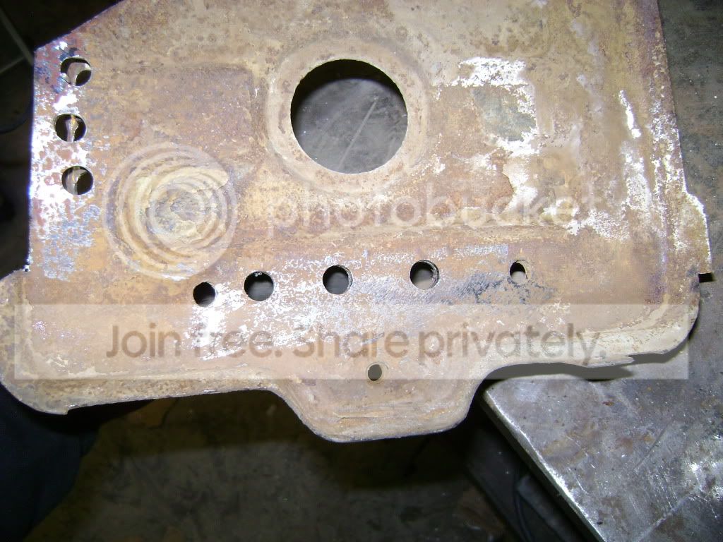

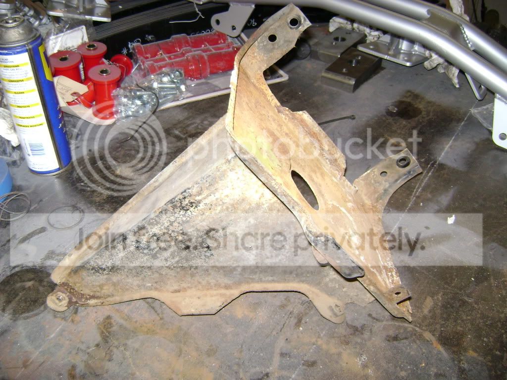

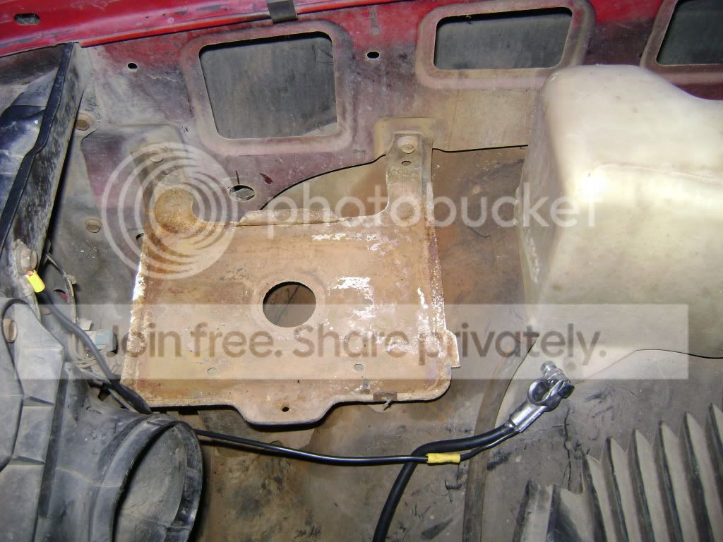

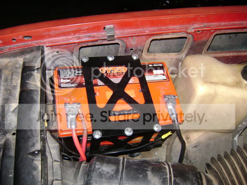

I got a little bit done today. Nothin major, but it needed to be done. I bought this bad ass battery tray for my Odyssey PC1750 from a vendor on Pirate-
http://artecindustries.3dcartstores.com/Odyssey-PC-1750-Battery-Mount-_p_121.html
Today was 'fab a battery tray mount' day.
I'll let the pictures tell the story.

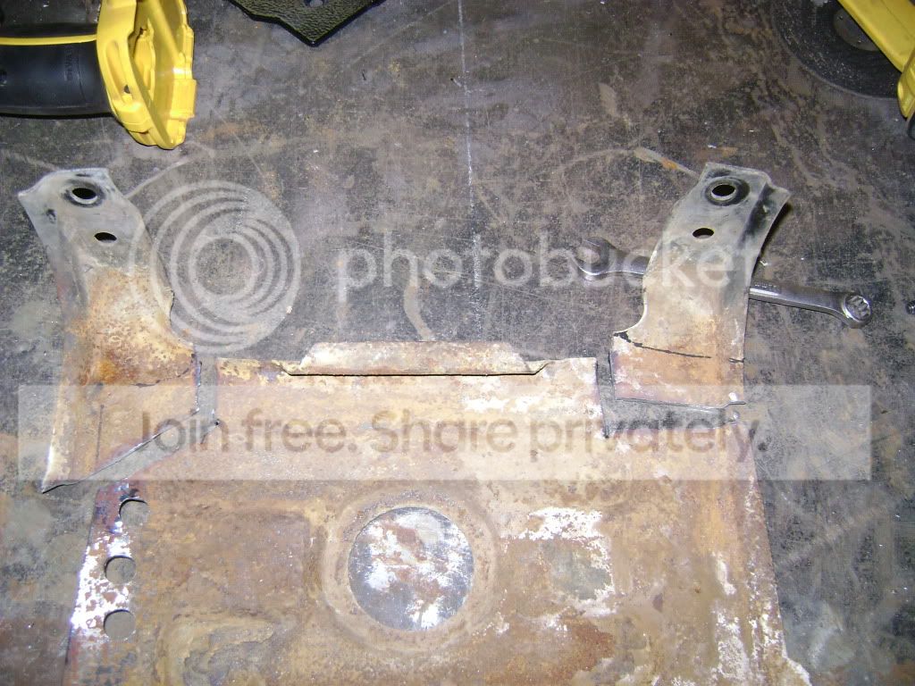

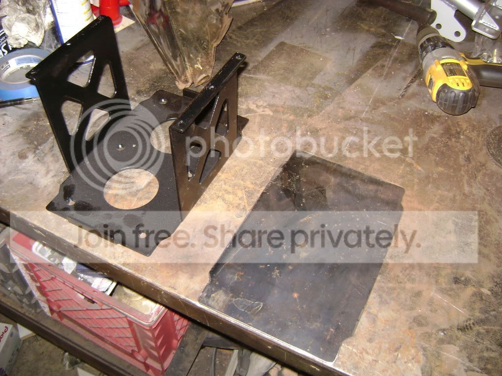

This is what I started out with. As you can see, the Odyssey is waaay bigger than the stock battery tray-
Stock tray-
The idea was to make this fit in the stock spot-

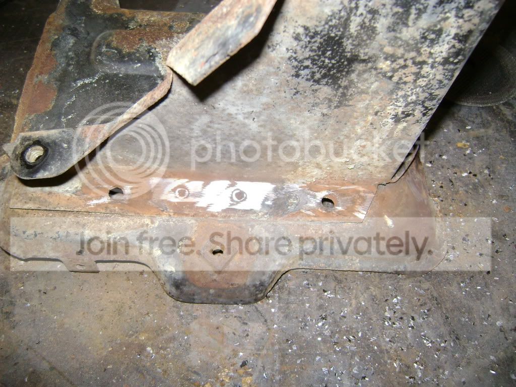

I decided to use the bottom half of the stock tray-

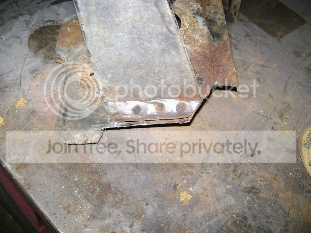

So the top half needed to be removed. Had to drill out the spot welds-

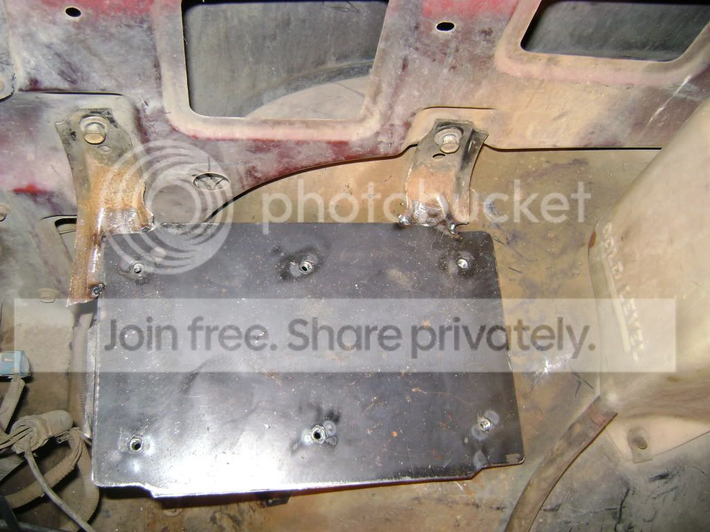

Here's the bottom half mocked up in the truck-

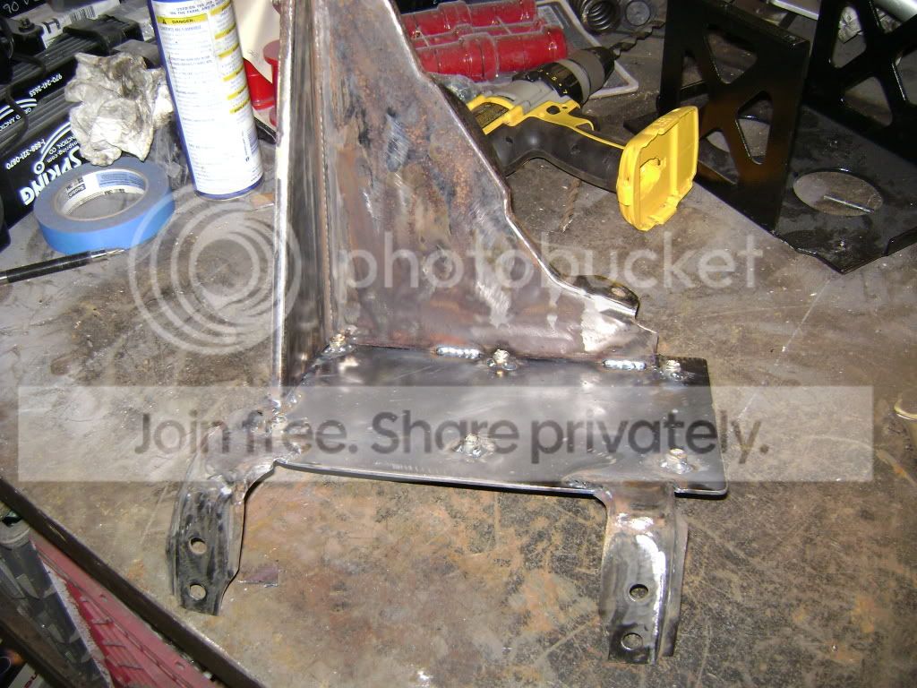

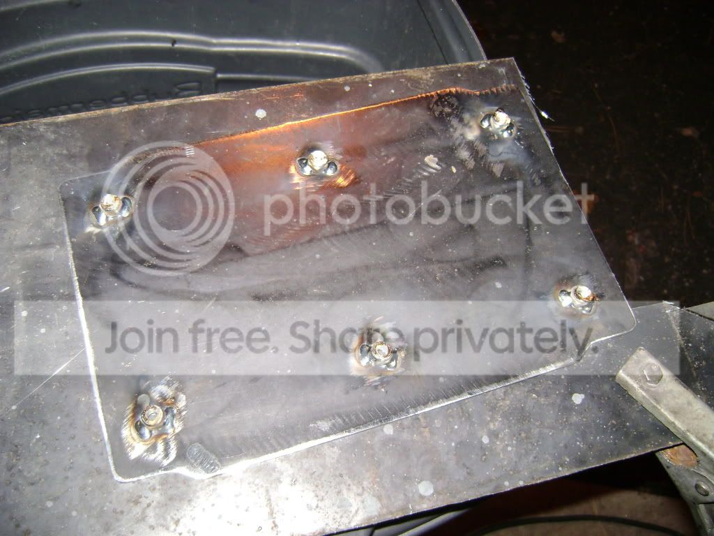

I cut a piece of 1/8" plate to match the bottom of the Artec tray-
Drilled holes and welded nuts to the bottom side-
Then welded the plate to the bottom half of the stock bracket. No pictures of that.

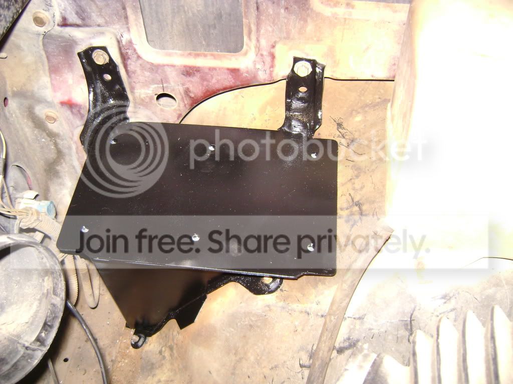

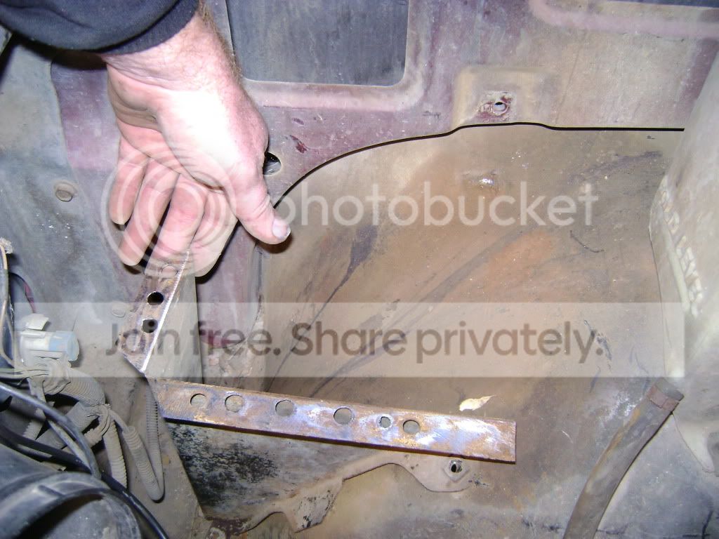

Rather than try to re-invent the wheel trying to come up with a way to tie the tray into the fender mounts, I decided to re-use the the appropriate pieces of the stock tray-
Rough mock up. Tacked brackets to tray. It took a small amount of grinding/cutting/fitting of the brackets to make them work-
Fully welded, fitted, ground and de-burred-
Painted and bolted in place-

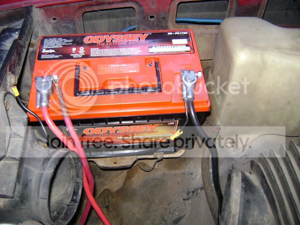

Finished product. The Artec tray is bolted to the me-built tray with counter-sunk allen bolts-

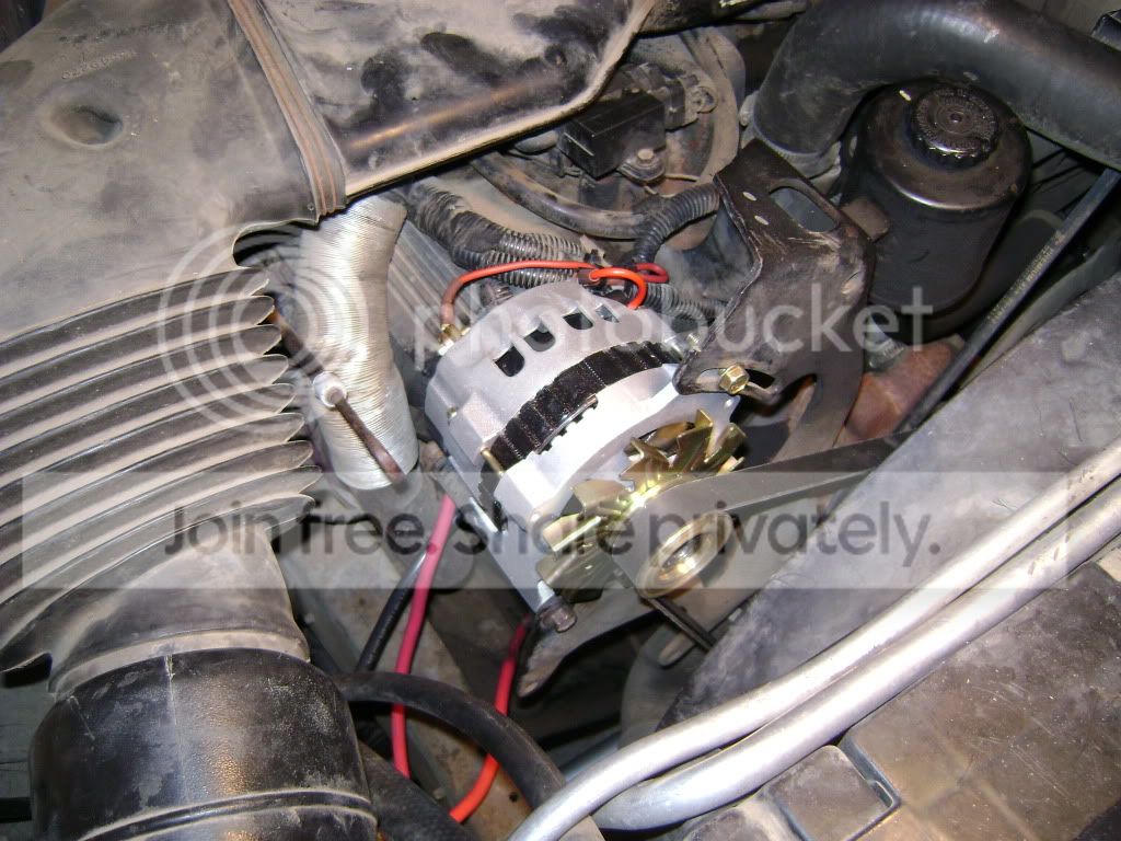

And the 140amp Power Master alt in place and working-

Looks good. I think you will like that battery. Its the same brand I have in my truck.
I have the next smaller size so it fits my tray.
It puts out some serious amps.
I replaced an Optima that I thought was in good shape with it, and found out my starter was good after all.:D
I had thought it was dragging and needed replacing.

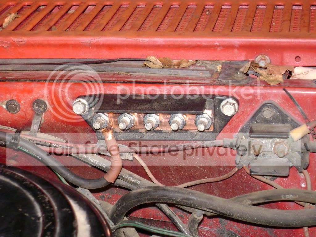

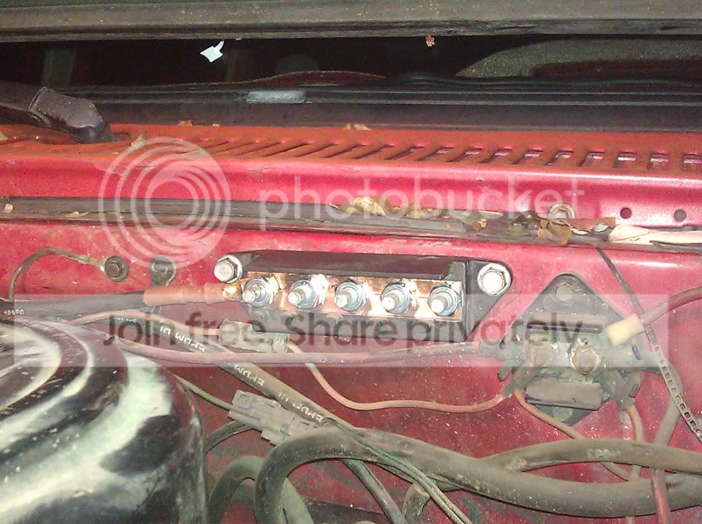

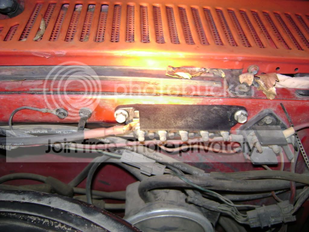

I picked up a couple of these 5 post junction blocks at the junk yard the other day. From the passenger side firewall on the '92-'98 body style gm trucks.
I wanted something similar to the original two post junction block on the firewall, but with more posts for future accessories and a cleaner look. Having a big fuster cluck of wires hangin off the battery looks ghetto as hell. Since these were just junction blocks and the terminals weren't bridged, I cut and drilled a piece of copper to bridge all the terminals together. Then 10 jam nuts- 5 to bolt the copper bridge down and 5 more for bolting stuff down. Juiced it up with a length of 6g wire from the battery with crimped and soldered terminals, along with heat shrink tubing to seal it up.
I'm going to eliminate the stock 2 post junction block and wire everything to the new one. As you can see, the stock one is lookin slightly hammered. :eek1:

Two things. One, I hope that that hot wire is not as close to the mounting bolt as it seems in the pic.
Two, check out the last pic in post 17 of my "What Truck is This? thread here in the garage.
It looks a lot like your setup with a cover.
Of course yours probably came with a cover too you just left it off for the pics.
lol! I wondered who was gonna be the first to say something about that....It's not even close, the picture does make it look like it's touching. The hot wire is atleast a 1/2" from the mounting bolt. I'll go take another picture in a few minutes.
And no, they didn't come with covers. What you see in the pics is exactly how I unbolted them from the trucks in the yard.

I just went out and looked at how close that hot wire is to the mounting bolt. It was more like 1/4" and on a slightly higher plane-
But after poking and prodding at it a for bit, I decided I didn't like it. So I switched it around-
It doesn't look as clean, but definitely a LOT safer. Also, the terminal end fits perfectly between the two little plastic tits on the block.

They did make that junction block with a cover. I have one out in the shed.
