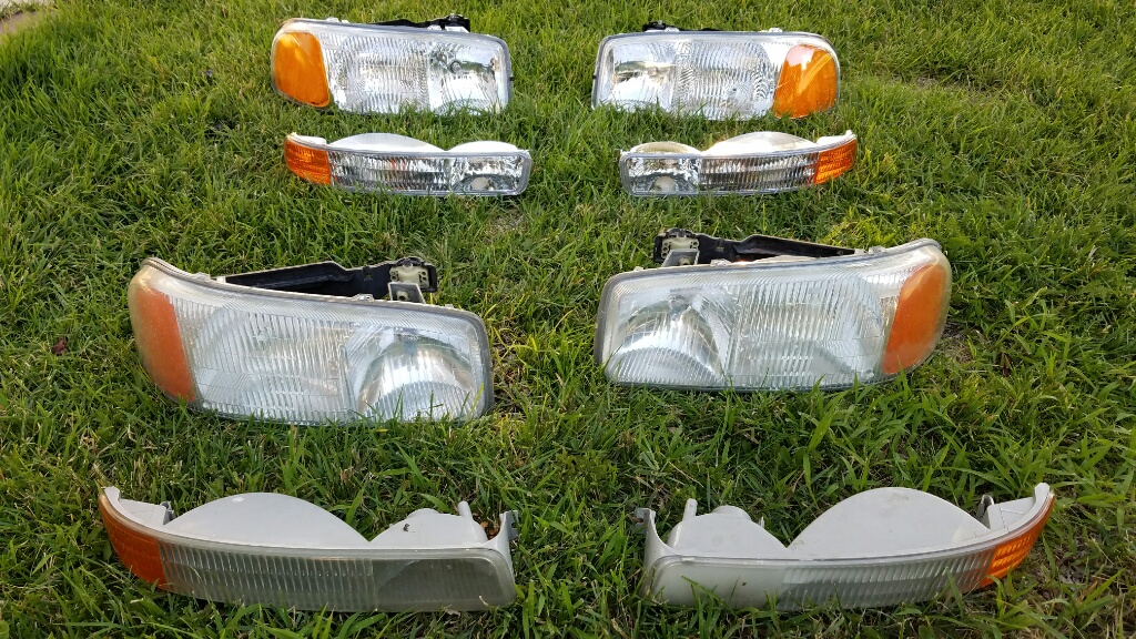

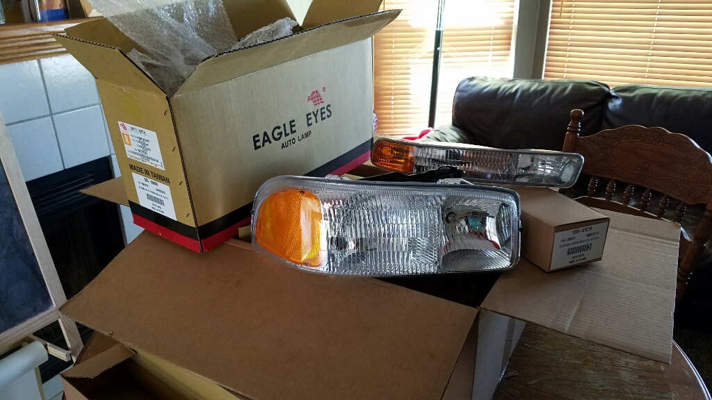

I also decided the cloudy headlights had to go so I picked up some new ones on amazon:
https://www.amazon.com/gp/product/B00UBFXSYE/ref=oh_aui_detailpage_o01_s00?ie=UTF8&psc=1
Gotta say, I was impressed by the quality. I'm guessing that the ones I had were not stock because the new ones seemed slightly heavier and better put together.

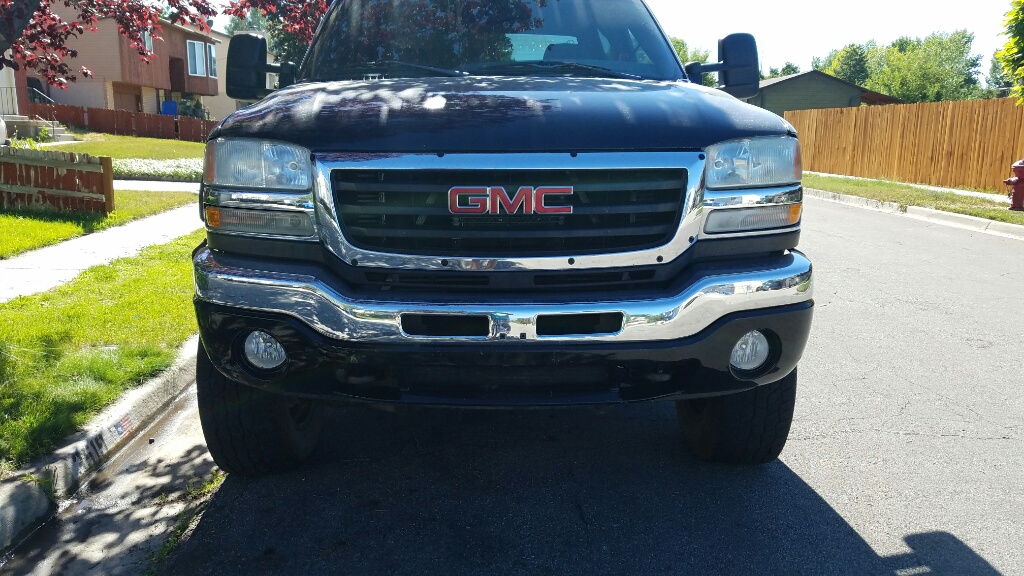

before pic:

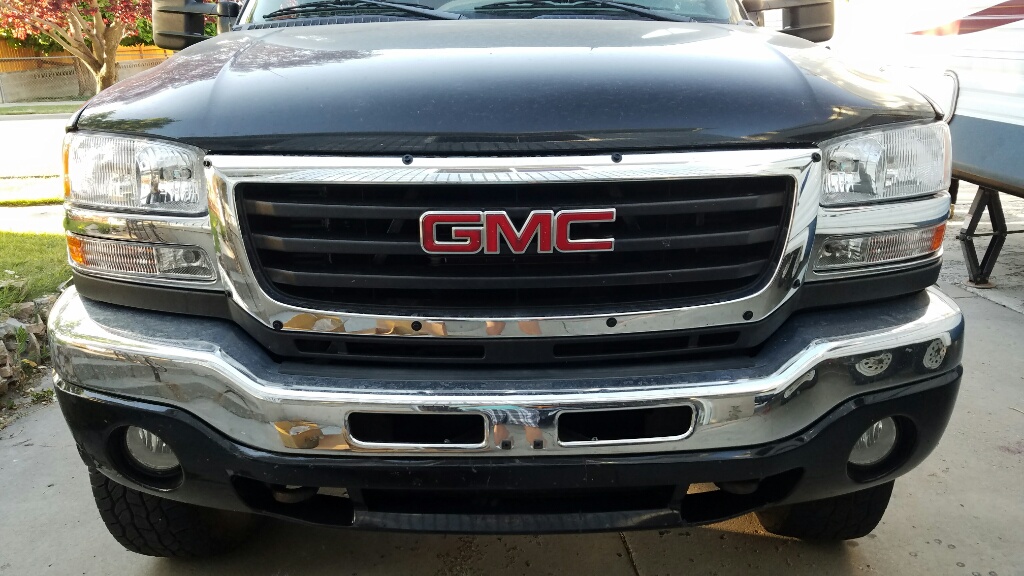

after:
New lights in back, old in front.

Those are they same lights we carry. I have replaced tons of front ends on Silverado's with those.
