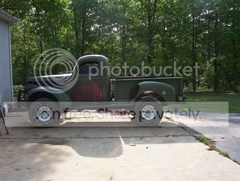

Are those rear tires the new mud slicks I have been hearing about?:D I hear they work real well.:dunno:;)
I guess that is just a bad pic, everyone thinks those tires are bald. They have about 19/32" tread.

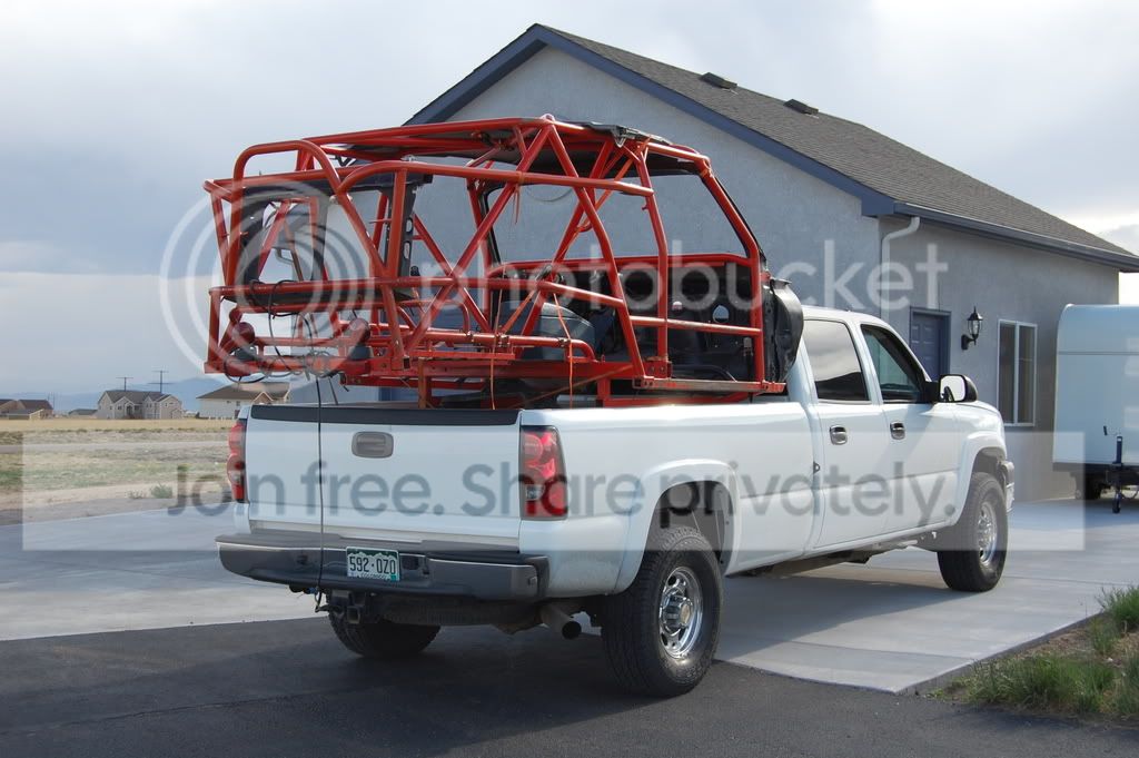

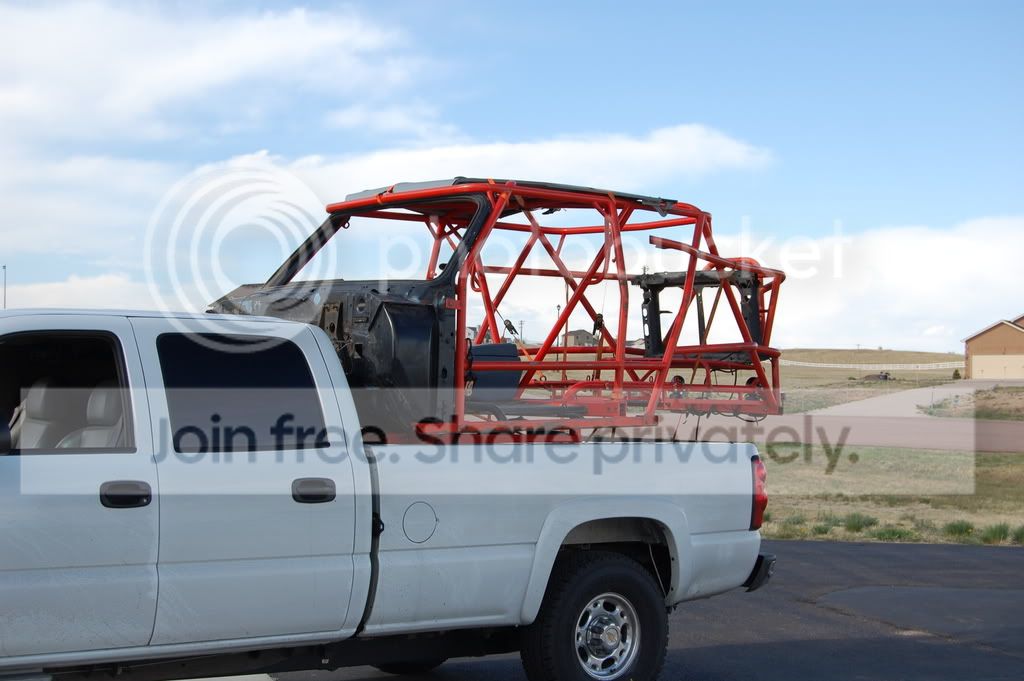

Cage was inside cab. truck now sits with bent frame and no axles.

There is nothing stock on my truck. The cab will be ridged to the gusseted frame with the exo-cage attached. The fenders would be in the way of the articulation.

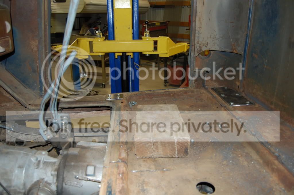

The rear plates are so big because the cab was split open by the original mounts. The floor has been welded, but I figure, why take a chance.

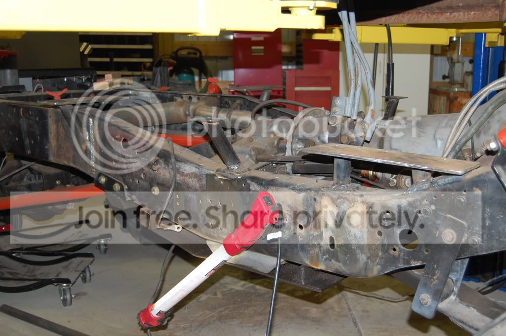

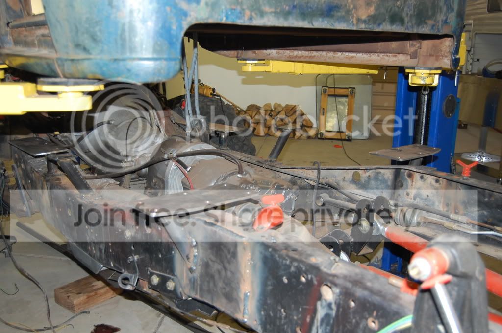

right side cab mounts.
left side cab mounts.
cab plates for seat hoops and interior roll bar
The truck as it sits.
