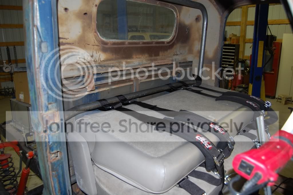

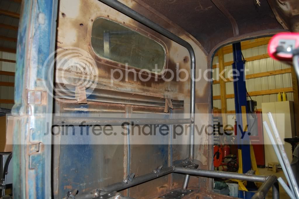

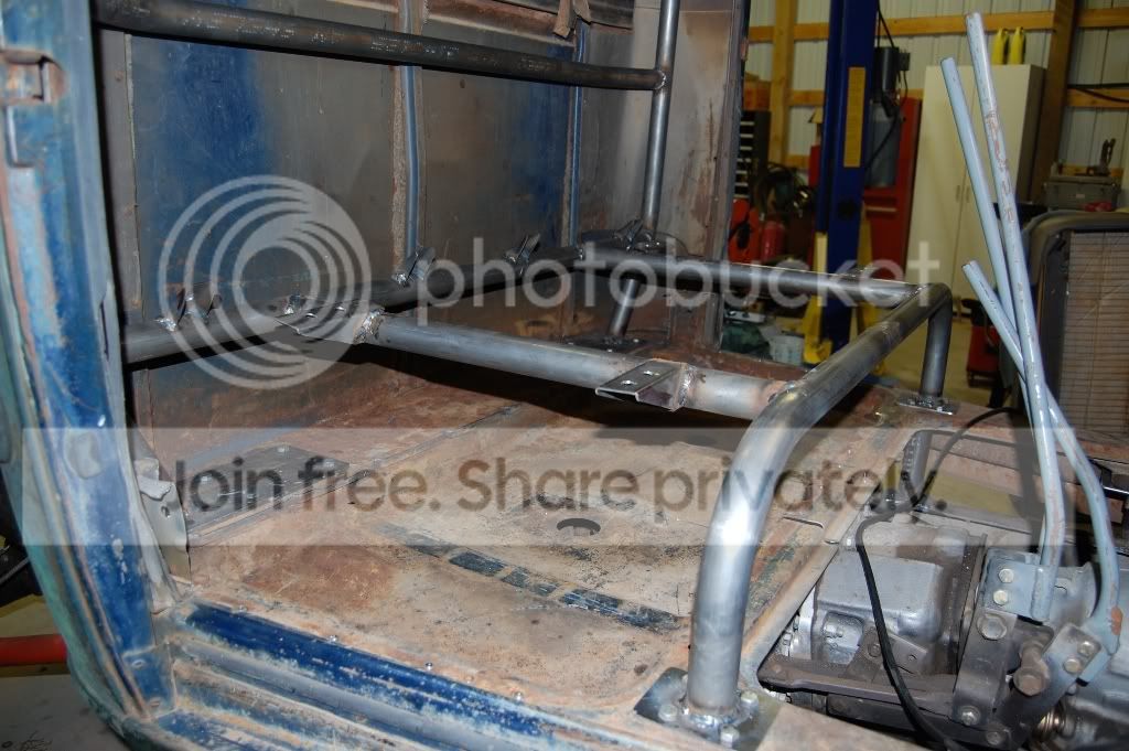

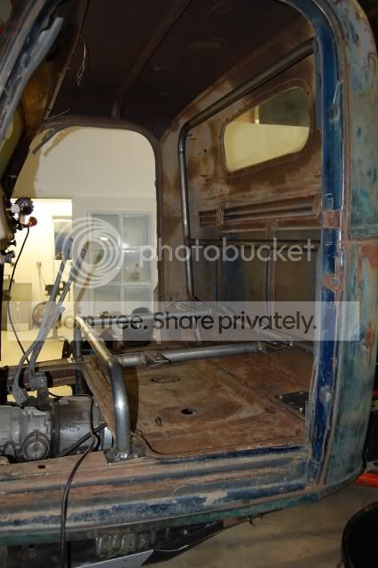

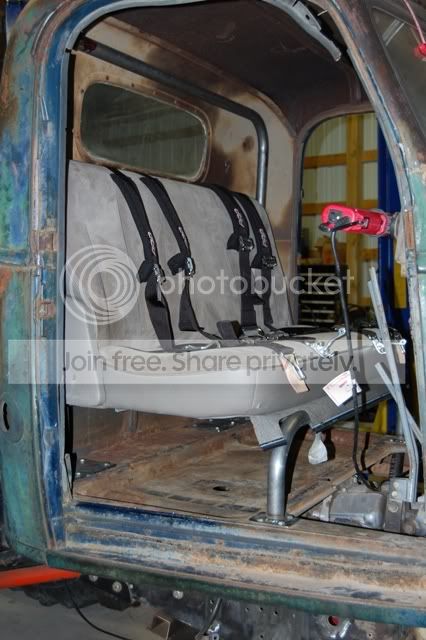

Found a Dodge Caravan Bench seat for $15 at the parts yard. Fit what was built. Added seat hoops to the floor. Tabs and a Seat belt bar in the back. Seat and belts are mounted.
Yes the roll bar looks wimpy. 1.5" x .120 DOM. This just holds the seat and belts. An Exo Cage will be added later.
Awesome fab work on that mini-van seat, ktm.... Great job - but it's not moving fast enough!!!! Hurry up on it!
Lookin good, let me know if you need a hand or just some sarcasm...
