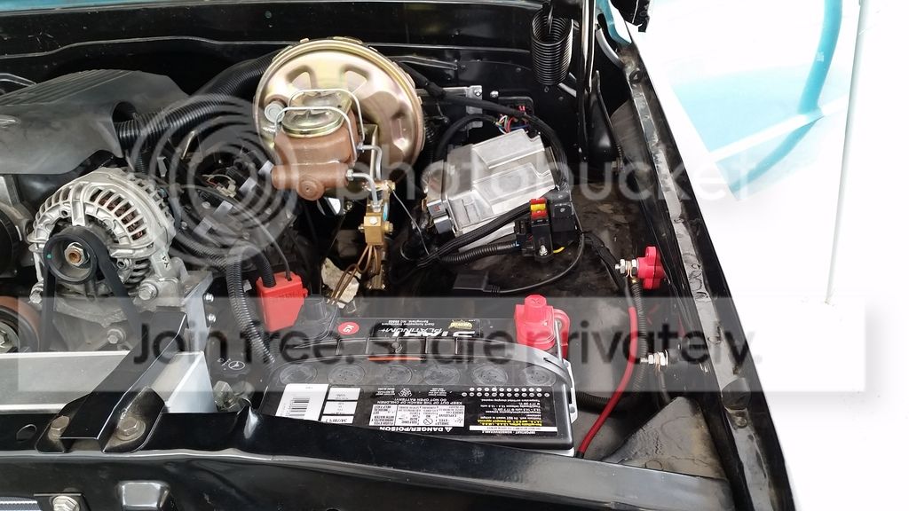

Checked for any shorts, didn't find any. Double check engine oil, good. Trans oil leaked a lot when I took the drive shaft slip out during install, so not sure how much is still left but its enough to run. Has coolant and PS fluid.
Cycled the key a few times until I could hear the pump build pressure. Checked fuel lines. Cycled key again to check fuel rail. Said a prayer and started it. It started soooo smooth. If I had my gauges in I'd drop it down and take it for a spin. Gotta be smart though, no gauges, no drive.

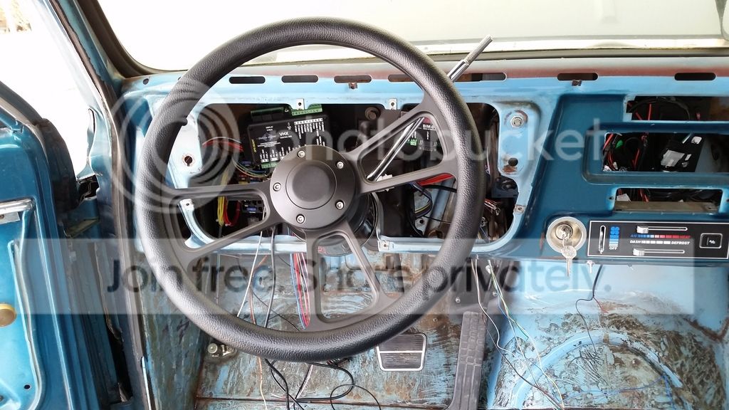

Still working on the gauges. Everything else on the truck is wired. Some of the smaller wires is for my cruise control and torwue converter signal, gotta get those in too.

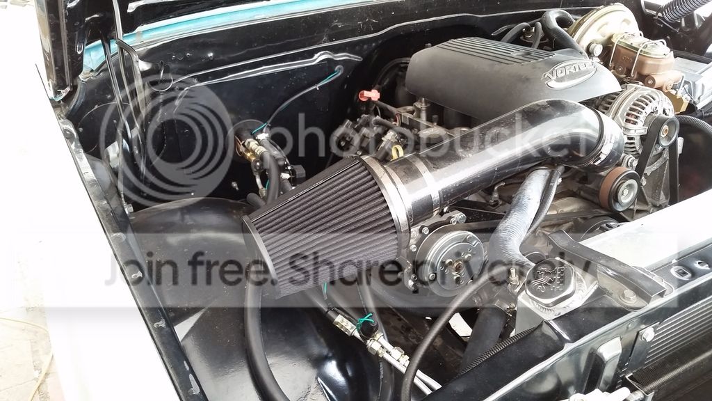

AC hoses and wiring is done. Not over the moon about the hoses but the directions warned me about vibrations or having the hoses too tight. So I looped the two main lines coming from the compressor so it wouldn't vibrate at the other side. I will probably re-do the line going to the dryer, I don't see it having a problem.

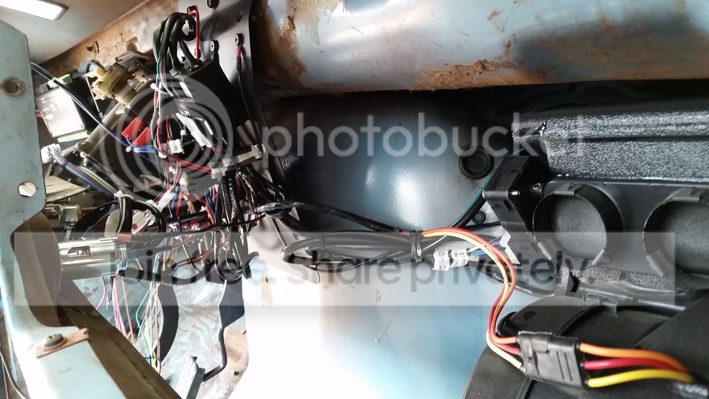

All my wire mess. Got everything in a loom. Took a lot of planing where the wires would go. I think this is what took me the longest time. A far cry from the Blazer's wiring LOL. Almost center picture is the OBD connector. It's unpluged because the other side is bare wires. This is how most of my gauges get signal. Here's hoping Dakota Digita has the sh** together.

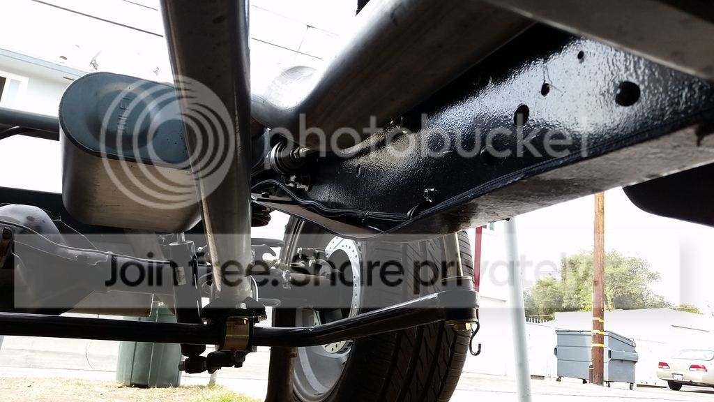

Fuel line and more wire loom, even tucked the tail light ribbon inside. Boy this stuff is nice looking, bought a box of 75ft. Boy this stuff is expensive. lol

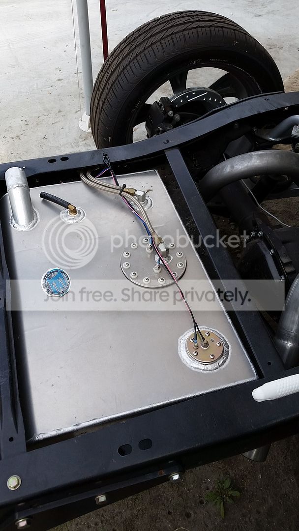

Little more work to be done back here. Need to make a new mount for the bed, since the tank is in the way. Not hard at all, just ends up outside the frame rail instead of inside like the others. Cut the filler and vent hoses to size, then slap on the bed :D

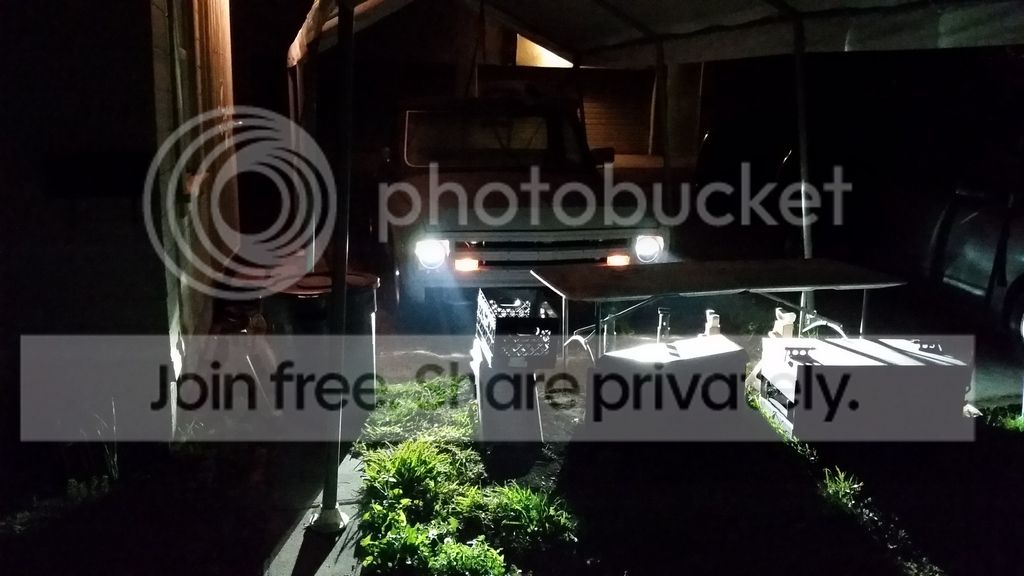

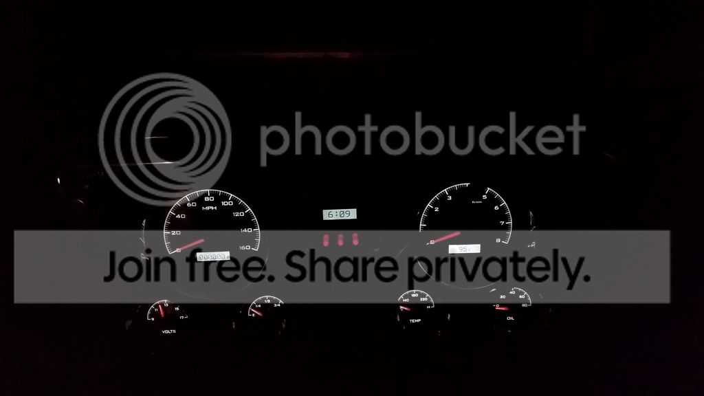

Sweet, I fixed the running light thing. Fixed one other wire, finished the TCC, cruise, and TOW mode wires. Installed the gauges and set them up to either read the OBD signal or sending unit. Started the truck up. Fans come on when they should, all gauges work great. Dakota Digital says it's hit and miss whether the OBD port supplies certain "extra" information. Found out that the digital read out on the gauges also gives me Trans temp, intake temp, TRANSMISSION gear (which is cool) and some other useless crap. Tightened up some leaky coolant hoses, topped off the trans fluid and coolant. Power steering is good. Brakes are ok, but they feel like they need more bleeding. (have not driven it, only shifted from REV to D to Park.

I didn't know you could get trans temp from the OBDII, that's pretty handy. I have an OBDII reader that connects to my phone for gauge info so I'll have to check that out.

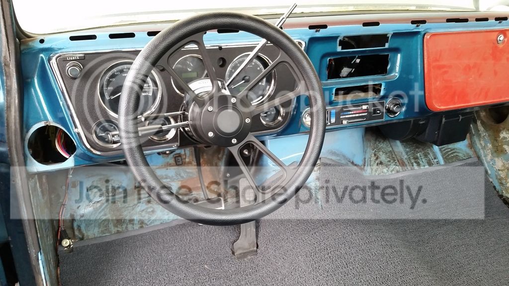

Little bit of daytime action. Threw the rubber mat I had been saving for the Blazer in. Figured it will do more good in here till I'm ready for interior. Hoping to get the seats installed tomorrow. I already have my 3 point seat belts but those go in after the seats. Still need to work on getting the bed back on. I am also leaning towards lifting the front an inch, I don't like having it this low. I'll need some new shocks too. This time I'm going through ECE instead of CPP, I don't want to give them any more of my money.

just something I tried while searching for the crappy throttle feel
