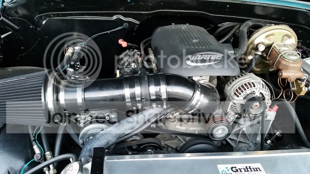

Got my MAF cut into the intake. Disconnected the old sensor for "speed density" and plugged the MAF into the harness. I was told it will start reading like normal. (yes, I disconnected the battery to remove the MAF code and let it learn the new sensor)
I like putting it in the middle of the tube. These kits come with them smashed up against the filter and I don't like that. I'd think there's a lot of turbulence in that area.

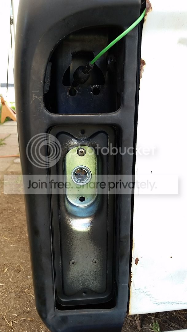

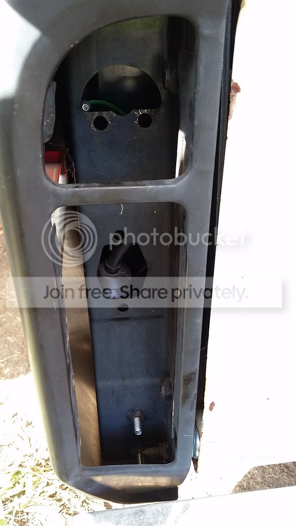

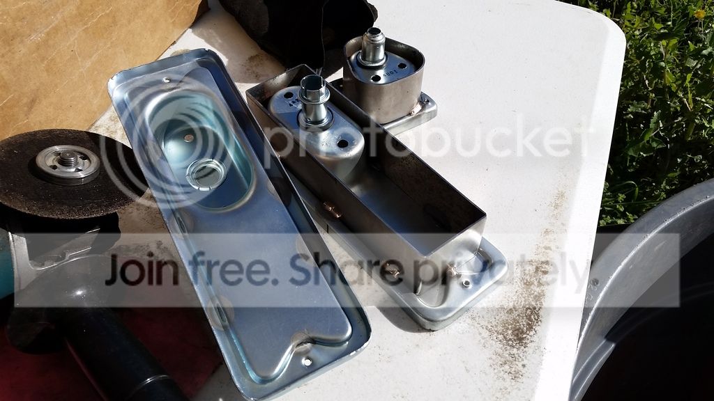

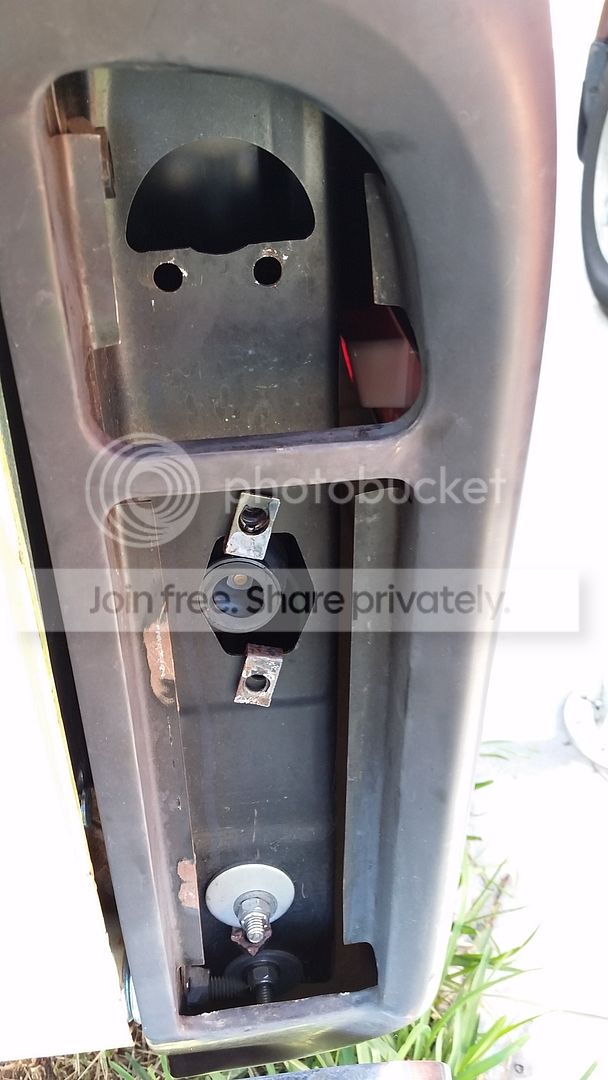

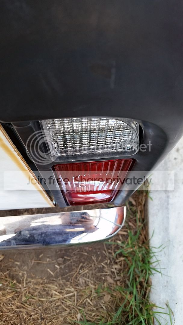

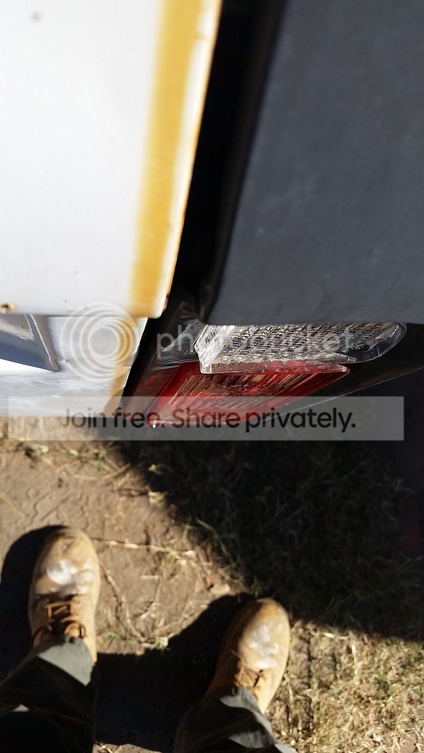

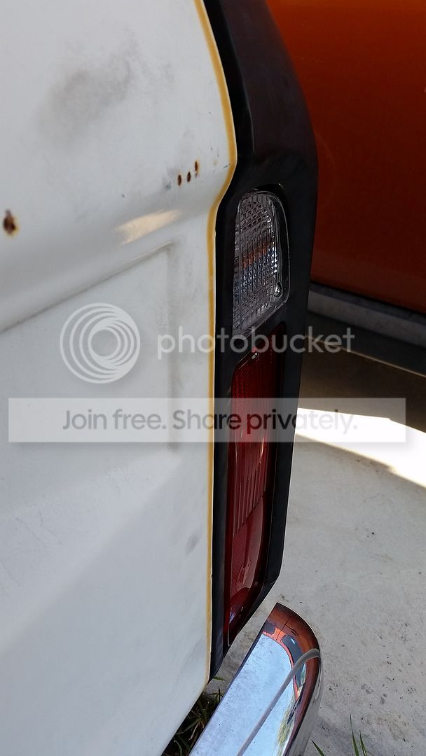

To recap the tail light problem. Damn things wouldn't fit right and nothing lined up. So I cut out the tabs and got some pieces of metal welded to the back side of the tail lights.
Before..

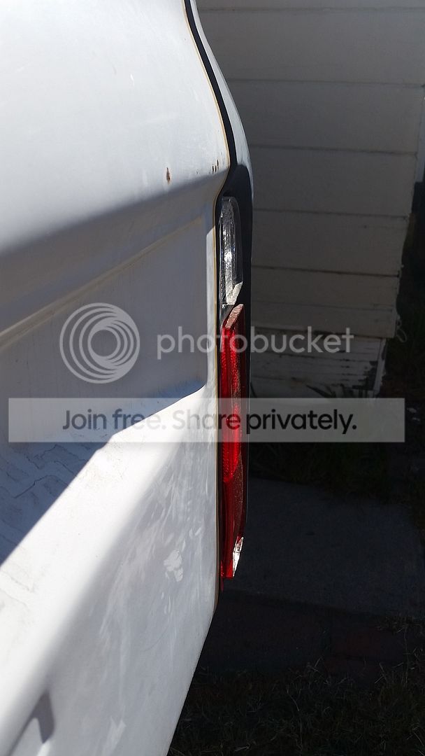

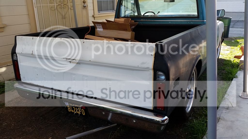

I also painted the outer edge of the housings, cause you see it between the lens and sheet metal. I hated that. Now they are both straight and slightly "Frenched" in a little, about 1/4".
After
I don't know if it's gonna be an issue or not for you maf sensors are placed in that location for reason. That's where they're designed to be and are calibrated at a certain amount away from the throttle. Hopefully it's not an issue
PS. I sanded the black paint off the flat part of the housing. Need all the reflection I can get
Hell, I've seen a lot of swaps with a tiny filter, then MAF, then TB. No tubing, just connectors, right in front of the radiator. Not good either. Time will tell if it's a problem. It's the farthest away from the TB that I could put it, without modifying my original mount. I bought another kit off eBay. I might use the tube to run the filter down towards the headlight. That's at the bottom of the list though
I am going to pretend that I didn't see how you were particular, ( there could be other words to describe it ) about your taillights. Otherwise I may possibly have 2 trucks to fix. ( maybe more) I get particular enough on other things! LMAO!
That looks good though!
hahaha, it drove me freaking BANANANANANANAS! I could only got the passenger side on before, the driver side was way screwed up to the point I couldn't get them in. This "fix" wasn't that bad at all and I'm super happy with the outcome. Would have been free if I didn't have to pay a welder, but I couldn't do the job he did, they came out great. I doubt anyone will ever know the difference, but I didn't do it for that :D
