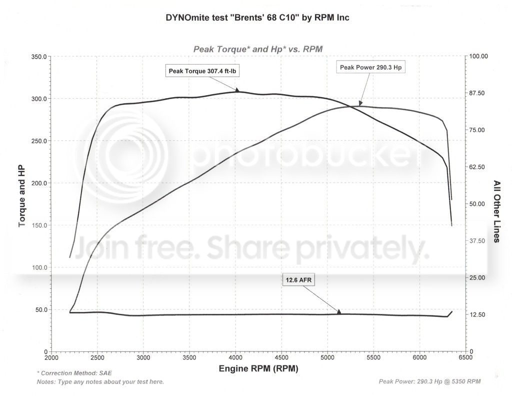

Still haven't addressed the brakes yet but tomorrow I'll be driving it down to CPP. The recent dyno tune feels great but they guy put WAY too aggressive shift timing in. It is barely streetable with the shift points so high, so I'm going back up to see about taming it. I'd say, if the shift points from factory were at a level 1, and what it's at currently is level 10, I'm going to ask him for a level 2. LOL, it's that aggressive, plus it likes to downshift with very little throttle input.

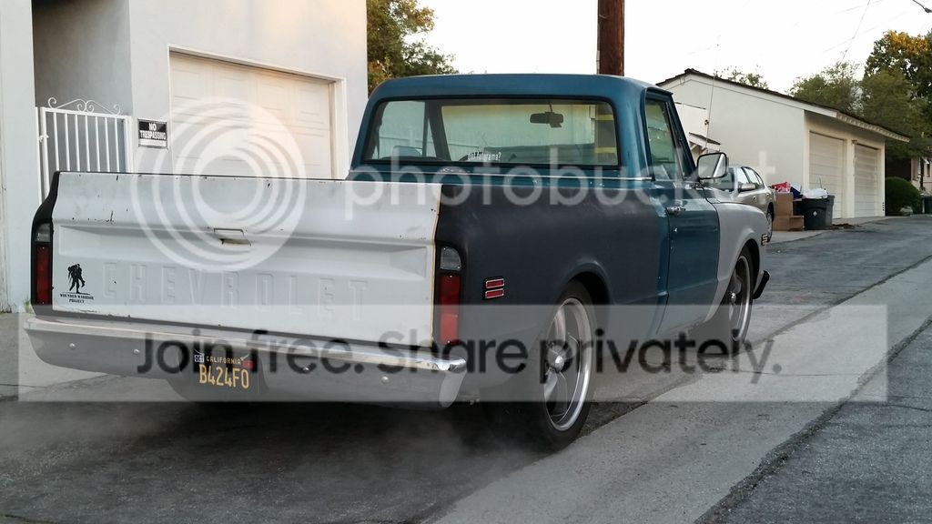

I got pissed at an asshole today on the freeway. Had to slam on the brakes. Rolled past him at ~5mph and jumped on it to get around. Damn truck lit up the tires. :eek1::eek::burnout:

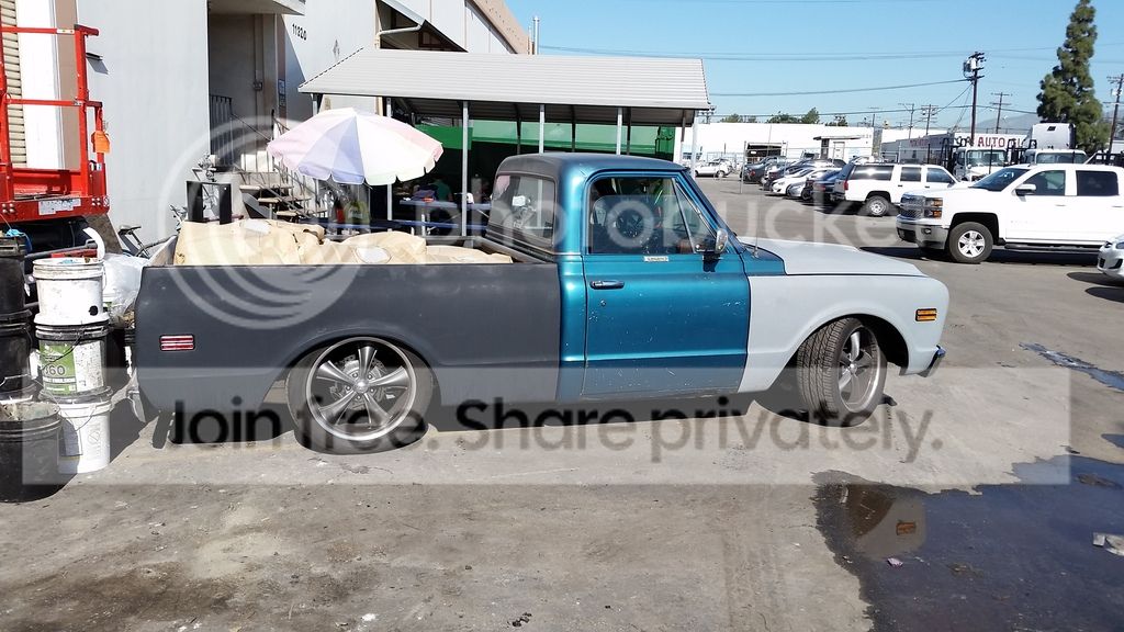

Moving some stuff from my late uncles appartment. Wish it was under different curcumstanses but the truck handled the weight easy.

that has to be the flattest torque curve in the history of curves..and torques.. looks good.
That's spoken like a true car guy there.
But honestly I thought I was the only one that liked that...

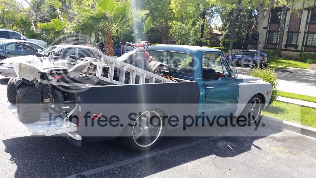

1080 lbs of roofing leveler. Little too much but handled it ok. Maybe 1" away from the cut frame's bumpstops. Don't think I'll do that again.
Second, took a couple quads in for service. Wasn't bad at all but I'm getting the feeling airbags are in my future.

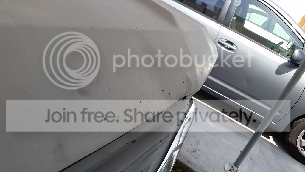

Some time before the quad picture I had another Uncle pass away. This time on my Father's side. I was much closer to him than my other Uncle that passed away merely 2 weeks ago. I got a call from my Cousin (son) just a few hours after my Uncle's passing. I was surprised to see it on the caller ID. Well, I was waiting for a red light behind a semi truck. When I reached for the phone, I must have released the brake a little and rolled into the back of the trailer. :( This month has been hard needless to say. I didn't even answer the call. 2 days later, while talking to him, he said he never called me or anyone that day. This was his house number, not a butt dialed cell. Weird right?
There is the obvious dent and a couple not so obvious bends. The hood no longer sits flat :( Looking for another hood. The top edge of the grill also has a dent in it, not sure if I'll replace it or just have it fixed.

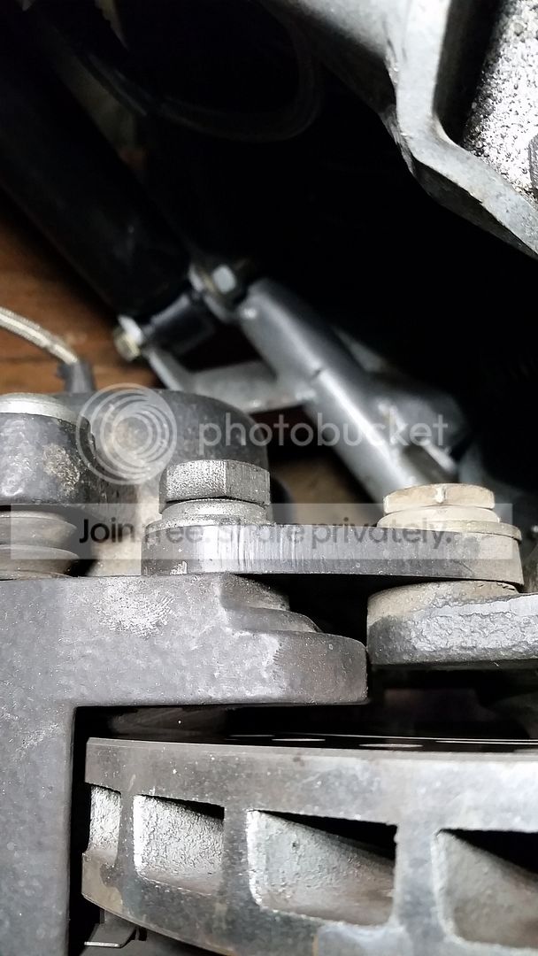

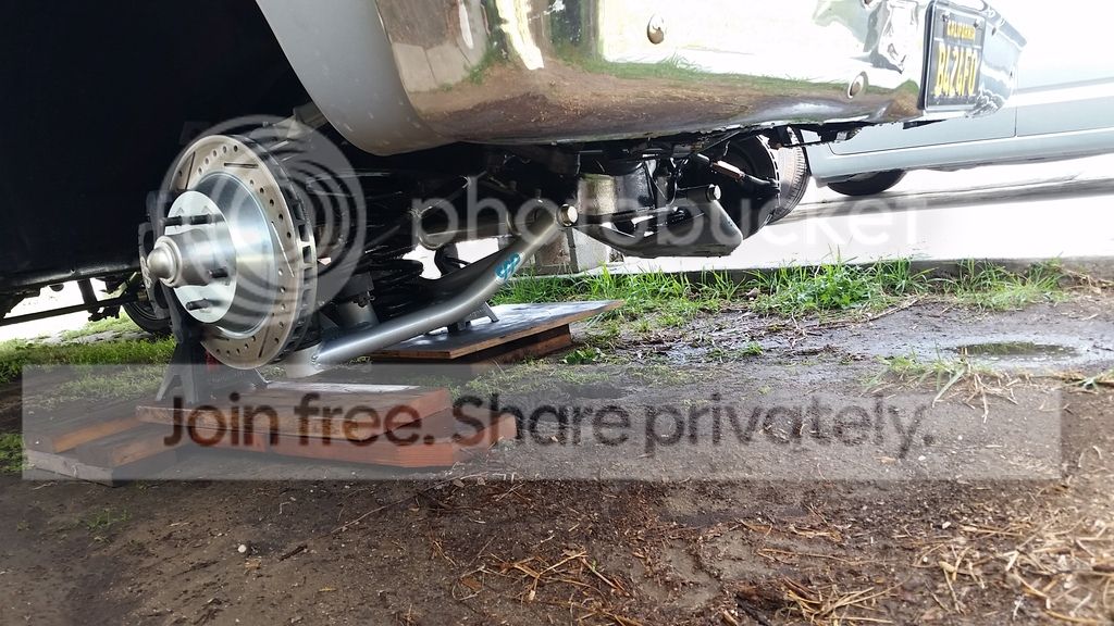

The brake and wheel bearing noise have gotten worse. My steering is still terrible and needs to be fixed for me to be more confident. With my S10 back in DD service, it's time to tear things apart.
How do you like this?
CPP spindle
CPP bracket
CPP caliper bracket
CPP caliper
equals
interference :angry1: on both sides! Not sure what this would do, neither parts are moving, but I'll be grinding down the caliper bracket some to get the clearance it should have. I'm sure that will bode well with the powdercoat
