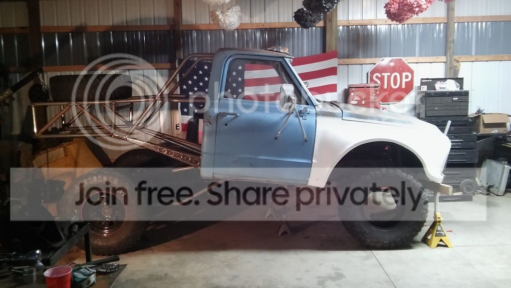

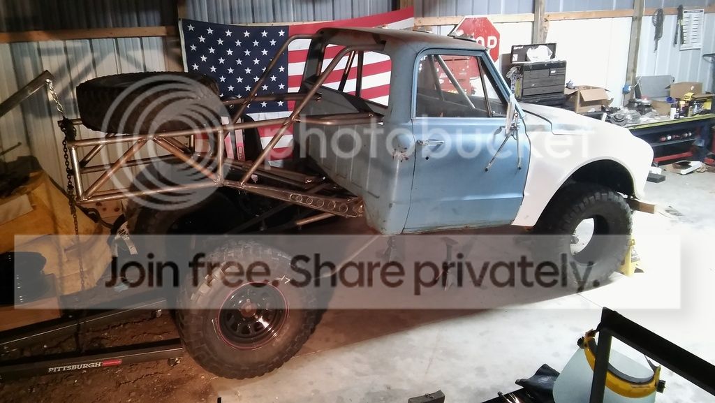

I did get some work done tonight. Lots of welding. Got most of the back half welded up. Good enough to check out droop and bump with the back half and the glass fenders.
RIDE HEIGHT
BUMP (although this is an unrealistic bump as more then likely the beams won't be able to clear the motor this low)
DROOP
That thing has so much character! The spotlight cab lights and patina are perfect! The pics remind me of when I was a glue sniffin kid sitting in my room building my dream rides. Can't wait to see this thing up n runnin!
That is part of the reason they push the engine back.
The engine is pushed back 3 1/2"s. In the droop pics the frame below the cab is only about 6"s off the ground. That low and it will just plow sand on landings and steep transitions. It will get set up more around the 8"-10" range.
I ran into this with mine, combination of taller mounts and sacrificing a bit more lift was the ticket. I pulled of a lift on 35's with 14 inches of travel that ride height is in the center of the shaft that will fit into a standard height garage.
You keeping stock front crossmember?? This is why you put bends in the beams.. Or lower the beam pivots or narrow the pivot locations.. I think that bump pic is very close..
