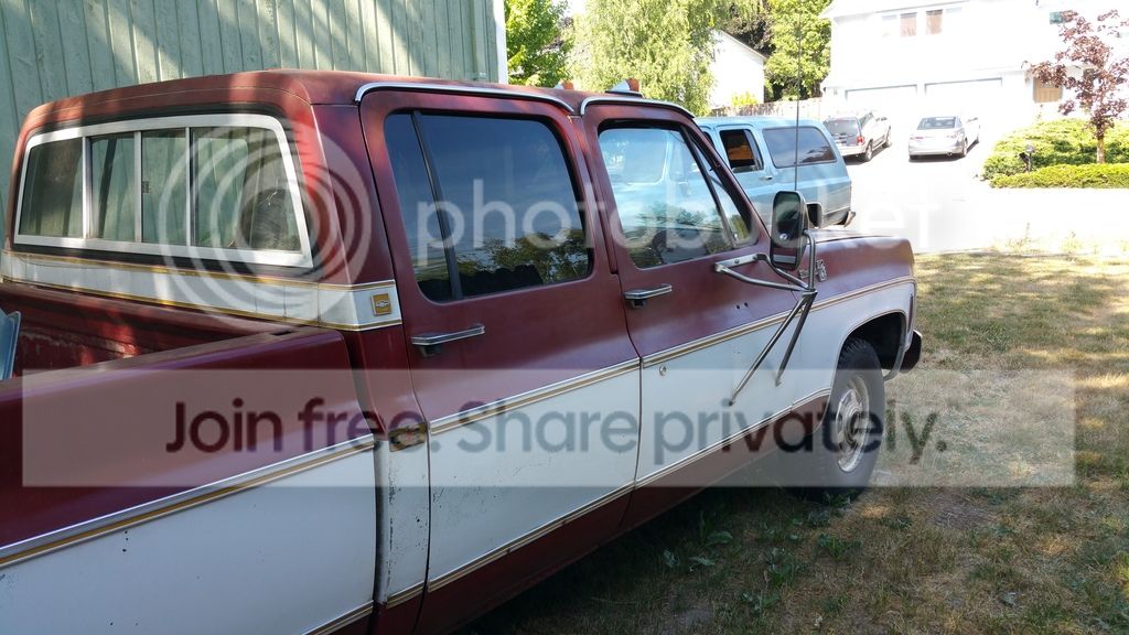

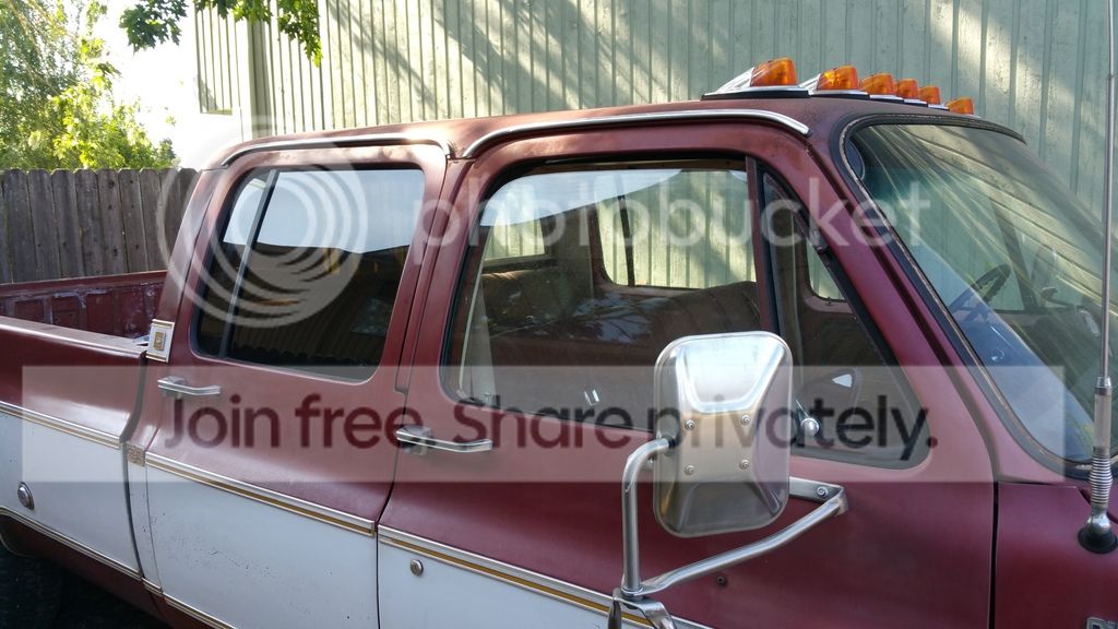

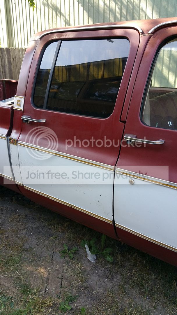

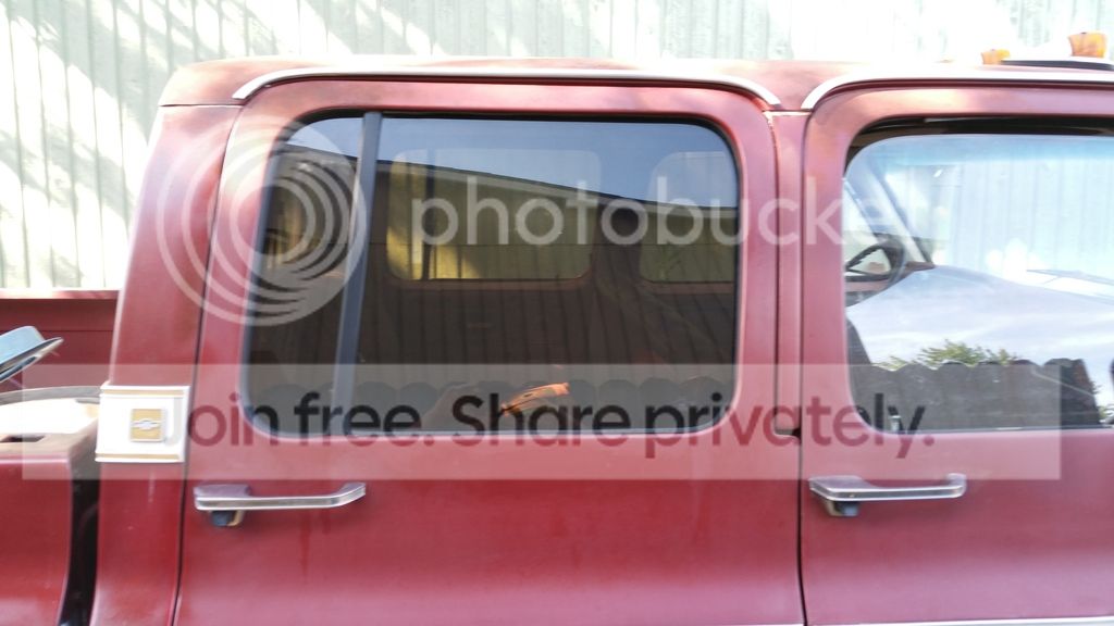

So the driver rear door needs replaced but the passenger rear is perfect. I got that pair of rear doors off a 91 burb so I just wanted to take the factory tinted glass from the burb door and put it in the passenger side. So I did that today after work and luckily, it worked perfectly! The rear doors are exactly the same and since the old glass is thicker than the new glass (clear for clear) but these are tinted, they are the same thickness so no mix and matching of window seals and felts will be required! Very happy with how it turned out/worked out.
I'll need to find a roll of tint that matches close for the rear slider. I'll leave the fronts untinted.
