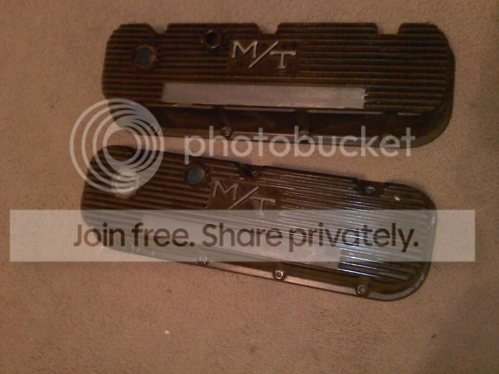

Bolted on the motor mounts, repainted the valve covers (the parts washer removed all the paint). Need to replace the main seal and bolt the alternator ect to the motor then pull it from the stand and put on the clutch and flywheel and stab it in. I will get a pic with the covers on hanging from the hoist. Hope it will be in tomorrow and maybe running some time this week.

I was getting the spots of rtv to set up on the gasket before I installed the grommets, breather and PCV.
