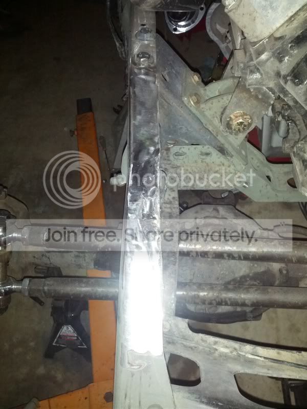

This is what it looked like by the end of the day.

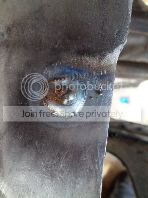

This is what it looked like before it fell through.
I'm not sure what do you guys think.
Should have stopped there. Let it cool and ground it down. Then add I'd needed. You welded in a circle around it. Generates too much localized heat. Then blow through.
Think what I did by building it up will hold?
