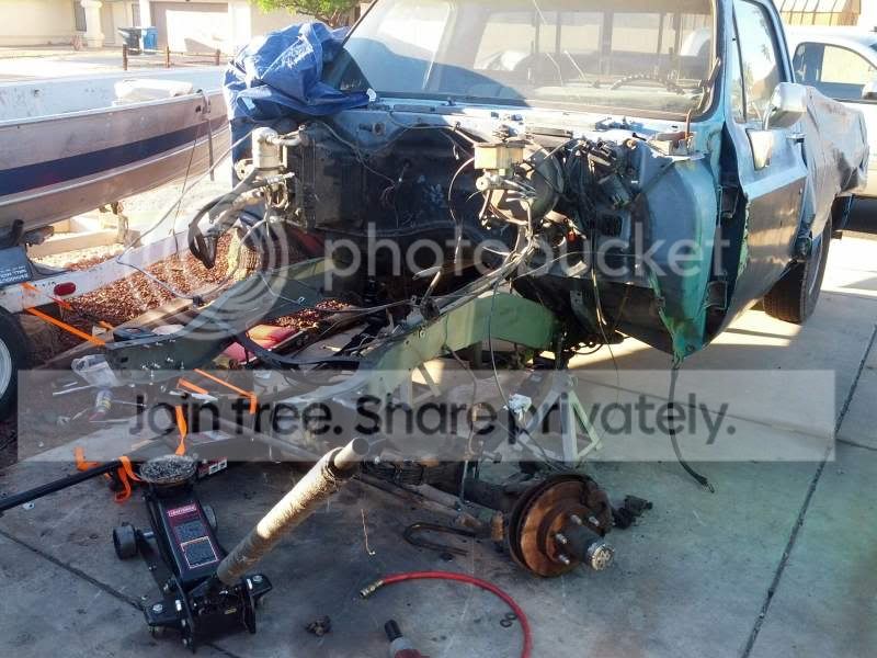

1 ton status
I suppose it would depend. Are you talking about the front spring eye? What are the bushings like that are in there now?
Nice looking good. Which springs did you get
Looking good. Never been so excited to see a 10bolt under the front of a truck. What have you been complaining to me for like 10 years you wanted it to be 4wd? Well your on your way man!
Soon my friend very soon. It will be nice to see it sitting on 4 wheels even if it has a wicked rake.
Awesome job so far man. Looking back on it now, would you do it again or would you rather start with a 4x4?
Lesson to learn, always test fit your center pin on the axle before installing the springs, to be sure they will fit in the hole. Also leave all your shackle and spring bolts loose so you have more movement in your springs to get everything lined up.
Thanks for the tip, and yes I can guarantee it won't happen again.
