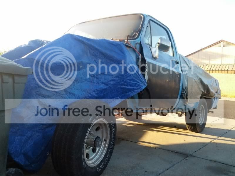

Took a couple pictures today for no reason other then I'm liking the new stance.
I did jump up onto the bench seat and pretended like I was driving, it felt pretty good.
I made my best sound effects of shifting the transfer case and what I envision a 6L wide open.
