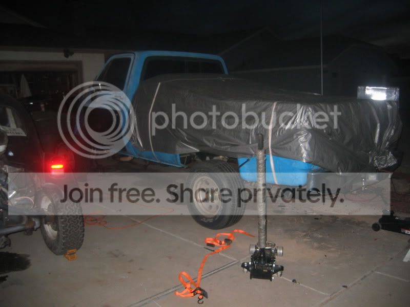

I bet your neighbors get a kick out of watching you work out there in the driveway - riding engines like a horse, jumping up and down on bare framerails and sitting in the cab pretending like you're driving.
I have yet to hear anything from them. I do take a lot of precaution though. I clean my mess up, keep it covered, close up shop at a good time and I even stop making a lot of noise when the neighbor kids are outside.

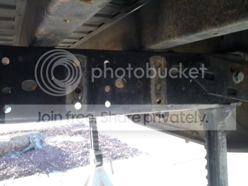

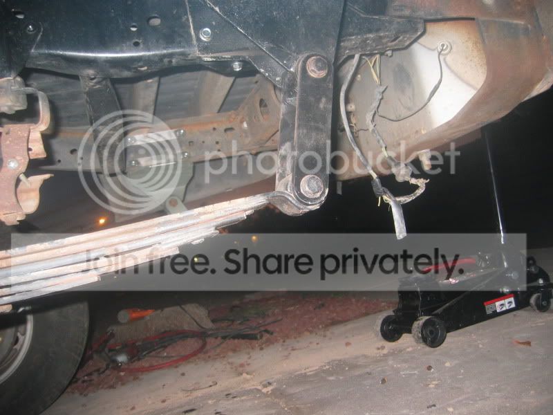

Got the drivers side factory hanger out. If I wasn't so lazy Saturday and stayed out till sunrise Sunday morning I most likely could have had it completely done.
That pic brings back good memories from when I did mine years ago. I love removing rivets from the frame.

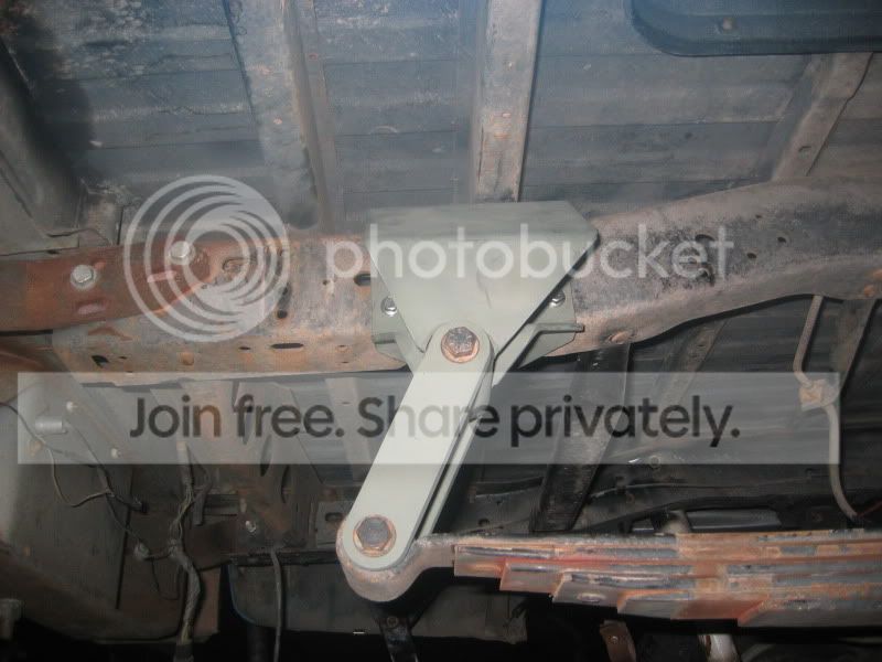

So what about the front hangers for the rear springs? Aren't they mounted way up higher on the 2wd frame than they are on the 4wd frame? Are you going to have to knock the rivets out and relocate those brackets?
I'm thinking it will be close to level because my stock pack has been modified and sits up a few inches higher then a 2wd. When I get all the weight back on I will go from there.
I have knocked out so many rivets it's not even funny...
Front leaf spring brackets front and rear, engine cross member. Also took out the front core support body mounts on my 2wd and now the rear leaf hangers. F bomb rivets.

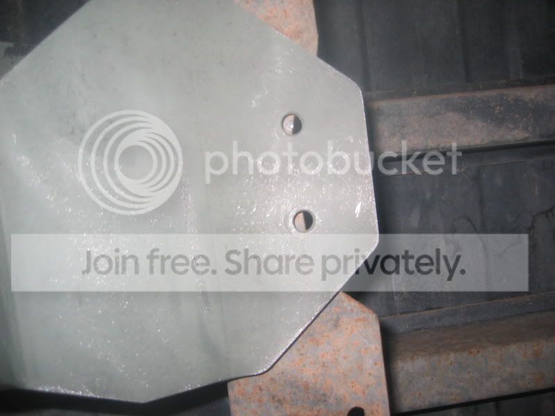

I put them in the exact same location as the factory brackets, that is where they go under my understanding. It does make sense that I would need to put the rear bolts through the factory front and re-drill but that would push my axle way forward and it's already a inch or two pushed in.
Ok looking at the pictures I have the passenger side forward in a different location then the drivers side which is why the angles are different. If I move the drivers forward then I will have the same problem with the bottom 2 bolts.
