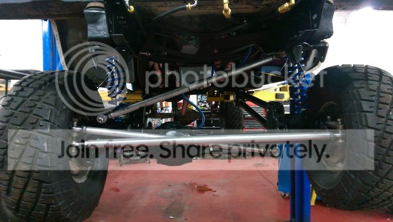

Update pictures, not much to look at but hey everyone likes pictures.
It isn't a burn out video so be nice to me.
