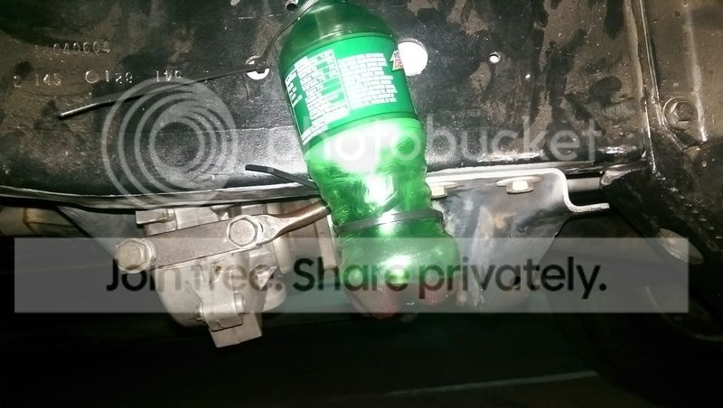

The vent tube is ran up to the trans dipstick and its spray all over the firewall. Fluid is going up a 5 foot tube at a slope.

Too small a vent line that is too long will make the tcase push fluid up the breather and cause some issues. Also I've seen guys let it push fluid out until it stops and check what's left to find they lost 1/2 a pint and it's no big deal. I bet if you drain the case you have 1.5 or even 1.75 QTs in there and it's all good.

Interesting point about being a tad overfull..... just let the overflow fluid accumulate and in that Mountain Dew bottle and mark a Sharpie line on the side each time you drive and see if the overflow amount rises by the same amount each trip or not. If Brandon's theory is correct....after a couple of trips that fluid level is going to stop rising in the bottle.

I'm using 5/16ths fuel/vapor line.
I already marked the bottle after each trip to check capacity.:thumb:
