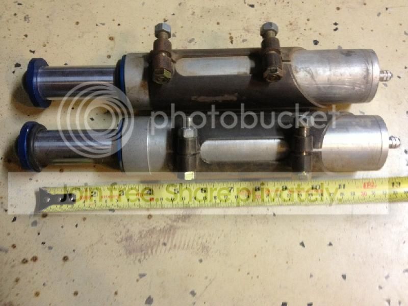

I found them on race dezert and made a offer, and the guy took it. I don't think he really knew what he had to be honest. I'm thinking about going with these for mounting the can
http://www.polyperformance.com/shop...an-Mount-Square-Tube-Frame-Mount-p-20895.html
That kit comes without the cans just the gussets. :thumb: What do you mean by double up the frame?
So basically copy what I have above but weld that onto the frame? Would bolting it on be sufficient?
