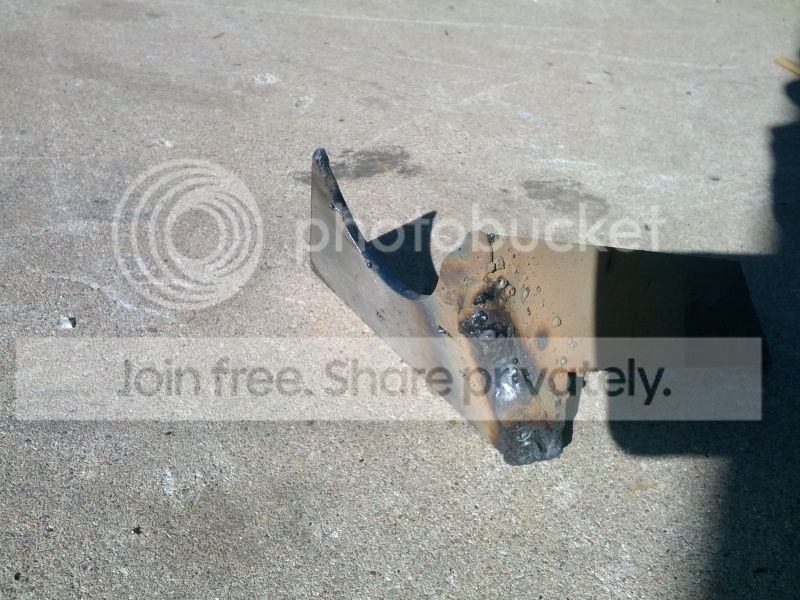

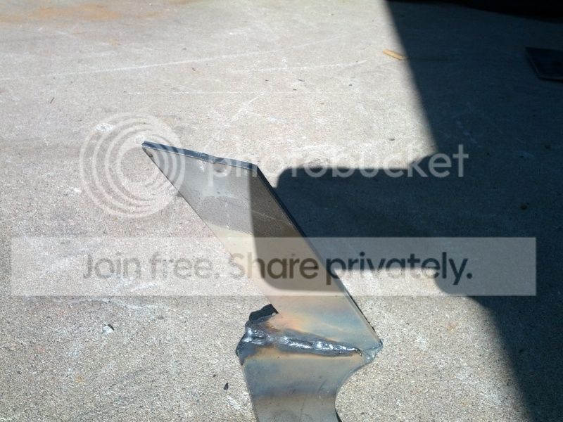

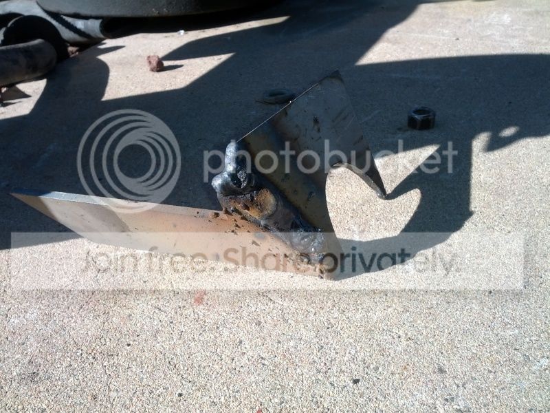

Tried my hand at welding today, not sure but I think I did ok for my first time.
I had to check google to see how the welding rod hooked on. :haha:
A few spots had pitting in them where it didn't look like the weld filled in. I would assume that's where making half circles comes in.
Should have thought about that before grinding on it. :doah: It had a nice blue ring around it I know that.
It's amazing how stick welds can look when you chip the slag off.
The slag can sometimes look very scary and bad, but when you chip it off, you find a really nice weld.
Or a bad weld. :whistle:
