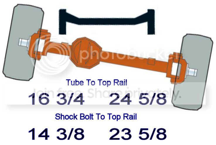

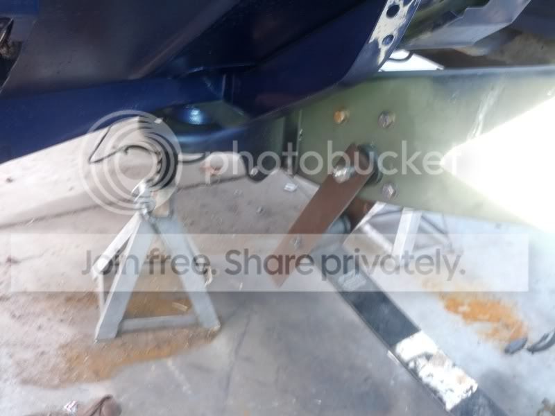

I was able to get some time in on the truck today, I havn't bought any shackles yet so I quickly whipped some ghetto ones up. These are just to "flex" the truck with the axle.

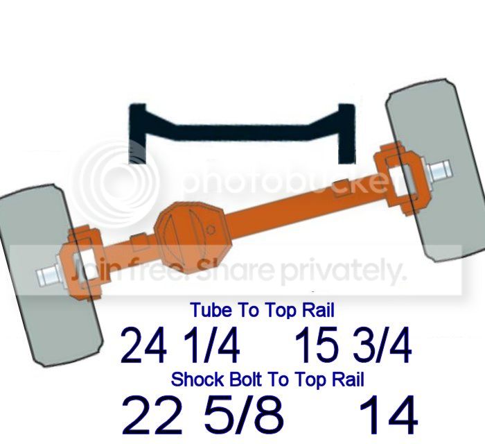

Next I cycled the suspension from left to right and took measurements.
With these measurements I should be able to set the shock, bumps and limiting straps with the help of Eric and other of course. :pimp:

If I'm reading this correctly with my measurements the shock will be placed ruffly 5 inches above the frame? So much for big tall hoops. :doah:
Hmmm, I wonder what would be the best thing to do. I really wanted those shocks to be up high but not I'm wondering if I should take the easy out.
Function over aesthetics. They need to be mounted where they will work the best.
dis
So with your travel it appears you don't need a shock that is as long as the ones you have, It looks like you have about 10" of differentiation between the 2 sides ( give or take) So with 14" travel shocks I would I would set em so that you are giving yourself about an inch of shock shaft showing on compression and set them just like that being that you will have plenty of shock the other direction.
