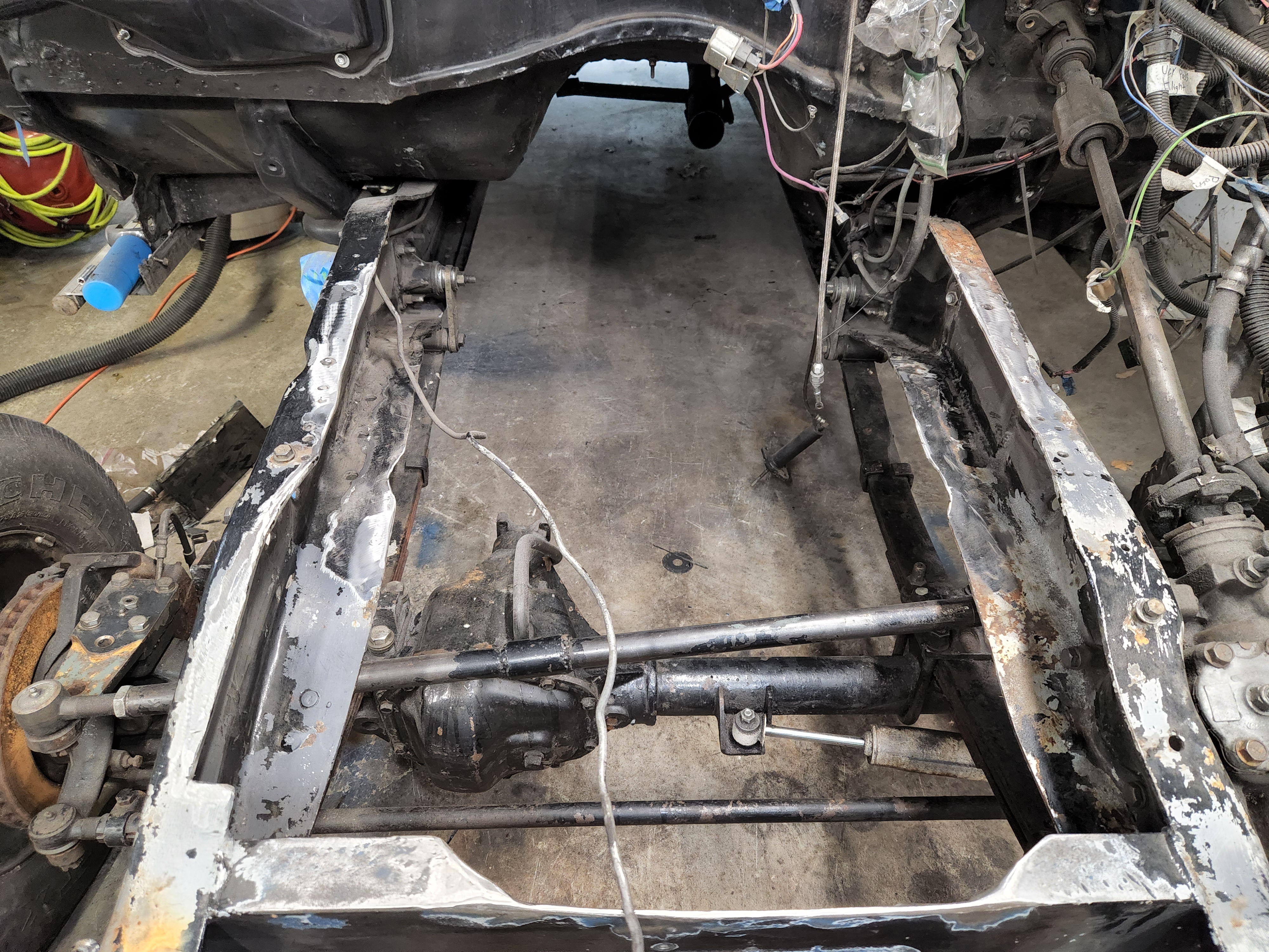

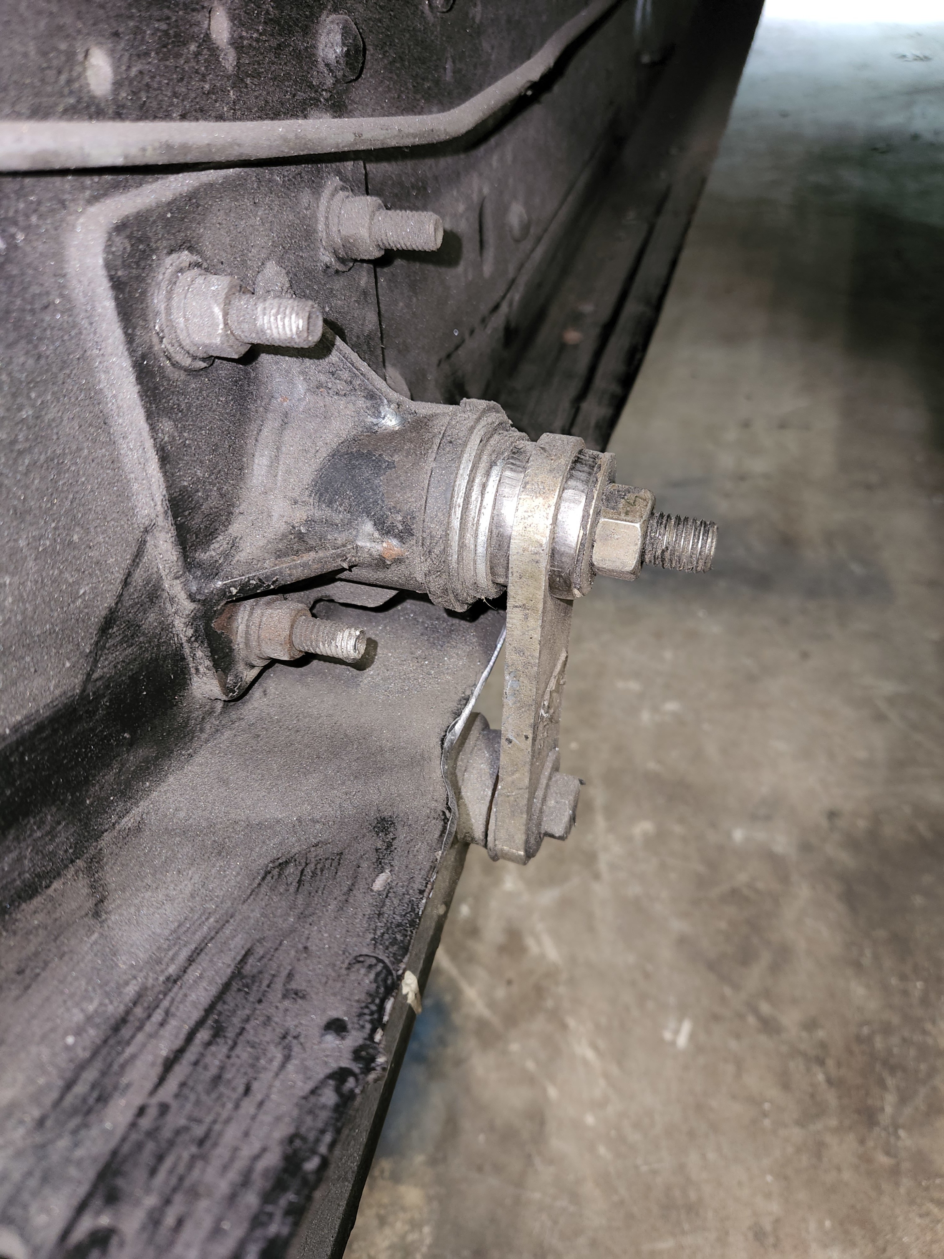

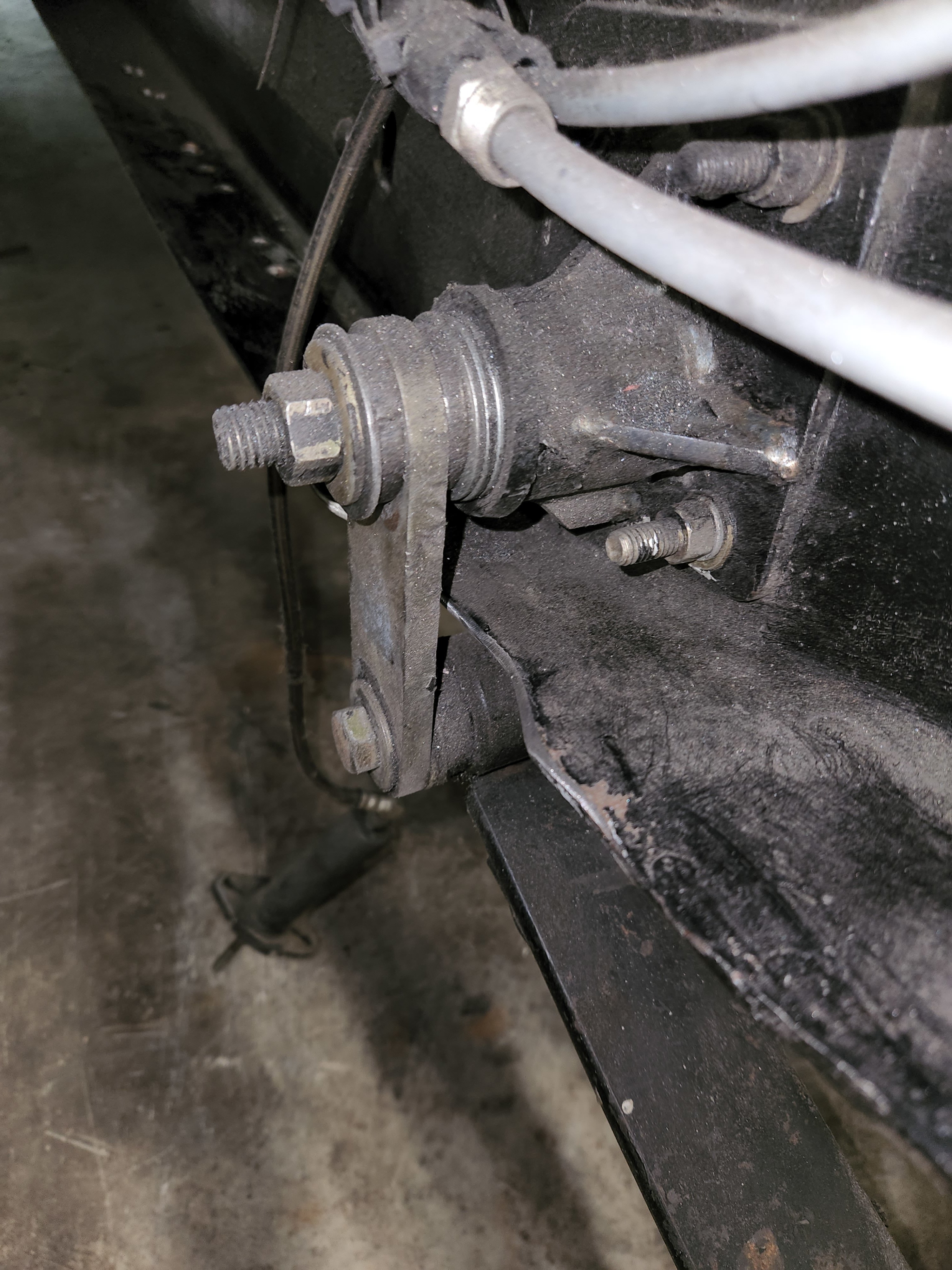

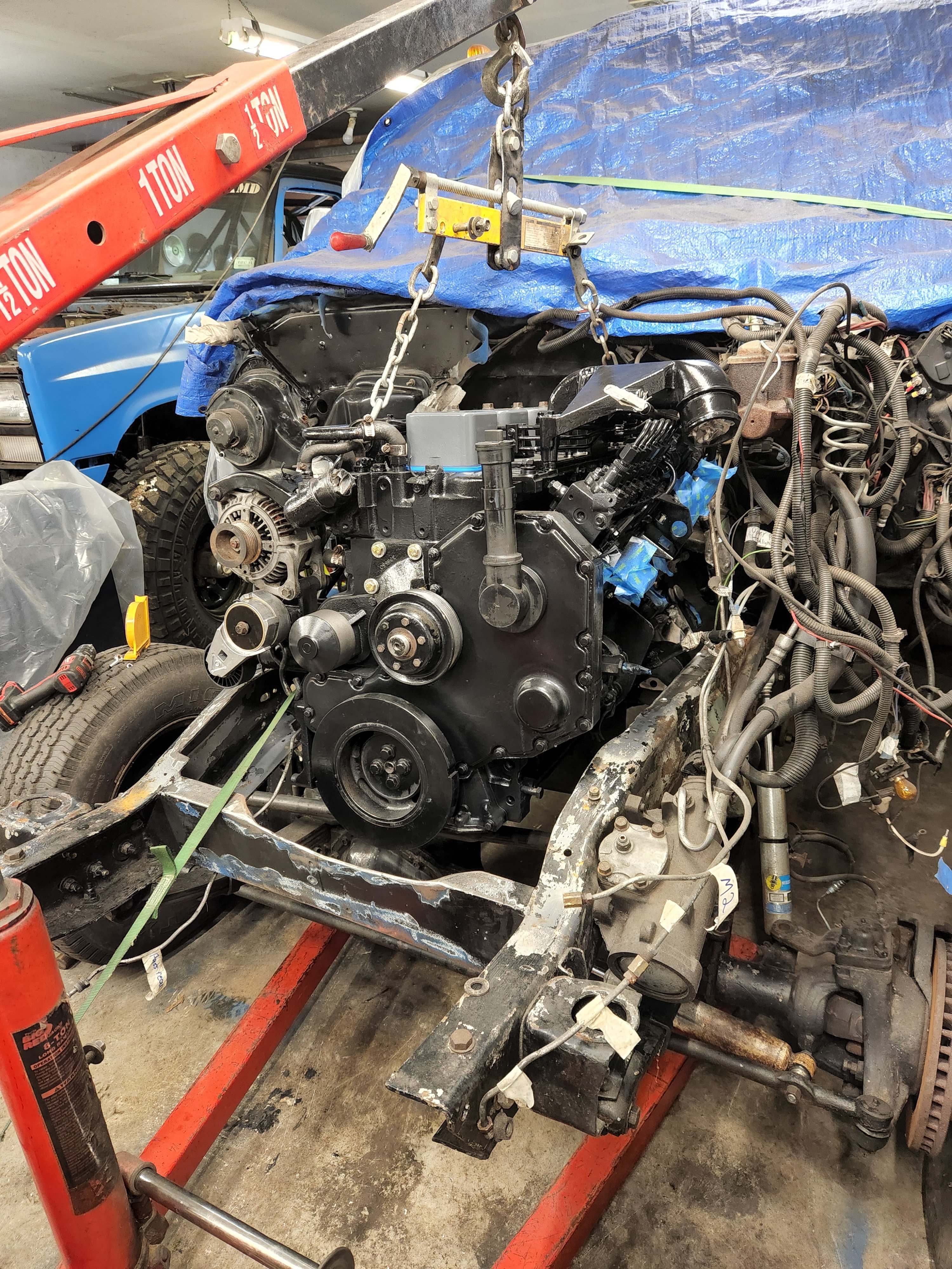

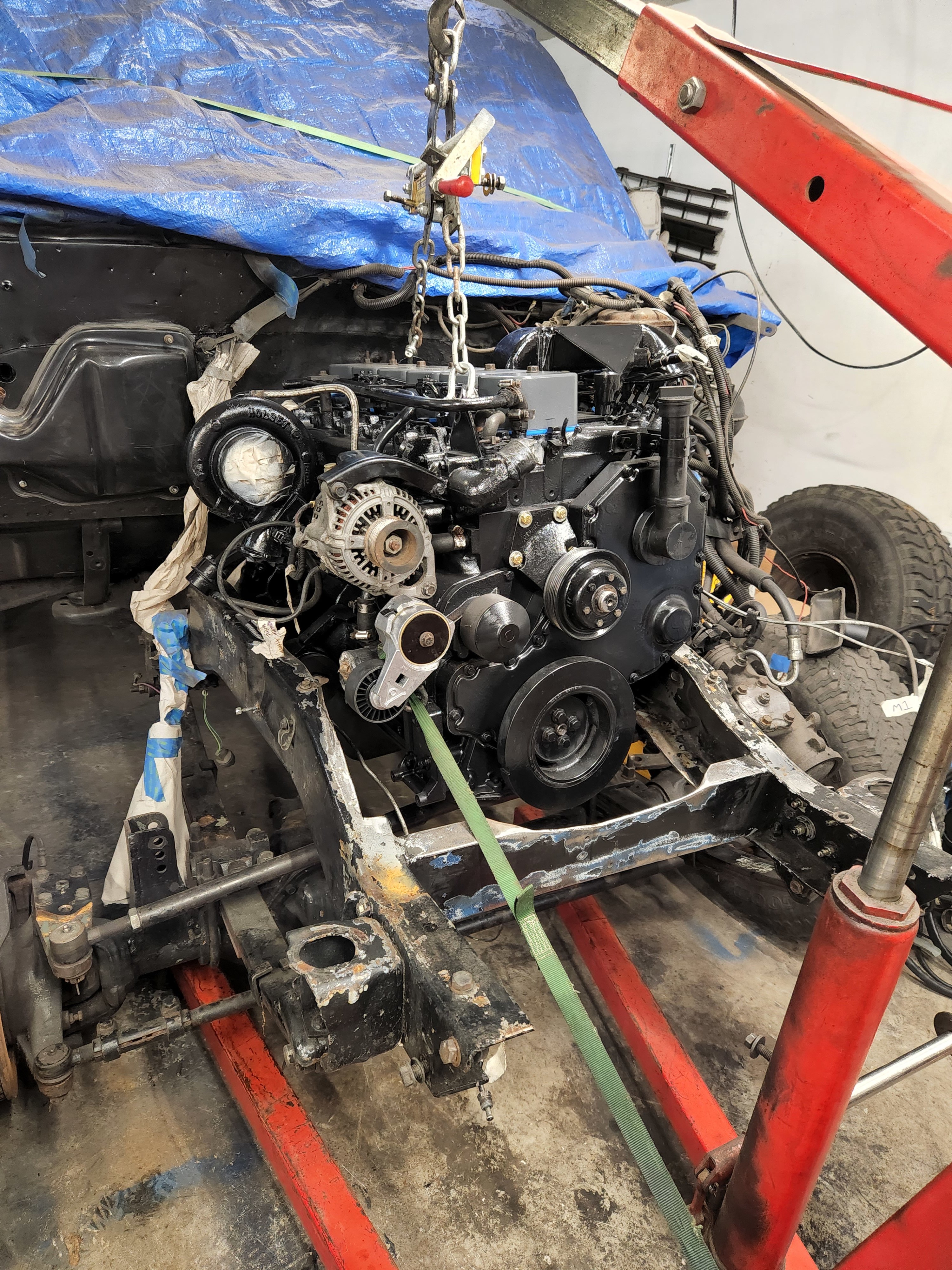

Its been a minute, started swinging the motor in the frame, fixed some stuff I didnt like, cut out all my old engine mounting plates and lots of work ahead. Its wierd being back in this position 10years later and a lot busier in life. My front shackles were always hitting my frame so a little cut with no motor made this lots better.
Well, slow details progress, motor is in, ill have to dig through my pictures for it. I am stuck though. I for the life of me cannot figure out what the heck slip yoke I need for my 2wd nv4500. I had it rebuilt with

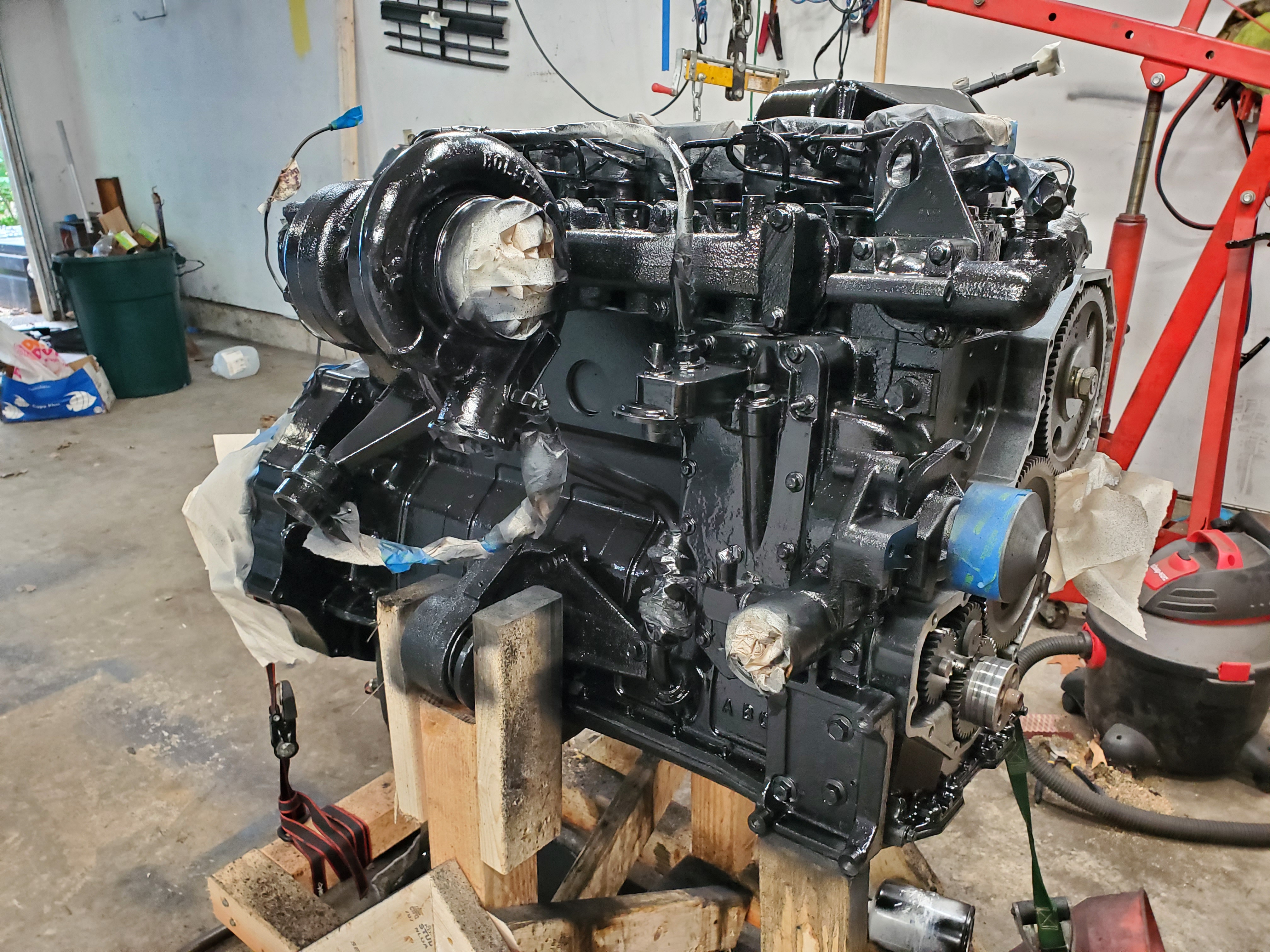

I know everyone enjoys pictures so let me dig some more up of the work of the last year.
