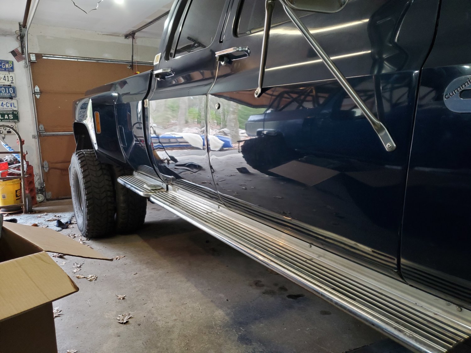

Hey everyone, its been a minute but having a toddler will do that to ya. I've been using the truck for well, truck things, getting top soil, cruising ext. Finally had nice weather where I decided to wash and wax it up. I was inspecting it a little closer and noticed the rust that was hardly there in 2012 is now really showing through the rust bullet. I store the truck in a garage, it is not driven in any winter salt at all but this was on the truck when I got it. Little heart broken about it but I am not sure what the best course of action is. It has drip rails that are screwed into the roof. Maybe this is the source of moisture/rust? It is on the driver side down the back door under the sealant too.
What can I do other than cut it out and try to weld in and make up replacement panels for it? Have you ever used any evaporrust or eastwood rust dissolver? Do I wire wheel it and slap more rust bullet on and keep moving for another 8 years?
Ouch. Take the seam sealer off and then use ospho or some type of rust converter. Not sure what else to do.
