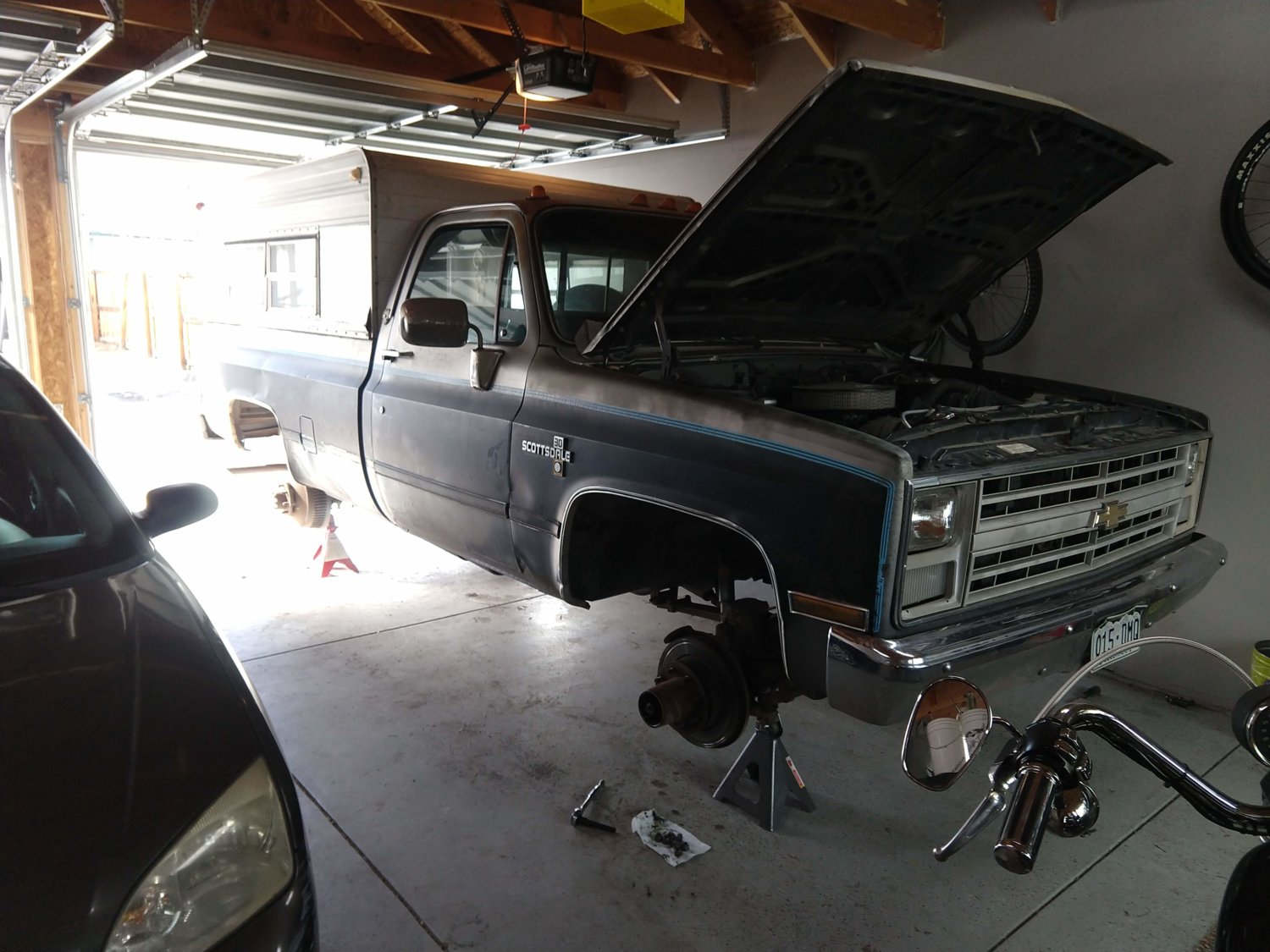

Good news is most likely the tool for the d60 is the same for the 14bff.Sorry for the delay, guys - made some progress and hit my first roadblock today.

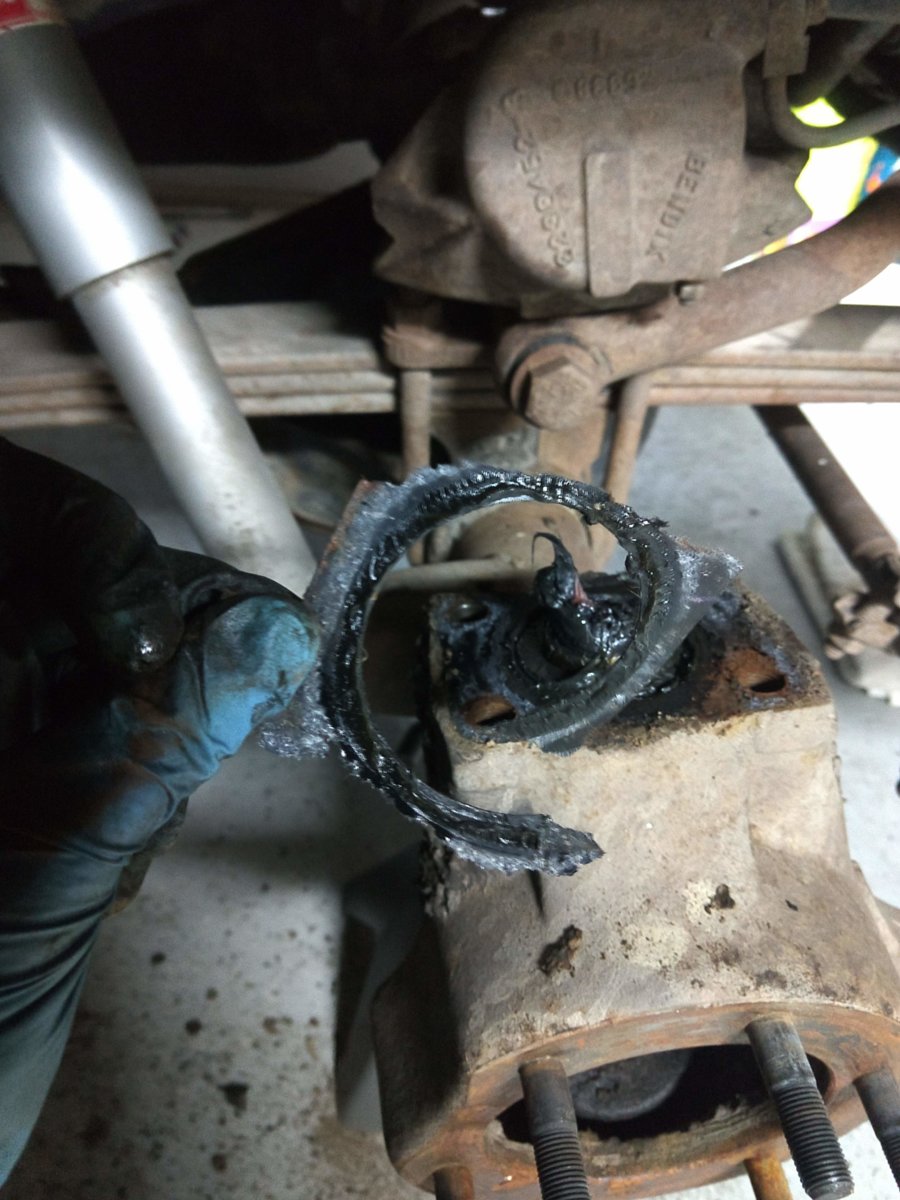

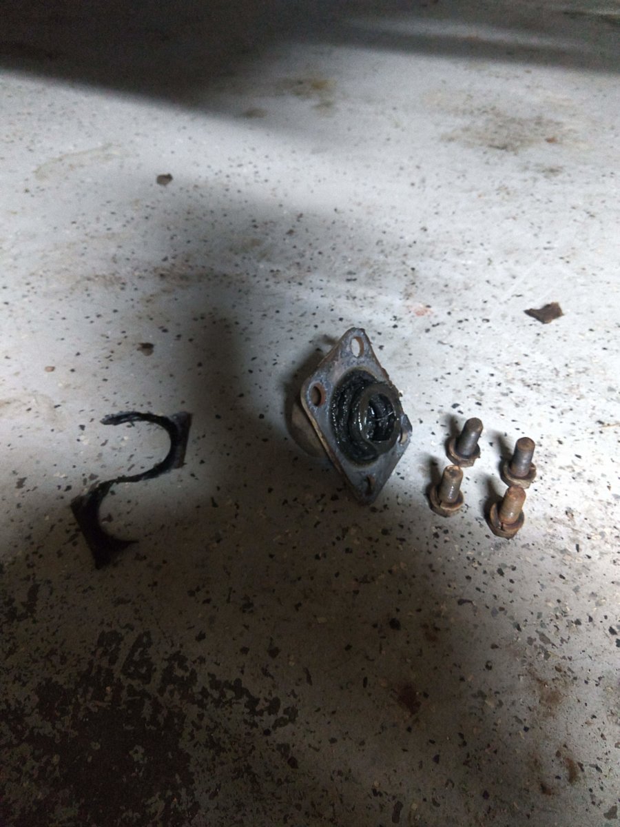

Got 'er up on stands and started tearing into the front axle. Plan is still wheel bearings + miscellaneous greasing / brake bleed / kingpins.
Getting the calipers off was a pain, but they came after some prying. The rotors are grooved real bad so the pads were difficult to slide off like normal.

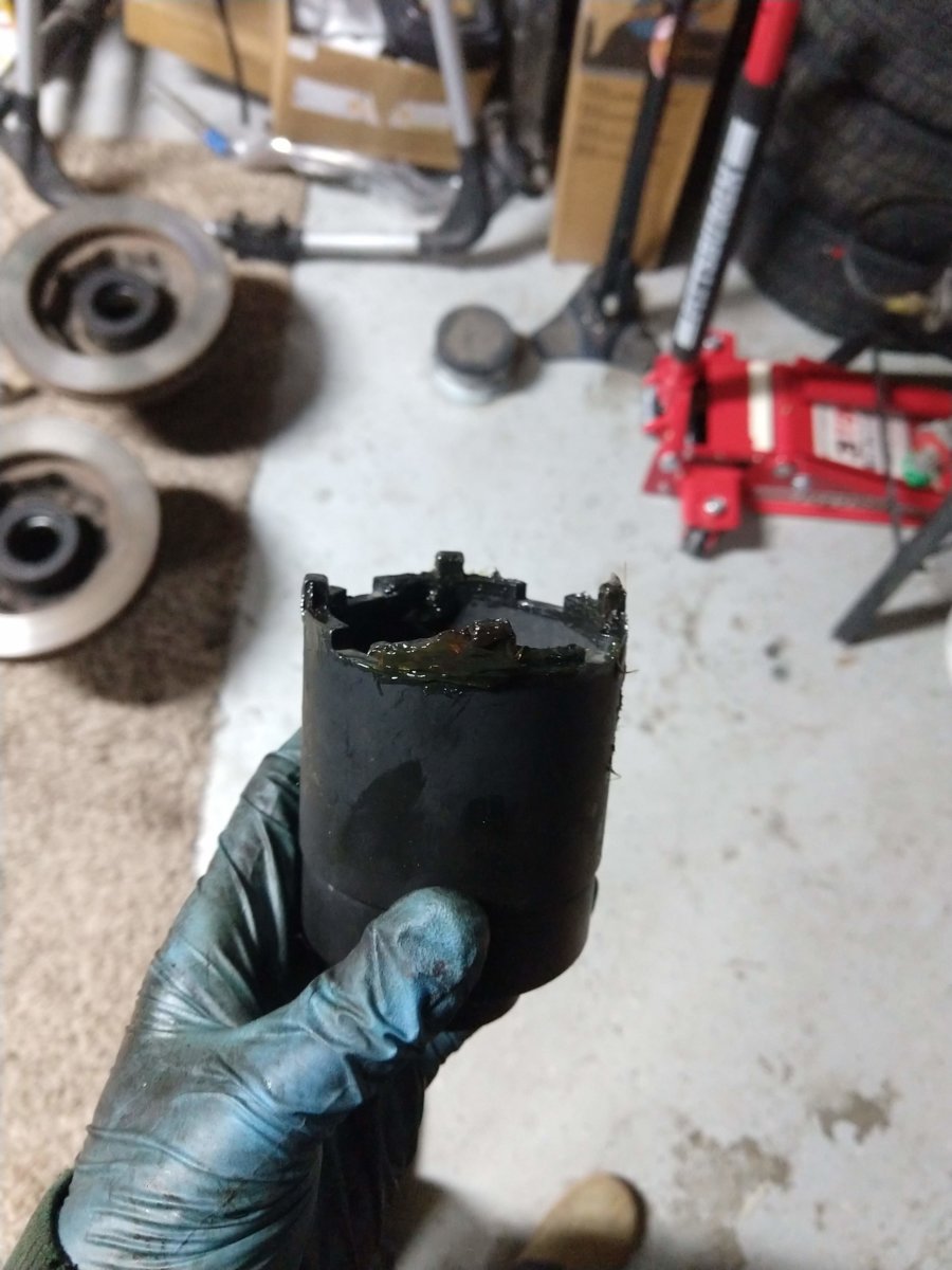

My first roadblock is that my spindle nut socket is too small for this axle. I think I need a larger one than the one I used on my K5.
Here's all the crap I have removed so far. It's not much but it's something. I am hoping to run by the parts store and make some more progress tonight.
if its a early dana 60 then there 6 tab . but even then you need to round the corners of a dana 60 6 tab socket to fit the 14ff nut . thats what i did years ao in my tool collection days to my snap-on socket .Good news is most likely the tool for the d60 is the same for the 14bff.

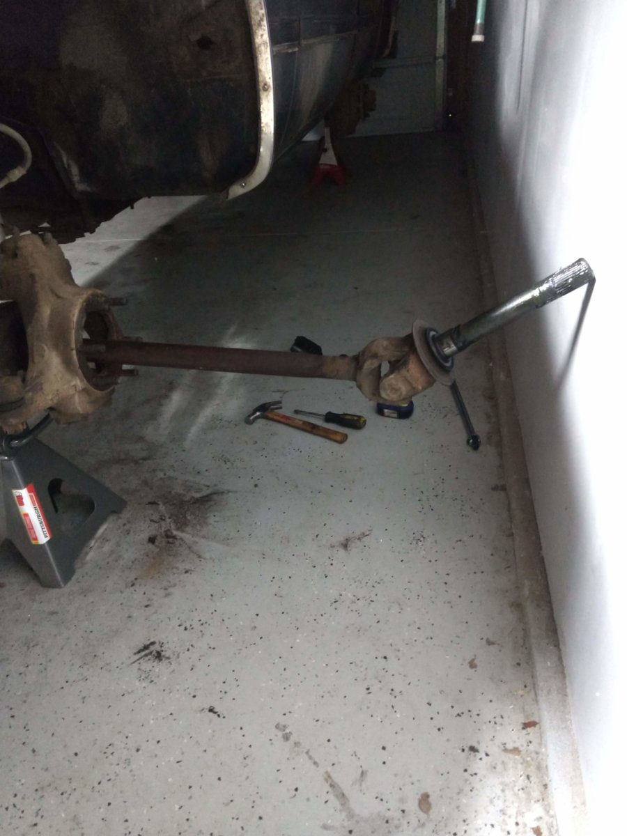

@shima where’s your casters? Roll the nose of the truck over!
Jack, roll it over a bit and pull the axle. Roll it back. Repeat on assembly.
I agree with the others; I would throw the rear tires back on and try using a floor jack to move the front of the truck over. I know that's a bit trickier with the front axle since the pumpkin isn't centered in the axle. If you have them, 2 jacks might help...
