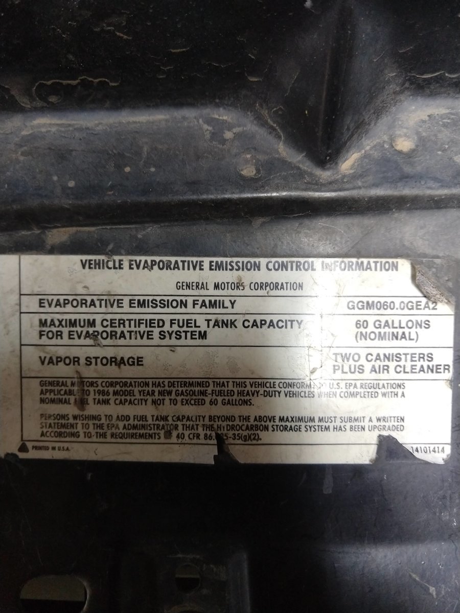

First and foremost, the radiator support sticker and the glove box equipment list:

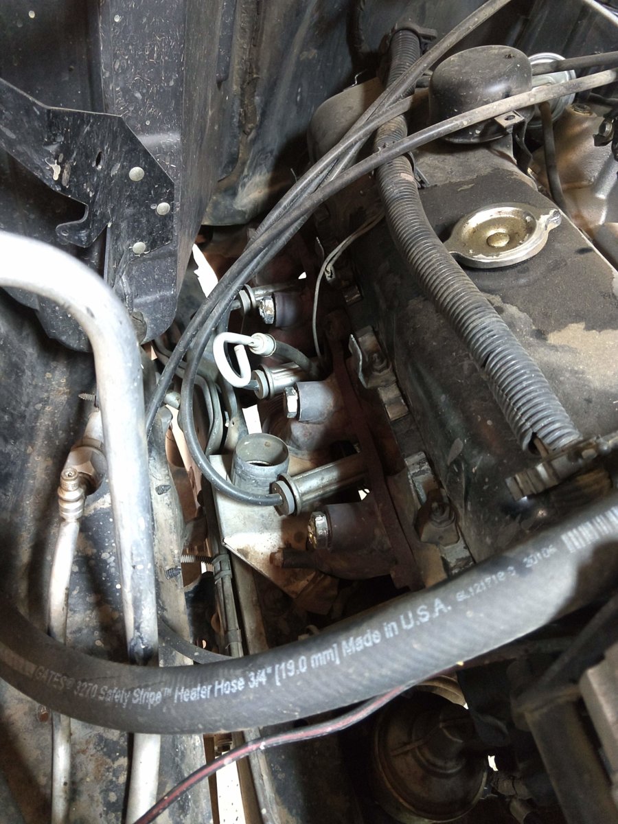

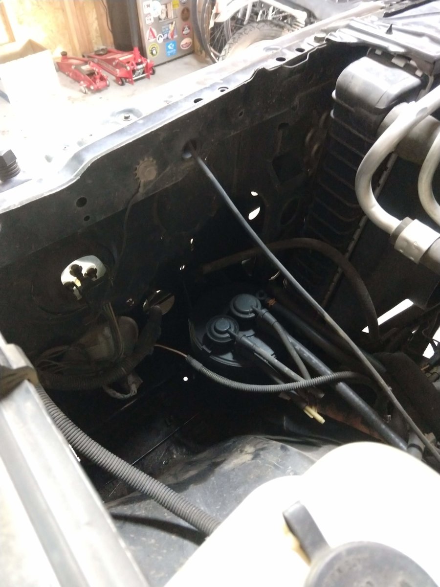

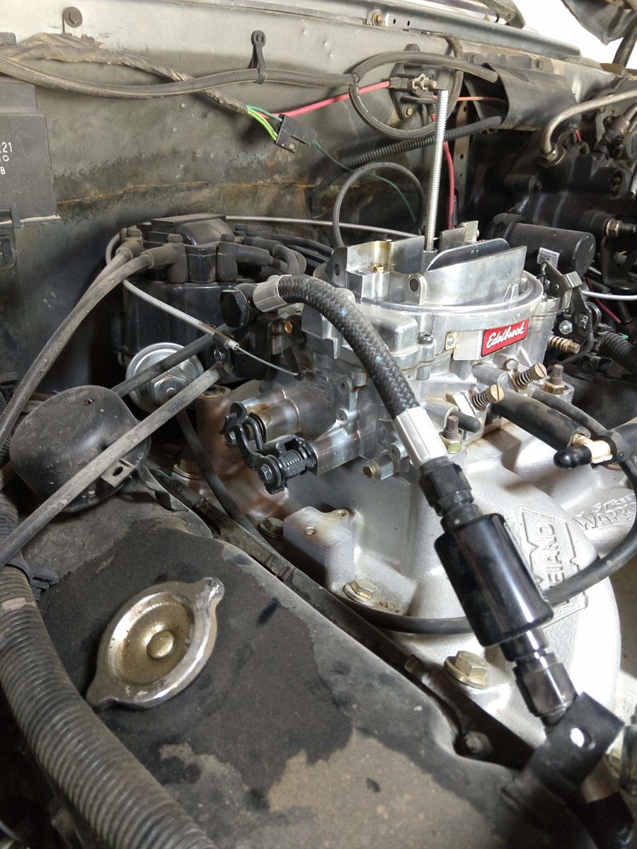

...and now a bunch of various engine bay shots:
Definitely not catalytic, Major plus.
Not sure on the EGR, but the intake does NOT have an EGR plate
the manual choke is a no, I don't see a provision for egr. the evap canister is there, need vacuum line/s from carb. vac advance will need a thermal vacuun switch in the cooling system near t stat.
the whole air injection system is missing.
I have the stock intake sitting on the floor in my garage. It came with the truck. It would be a shame if I couldn't use this fancy new intake though.

Sorry, what do you mean by the manual choke is a no? It would be nice if I did not need an EGR - perhaps I could use the aftermarket intake then?
The original setup would have had two smog pumps, two charcoal canisters and a spark arrestor in the air cleaner. I have most of the pieces, but not the lines that screw into the exhaust manifolds.
Thanks man. I knew I had to get the smog pumps. I wonder where the second charcoal canister goes inside the engine bay?

The other canister might be under the battery tray.
EDIT the carb probably ain't gonna fly.
I forgot this was a big block truck. The emissions equipment is the same anyway. So you are missing the air pump and pipes, but have the correct exhaust manifolds with pipe plugs. The intake and carb are wrong. No EGR. The manual choke is a negative but since the carb is wrong it really don't matter. Not sure what you have for an air cleaner, but I'm guessing it's not stock since it's got the intake and carb on it. That means you need a stock air cleaner for it too.

From reading your response, it seems like I'm in trouble because I have some of these aftermarket parts. Do the emissions testing folks require the equipment on the vehicle to be OEM, or is my stuff bad because it will allow too much CO / HC / NOx through?
Has to be CARB approved. They ship those with stickers if they are. You may wanna check the model numbers against the makers web site, or email them, and ask about the CARB certificate
