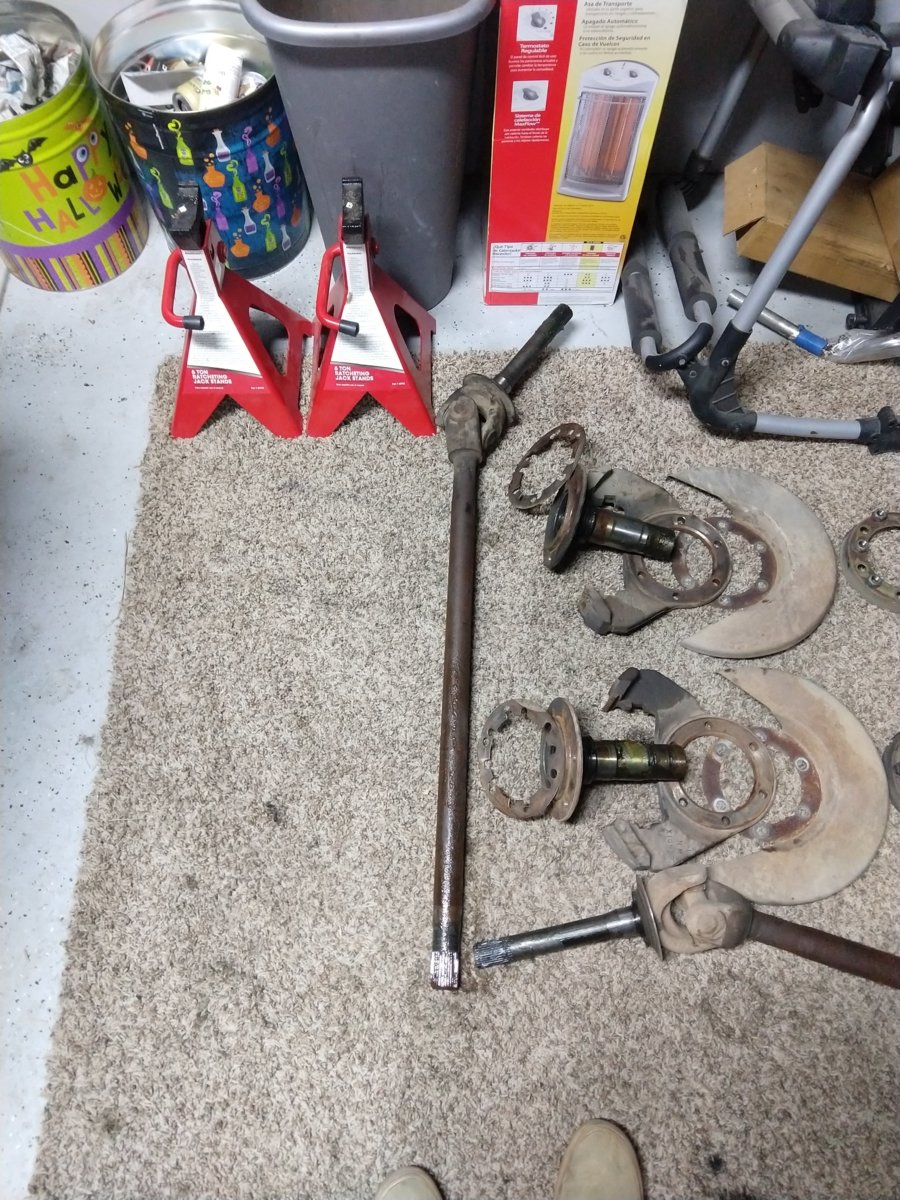

With the truck in its new position, the driver's side axle shaft came out easy!

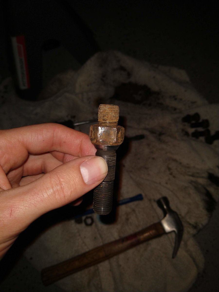

Oddly enough, the upper cap looks thicker on the driver's side than it did on the passenger side. Here is a photo of it:
There were cap screws holding the upper kingpin cap down on the passenger side, but on the driver's side it is studs. One of them unfortunately came out as you can see in the previous photo.
The bottom cap on the driver's side is stuck just like the passenger side. But I took a cold chisel to it and managed to get it to turn a little at least.

your doing just fine . stud and nut as one is comon no big deal .
lube / and work will get you there . if rebuilding the king pins then you can cheat and hammer / punch the lower out threw the open knuckle area now . the tin cap in there gets replaced anyway . so damage to it is no problem . just dont get to crazy and mushroom over the top pin of the lower king pin cap .
side note when i put them all back together i wire brush / sand out all surfaces and copper anti-seize them up good for next time .
