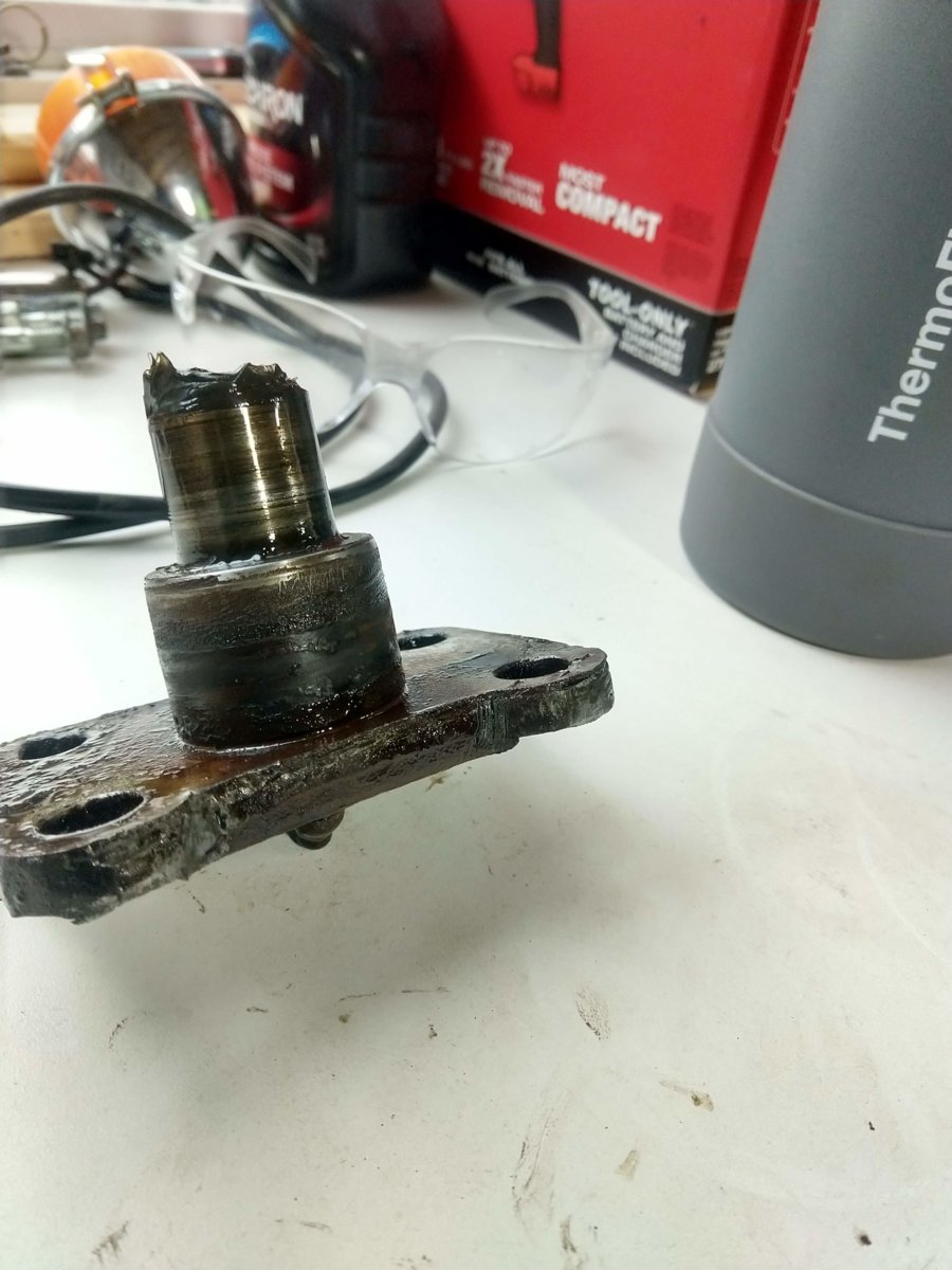

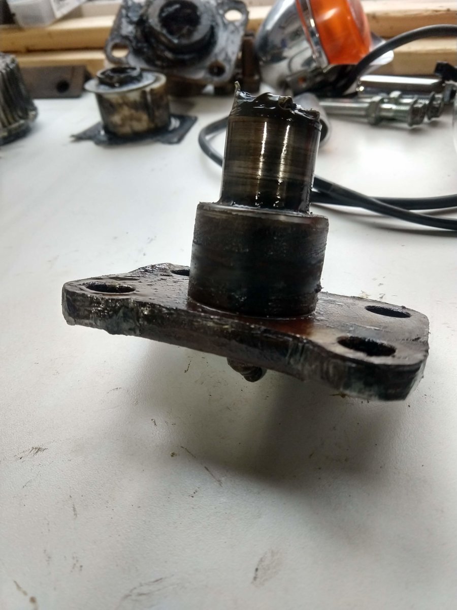

Finally got my passenger-side lower kingpin cap to move. I noticed that one corner of it was sticking out past the knuckle, so I smacked it with the hammer until it started moving a little bit.
This was its final resting place after my arm was dead tired:
I hit it with PB Blaster and called it a day.
The driver's side upper cap still will not budge. I have hit it with a hammer over and over, and I have tried using my cold chisel to move it. Plenty of "rust dust" comes off but it still hasn't budged. Same story, hit it with PB Blaster and called it an evening.
Here it is as it sits... does anyone know why the base of it is so much thicker on the driver's side compared to the passenger side?

The left side is the steering arm. It has structural integrity.
That makes a ton of sense, thanks man!

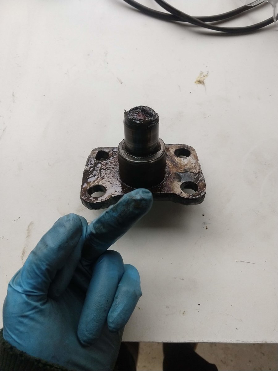

After a ton of work and even more swearing, I got the passenger lower kingpin out. Beat the s*** out of it. Some of the hardest labor I have done in a long, long time.

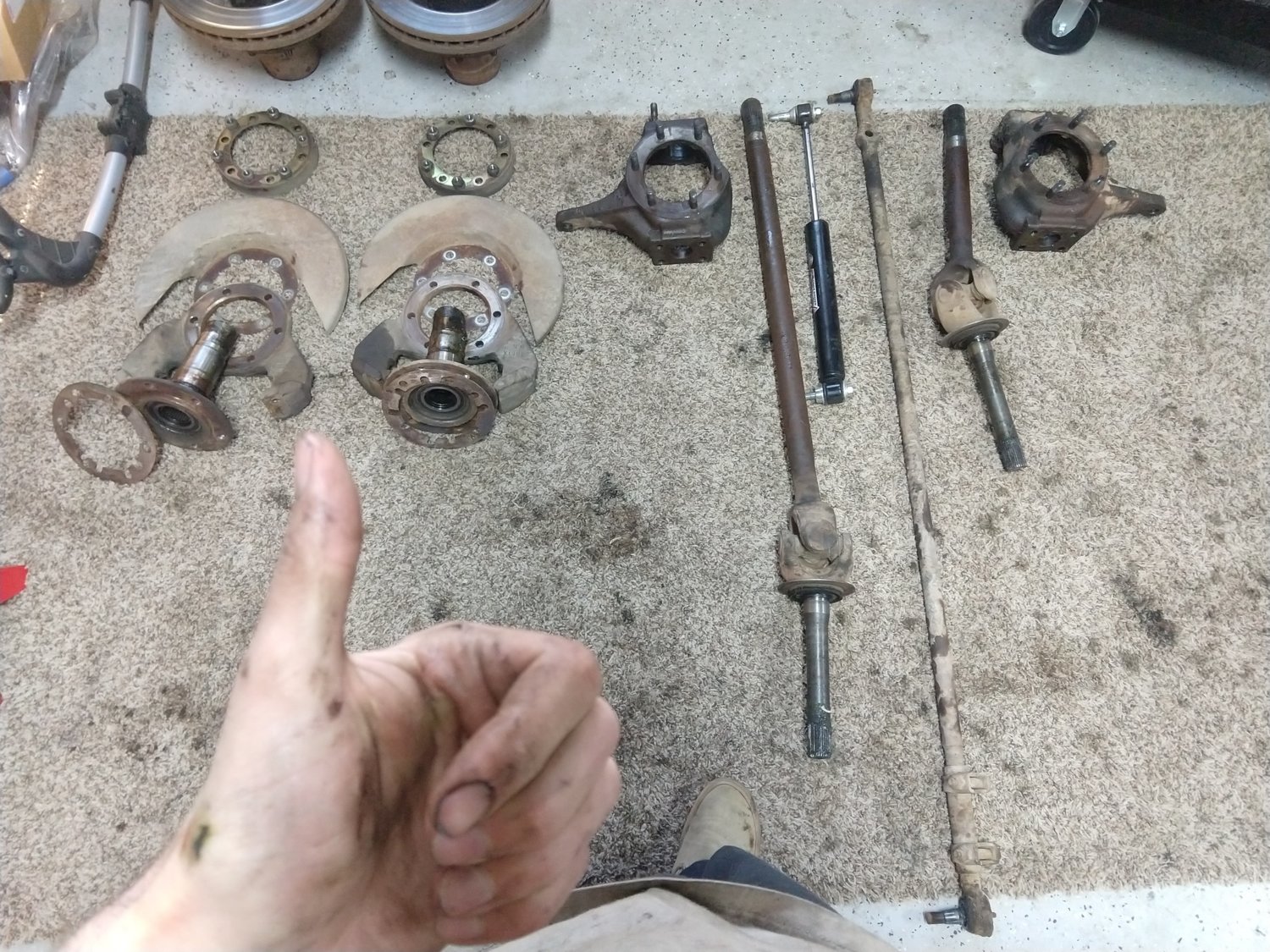

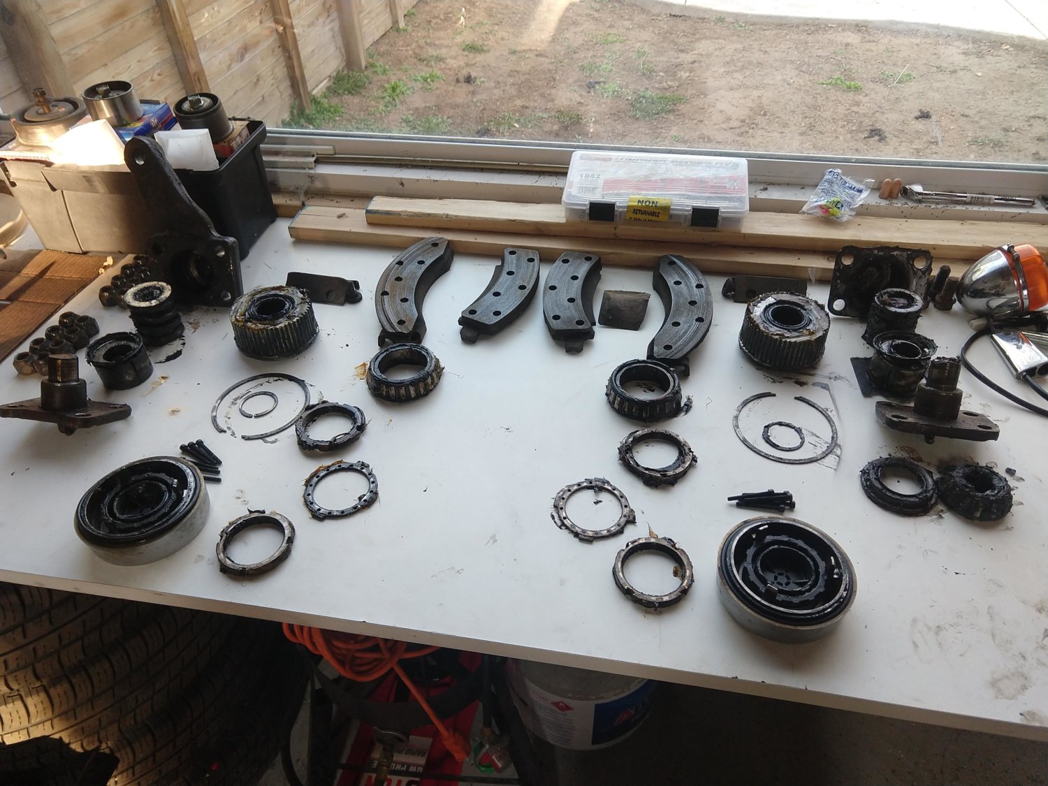

Today was a good day... I got both knuckles off! Cleaning time!!
Here are some pics from the day...

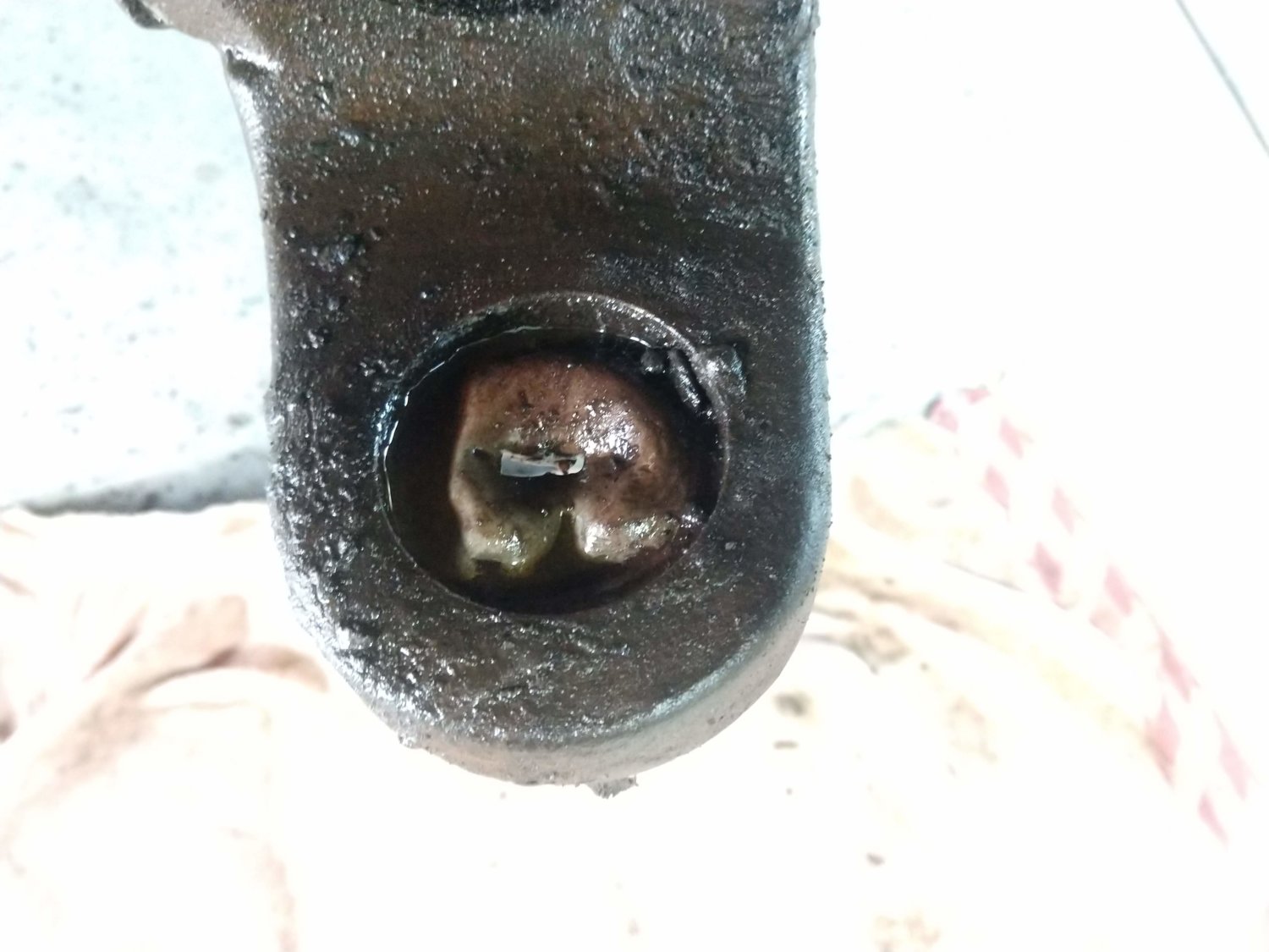

The lower kingpin races are fighting me on both sides... punched a hole through this one!

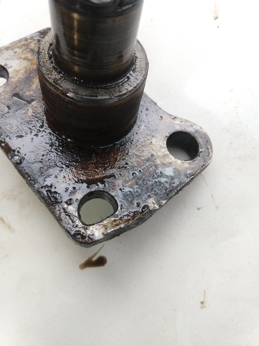

Also, I took some close-up photos of my upper kingpins. They are discolored but don't seem to be scratched or grooved. @sweetk30 I am going to re-read the post you linked right after I post this.
Here are those photos: https://imgur.com/a/fvcnr9X
First thing this morning I tried freeing my drag link without using a pickle fork... couldn't get it to go. Ended up stopping by Harbor Freight and buying a pickle fork for $10. It did the job well, but it did indeed destroy my drag link boots / bushings. Both of 'em are toast. I also used it to separate the driver's side upper kingpin cap from... the "other drag link" (not sure what you would call that thing)? Managed to save that boot / bushing despite using the pickle fork.
Overall, I'm really happy. I'm at the point where I can start cleaning. The only real "demo" left is to get those races out of the axle C. A big thanks to all of you guys for helping me through this.
