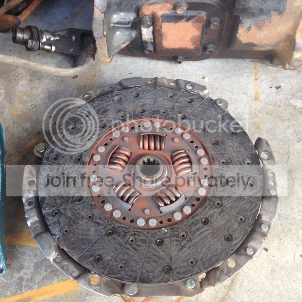

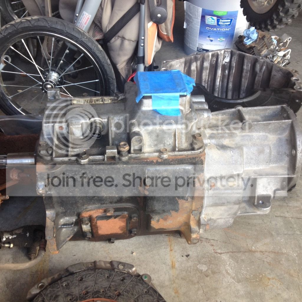

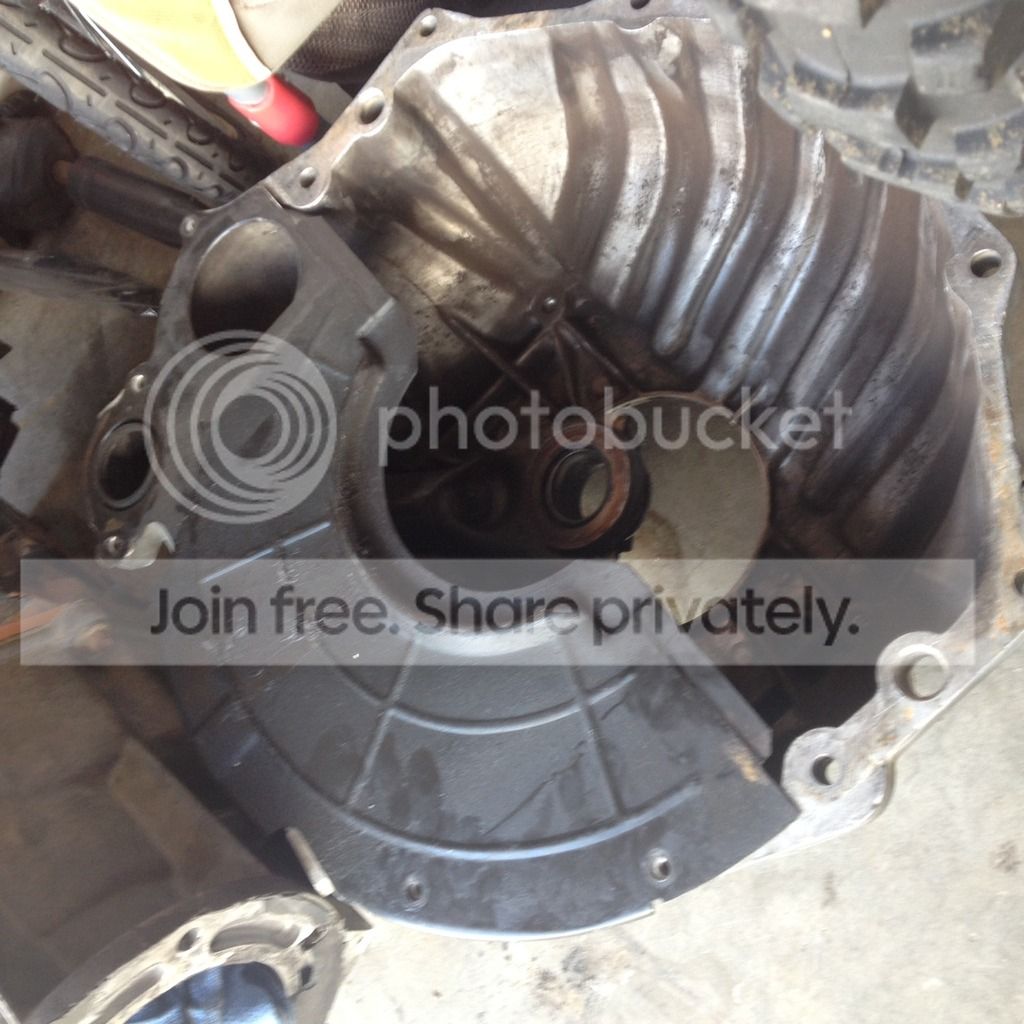

Small change....I was going to have my 97 NV4500 rebuild just for the peace of mind...until a friend of a friend heard I just picked this trans up. He has built a 95 Tahoe 2 door that he swapped an 95 NV4500 in it (with the external slave that hangs on the passenger side low), but he is 3 linking the front of his to where his external slave wouldn't work (was contacting his upper link) and he needed to get an internal slave NV4500. So he got in contact with me and asked if I wanted to do a trade with him. So I traded him (plus a little bit of cash) my 97 NV4500 that he was gonna rebuild and is what he needed, for his 95 NV4500 (same gear ratio as the 97, but an external slave) that only has 10,000 miles on a complete rebuild with a almost brand new clutch (was swapped in at the same time of the rebuild of the tranny). It was a pretty good deal and we both got what wanted/needed.
Pic of the now 95 NV4500 with a rebuild 10,000 miles ago
Pic of the external slave bell housing. I need to get a new throwout bearing, but that is easy and cheap
Pic of the newish (10,000 miles on it) clutch pack
So my new plan it not to get Advanced Adapters bell housing anymore. I am going to try and make this external slave housing work. I have read so many threads where guys say there is interference with the front driveshaft on these square bodies if you use the external slave, but I plan to lift this thing 3-4" and I have no plan to have this thing off road really (no extreme flexing) since it's going to be a fun/tow rig so I think I can make it work. The guy I got the this from said I could have his slave cylinder and the line as well and try to make it work on my clutch master cylinder. So I'm gonna give it a shot. So all I should need for the tranny swap parts gathering to be done is a 8.1 specific flywheel and bolts and I should have everything necessary for the NV4500 swap. On to gathering parts for the motor swap (including the motor, haha)

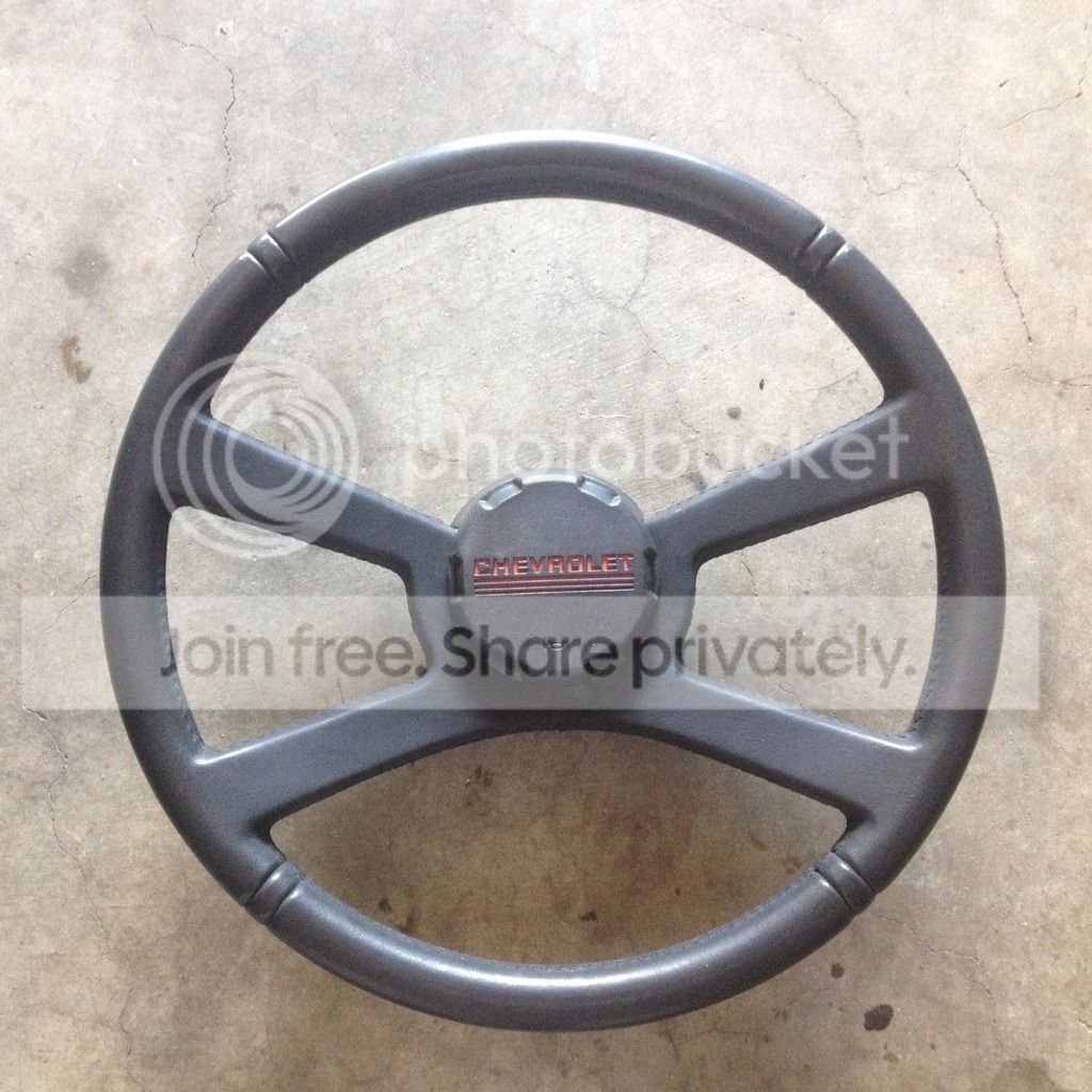

Oh, and I also picked up a steering wheel off the late 80's/early 90's trucks to swap on to this thing. I love these style of steering wheels (I have one on my wheeler too)

I found this wheel on ebay. I was hoping I would find one of these trucks on clist being parted and steel the wheel for cheaper, but wasn't finding any luck. So when I saw that one on ebay I jumped on it.

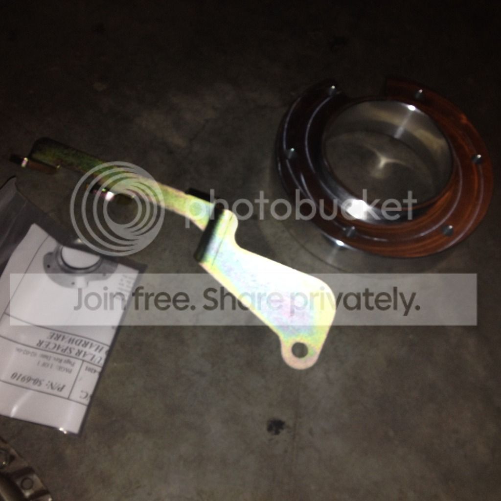

First off, I purchased this adapter from Advanced Adapters that is more like just a spacer between the round pattern np205 and the NV4500. I could have just bolted the 205 directly to the 4500 but I would have had to swap the long 32 spline input on the 205 to a short 32 spline input which would require a teardown and then I would at least do a seal kit too. But this AA was cheaper than all of that. Also, with the AA adapter on the back it makes the setup the exact same length as the TH400/205 setup that is currently in the truck so no driveline modifications. The other route it was up in the air if the stock slips on the shafts would handle the offage. I also picked up the little 205 shifter bracket too. This is the worst part of the kit and the thing most complain about that this bracket can't handle shifting the 205 and tends to bend, but I found some guys who just beefed it up a little bit and it worked just fine. So that will be what I do.
So the only thing left for the NV4500 swap is an 8.1 specific flywheel, and adapt the 95 slave cylinder's hydro line to the 85-87 master cylinder
