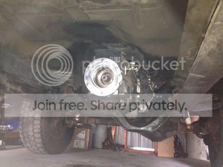

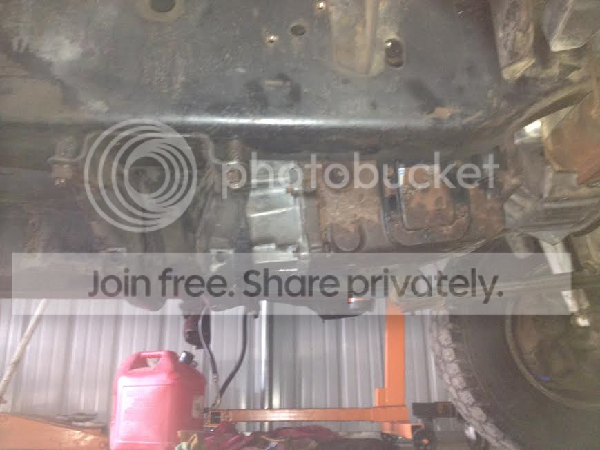

Got my NV4500 bolted up, and as everyone would expect, it was a crappy job that fought me for a couple hours until magically it just slid into place. But as I anticipated, the factory TH400 cross-member and transmission mount fit on the NV4500 in the factory wholes in the frame....I freaking love it when stuff like that happens.
Here are some pics just to prove it happened (once again sorry for the crappy pics, but in the first pic you can see the Advanced Adapters 205 spacer on the back of the transmission
And I did replace that trans mount with a new one and I moved the cross-member to on top of the frame like it was before instead of on the bottom like the picture show, just didn't get a pic of those things

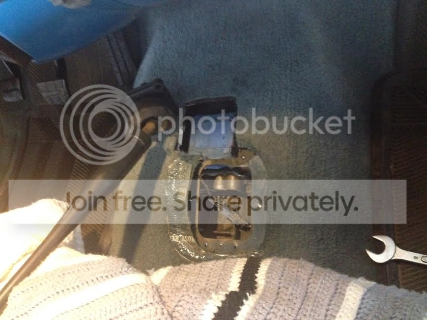

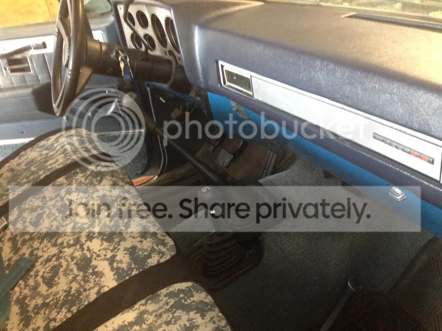

Then I cut the whole in the floor for the shifter

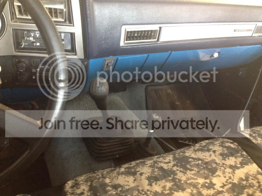

And installed the shifter
Neither the trans or transfercase shifter boots are bolted down yet, they were just sitting there on the floor in those pics

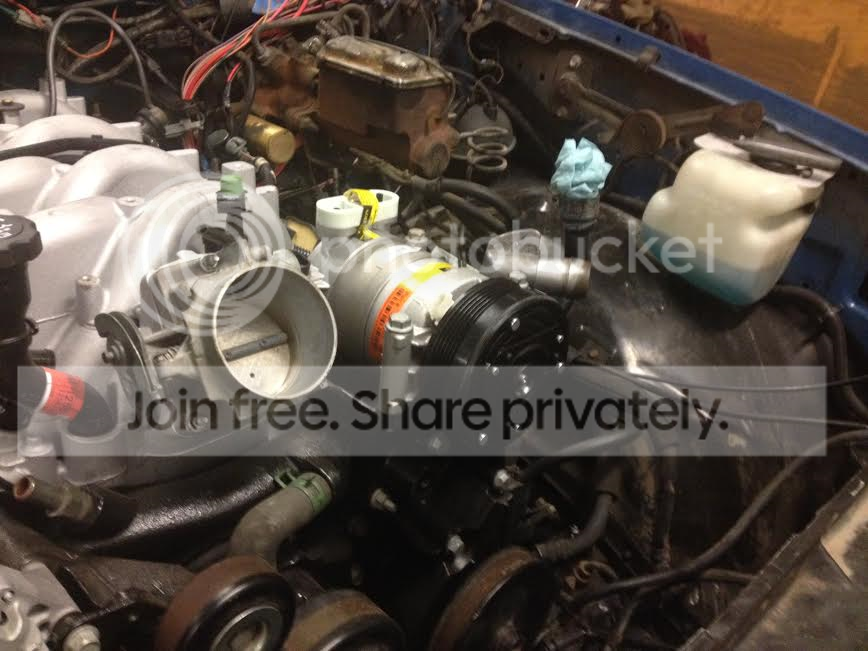

And I got an A/C compressor and bolted it up

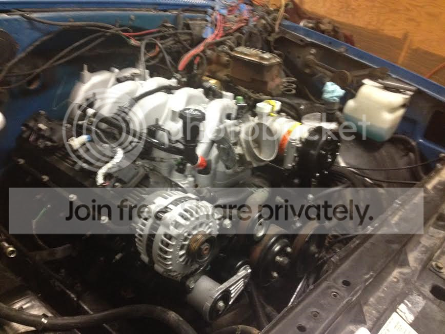

And who doesn't like pics of an 8.1 liter in a square body :D
