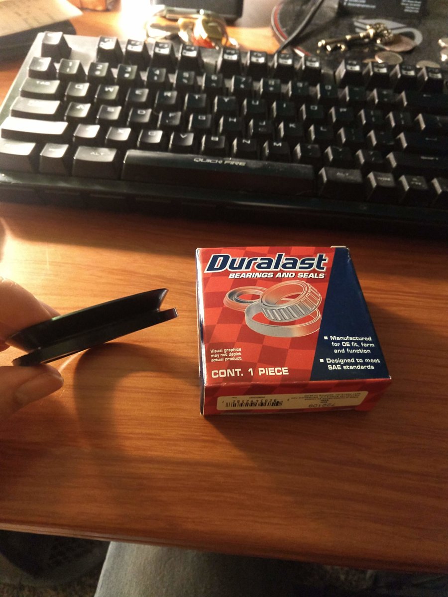

I ended up buying a couple of new hub seals:
I found the seal's part # from the kit description then searched for just that and it turned up. $5 each.

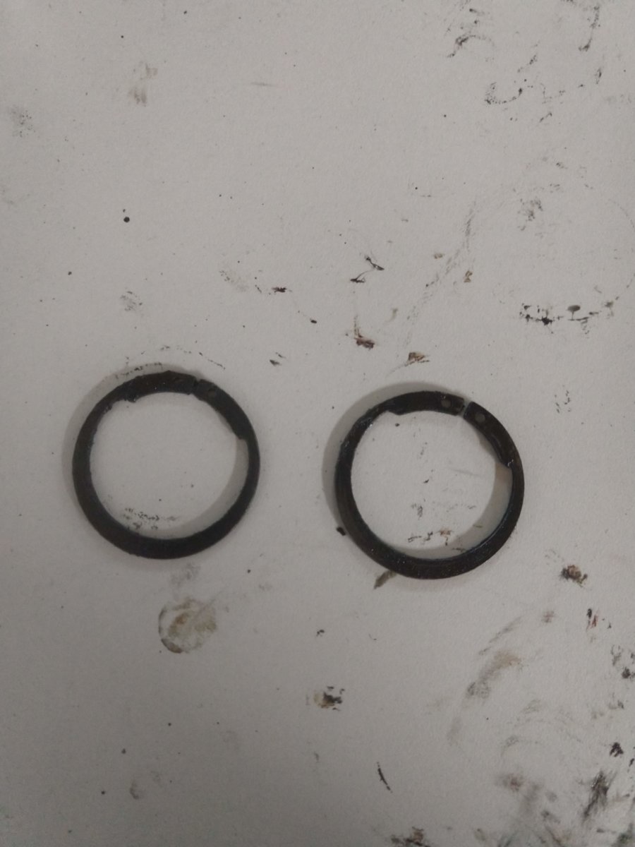

  • I couldn't get the snap rings back on. In the demo video that I linked (above), there are no snap rings at all. So I figured it wasn't the end of the world.

  • Can anyone remember exactly where the snap rings fit? I can try and get them on again, but I was having a hard time remembering exactly where they sat when I took them off. It has been a few weeks now.

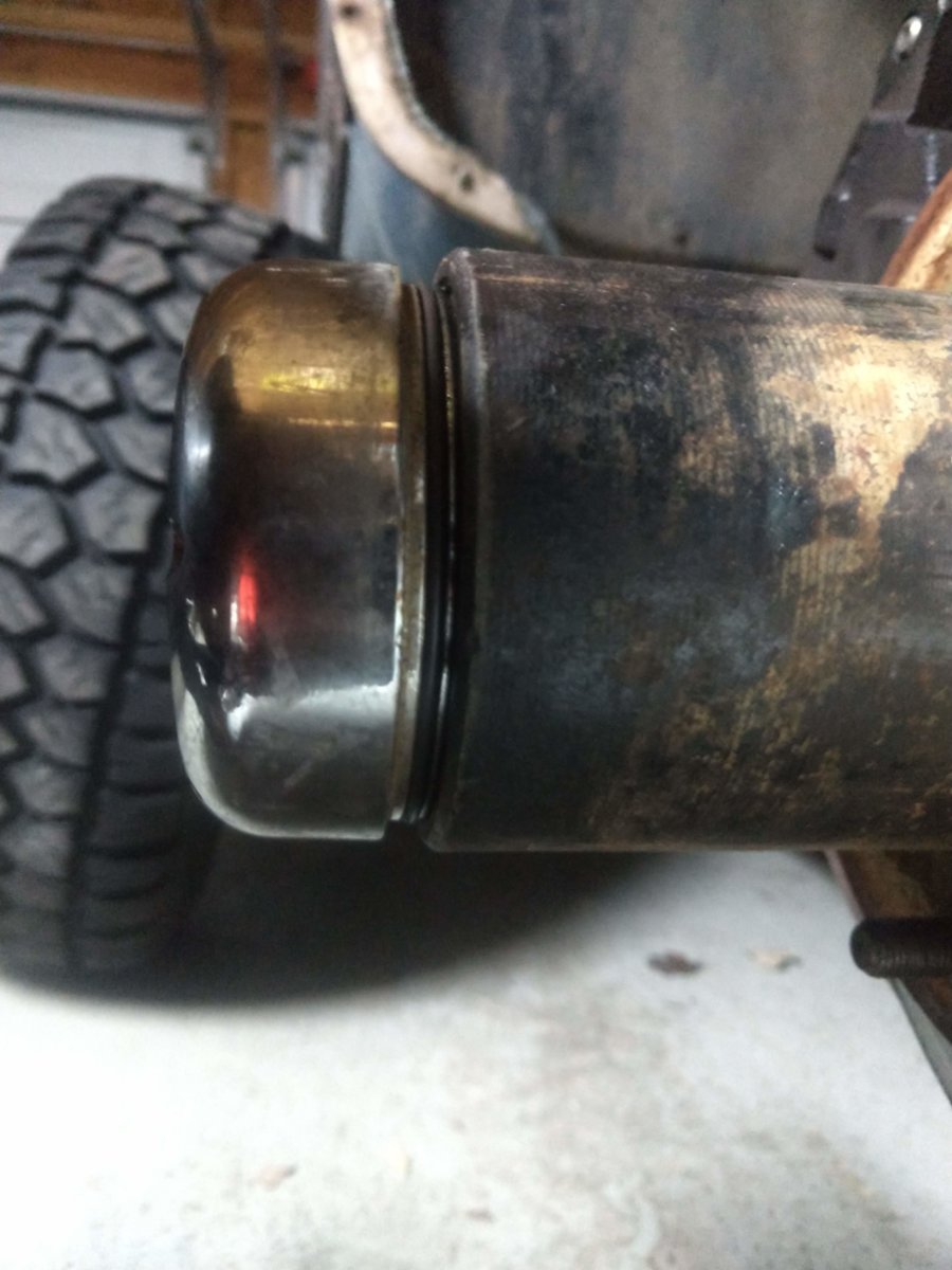

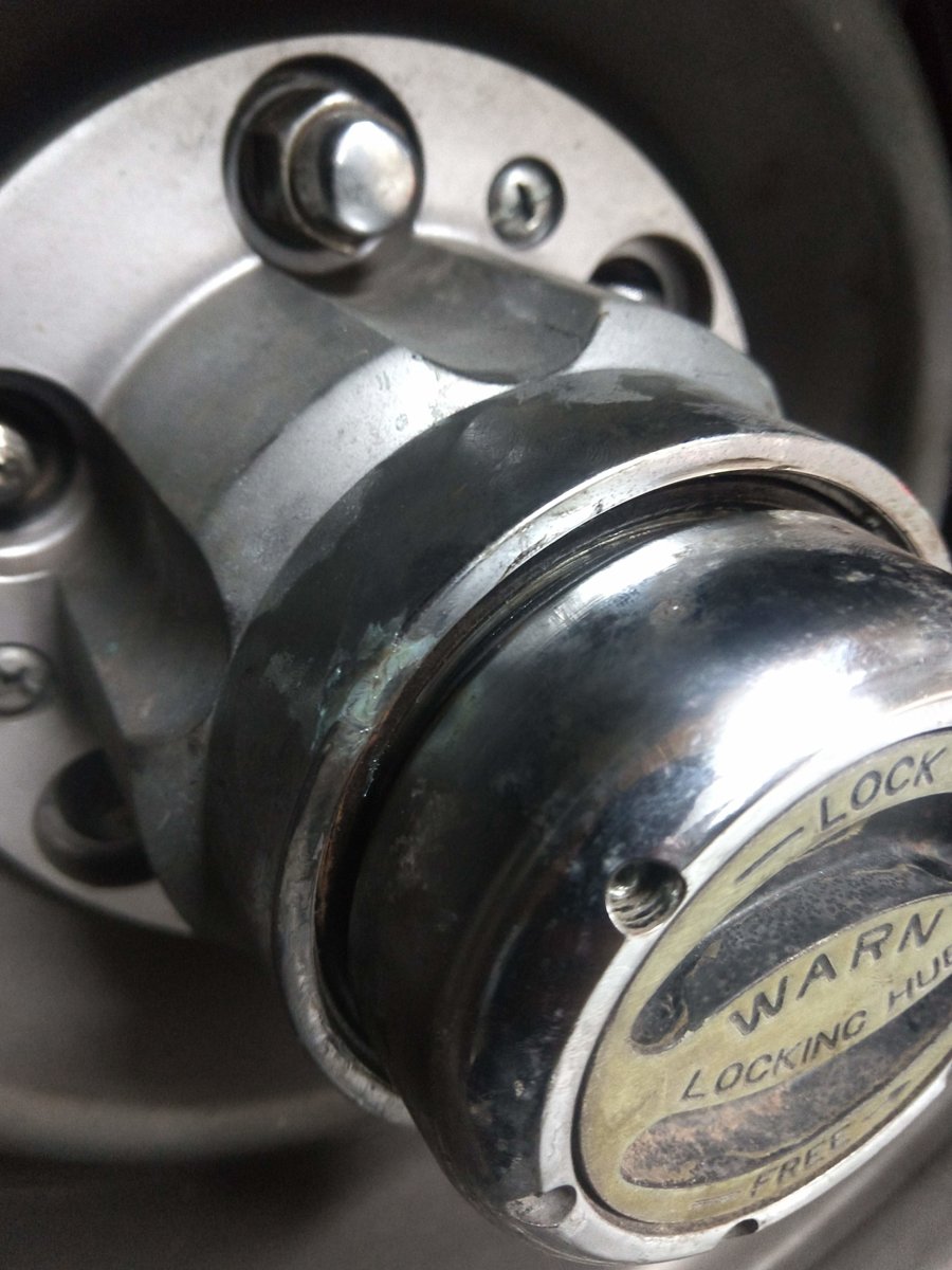

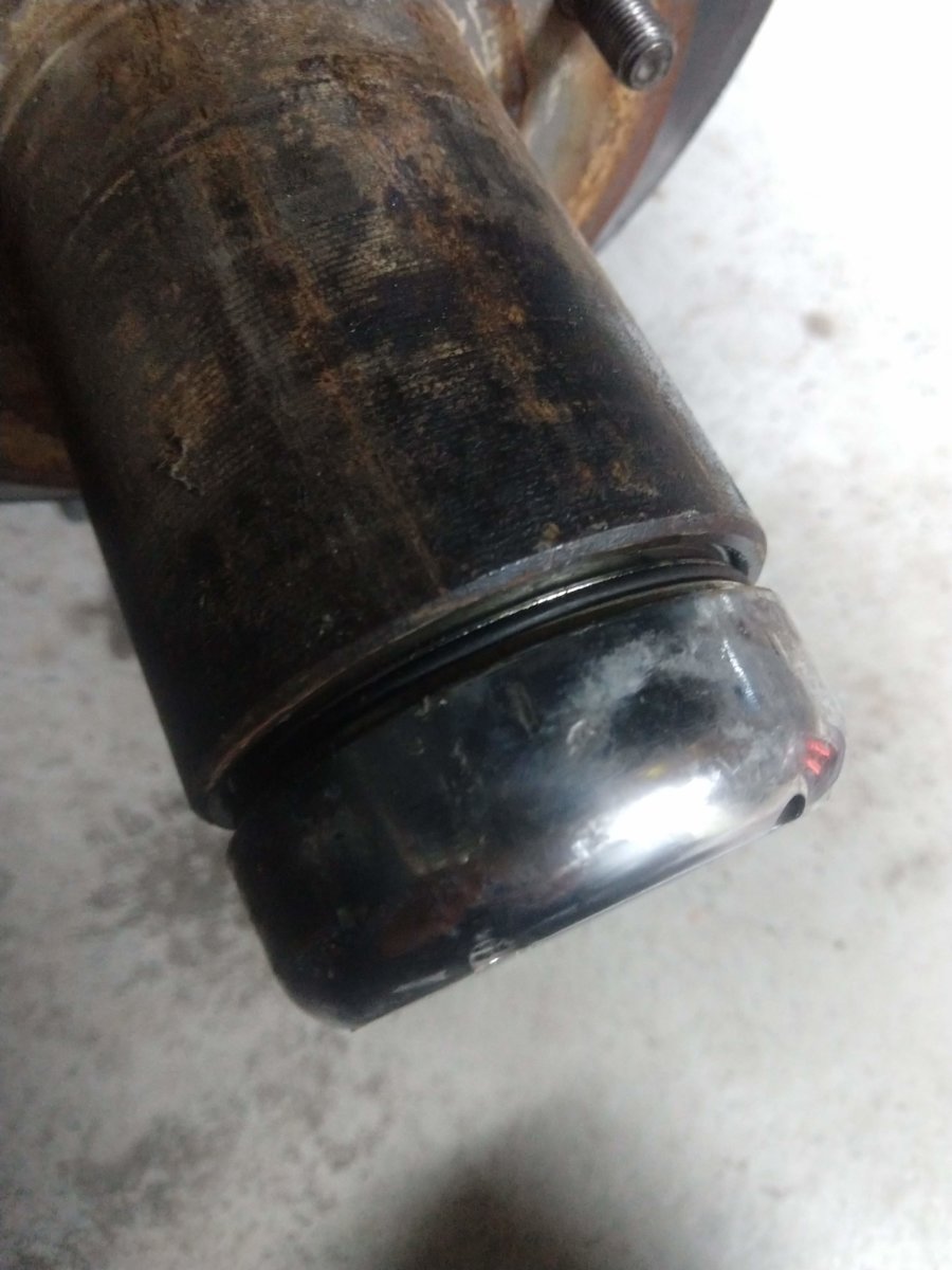

  • After reassembly I ended up with a gap between my locking hub "cap" and the actual hub body. I must have really goofed something up, anyone have any ideas?
These are the snap rings that I couldn't get back in:
Here are some pics of the gap that was left behind (this is on both driver and passenger side) after the reassembly:

Something is not seated all the way. Do not run it like this.
I won't - I'll probably just have to take it all off and try assembling again. Bummer but now that everything is cleaned and greased it shouldn't be too bad.
Welp, figured out what I did wrong this time.
Watched this video, and saw clearly that I installed the outer wheel bearings the wrong way when I put everything back together.
I had 'em put in the other way. Stupid mistake. Hopefully I didn't harm them when I torqued everything down and they were in there backwards.
