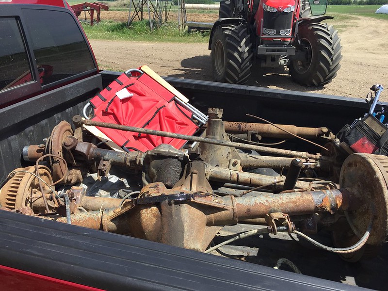

Me and rene had taken a trip out to Max02s place, in the days before i had heard a huge clunk coming out of my rear end while traveling about 70 kmph..:confused: I had mentioned this to rene and he suggested getting an extra 10 bolt would be a good option and take my time and building my 14b properly in no rush.. JUST to make something clear i have settled on the 14b SF 6 lug that i obtained and a beefier 10 bolt front. The plan is no bigger than 35s and until i break either one i wont be upgrading.
that being said after a welcoming trip out the max02s place ( thanks dean! ) we ended up with a torch and just a few axles to put into my truck for the drive home.
diffffsss

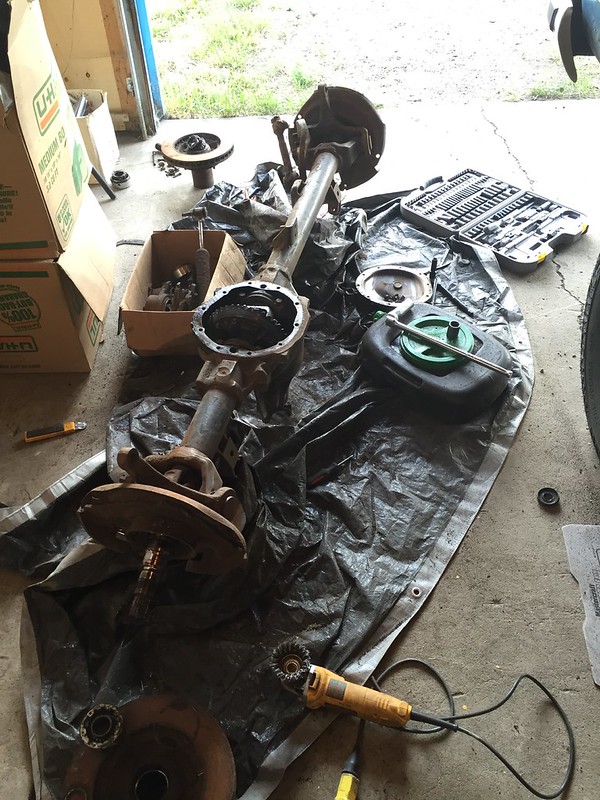

In there was two diffs , 10 bolt front and rear (3.73 gears for renes truck, as a quick moab fix) and a 14B sf rear (6lug) for me with 3.73s and a another rear for me as earlier described wheni was worried i hate a gov bomb ready to explode in my rear axle.As we discovered i have a gov lock in my rear 10 bolt as rene has described he thought was very possible considering the options on my truck.It was in fact, in very good shape and we put new gear oil and painted the awful blue diff cover black with a good buffing.

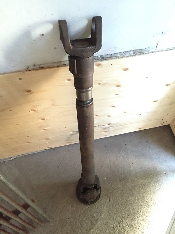

I got this front drive shaft:
Going to redo the ujoints ( spicers )and order the 1' spacer for the front axle as to not lengthen my front shaft for now.
front DS
I still need to disassemble the double cardon and find out what i need to rebuild that, Rene mentioned there possibly being a spring inside the middle.:dunno:

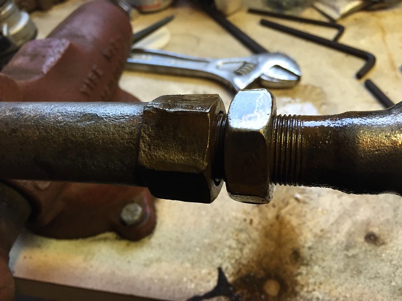

for now. Me and rene had noticed this beefy tie rod the 10 bolt had on it.
IMG_4392
IMG_4391

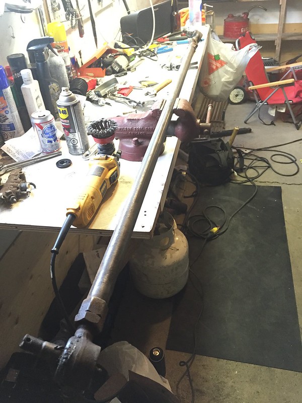

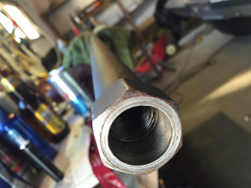

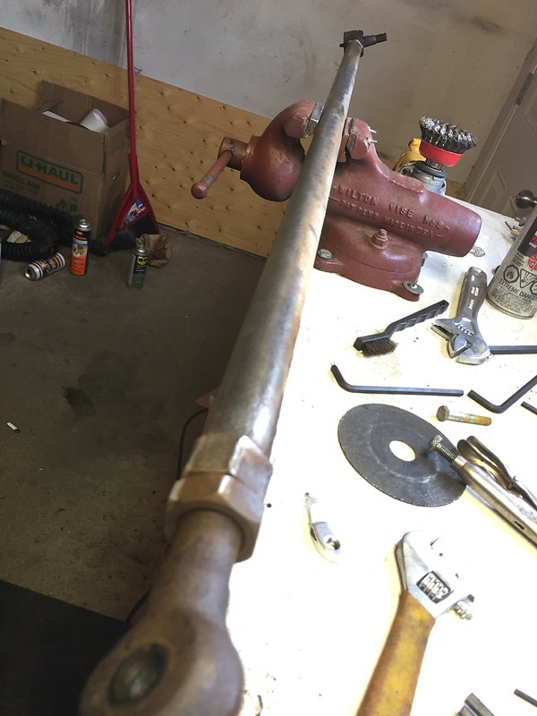

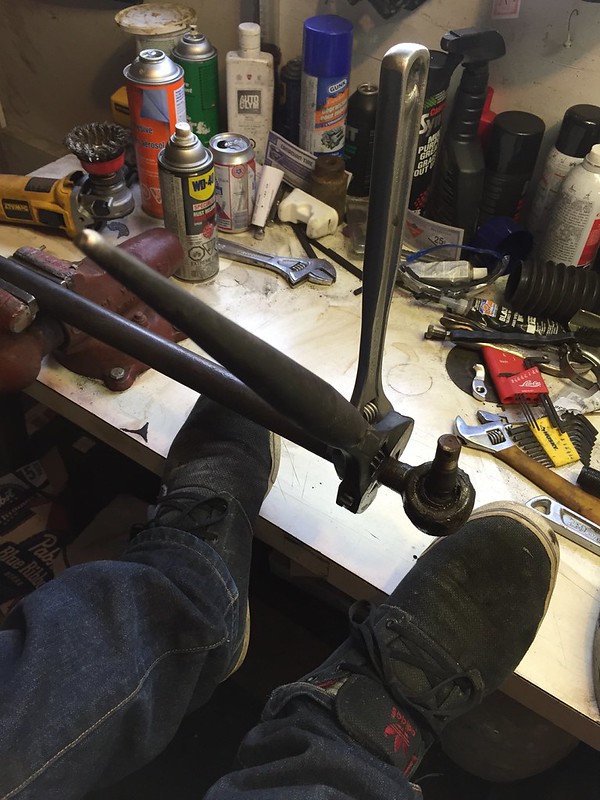

i soaked it for an hour or two in penetrating spray and got after it....
this tie rod took some convincing to undo.
stubborn ujoints

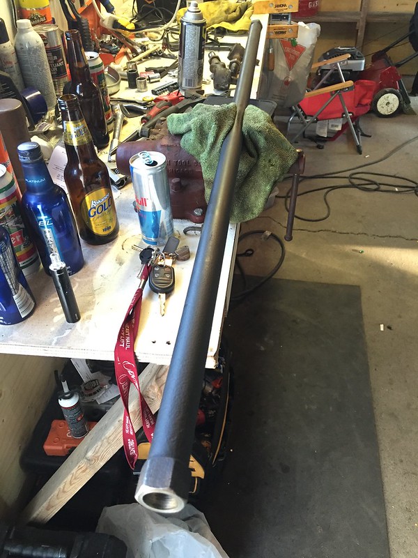

but once said and done it got it off and cleaned up with some flat black.
front tie rod off the 10 bolt
IMG_4396

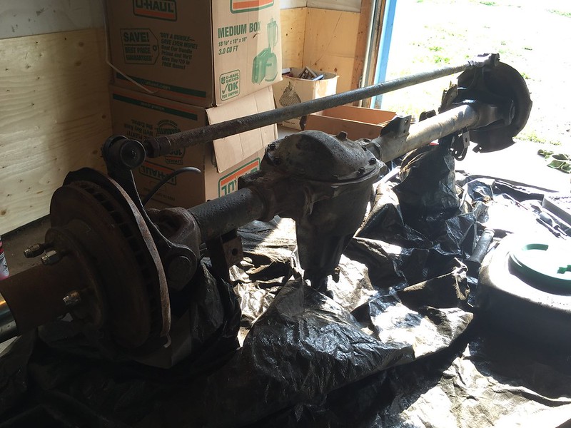

and got the diff down to the spindles for now. finding a 9/64th allen key for the one misc hub was fun but i managed to dig one out of my random tools.:thumb:
front diff

The double cardan joint is super easy to do. Just did one saturday for the first time.
The kit is like $20 or so at a parts store. I got the neapco brand one.
Pics in my build thread or i can link them here.
That tie rod seem to be a diesel thing! I got on one mine too! :thumb:

I've got the same tie rod under my 80, the axle came outta mid 80s k5, not sure if it was a diesel though.

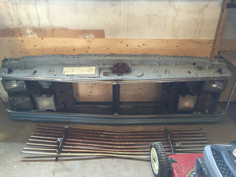

Wait, let me get this right, you are going to remove an '89-'91 grille, and replace it with an older radiator support and a tube grille???

Seeing as that 6 lug SF 14 you got has 3.73's I'd go ahead and re-gear that 10 front to 3.73...have em both ready and it'll be a one day swap when the time comes.
I'm not going to be using the tube grille I don't think but I will be changing it to the 80s style front grille, is that an unusual thing??
Torn down. If its stock you need to use a torch to melt the plastic injection out from the caps. No you wont beat it out with a hammer (Ive never seen it work)
While your at it, grind the stops on the yokes down a little bit. It will help it not bind if you get into some longer travel situations.
Cleaned up
remove ball with a puller
Hammer
This actually has a zerk that works with a needle fitting, never knew that...
Put the spring in, followed by the little brass washer (the kit doesn't come with a brass one, but the brass one that was in mine seemed a better fit as it wouldn't wear the ball out :dunno:) Then put the 3 pieces that come in the kit on top, followed by another washer and then press the seal in. I peened the edges of the yoke over so the seal will not walk out. Press works super nice to put the seal in. Fill with lots of grease.
Then just reassemble it all. I put the yoke with the springs/seal in last as far as u joint install. Seemed to make it the easiest.
Hope that helps.
