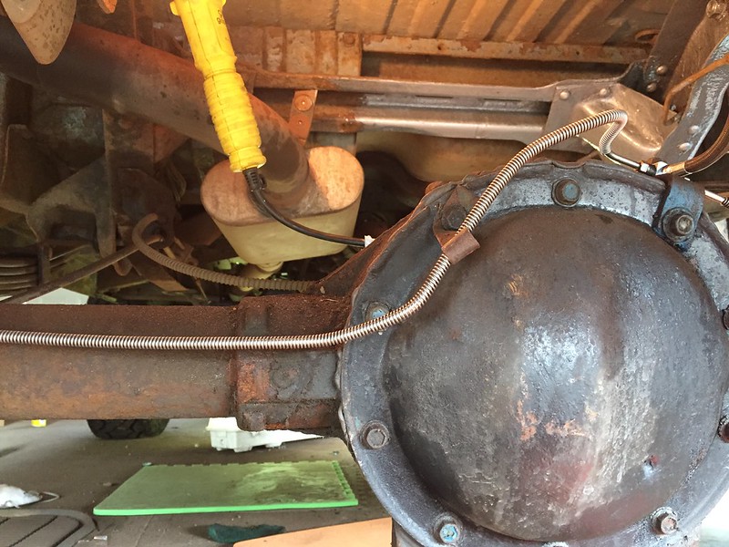

Ive been wanting to ditch all my old fuel and brake lines for awhile now as they are cruddy and rusted to chit.
IMG_4769
But with the value of our dollar and the price being 1140 canadian to have them shipped from inline tube i have been a bit hesitant.. That being said with the ORD brake lines sitting on my shelf taunting me this whole time i decided to give it a shot ( adding the extended lines...:whistle:) My plan was to get them on clean up what i could of the old ones and wait until our dollar got better.... Well the first one was so rusted but managed to get the fitting loose of the brake line at the drivers bracket.. with the rust it was hard to tell what size of wrench was actually needed and that made everything a struggle on its own.:dunno:
IMG_4750

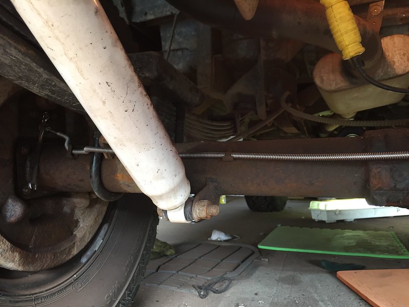

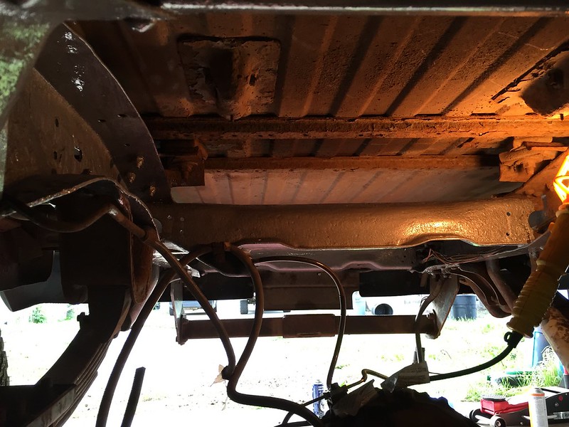

So after that one was done i headed to the passenger side. This side was a pain the ass... And after fuggin around with it for awhile it broke.. I was a little frustrated as this is the first vehicle i have ever had the time and money to work on but realized things happen and its a sign to get new ones anyway... So i removed the old one and put the new ORD one in its place for now.
IMG_4772

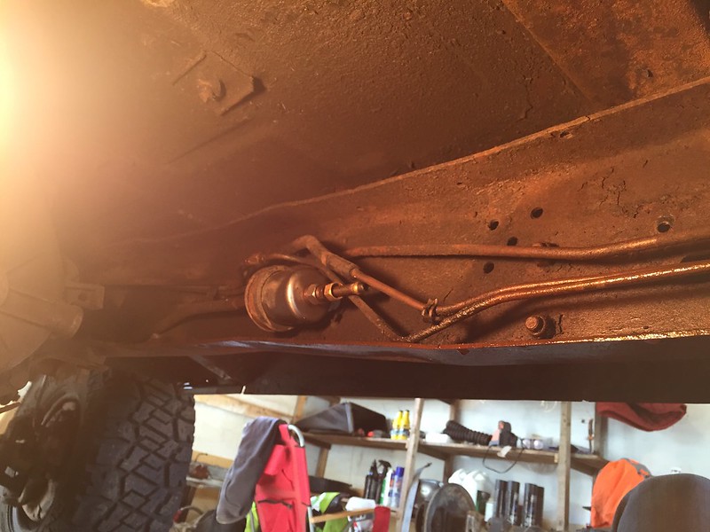

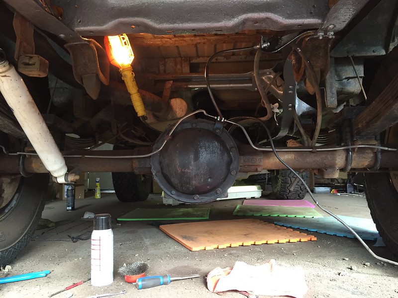

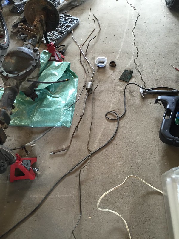

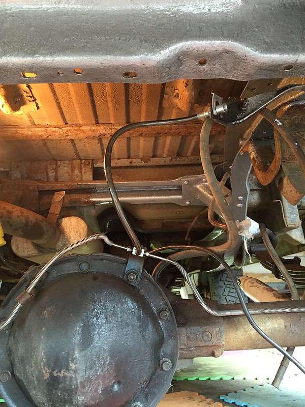

I then continued to disconnect all the fuel and brake lines along the frame, making a massive mess along the way. I knew my fuel gauge was somewhat accurate and reading 1/8 of a tank i was hoping it was less.. that wasnt the case..:doah:
IMG_4772
I made my way towards the front of the truck knowing that area with my crossmember would be tight since i have my core support and everything in...helping rene with this while his truck was apart was so much nicer. crawling around under mine was painfull. i think i ate more rust, gas , and brake fluid today than food...:haha:

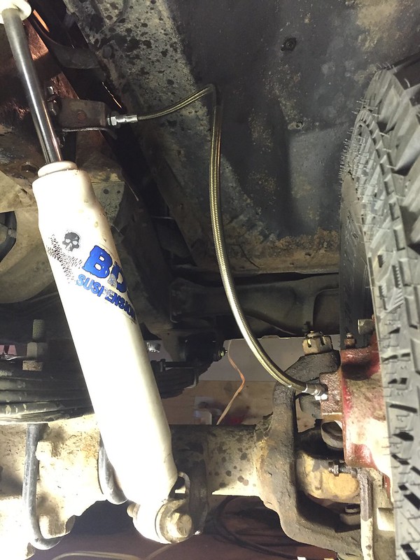

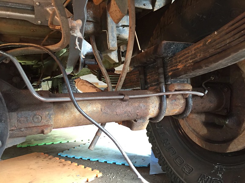

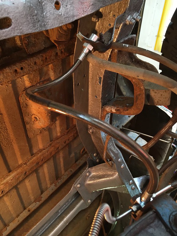

I tried to lay out my lines so that i could match the new set of SS brake lines i ended up ordering from inline tube. The fuel lines were the real spender, the SS brake lines ( with all new clips,bolts, prop valve ) with shipping came to 350 which is 433 CAD.
IMG_4792

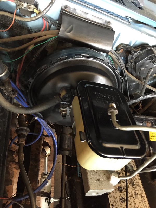

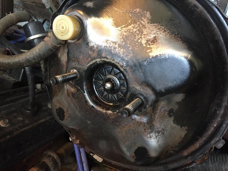

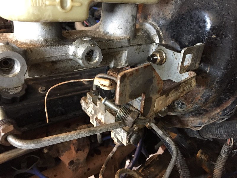

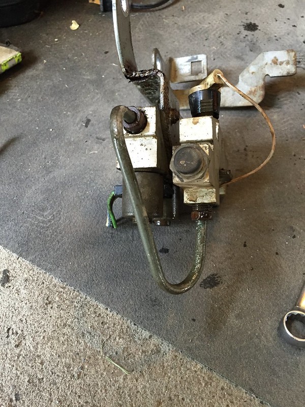

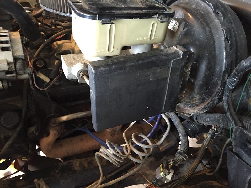

Once i made it up the engine bay i started to disassemble the mess of a useless ABS system i have that doe not work..
IMG_4793
IMG_4796
IMG_4803
IMG_4804
IMG_4807
Was there 2 prop valves in these models..? either way this abortion of a braking system had to go!:waytogo:
IMG_4804

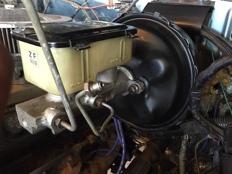

I cleaned up the master cylinder and added the two lines and put some fluid back in as to not dry it out. I scuffed and painted it black and cleaned out all the gunk around the connections and put it all back together.. :bow:
Looks so much cleaner and less cluttered.

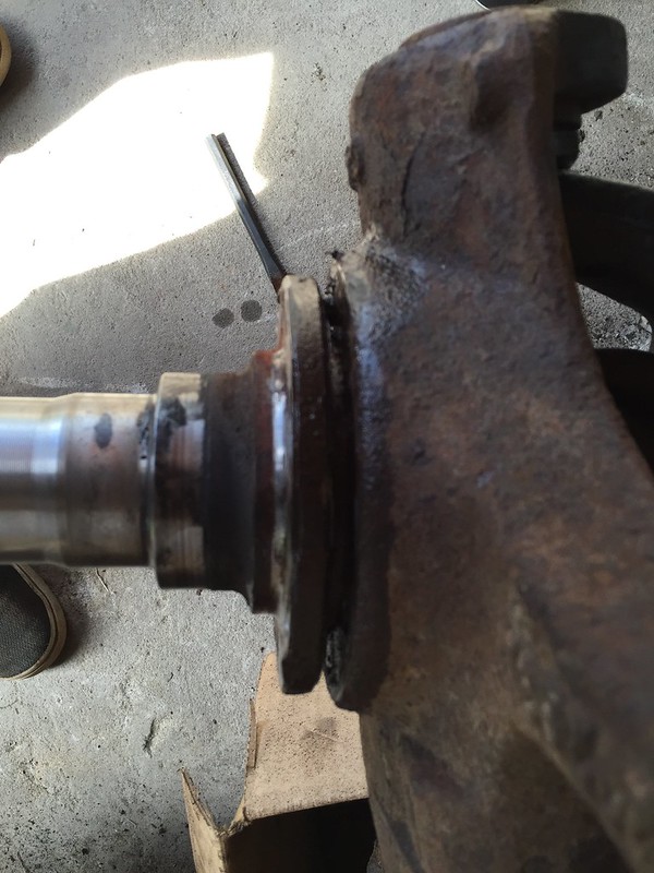

On the 10 bolt spindles...smack the threaded end of the spindle down,sideways,up...with a hammer. Carefully BTW! Use a nice piece of wood to protect the threads. That is actually the way they tell you how to remove them in the manuals.

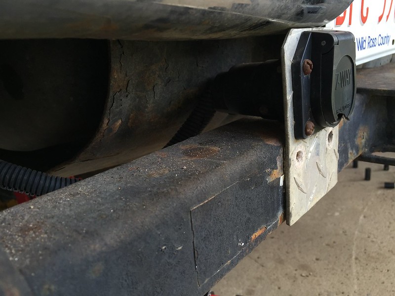

The only thing stopping it was this trailer brake connector that i have taken off as i cut all the trailer brake controls out of the front dash anyway. The thing is an electrical disaster so far so i am getting rid of anything not stock and will redo anything i feel the need for down the road, as for now i dont even own a trailer so its going in the trash.

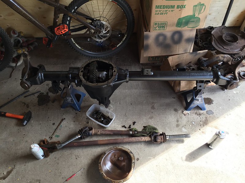

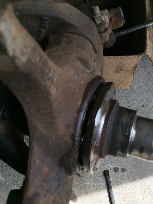

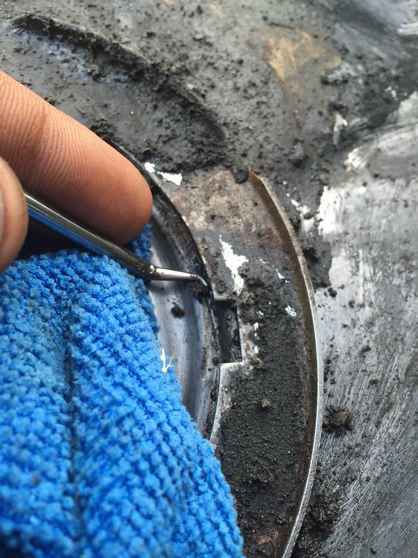

I also managed to get the spindles off... good lord that was a battle. Cold chisel and a 5lb hammer. i kept telling myself it doesnt have a brain and i do so i can figure this out. i tried everything and had to result in brute force. :thumb:
IMG_4832
IMG_4833
IMG_4838
I am going to clean up the axle shafts and keep them for spares. New ujoints and all that before they get stored for trail spares.

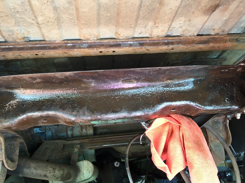

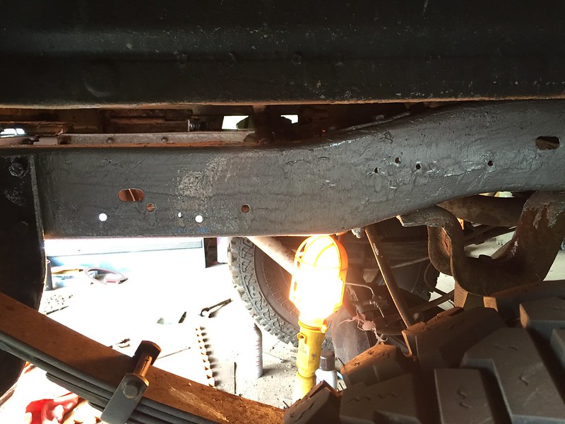

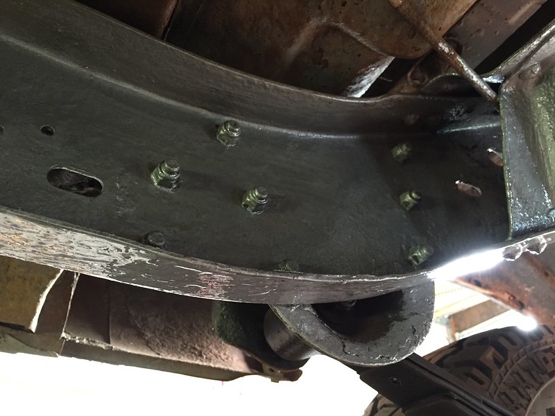

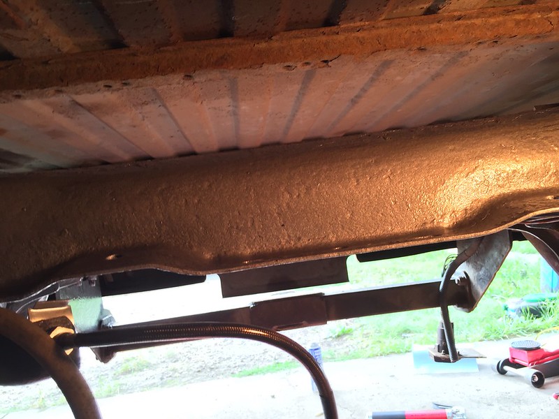

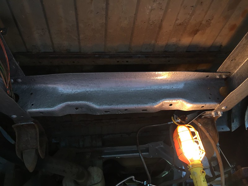

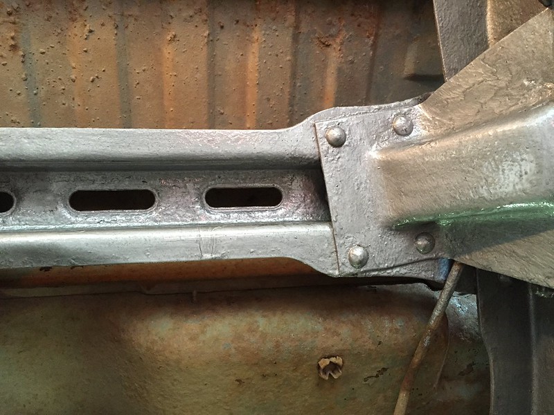

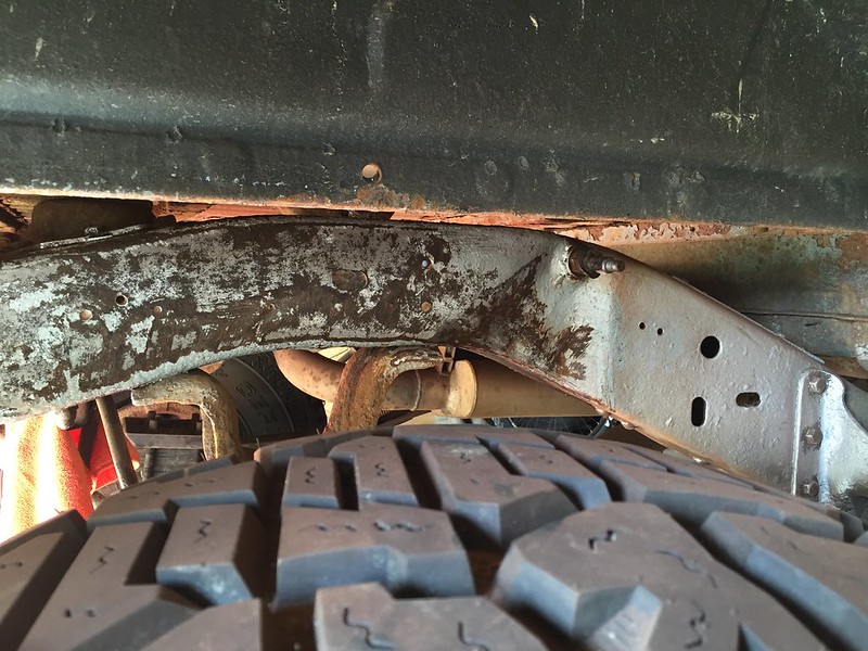

I also managed to coat one side of the frame rail with por15, i got the side with all the lines run on it done now as the other side still needs to be wire wheeled and prepped. I didnt want to leave the steel exposed so I covered it for now and ill wait until its all done for now until i paint.
IMG_4817
IMG_4815
There was some left over tar like rhyno liner that used to be on the frame.. Was going to burn the grinder out trying to take it off so i just got the rust off and went over it.. Id like to meet the old owner of this thing one day....:doah:
All the rivets had been removed from this truck and replaced with bolts except for the crossmembers in the past which leads us to beleive this has been frame offed at one time. I pulled a CARFAX report and it states it was purchased in 89 and from 99-2005 it wasnt registered.. They definitely could have done alot better of a job on the frame off... Lots of things werent touched or done well.. and this gooey rhyno liner crap is annoying as hell. But its nice in a sense because some parts of the frame i cant get too are still in good shape so im not too worried about those areas for now.

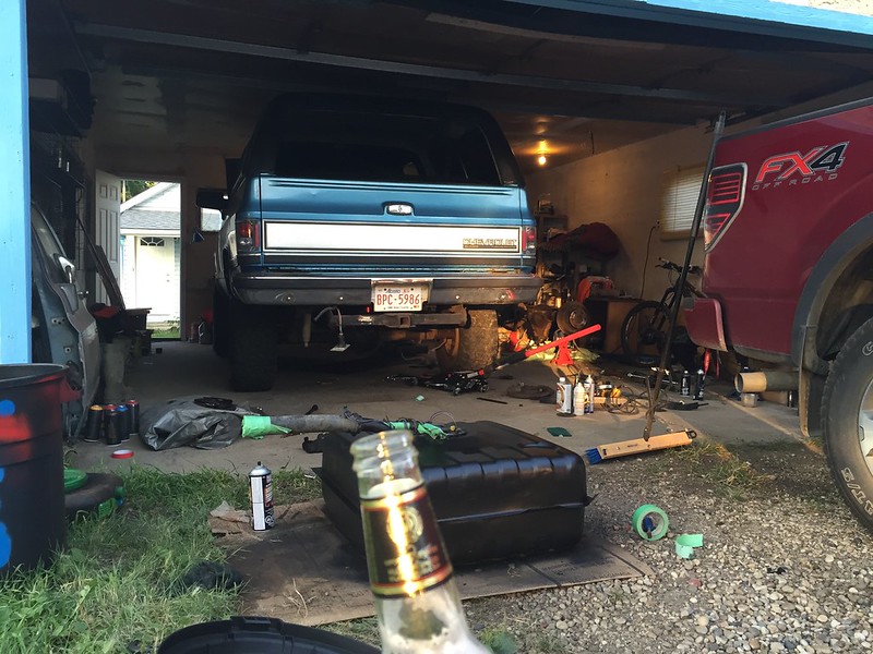

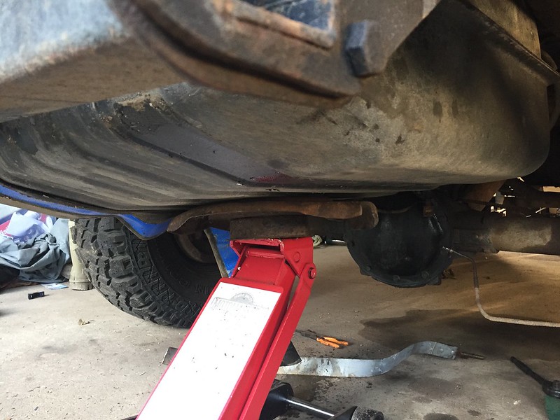

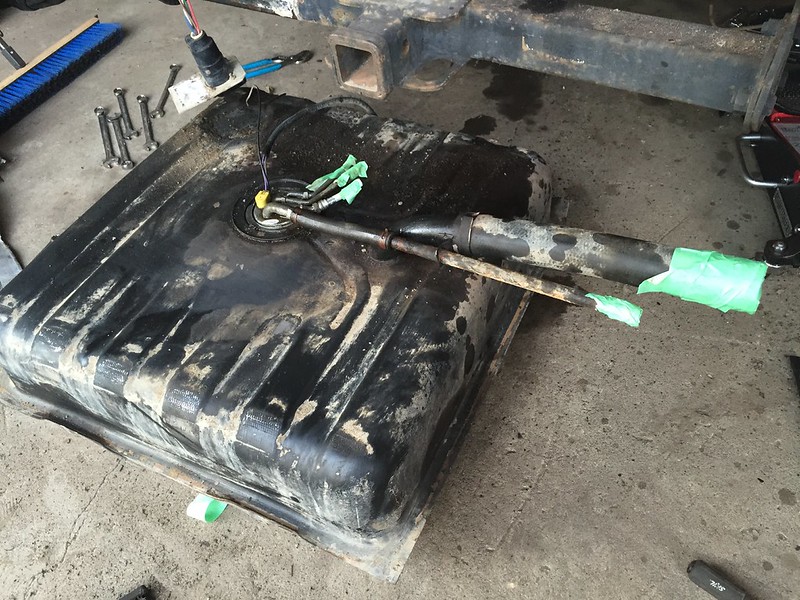

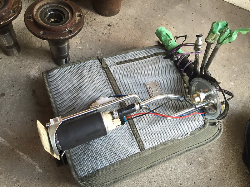

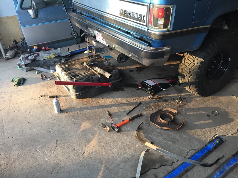

So tonight i had some free time after work and decided to work on the k5. I managed to drop the tank without taking off the bumper and that i was happy about. I still may take off the bumper but im not sure at this point. I want to cross some things off the TO DO list...

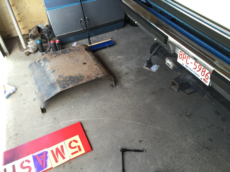

I had removed the skid plate a few days prior to tonight's crack at things.

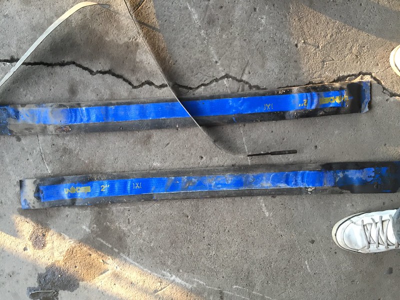

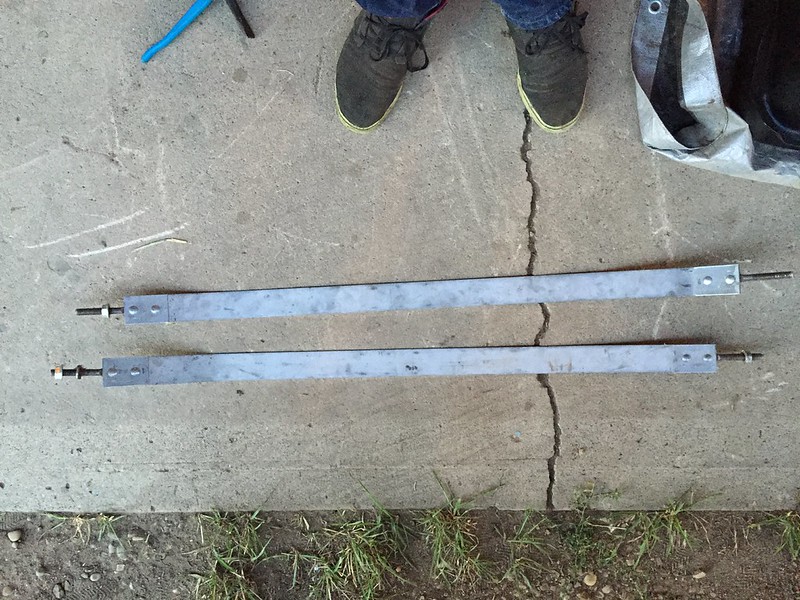

3 of the 4 gas tank strap nuts were nice and loose as the tank had been down to have a new SPECTRE pump put in when I first got the truck. But one kept binding. I had tightened it back up and brushed the rust, and loosened it but once the strap got loose the momentum was put into the strap and it started to twist, got all bent.... so i ended up just cutting it off. I didnt have anything to put on the jack to balance the tank while I cut the last strap, so I grabbed one of the 10bolt spindle knuckle guards and it sat on the jack perfectly
IMG_4904
Not such a bad idea when you have these laying around
IMG_4960
It was also nice the anti squeak straps were replaced at the time the tank was put in before i purchased this blazer.

I lowered the tank, disconnected the return line that was still hooked up, as it stretches across the rear cross member, along with the ground for the fuel pump. ( Noticed the ground was in rough shape so that may help my gas gauge reading )

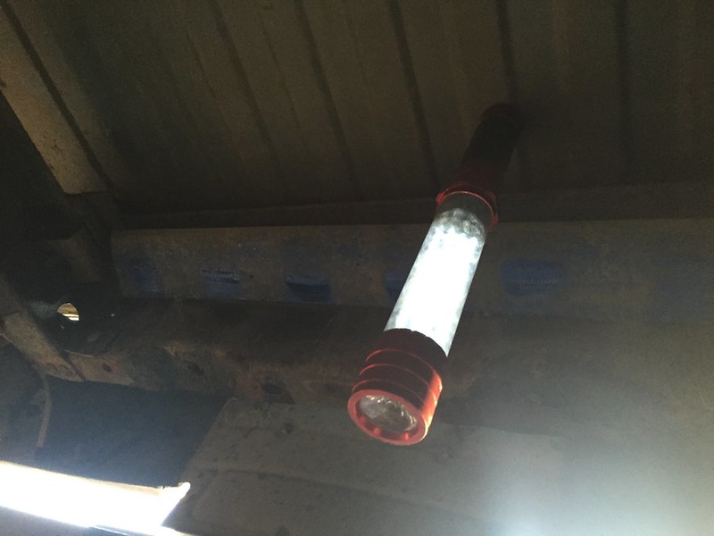

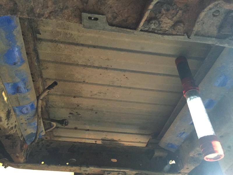

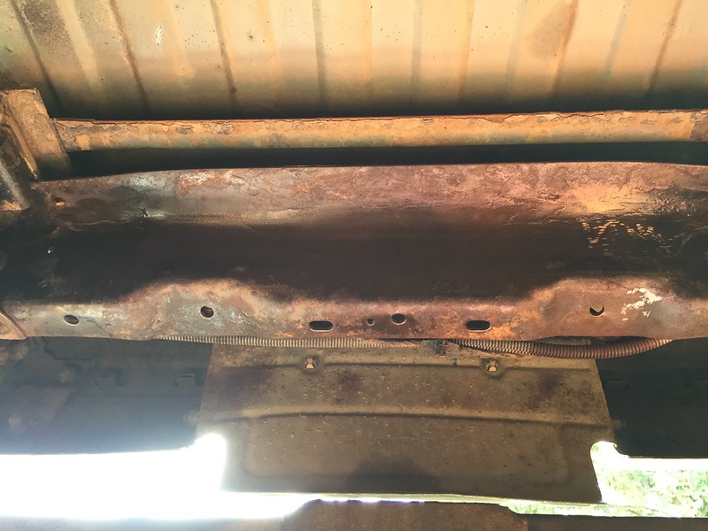

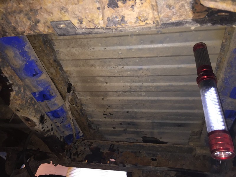

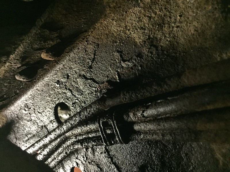

Once the tank was down, i looked up at what i was going to have to tackle for frame cleaning in that area. It wasnt as bad as it could have been, but i wish it all looked like it did ontop of the tank!
IMG_4911
IMG_4914
IMG_4920

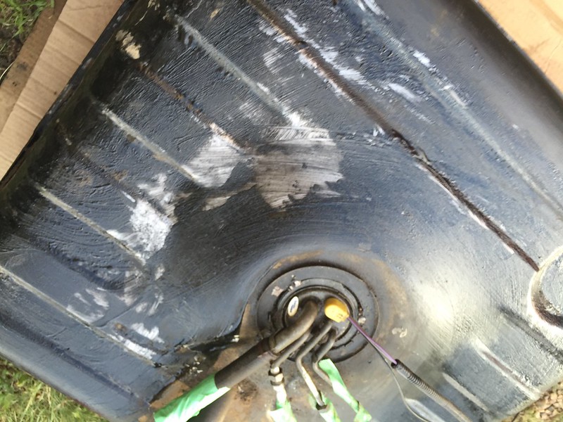

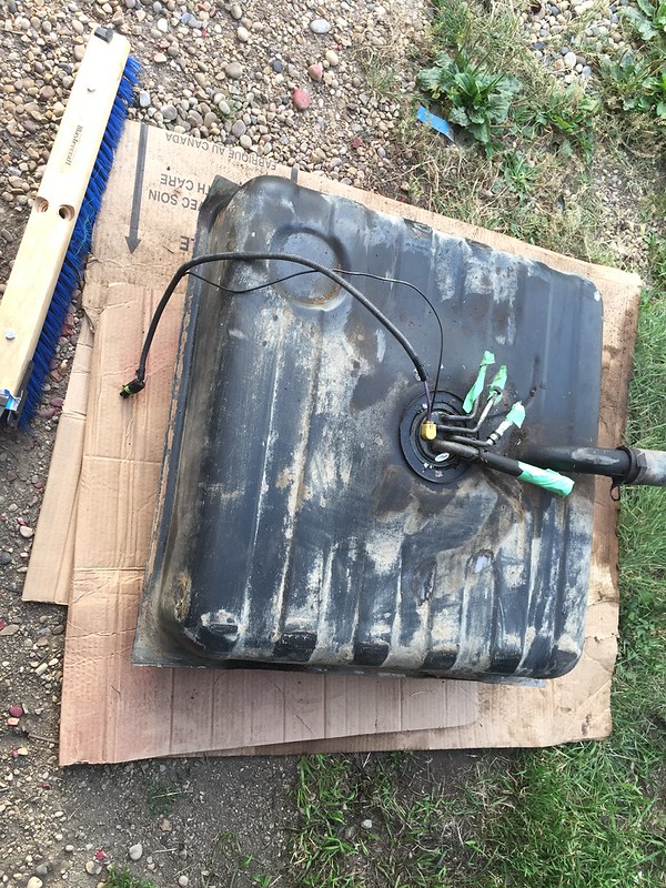

After work i stopped off and bought some paint stripper, brushed and rubber rock guard.
IMG_4938
Once the tank was down, I rubbed some stripper on it, let it soak while i had a beer. Once the stripper was soaked in a bit, i went to town scraping, and buffing the old cracked paint on the tank.
IMG_4943
IMG_4944

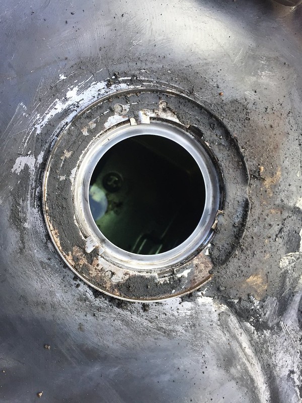

The stripper purchased was nice, as it was a gel. It sat on top well, didnt require a bathing method, but did burn a lot on exposed skin..:popcorn:

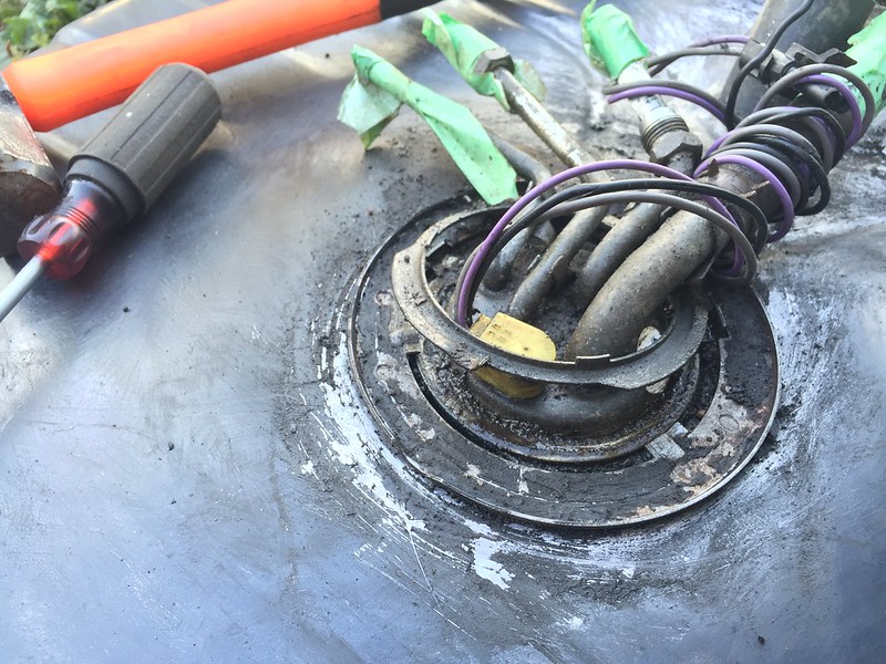

I got the locking ring out, and sprayed and brushed the seams out surrounding the fuel pump assembly. Used a pick and cleaned out the little cracks once i got the pump out.
IMG_4946
IMG_4951
IMG_4950
IMG_4947

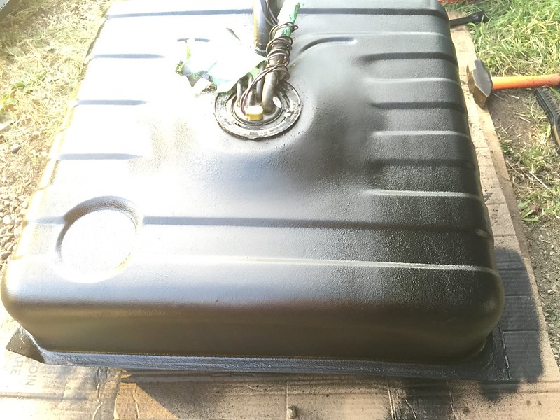

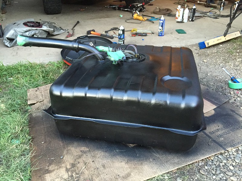

Once i got the Tank buffed down to the metal, and ready for rock guard and paint.. i forgot to snap a photo..:doah:
But here are some of the tank rock guard'd and painted.

On those spindles...... a rubber mallet and some full force both hands types of hits. The kind where if ya miss no matter what ya hit it's gonna hurt alot.
Hahah yea i tried that method, but being as its on jackstands and im always working alone, i only hit it as hard as i could without potentionally knocking it off the stands. The cold chisel method worked well , but it did ding ,and knick the spindle. It would be nice to do this on the garage floor next time so i can really whack the crap out of them.

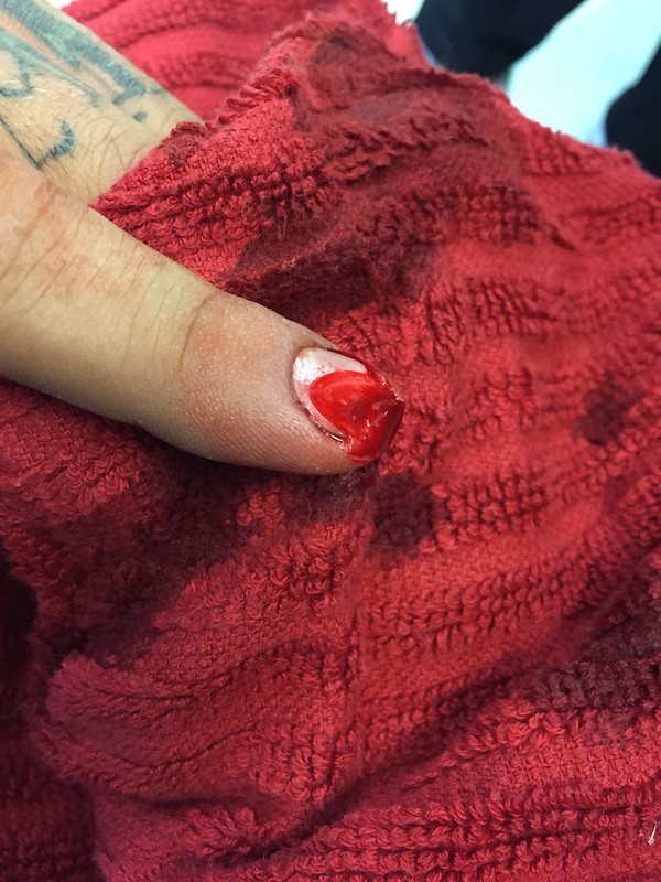

Sooo about 2 weeks ago while i thought it was a great idea to separate frozen chicken, with a knife... I was soon to be reminded about how bad of an idea it can be..
IMG_4995
i know you cant see with the blood, and muscle swelling but it is pretty deep. I could clearly see all the nerve endings, muscle before the blood started 4-7 seconds after. After realizing i didnt know where any hospitals were, i called a great friend , got it all cleaned, and got a tetanus shot..
After about a week it started to heal but still wasnt drying up.IMG_5019
The worst part of this was how sensitive the finger was to pressure, even when it felt fine, the minute it was hit on something, it made me want to punch someone! Now a week after that , it is healed enough to get some work done on the blazer So out to the garage i went today.

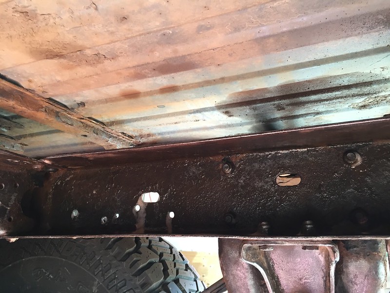

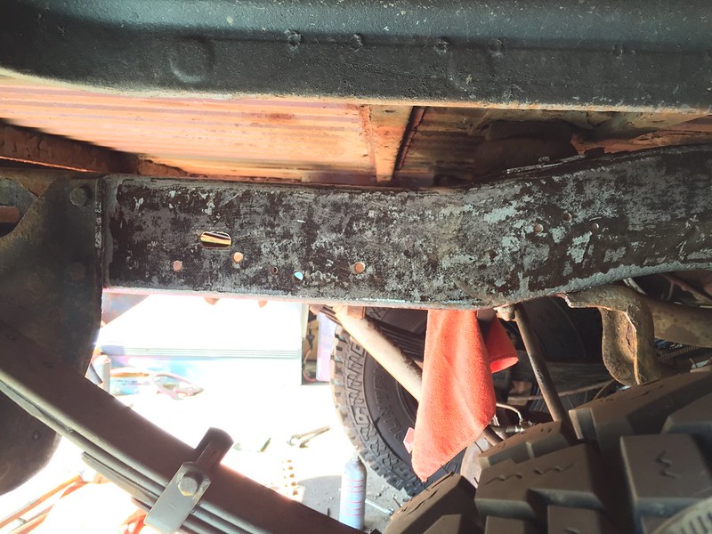

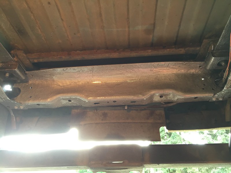

I had left off around the time of getting the tank down and part of the frame grinded and por-15'd. So when i went back out today i started grinding away in the fuel tank area. I got the rear of the passenger side frame grinded down aswell since the flaky rust i had left was bothering me.
IMG_5130
IMG_5129
I then applied the metal prep to the gas tank area.
IMG_5131
IMG_5132
IMG_5133
IMG_5134
By this time i had grinded quite a bit of the tank area, frame, cross-members, and i had eaten enough rust.. so i decided to take a break while the metal prep air dried. I then decided to fit the rear brake lines as they needed some bending, and fine tuning to fit just right.
IMG_5148
IMG_5151
IMG_5152
IMG_5149
IMG_5150
IMG_5153
Im very pleased with the quality of the brake lines from inline tube, along with the prop valve, although the prop valve didnt come with new mounting bolts i picked some up at the local partsource :waytogo:

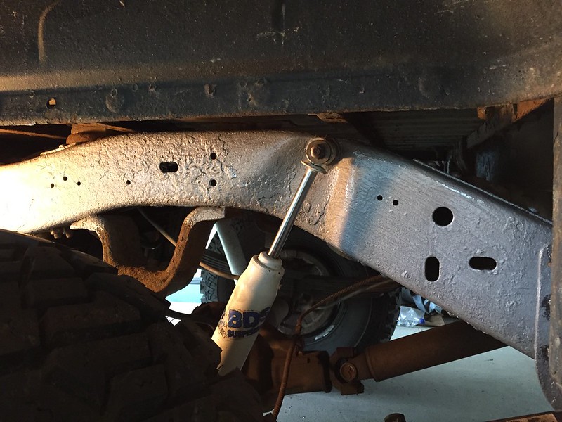

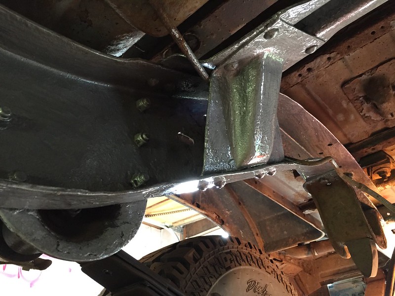

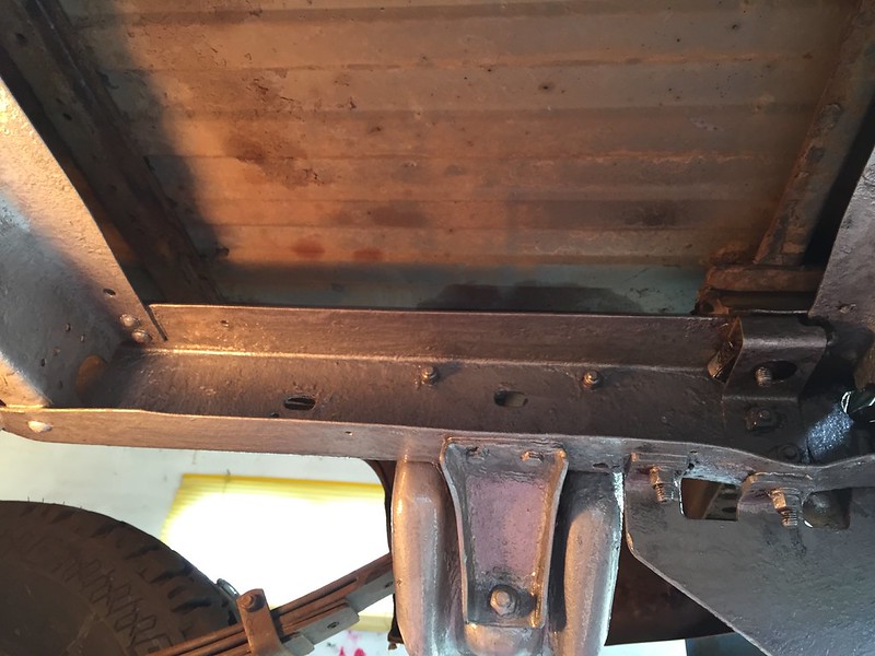

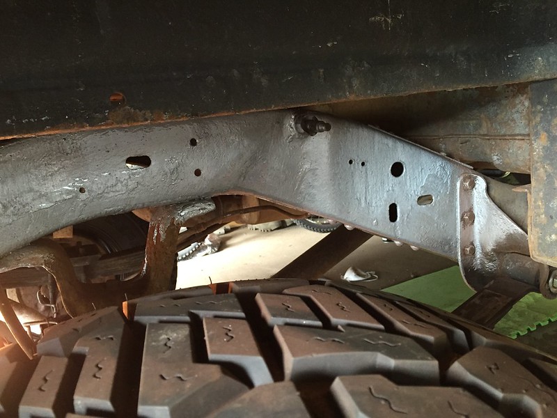

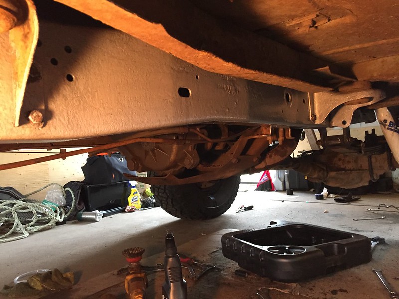

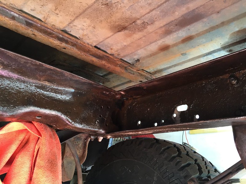

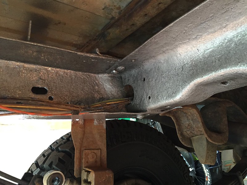

I then broke out the por15 and started to coat the passenger side to the tank as i make my way around the truck back to the drivers side brake line.
IMG_5137
IMG_5136
IMG_5138
IMG_5139
IMG_5140
IMG_5141
IMG_5142
IMG_5143
IMG_5145
IMG_5146
IMG_5147
My goal is to continue grinding and por 15ing my way to the drivers side by friday, and then over the weekend install all the brake and fuel lines and hopefully have it back on the road for monday. I miss driving this thing too much.
Im so happy this site exists as i can document my build as a work log, even if no one could see this and help me with it as people have, It'd still be worth the 25$ a year just to document the build for my own record.
i apologize for the por15 being all wet and drippy in the photos, i brushed out alot of drippy sections , and i will post different photos when its dry.
