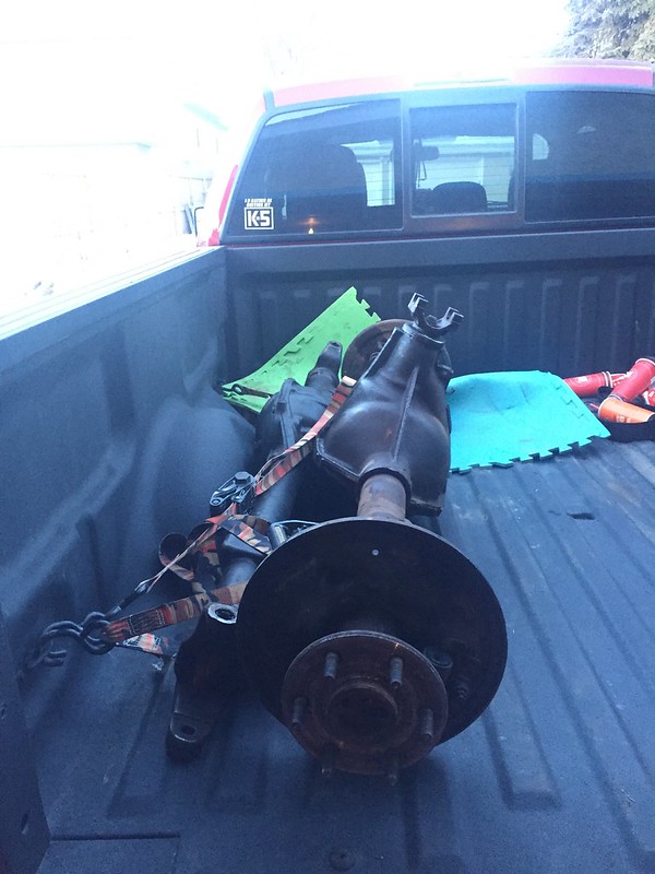

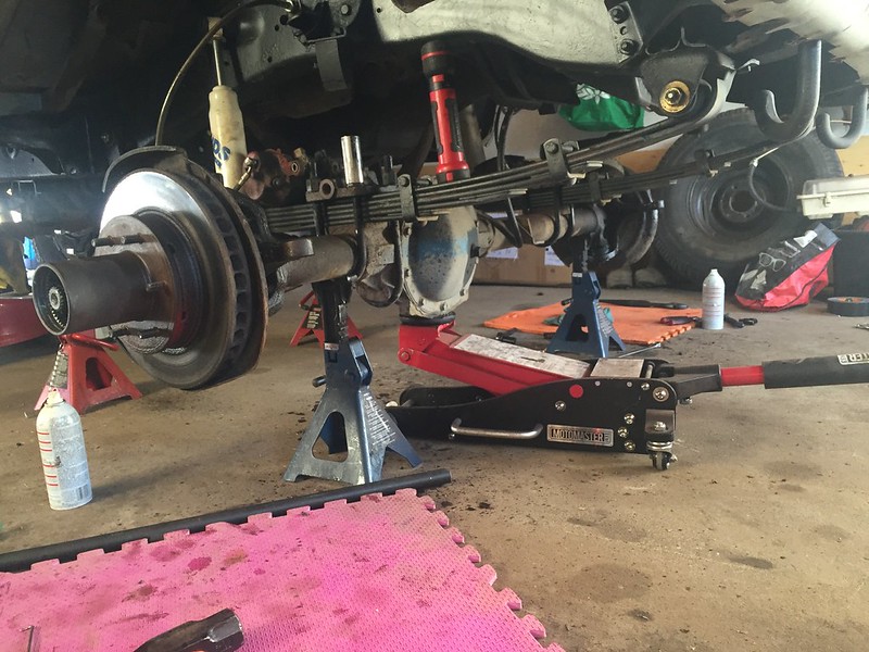

On saturday i woke up, and started loading the 10 & 14 bolt, taking the drums off the 14 bolt really helped with shedding some pounds, as to not blow my rear end out lifting it :eek::doah:.. hahaha

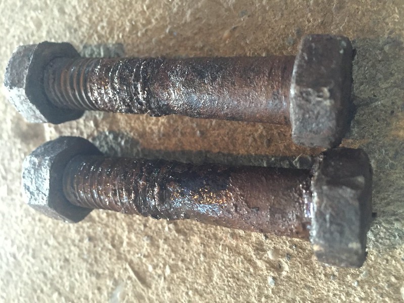

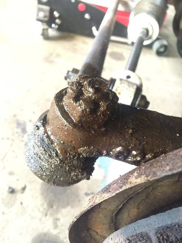

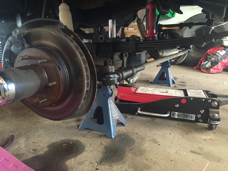

I started with the tie rods, I had changed the ball joints when i first got this truck, as the tire had a lot of play in and out due to shot ball joints. but didn't change the tie rods. The one closest in the picture looked okay, after applying these parts for 2-3 days in rust penetrant, but the other side was gross and completely shot, along with the connecting sleeve.
[url=https://flic.kr/p/CZGa8o]IMG_7801
by Nick Smith, on Flickr
[url=https://flic.kr/p/DXcxR2]

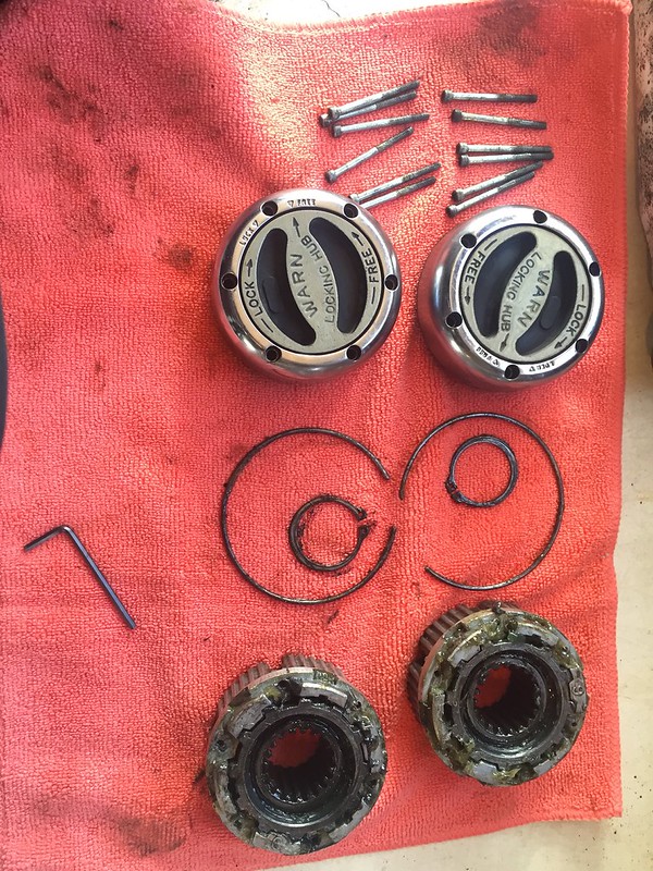

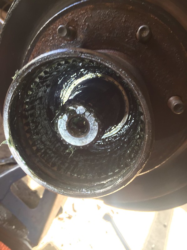

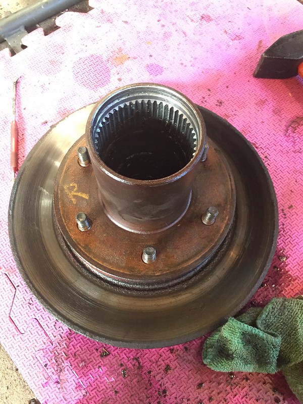

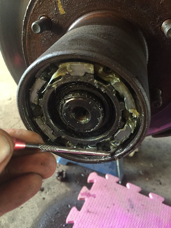

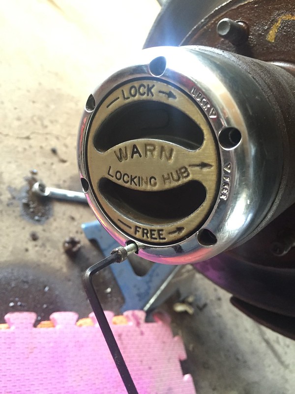

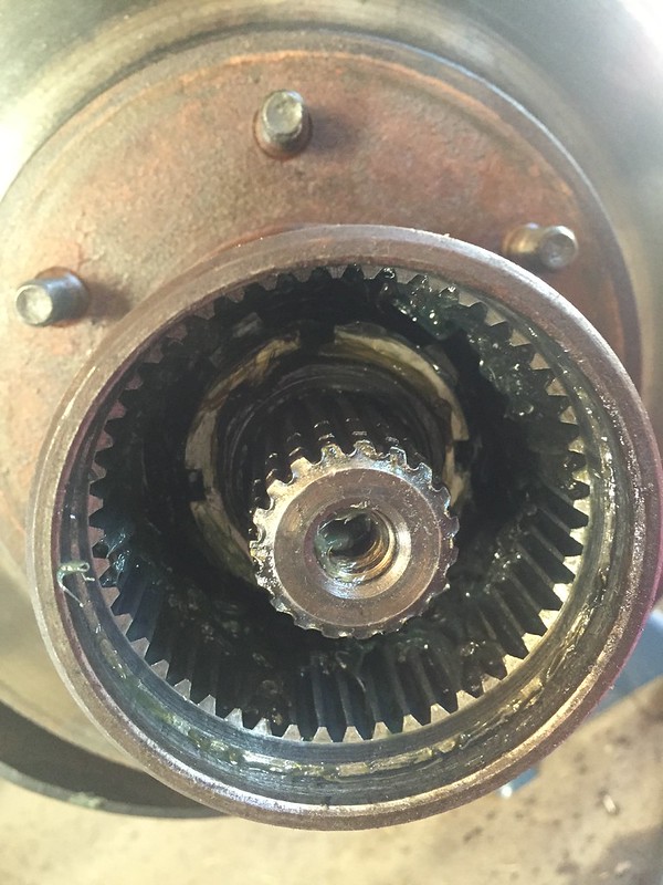

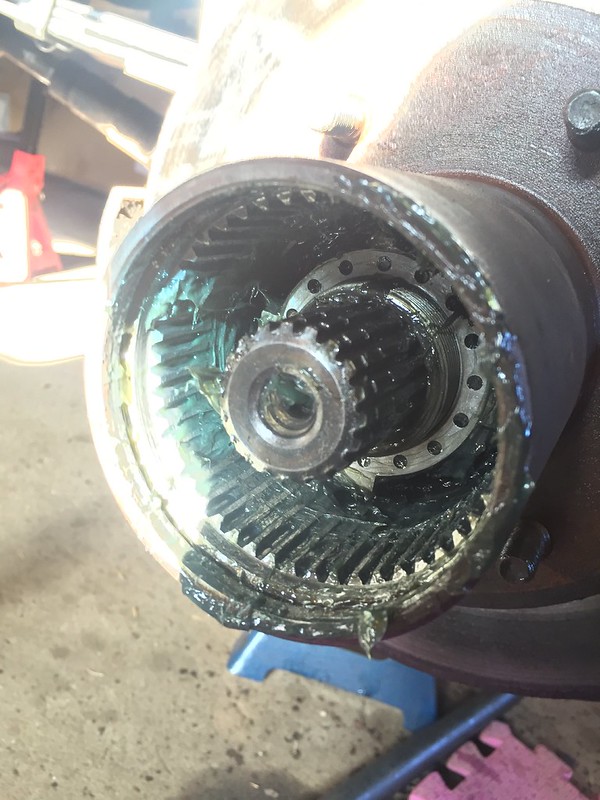

Figured i should keep and reuse these... like the previous owner would have :doah: haha. With the four pounder i got them out, couldn't get the cotter pins out, but they were so rusted they broke when the nut started to break free from the tie rod. I then tackled the hubs on both side, after rummaging through my piles on allen keys i found the right one and removed both snap rings and got the internals out with two picks.

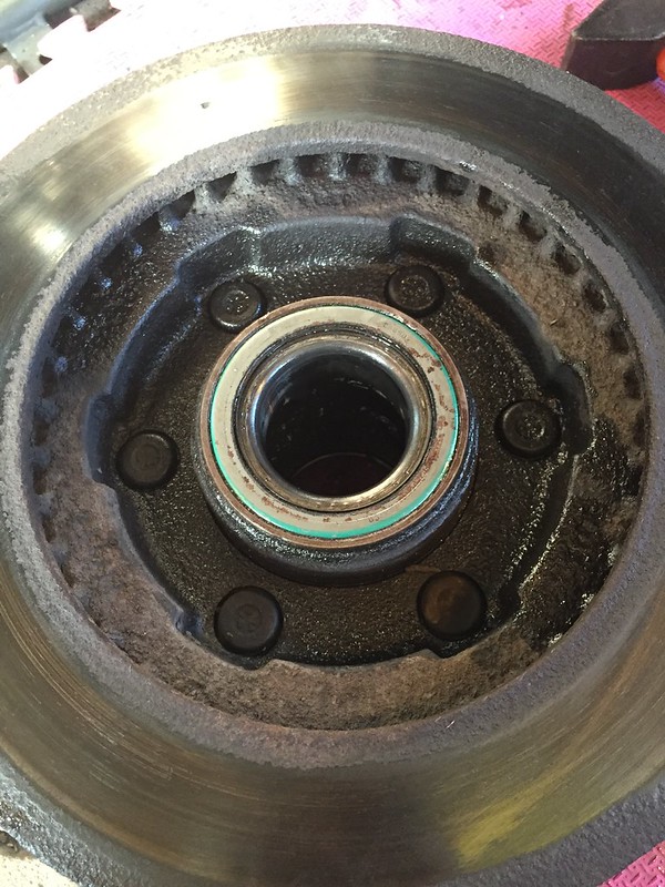

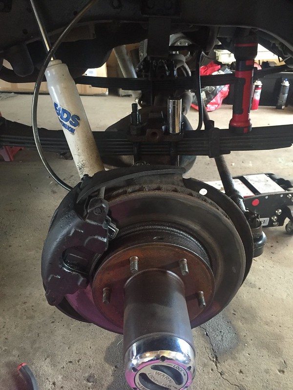

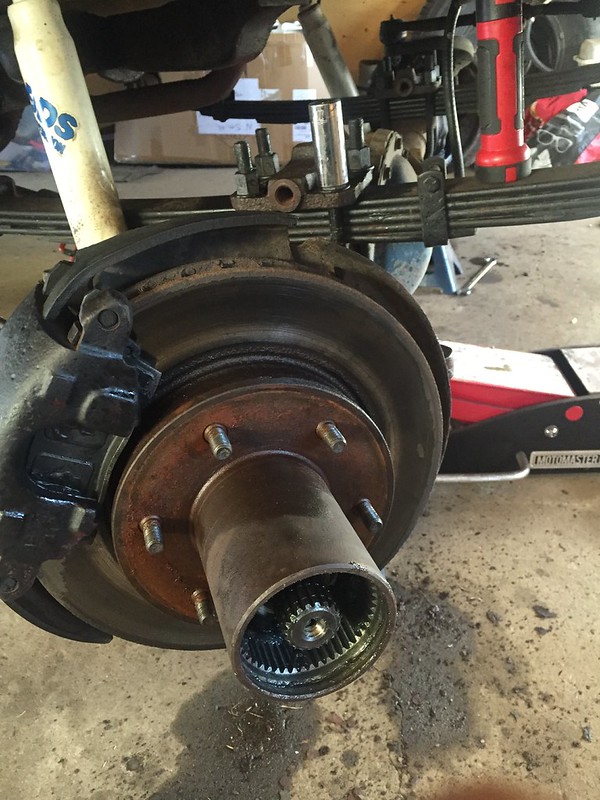

Since I'm terrible and putting parts and tools everywhere, I've decided on this axle project, i am going to organize everything, in a nice clean order for once... or at least make the effort:deal:. Then moved on to the brakes, got the callipers off, and tucked up top since the inners are out. I was going to change them but, funny how a coat of black paint can change your mind hahah. Moved on to the spindle nuts and got those out as well. Got the rotors off and marker for which side they came from, Inspected wheel bearings and they are timken brand, and in really good shape ( planing on cleaning, re packing, and reusing ) and remarked which side they came from. If the steel seal around the rotor is good, i can reuse right? I will buy new ones if its going to cause much risk.

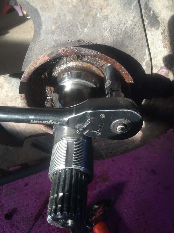

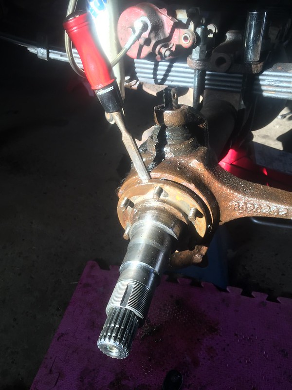

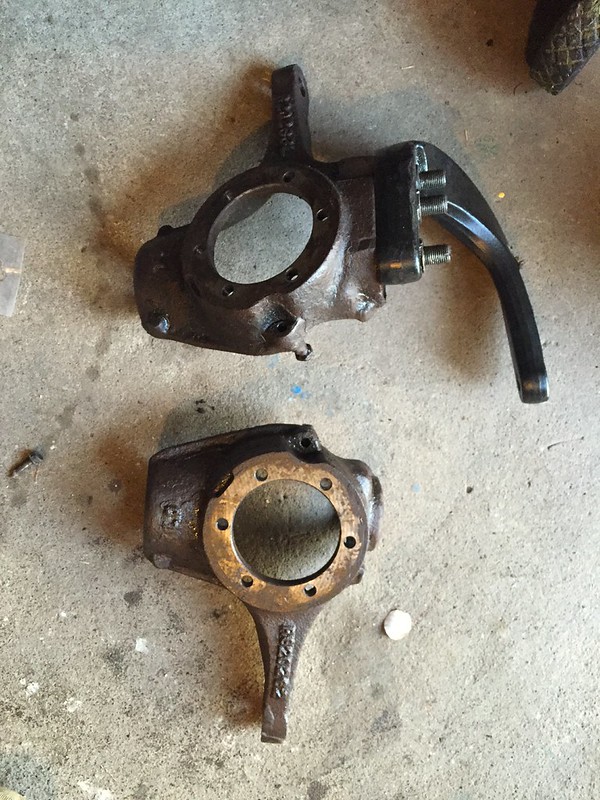

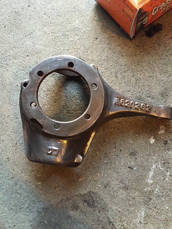

Moved on to the dust shield thingy..( not sure what its technical name is ) Things were a tad dried up since the last time but nothing was too challenging, for the most part at least. It was nice because since i was going back and forth on sides to repeat the same task, anything kinda dried up always got a coat of rust juice, while i was working on the opposite side. Once i got the shields i used a duller carpenters chisel to separate this slightly apart and then used a metal chisel to open them up. I did nick the knuckle a little so i will try and file anything down before re-installing. Pulled the axle shafts out, layed them out, and exposed the knuckles.
IMG_7833 by Nick Smith, on Flickr
IMG_7840 by Nick Smith, on Flickr
IMG_7843 by Nick Smith, on Flickr

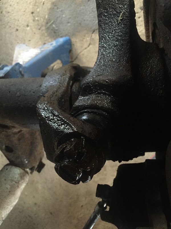

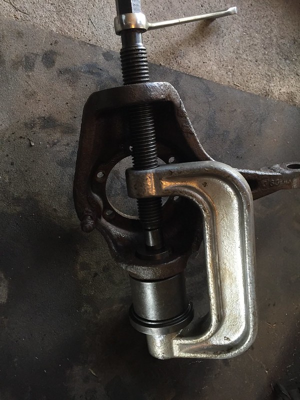

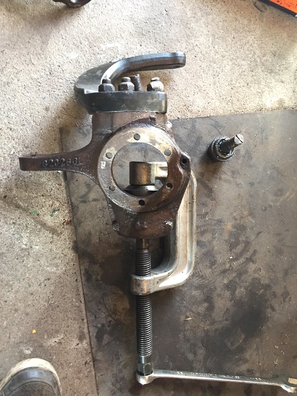

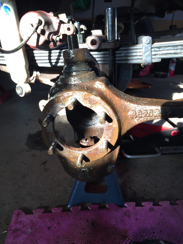

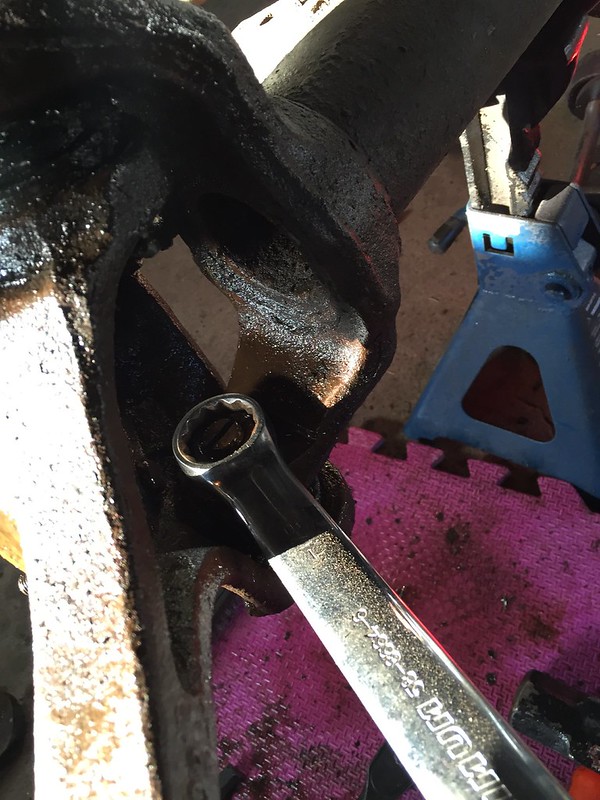

For the top ball joints i used a snipe, with an adjustable spud wrench that fit, because my biggest wrench is a 1'1/8 and i believe the tops are 1 1/4?

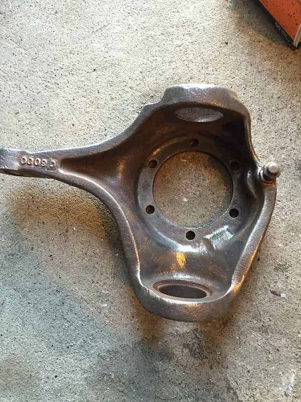

luckily for the bottom which is smaller i had the right size because no adjustable wrench can fit down there. Managed to get the the knuckles off with not too much ****ing around. The only issue i ran into was since i am going to reuse these, and I wasn't feeling up to beating the steering arm loose either. The wall of my ball joint press adapters wall, was too thick to squeeze between mine and the pro comp one that came with my kit. I may have just hit it with my hammer until it sorta stayed in place and used the press. it wasn't easy but it came out. This was a moment when i wish i had, even and electric impact...:doah:

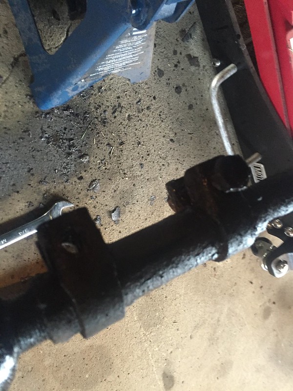

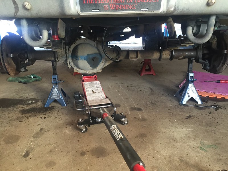

I then used my grinder with the wire cup brush and cleaned up these knuckles. I am going to primer and paint these. I wasn't completely planning on using my diff at all for parts unless i had too, but when i found out the axle shafts out of the ten bolt i got had 28 spline axles i knew i needed my axles and spider gears. I drained the diff to check for any bad wear that may have been inside waiting. I once again encountered about a whole cocking gun full of blue tacky gasket goop.. :surepal: The bolts had about half their threads covered in thick gasket crap...:doah:And i called it a day afterwards. I woke up planing on doing more on sunday, but i have felt pretty sick since. I may get some done tomorrow, if I'm feeling any better. I have to tackle the u bolts next and get this axle out from under the truck by saturday, when the 10 bolt is ready to be picked up. The parts order should also be here on friday to rebuild the entire front end... :D.. can't fuggin' wait!
