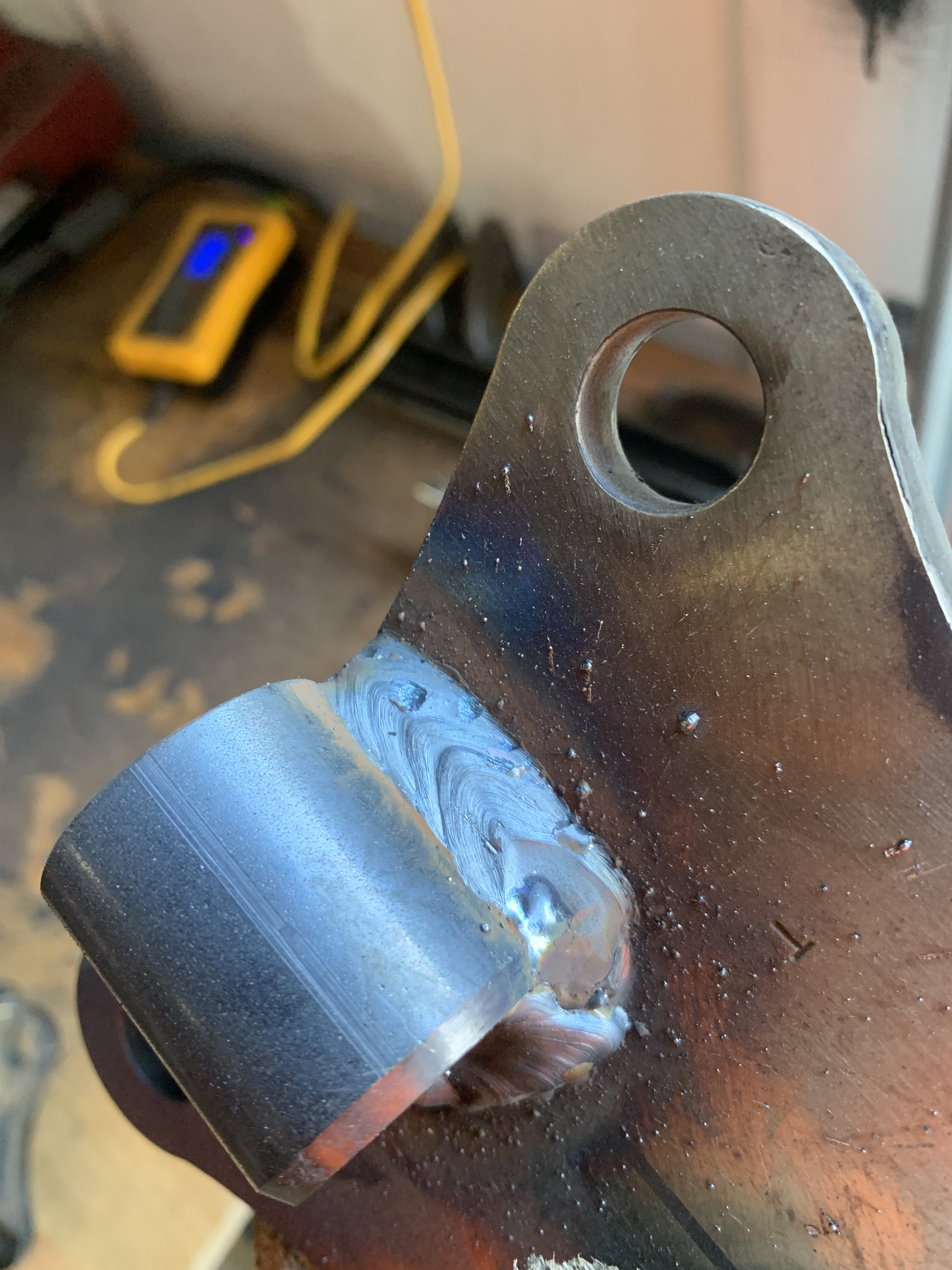

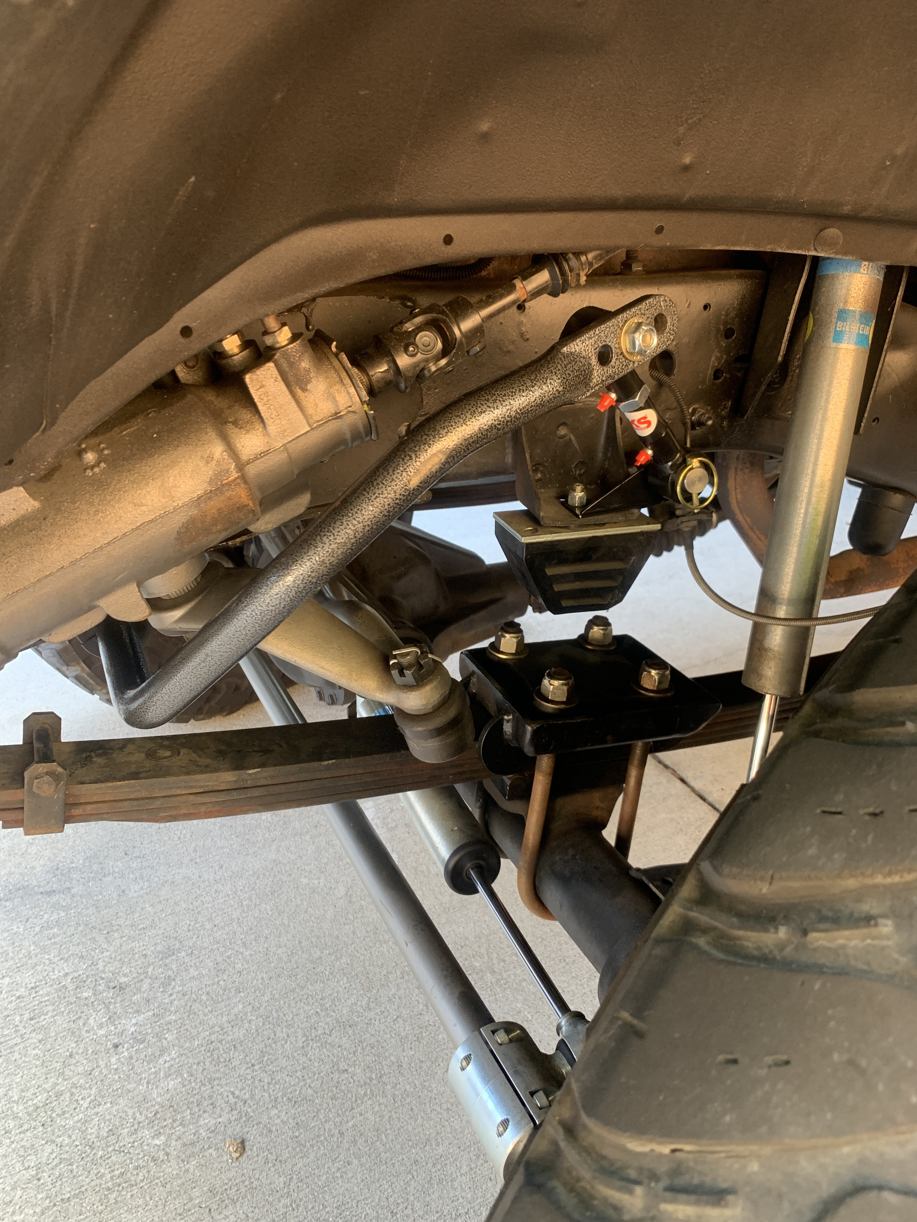

installed the ORD sway bar, still need to weld the bungs on to the DIY4X bump stop plate. I’m excited to see how much of a difference it makes.

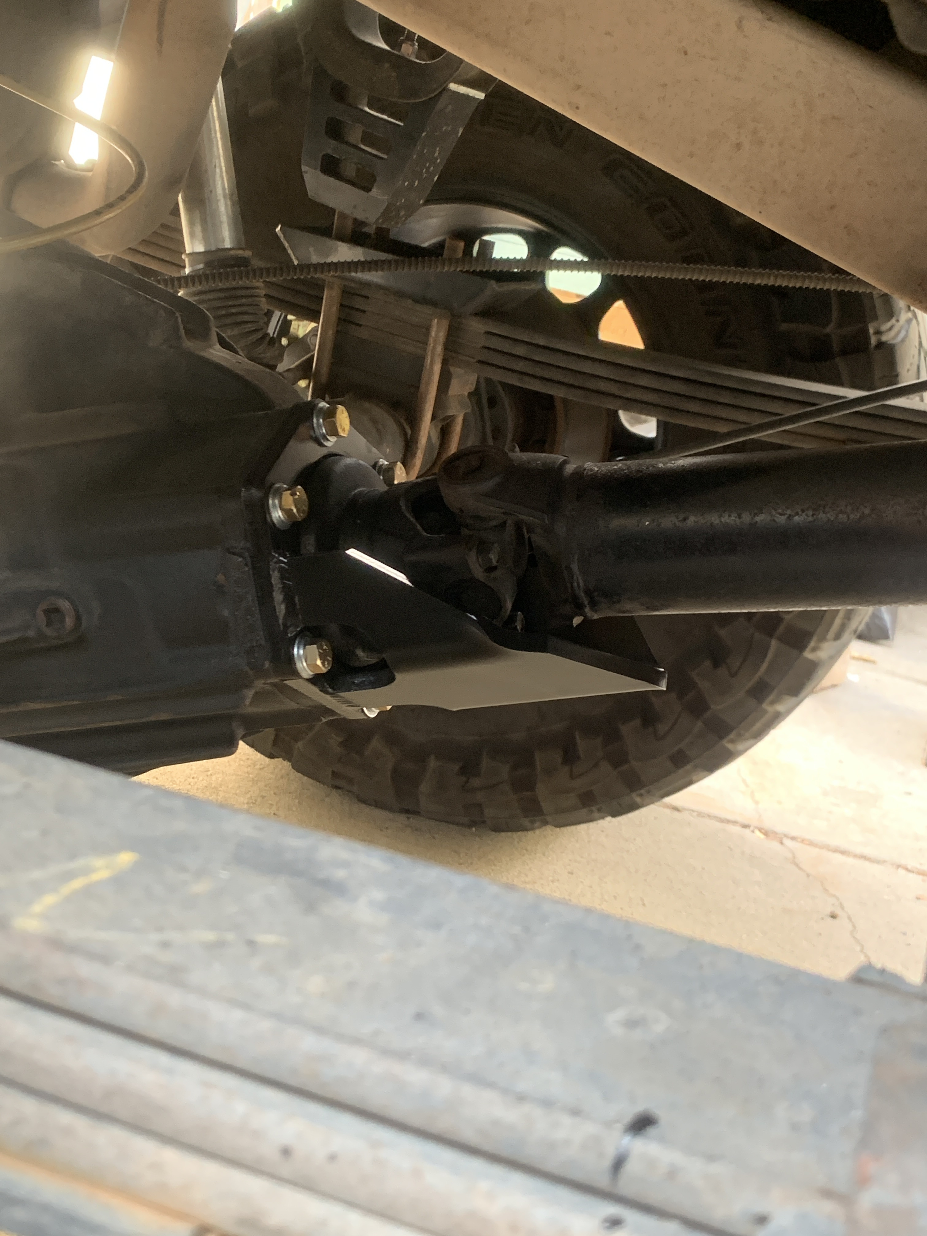

Also added a Ruff Stuff pinion guard. During this process I realized the rear drive shaft is too long. Looks like a SYE and another Tom Woods driveshaft is on the short list.

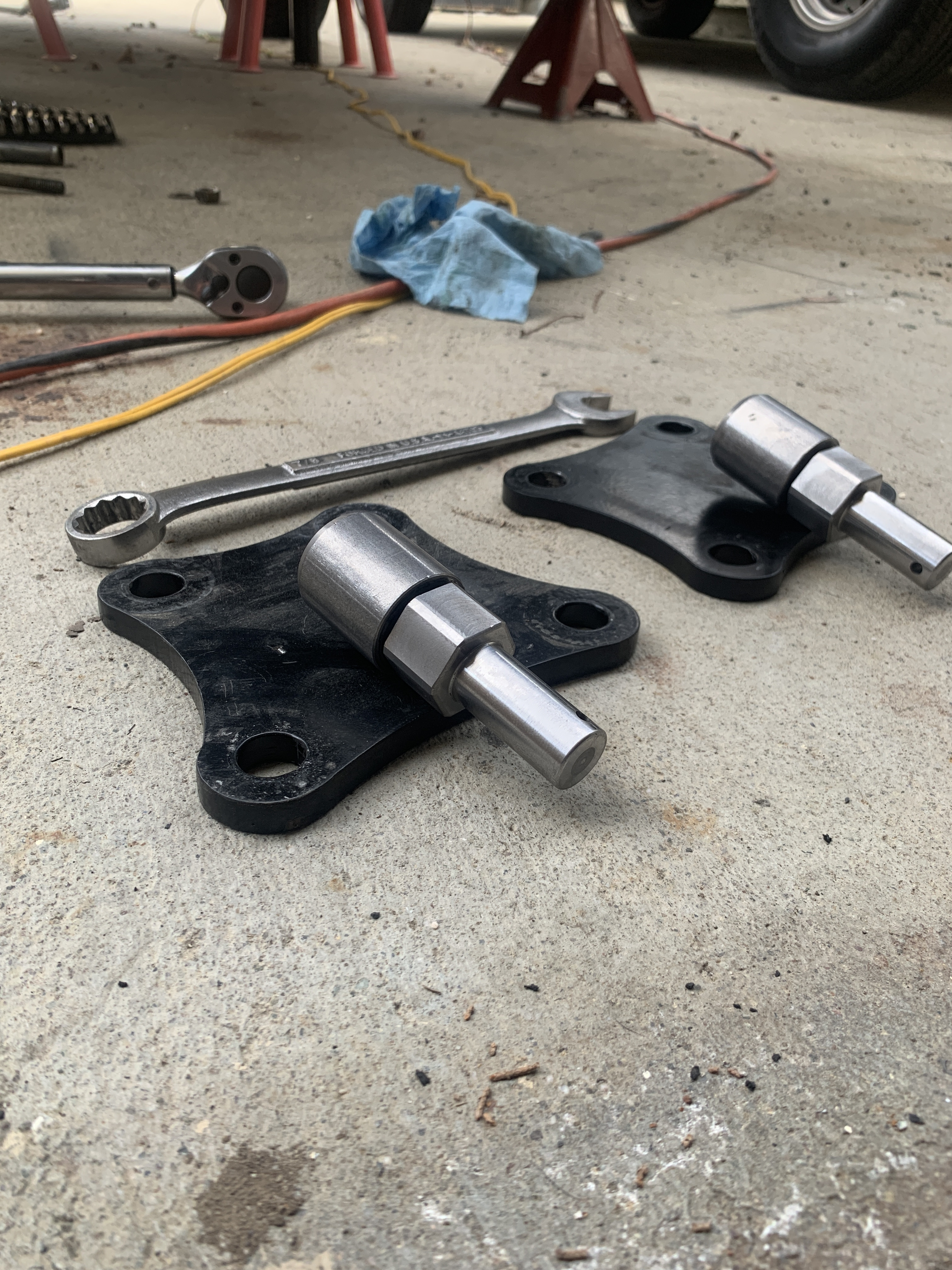

Do you plan to keep it connected while wheeling? I don't know much about the sway bar except that it works with crossover.
Nope! It has disconnects and mounts on both sides to slide the end links on when you don’t want it engaged to the axle. Post 83 has a picture of them since i didn’t have the weld nuts on the spring plate yet.

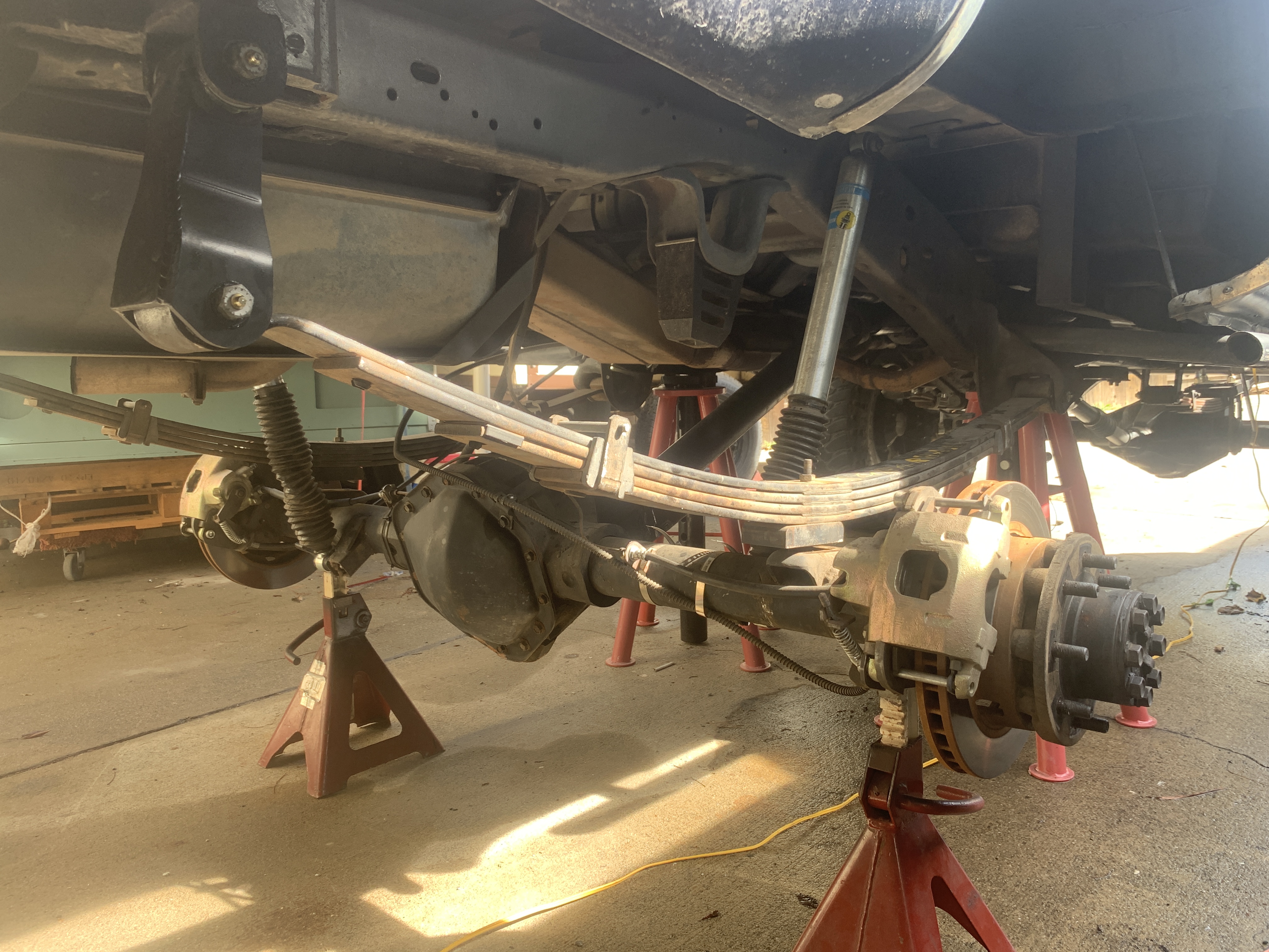

B5BB4992-EDAE-4AD9-8E38-E2031D2080AD.jpegParts started rolling in this week! Planning a trip to Rubicon mid-June with some buddies. Hopefully I’ll be able to find time to get all this stuff on the K5 before then.
pictured:
SYE with 1350 CV flange
Yukon 35 spline hubs
Yukon super joints
Brake line kit (need to clean up the 14 bolt after the disc conversion)
ARB compressor
ARB breather kit
ARB locker - 14 bolt
Yukon 4340 front shafts w/ 35 spline stubs
