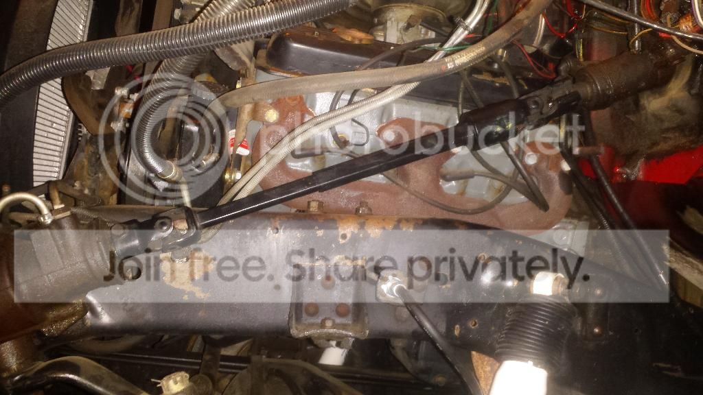

Have not gotten anything major done but I have made some small progress. Last week I took the truck for a drive after changing the kingpin bushings and springs. During the drive I experienced bad death wobble, I'm not sure if it would have done it with the old bushings and springs but I think it would have. So after some searching and thinking I decided to try the cheapest fixes first. One of the threads I had seen mentioned adding a washer under the kingpin cap to add preload, so a trip to Homedepot and about $2.50 and I had two 5/8" washers that have a dia of just under 2" and a thickness of .17". I installed them and took it for a spin and I won't say that it fixed it but I hit every bump I could find at speeds from slow to 45mph (no rear shocks so don't want to push it) and no death wobble.
Then today I when to the salvage yards and picked up a few things, got a set of front climb assist handles, a VSS sensor for my VSS'ed 205 project, two of the steel GM power steering remote resistors, and a '94 xj steering shaft.

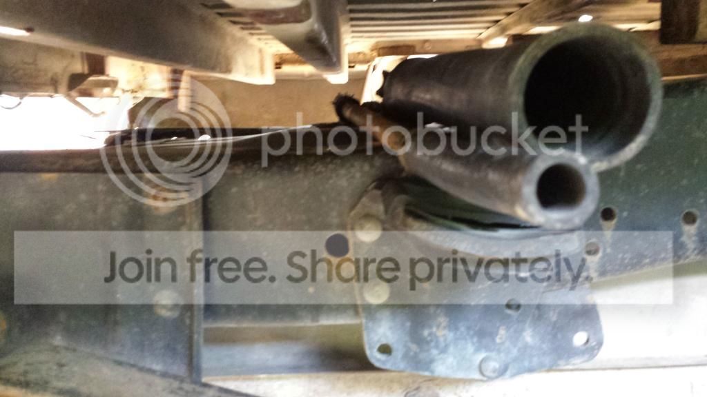

I cleaned up the xj shaft and started working on installing it, it went in fairly easy but I did have to heat it up more than I planned to get it to collapse. After it was in I took the truck for another spin and could definitely tell a difference. Now I just need to rebuild my box and it should steer great! This is the only pic I have from today... And its after the shaft install.

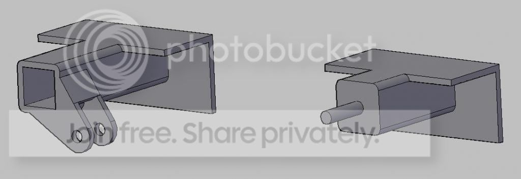

I'm going to be running a 40gal suburban tank, so that means that the stock "stagger" shock arrangement wont work. Also the center section casting on my soon to be swapped in dana70"s" is so wide that it means i almost have to go outside the frame rails. This is not a problem for me because this is not going to be a "flexy" truck.
So the question, which of the two mounts do you think would work better. The one on the left is similar to what the Ford Raptor uses and the one on the right is similar to the stock one. And secondly should I stagger the shocks front to back or point them both in the same direction front or back? Here is a quick rough out of the two mount styles.
I want the rear of this truck to be as stable as possible and if that means i sacrifice some flex i'm fine with that. Any thoughts would be great!

Adapter is sweet! For the rear shock mounts, I would do the one that has tabs. This way you never risk the bolt getting screwed up and needing replaced. Almost all new trucks have the shocks outside the frame.

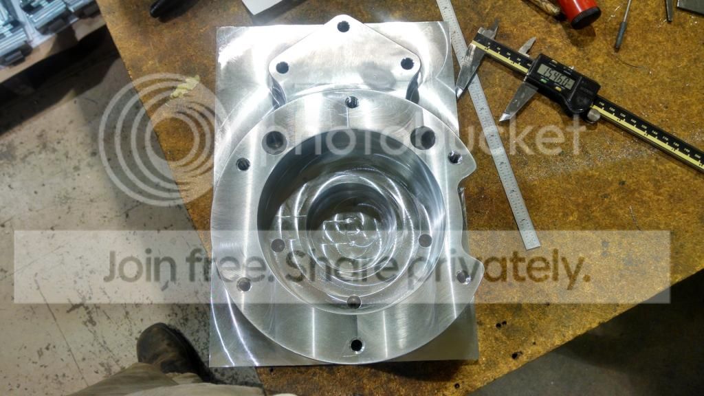

So while I wait on more small parts to show up I went and pick up my NV4500 to NP205 racetrack pattern adapter. Extremely happy with how it turned out! It may not give me the shortest drive-train but, It is and will stay a Crew Cab lwb so its not a big deal. I went this way because I really didn't want to use some of the other adapters that are out there and i really didn't want to notch the rear extension housing. On to the pic!

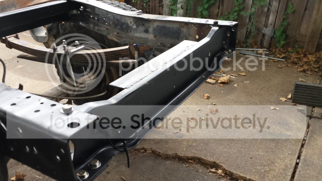

Then i started on installing my 40gal suburban tank. Started by moving the rear frame crossmember as far back as possible and adding a little material to make better contact with the tank.
The front two crossmembers, one is for the tank straps to connect to and the other is what the tank pulls up against when its all tight.

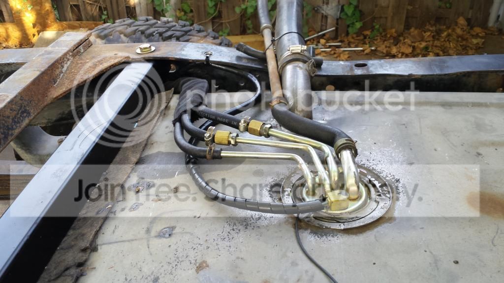

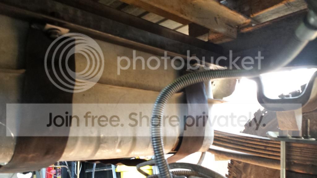

Here is the tank installed and a pic of the diff cover to tank clearance. Good thing I wont be jumping this truck! Also pics of the fuel lines and crossovers I used to connect the rubber line to the sending unit fittings and the fill neck clearance under the bed. Will probably have to take out a small section of the support under the bed floor.
